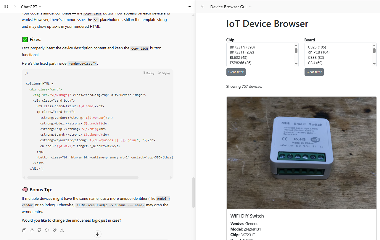

At this stage a problem arose - the code stopped compiling. Fortunately there is an option in Kanwa to automatically have the model fix it....
I can't believe it, he seriously did it! He fixed the error.
So I continued - on in one hut:
To each entry, add Copy button that copies raw original device JSON entry to clipboard
Here, however, something strange happened. I had to go as far as looking into the code - Kanwa allows you to preview the changes:
I went back and corrected the query:
To each entry, add Copy button that copies raw original device JSON entry to clipboard, do not remove existing features
I was greeted with an error:
However, this time again the AI was able to fix it:
It even generated an explanation of what was wrong:
The syntax error was caused by a duplicate and malformed <button> tag inside the device rendering block. It's now fixed - each device entry includes a single working "Copy JSON" button. Let me know if you'd like the copy action to show a tooltip or toast instead of an alert.
The finished effect can be seen here:
