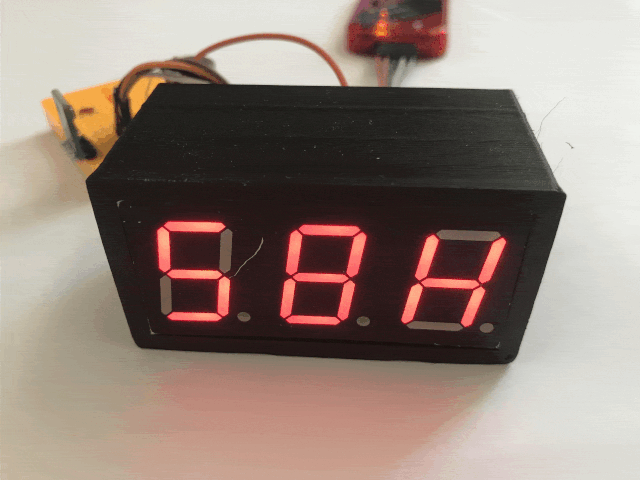

Animated 7-segment display with red digits in a black enclosure .
I invite you to the second part of the adventure with a thermometer/hygrometer built from 0 based on a PIC18F2550, parts from a drawer and programmed in the SDCC compiler - without external libraries. In this part I will run the ADC, i.e. the analogue-to-digital converter, and realise based on it the brightness control of the display so that at night the segments do not shine too brightly unnecessarily. In addition, I will already start working on the housing here.
In the previous part, I started a 7-segment display with 3 digits based on multiplexing from a timer interrupt on the PIC, and then implemented a simple I2C support in software to take measurements from the AHT20:

Case concept .
I wanted to make the enclosure using 3D printing. My first idea was to make the enclosure adjacent to the display. I started by sizing the display and preparing a test print:
3D model of a frame with dimensions shown in a design software .
It went smoothly and the shape overlapped the display just right:
Red 7-segment display with mounting frame on white background .
It was therefore possible to go one step further.
3D model of a rectangular enclosure with ventilation slot and dimension labels .
I sanded down the sides of the board so that it did not protrude beyond the display frame and prepared a deeper prototype:
7-segment display with microcontroller, photoresistor, and 3D-printed case parts .
It fits nicely:
PCB with 7-segment display in 3D-printed enclosure held in a hand .
Initial effect:
7-segment display in black 3D-printed case showing value 8.8H 7-segment display in 3D-printed case showing value 23.0 .

Summary of part two .
In this step, I first made the necessary error corrections from the first part, i.e. increased the segment current slightly so that the display was brighter. Then I moved the connector from the ICSP so that it didn't stick out from the side, which blocked me from adding a straight housing.
I then decided to add a brightness control for the display. On the hardware side, there was one problem, because the PIC18F2550 allows you to run the analogue pins "counting from 0", and I had already allocated RA0 and RA1 for I2C, so in the end, not wanting to re-solder the bus, I decided to reconfigure the port every reading. On the software side it went smoothly, I just increased the interrupt frequency and added a simple compare and count into it - from now on there are 8 interrupts per digit, where in each one I check if the current counter has reached a given brightness level and based on that I light or turn off the digit.
Finally, I started experimenting with the casing - I decided on a version adjacent directly to the display, the front of which even matches the overall colour, although these blemishes could use some painting.
However, the photoresistor complicates matters a bit, because at the moment I'm not sure where to put it - my concept of the case doesn't provide for it, and if I put it on top, then placing the device on a shelf will make it partially covered. I need to rethink that.

efi222 23 Jul 2025 21:41
With the photoresistor 'on the roof' quite an innovative solution. In the end we will probably end up redesigning the housing and the photoresistor (newer, smaller) will end up on the front. [Read more]
p.kaczmarek2 24 Jul 2025 04:57
Yes, worse, I liked the concept of the display close to the edge of the case. I think I would even reduce the thickness of its walls.... depends where it will stand. [Read more]
efi222 24 Jul 2025 11:31
Maybe give a tinted glass on the front. It would mask the photoresistor and improve the contrast of the displays. [Read more]
