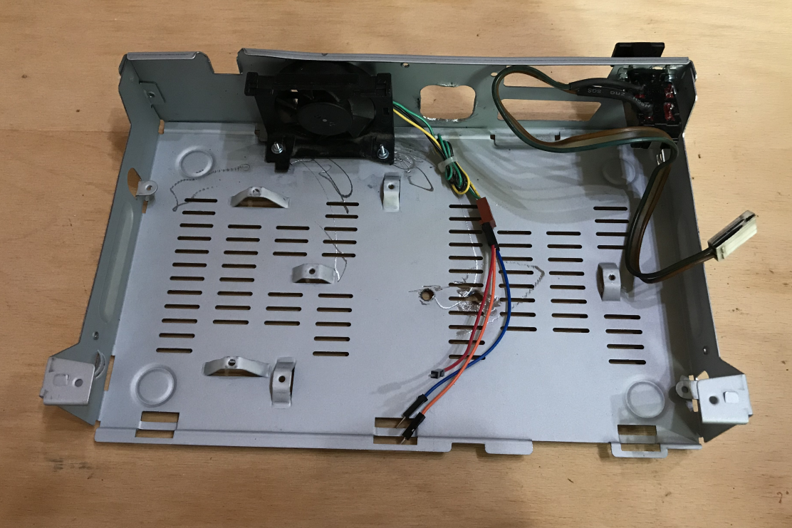

    First modifications
    First I added a small fan and a mains ON/OFF switch, all taken from a drawer/electronic scrap.
    I insulated the wires to the switch thoroughly with heat shrink sleeves.
    The idea for the switch itself came from two reasons:
    - originally the tuner, when connected to the mains, was in stand by all the time and it was not possible to switch it off at all
    - the power supply board from the tuner already had a ready-made, derived connector, it was just asking to use it

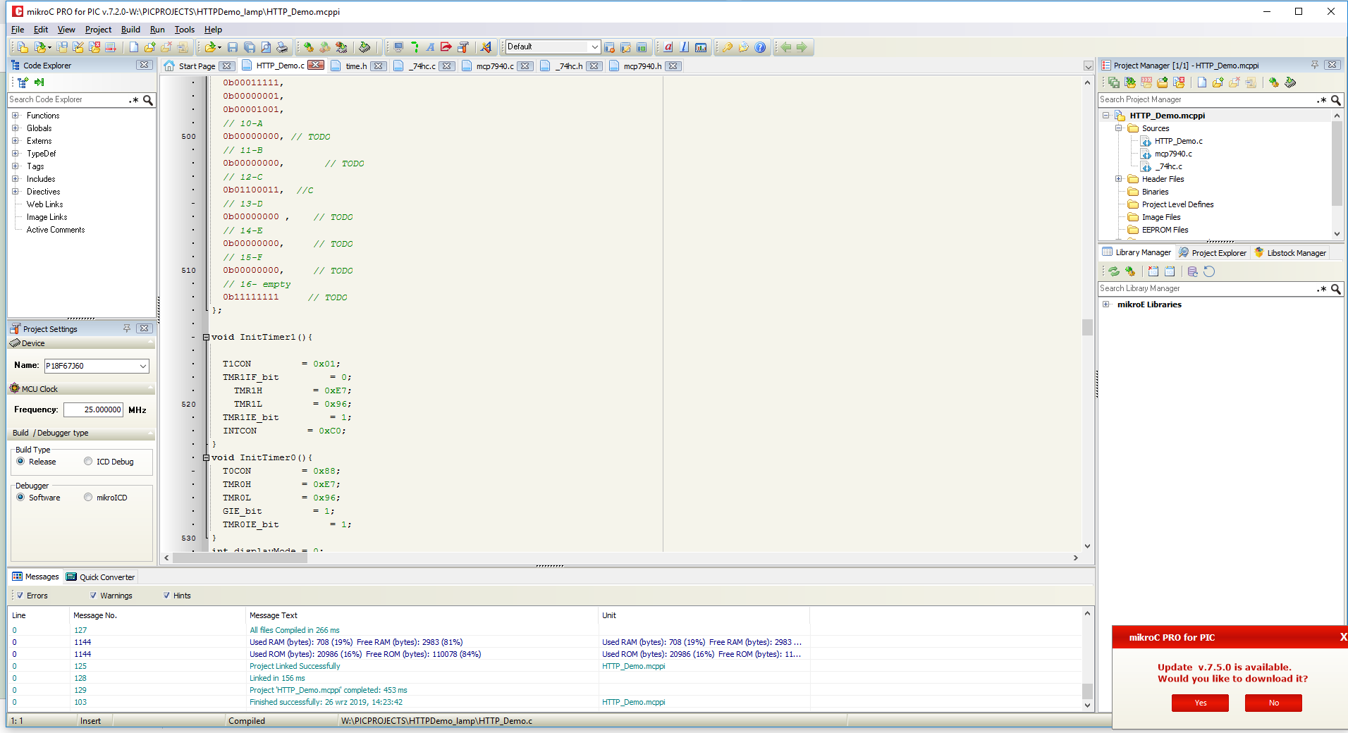

    Firmware on the PIC
    Firmware was written in MikroC PRO for PIC based on HttpDemo for PIC18F67J60. I added support for the I2C bus (for thermometer and RTCC), 74HC shift register, software PWM (not used in this project) and the possibility to control the relays and the aforementioned PWM via a web page.
    Small online relay/lighting controller in a sat receiver housing
    The code is not final, it is not cleaned, I only make it available to those interested fully at their responsibility.
    The test website at the moment looks like this:

    Cool design. Plus for the careful craftsmanship and use of scrap metal. Unfortunately, I have the impression that it's form over content. A similar device can be made on an ESP32, some relays and a USB charger. Here, a large device that can do little. It seems to me that the author can afford something more ;) ...and also this watch - it's probably already 10 in the house ;P
    One more question. Why the fan in the case? ;P

    Generally I put what was in the drawer in there, but the project was to have one more feature that is ready in the code. These software PWM which are visible on the web page were supposed to control LEDs (of course not directly from PIC pins :D ), maybe even a bit more of them, allow to change their brightness, etc.
    I haven't used this for now, but maybe by Christmas something will be up and running....

    Big kudos to you for feeling the need to have such a device, you created it yourself, bravo for that. The description is also nicely done, you tried to accurately present what you have done.
    But as for the visual effect, which can be evaluated here, it is already in my opinion average.
    Not my aesthetics. If you look at it, you can see a mix of different styles, or a lack of style. I understand your desire to use some blocks from the demob. Seemingly a cool idea, but a bit problematic. If you would make a dedicated PCB, it would come out more coherent and aesthetically pleasing.
    I most "liked" this fun creation of yours:
    After all, this socket could be soldered out of this green board and mounted directly in this universal one (why the piece of green board?!).
  • #7 18190213
  • #8 18190252
    Posts: 14763
    Rate: 12894
    After all, this socket could have been soldered out of this green board and fitted directly into this universal one ( why this piece of green board?!" ).
    The design is not perfect and was not intended to be so, and I admit that much can be criticised, but just what you pointed out has good justification :D
    I did so because, that there are signed voltages on the board and I realise that when I look at the chassis in six months' time I simply won't remember what goes to what anymore.
    In general I've tried to have everything reasonably clearly done (at the expense of doing the whole thing fairly quickly) so that I can develop it later, ie:
    - on the PIC board all pins are signed
    - the board with the relays also has signed pins
    - the power supply from I2C is wired with white and black cables (matched colours)
    - well, and that connector from the power supply which you drew attention to also has signed pins
    And on the RTCC board (the one with the battery) I even left myself free pins from the I2C bus to be able to connect another module to it if necessary.
