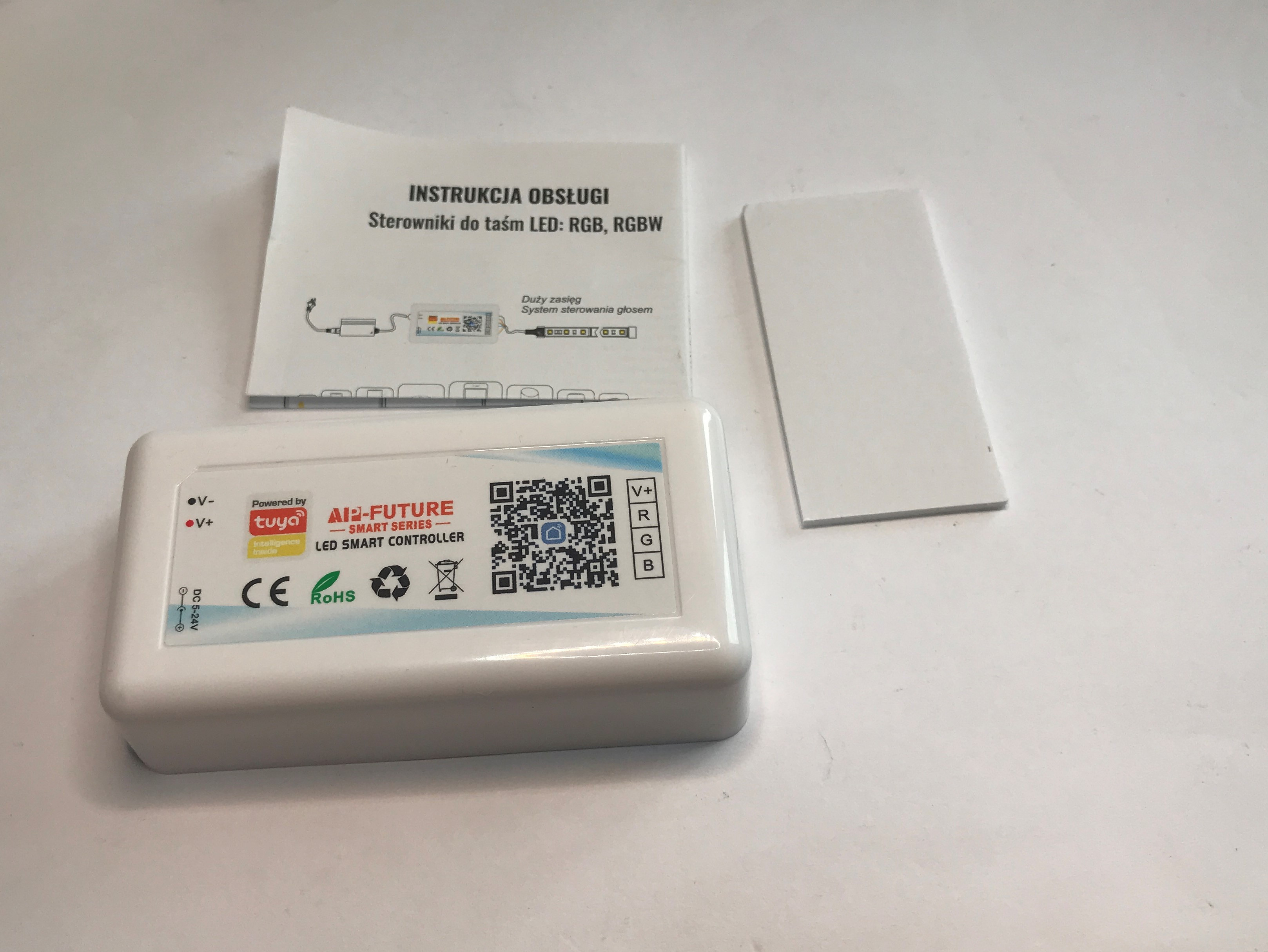

Here's another LED lighting controller offering control via WiFi. This time I'm also changing its firmware at the request of a reader - I'm reprogramming the WiFi module so that this controller can be connected to Home Assistant and controlled locally without the cloud.
The controller shown here is commercially available under the name EC79901 and is designed for RGB tapes, but after changing the firmware, it can also control three separate single-colour tapes or CW tape (shades of white). It's all up to us.
So let's start with the kit's markings and contents. The manufacturer promises 12-24V DC operation at up to 15A.
LED Smart Controller package with two QR codes for Tuya and Smart Life apps Tuya EC79901 LED controller box with EcoLight branding and technical specifications .
A double-sided adhesive strip for mounting the controller is included.
Tuya LED controller, instruction manual, and mounting tape on white surface LED controller EC79901 held in hand, label with CE and UKCA certifications visible .
The manual is in Polish and English:
