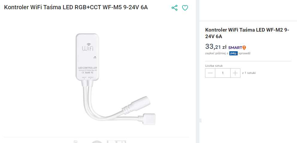

    Purchase of a controller
    The purchase was sent to me by a reader so that I could change the load, but I know that the product comes from a Polish auction website and cost less than PLN 50:
    [ESP8266/LM1] LED strip controller with WiFi CCT WF-M2 (or maybe WF-M4 RGB) - interior, Tasmota
    Why there is one thing in the title and another in the name of the subject - I don`t know. We definitely bought: WiFi controller WF-M2 LED strip 9-24V 6A
    Quite a poor description:

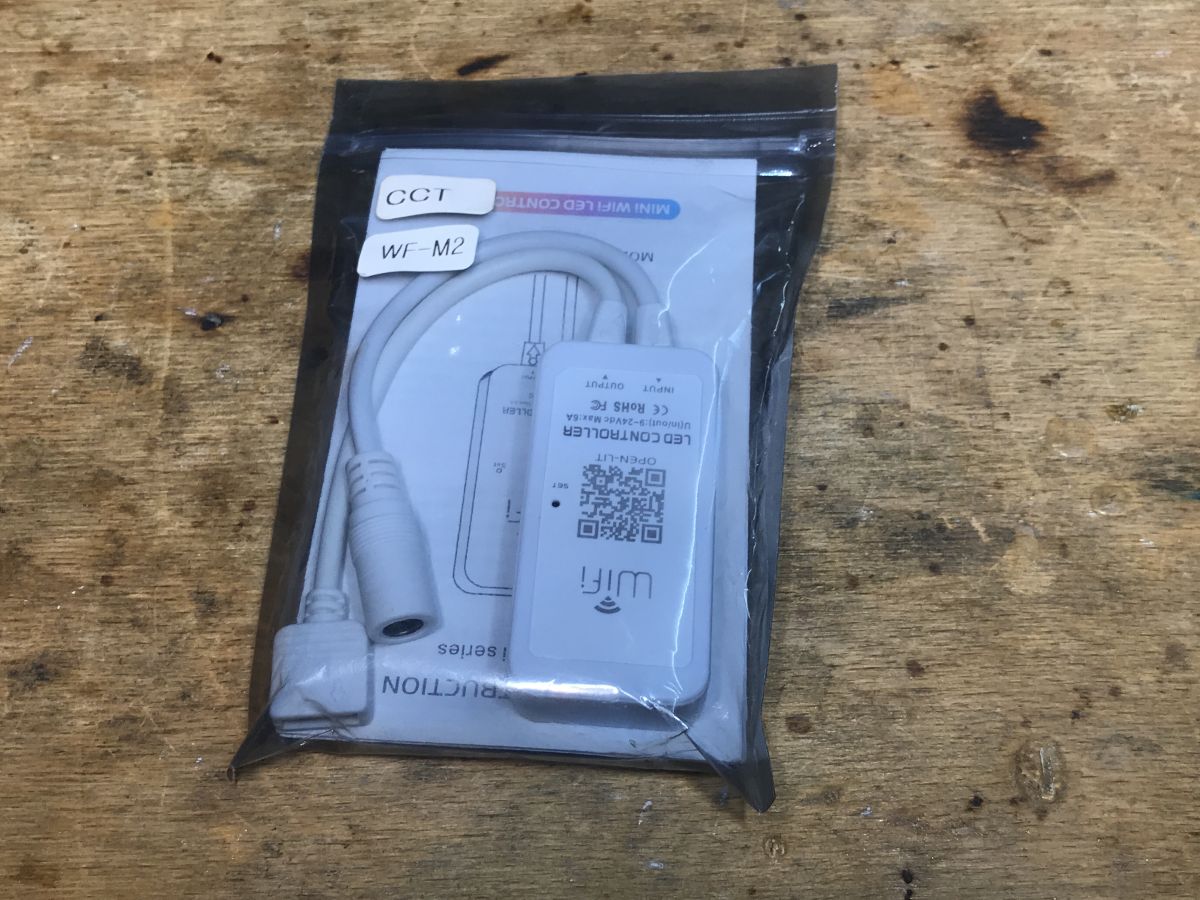

    So let`s see what we get in the package:
    [ESP8266/LM1] LED strip controller with WiFi CCT WF-M2 (or maybe WF-M4 RGB) - interior, Tasmota [ESP8266/LM1] LED strip controller with WiFi CCT WF-M2 (or maybe WF-M4 RGB) - interior, Tasmota
    There is a CCT, WF-M2 sticker on the packaging, so it seems correct... let`s look at the instructions:
    The manual contains the model WF-M4 - it`s weird.
    Additionally, we see that it needs to be linked to the Open-Lit application, perhaps another Tuya clone?

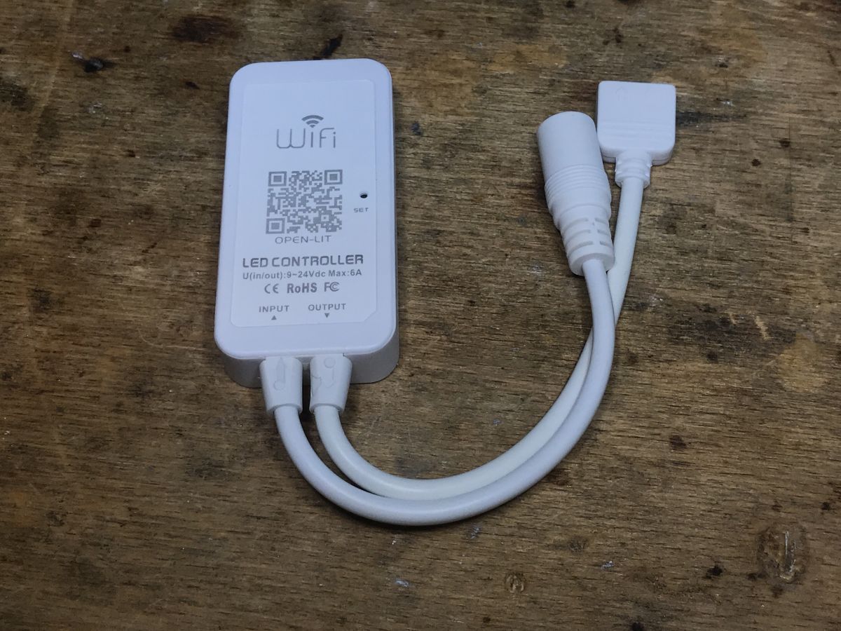

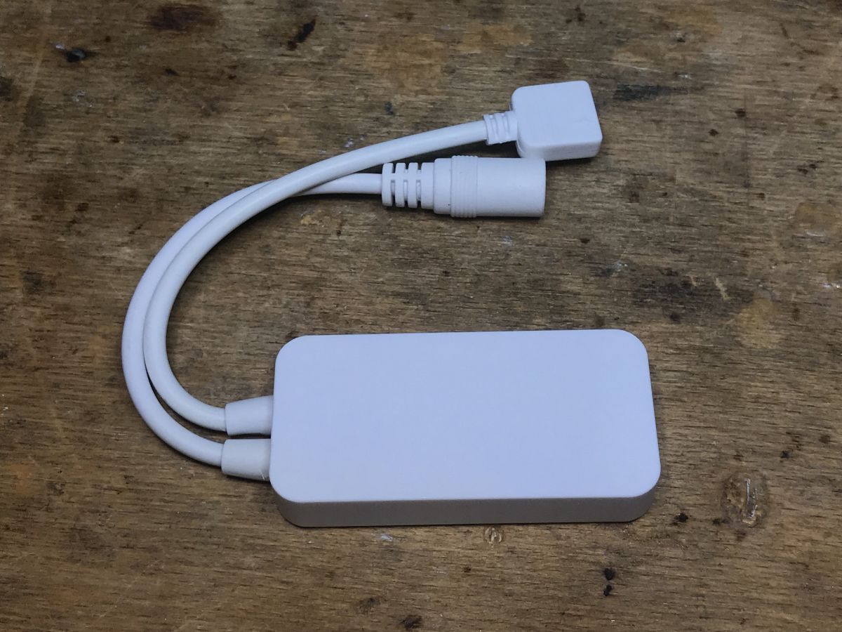

    And the product itself:
    Everything is standard here, both the power input (jack socket) and the LED strip output...

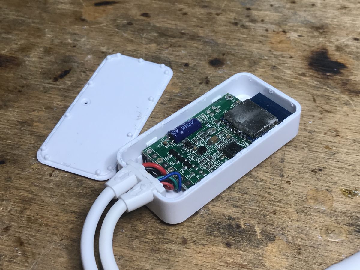

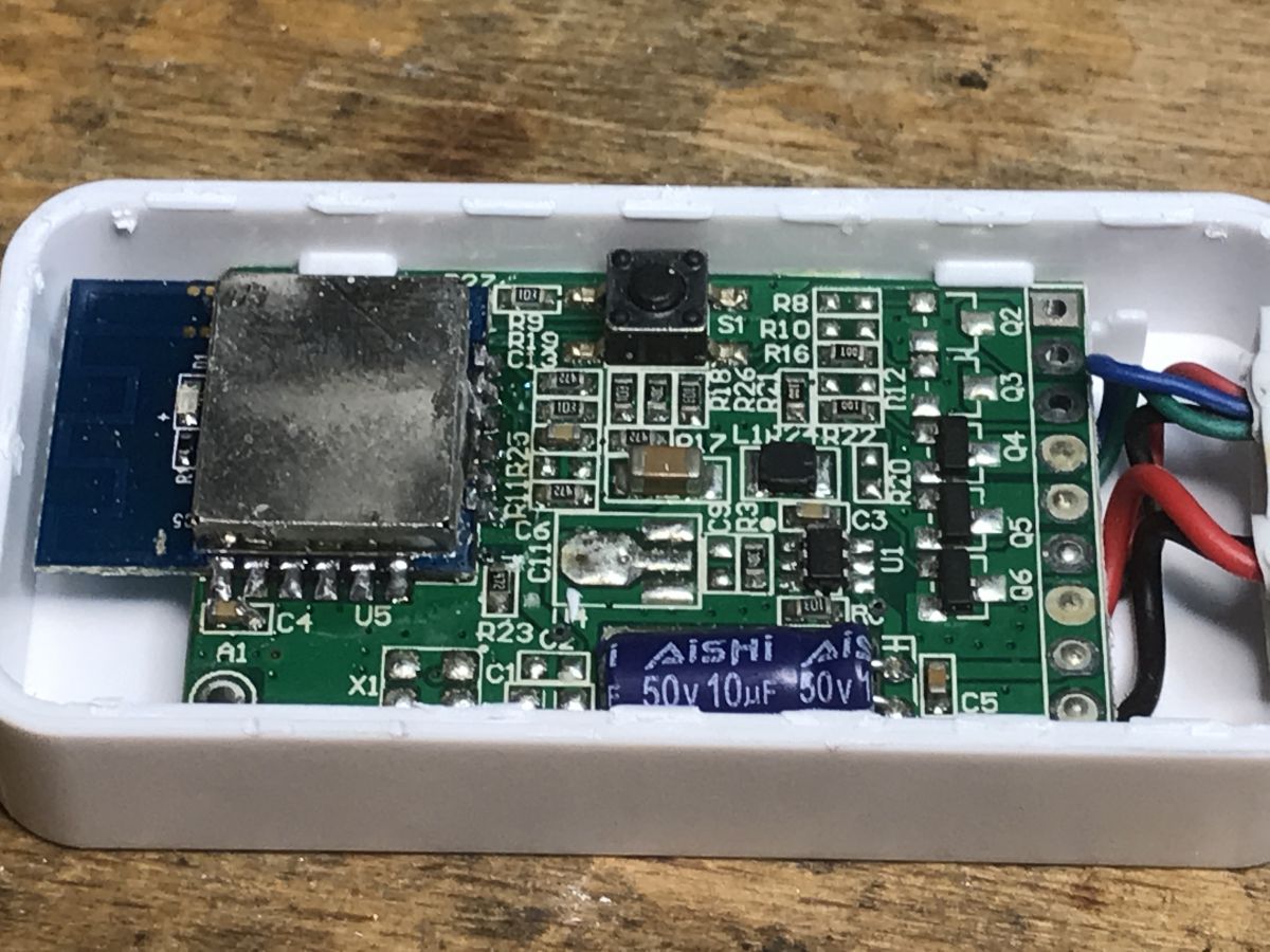

    The interior of the WF-M2 (or rather WF-M4)
    There are no screws, just pry the lid with a flat screwdriver:

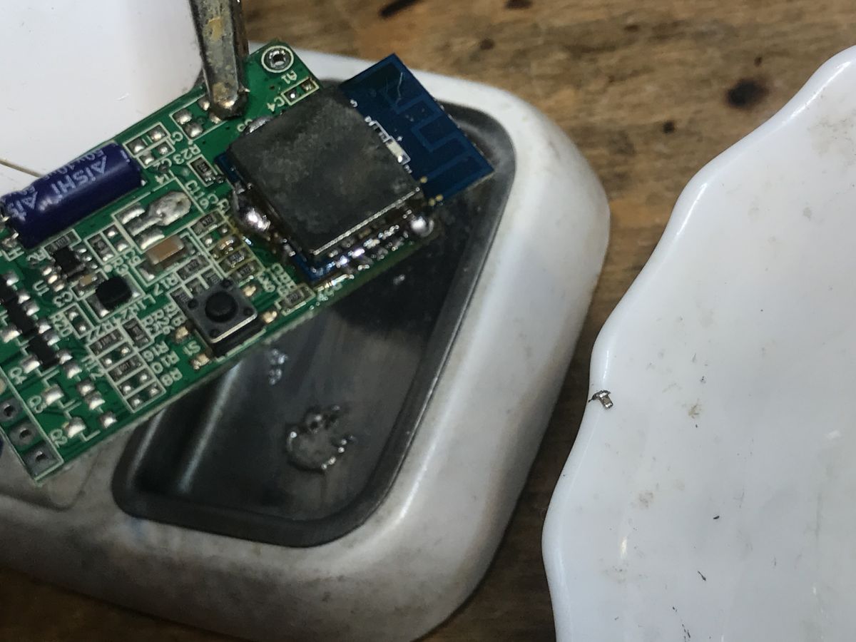

    At first glance, the WiFi module is not described:

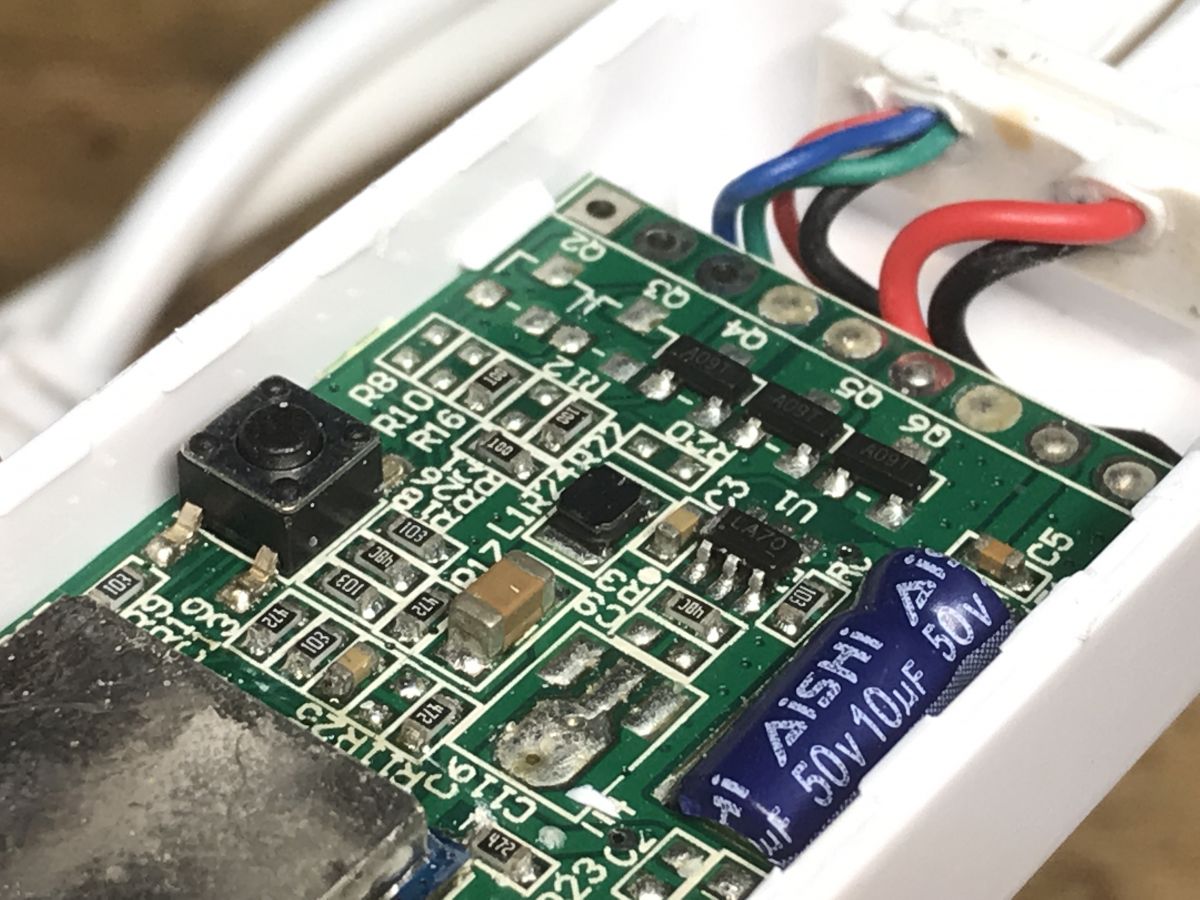

    There are three transistors inside, so I don`t know if it`s really the CCT version... it looks like RGB:

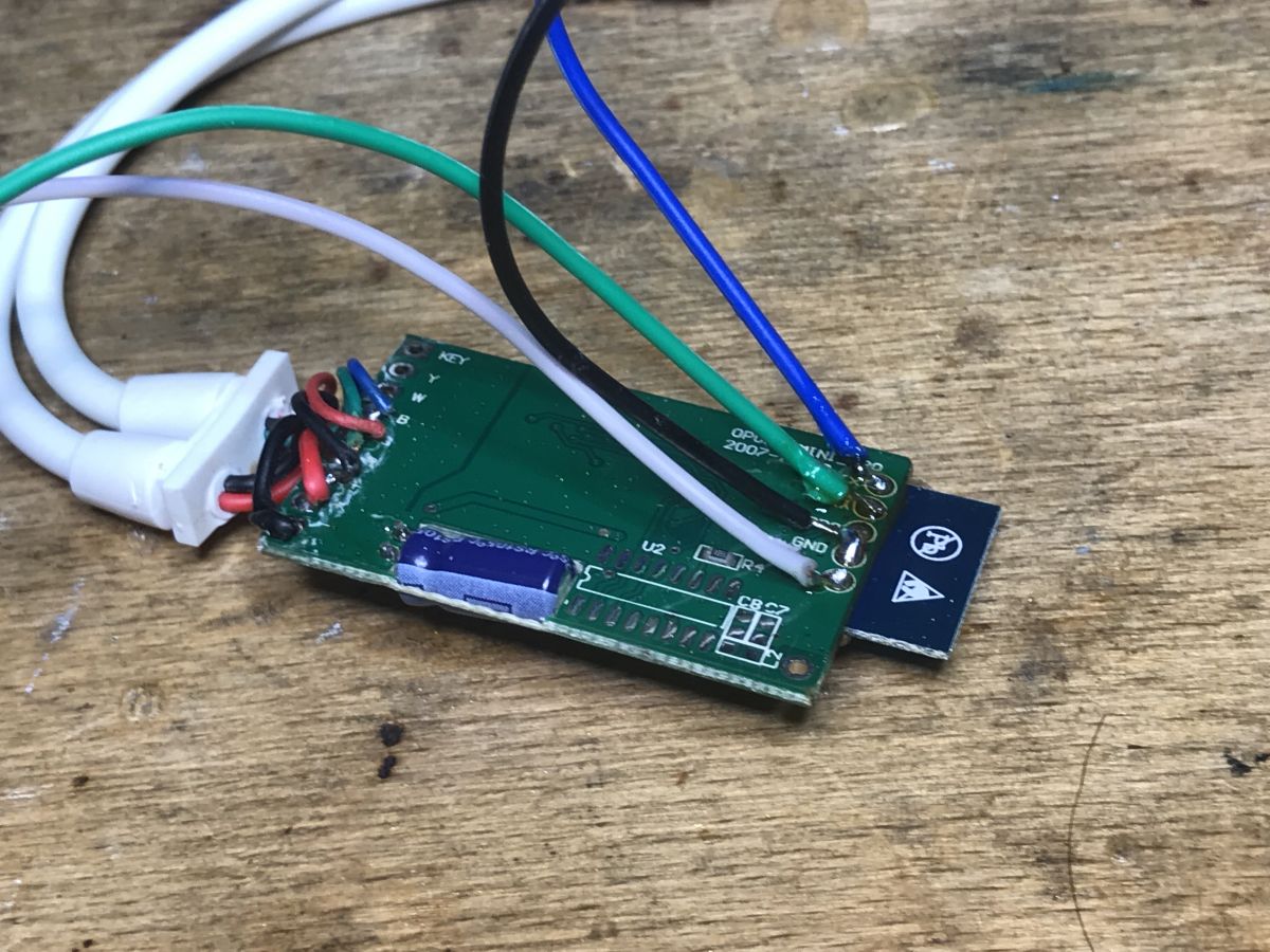

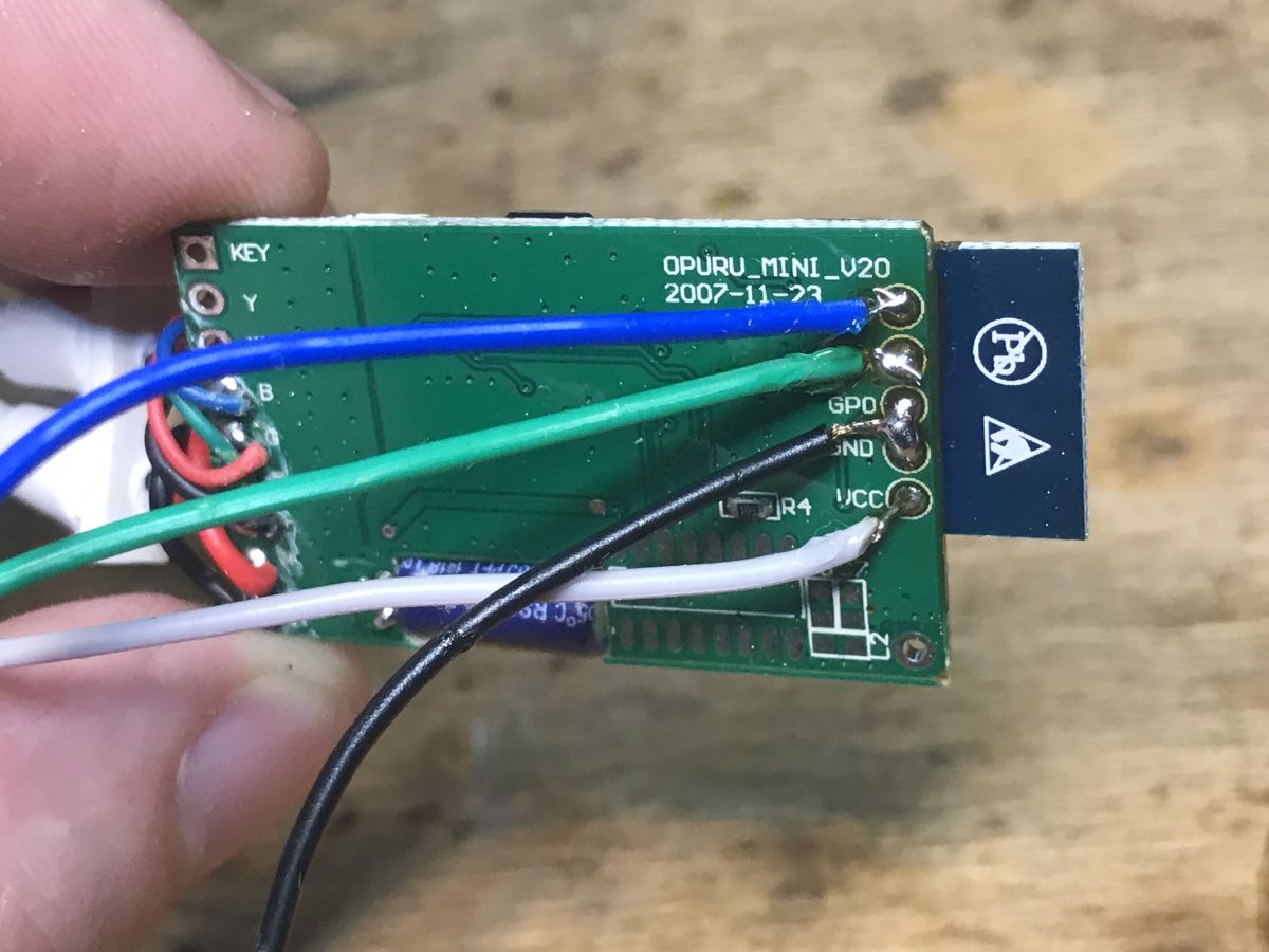

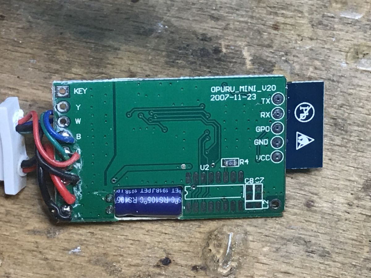

    On the bottom we have the marking: OPURU_MINI_V20 2007-11-23, you can also see programming pads, including the characteristic IO0 - is it ESP8266?

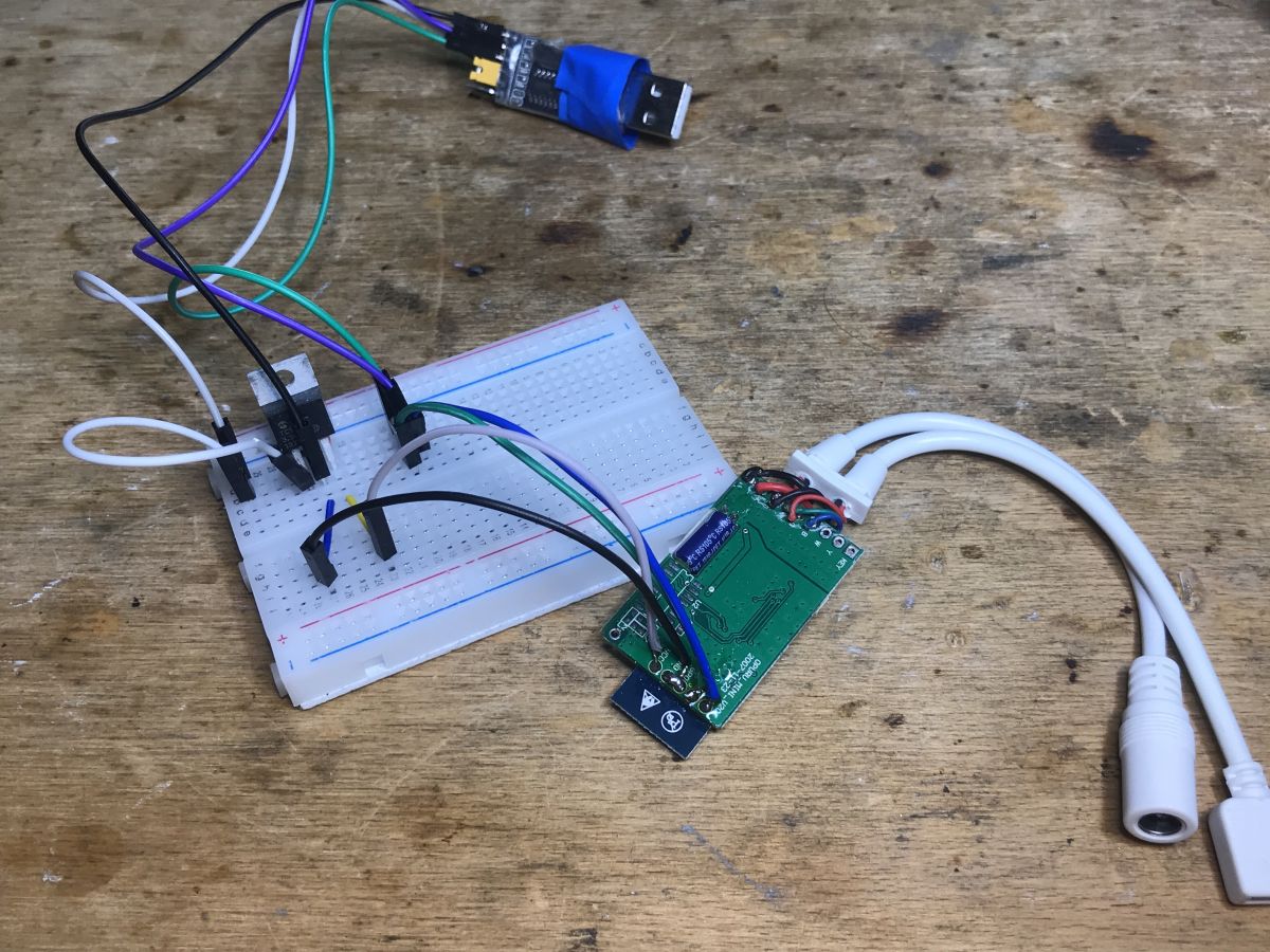

    I tried to solder it with programming cables, as usual, I described ESP programming on the forum via esptool.py:
    All you need is a USB to UART converter, connecting RX, TX, power supply and IO0 shorted to ground (during booting) to put the ESP in bootloader mode.
    Success! Esptool recognized the system.

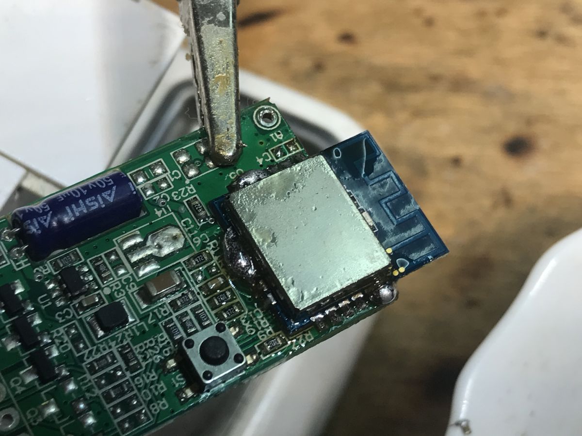

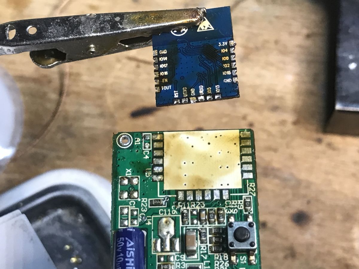

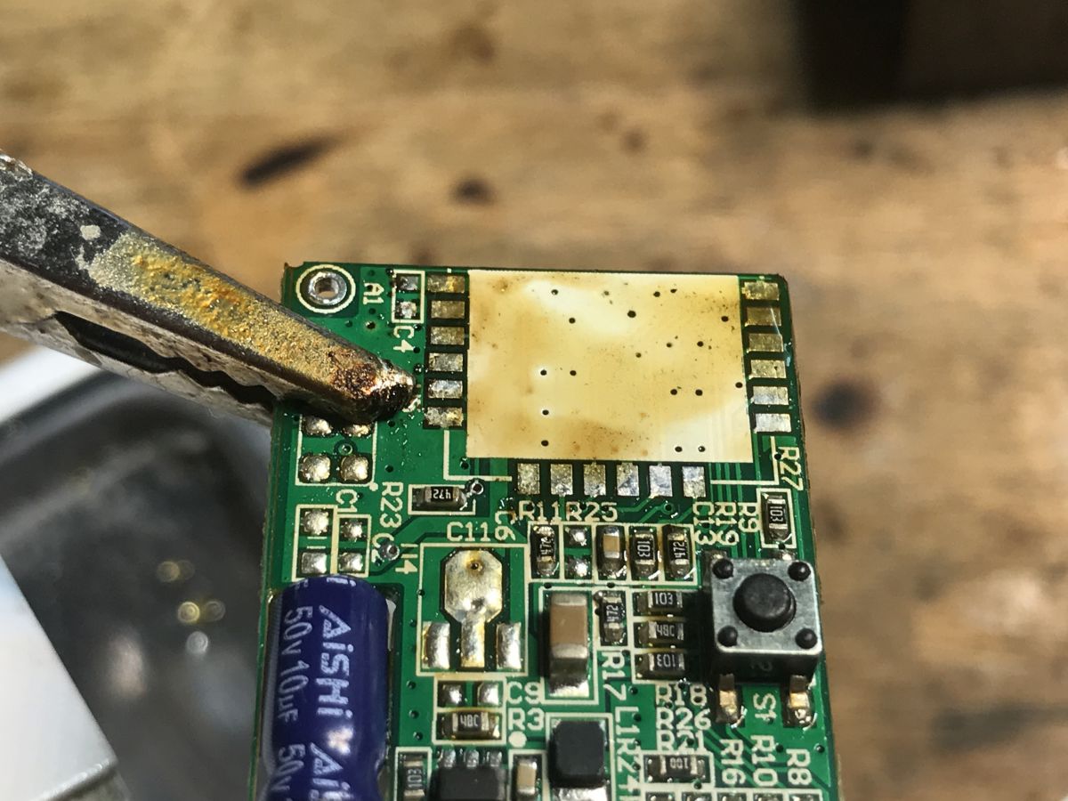

    Tasmota I managed to upload it, but the issue of the template remained... I decided to desolder the WiFi module to learn its markings. I applied additional flux and a bit of lead binder to the February:

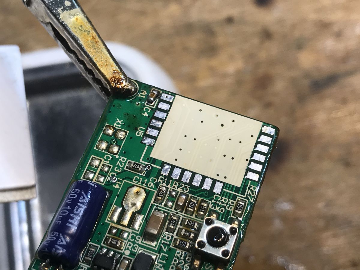

    Hot air moves and after a while we have a desoldered module:
    We can also see its outputs, they are signed on the descriptive layer:
    This allowed us to identify the module - after all, it is LM1, its pins are documented on the network:
    WiFi Module LM1 and Pinout Diagram

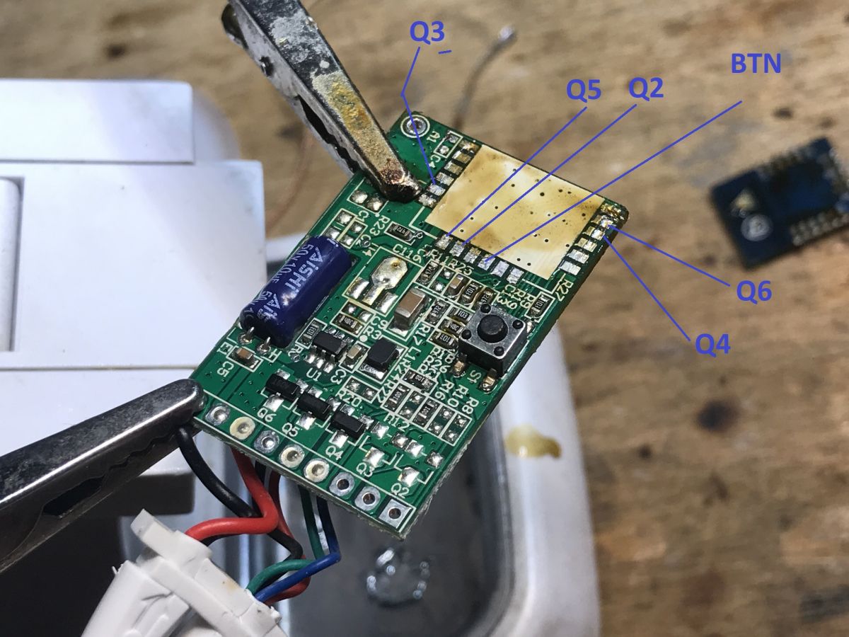

    I also did a short analysis - where the path leads.
    As you can see, this analysis will also be useful for the RGBCW version. I described all five transistors:
    - Q2 - IO5 (not soldered on this board)
    - Q3 - IO15 (not soldered on this board)
    - Q4 - IO12
    - Q5 - IO13
    - Q6 - IO14
    Additionally, I also mapped the button, but it seems to me that it is not marked correctly in the photo. If I find a moment, I will check the configuration of the bar and update the topic, and if not, you can try to trace the paths.
    Finally, a nice photo taken before soldering the WiFi module into place (pads cleaned):
