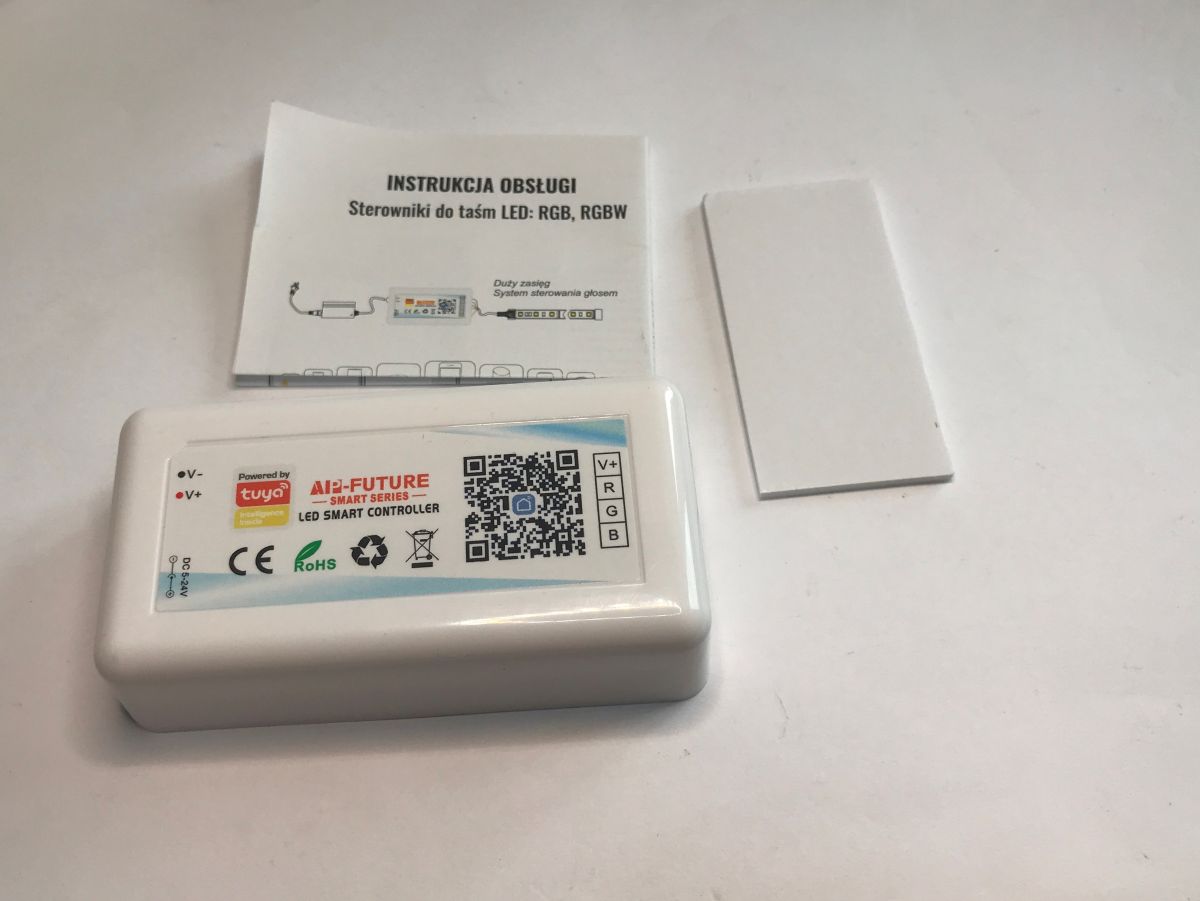

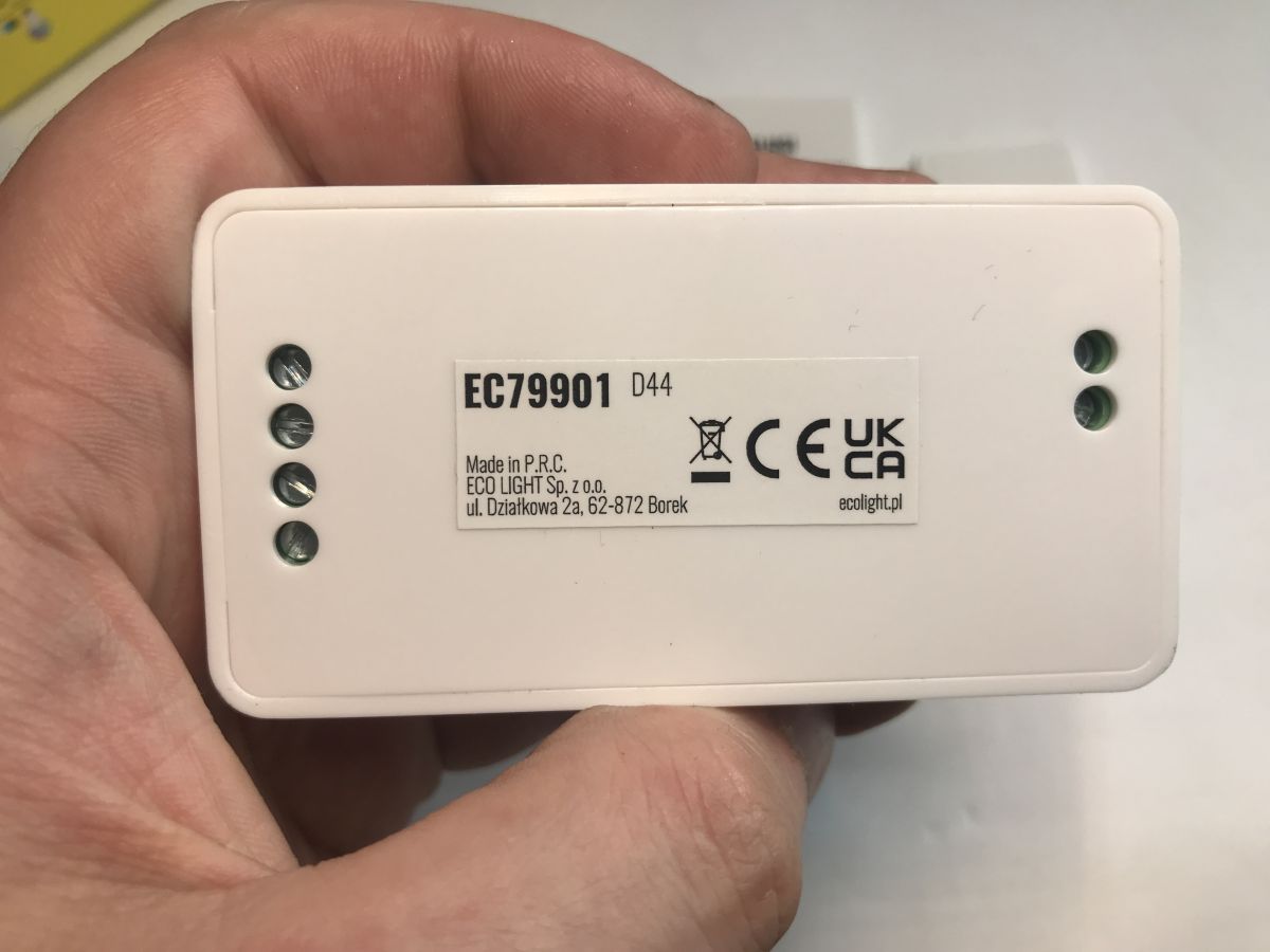

    So let's start with the kit's markings and contents. The manufacturer promises 12-24V DC operation at up to 15A.
    LED Smart Controller package with two QR codes for Tuya and Smart Life apps Tuya EC79901 LED controller box with EcoLight branding and technical specifications .
    A double-sided adhesive strip for mounting the controller is included.
    Tuya LED controller, instruction manual, and mounting tape on white surface LED controller EC79901 held in hand, label with CE and UKCA certifications visible .
    The manual is in Polish and English:

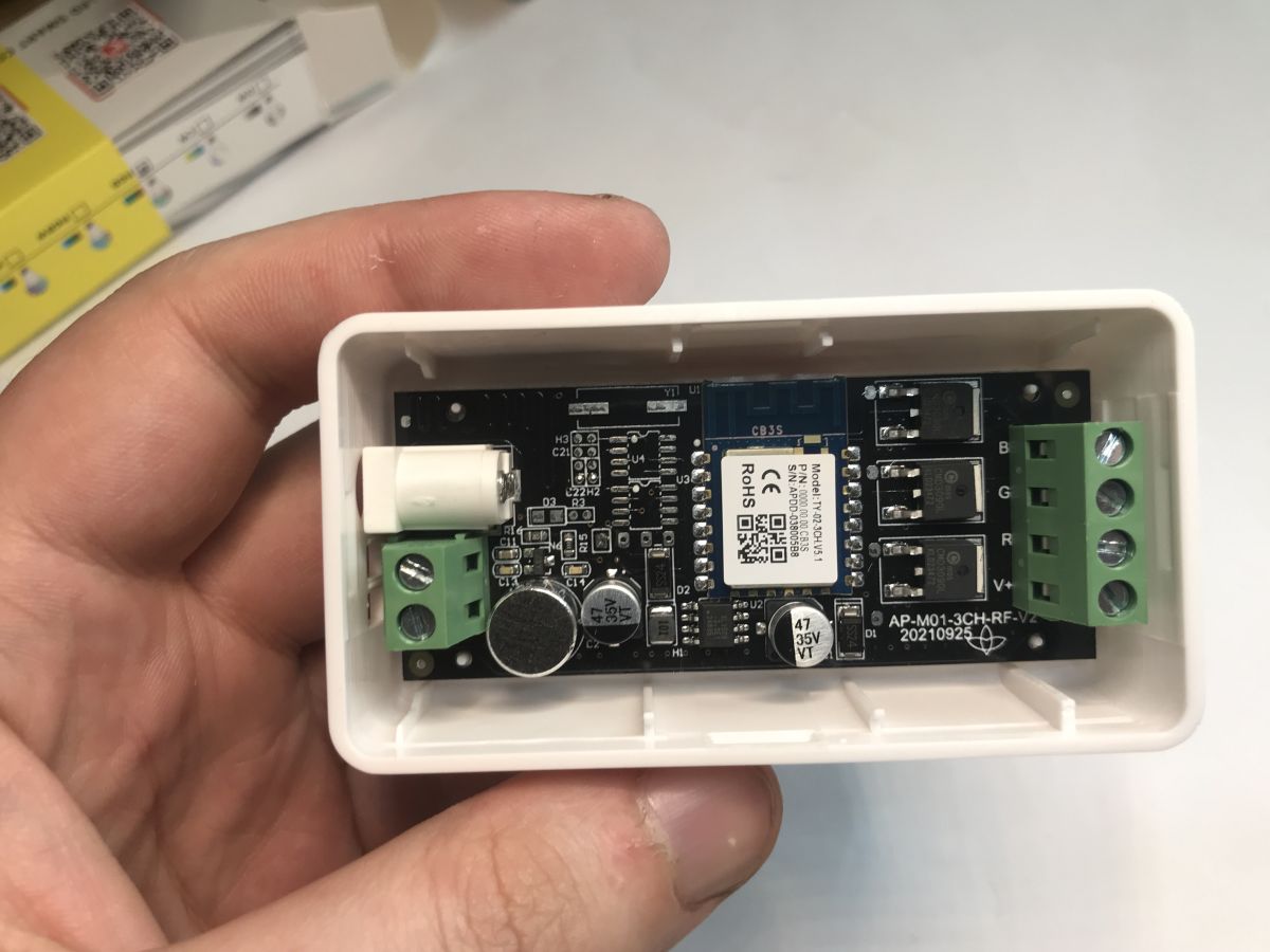

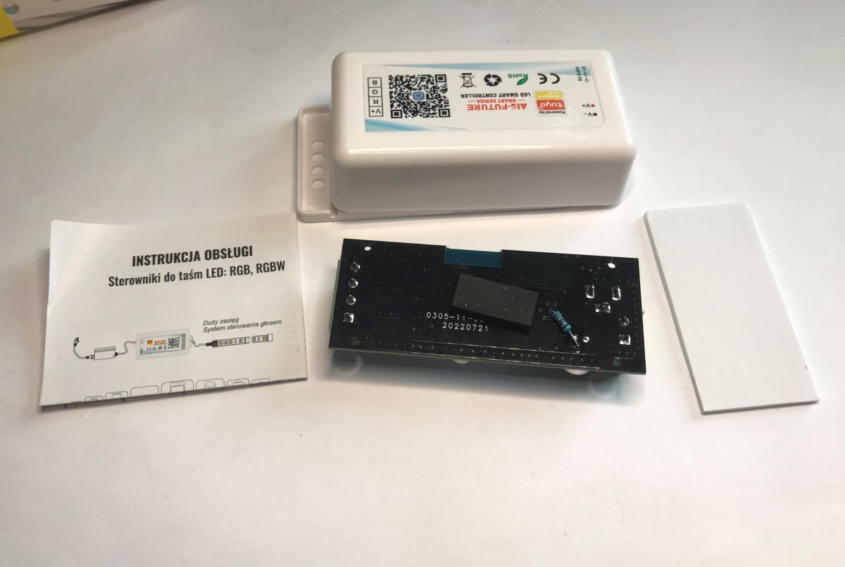

    The case is snap-on, it's easy to look inside.
    EC79901 LED controller with open casing showing internal components RGB LED controller with opened case, PCB board and user manual visible .

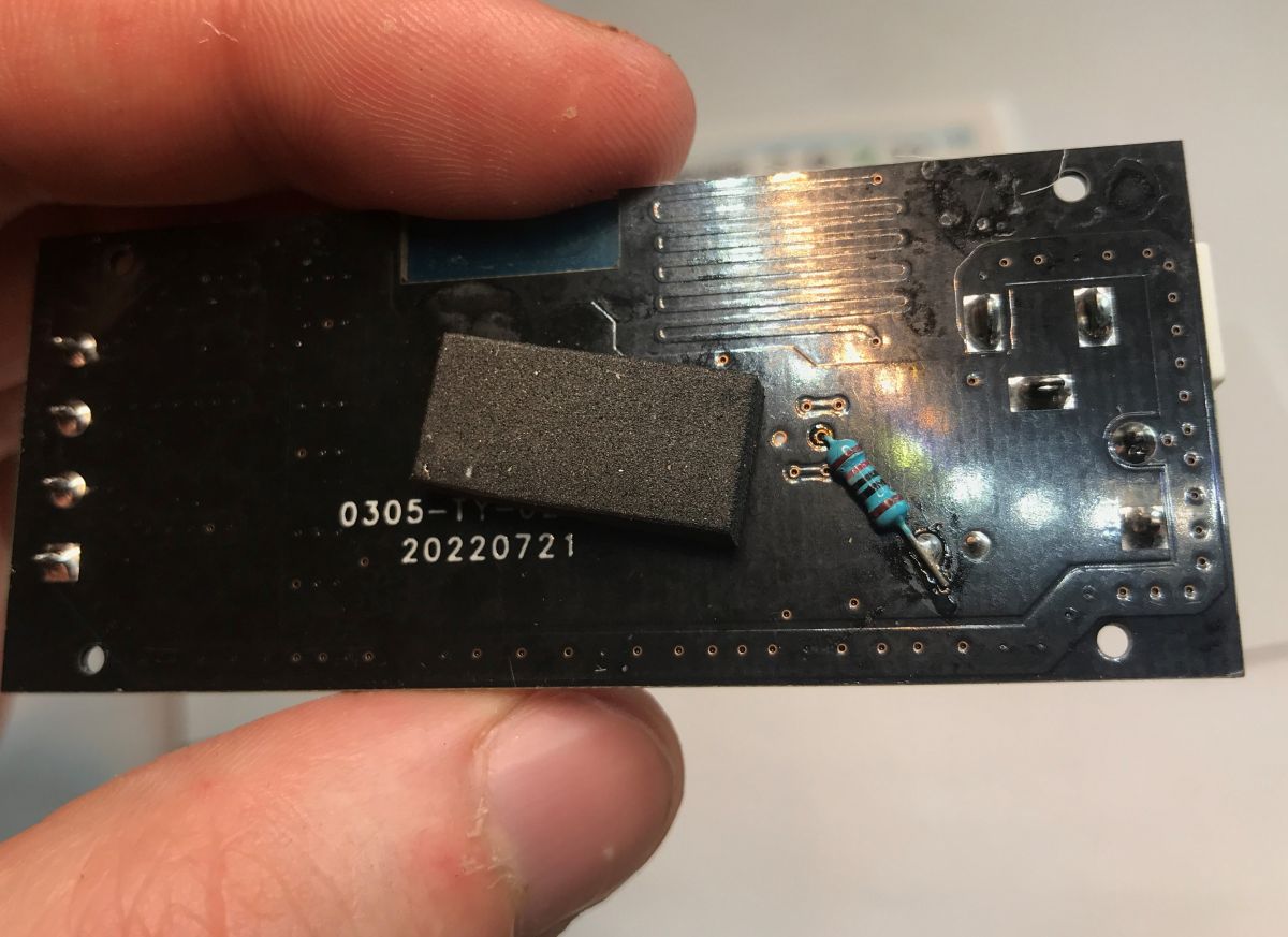

    The first thing that caught my eye was that through-hole resistor - could it be some quick fixes at the factory?
    Close-up of an LED controller PCB with a manually soldered through-hole resistor .

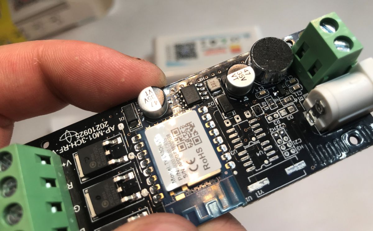

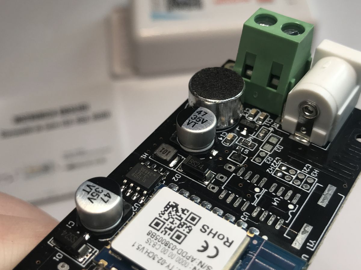

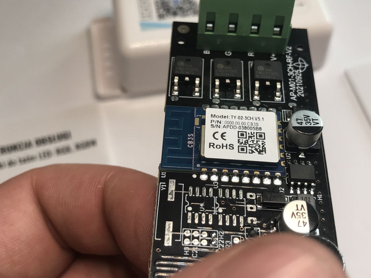

    The construction of the controller is fairly typical. Inside we have a step-down inverter converting these 12V inputs to 3.3V for the WiFi module. I can also see a microphone nearby.
    Close-up of LED controller PCB with CB3S WiFi module, microphone, and power terminals EC79901 LED controller board with CB3S WiFi module and screw terminals visible .

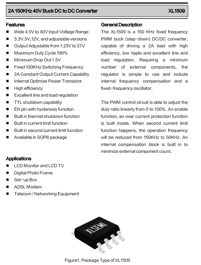

    The inverter used here is the XL1509 3.3 - as the name suggests, 3.3V:
    Technical datasheet of XL1509 buck converter with features and applications .

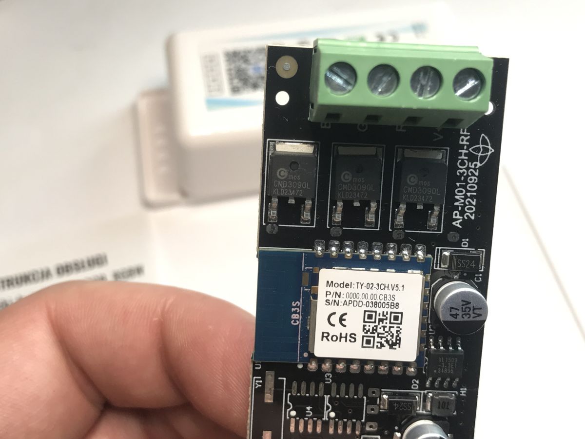

    The WiFi module itself is CB3S - you can upload a Polish OpenBeken .
    Close-up of CB3S WiFi module on EC79901 LED controller board .
    PCB designation: AP-M01-3CH-RF-V2 20210925 This RF stands for radio communication, which is not implemented here - the PCB lacks radio components.
    The transistors remain:
    LED controller module labeled AP-M01-3CH-RF with CB3S WiFi module visible .

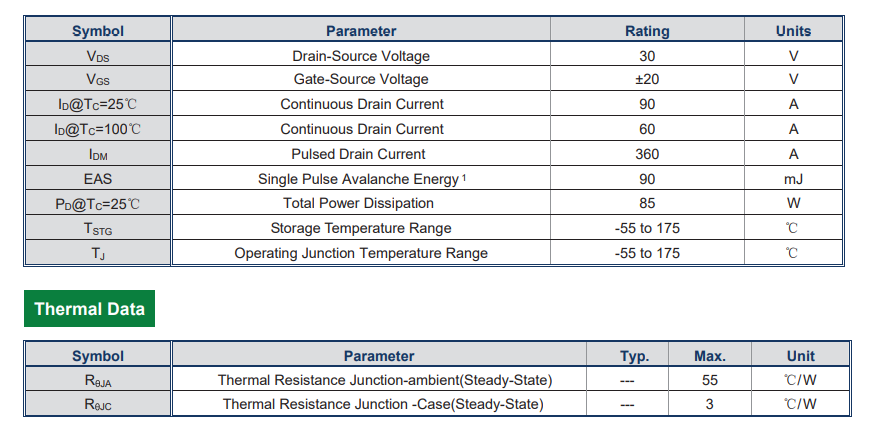

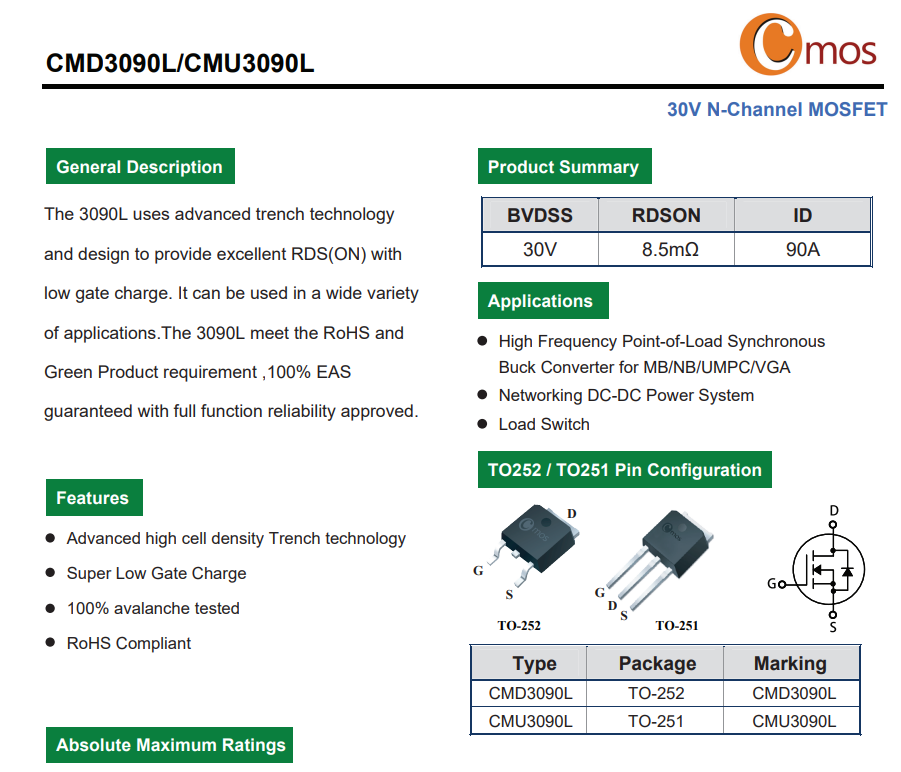

    CMD3090L, controlled directly from the GPIO:
    Datasheet for N-channel MOSFET CMD3090L/CMU3090L with specs and pin layout .
    Table of MOSFET CMD3090L electrical and thermal characteristics. .
    These are indeed better transistors than what I usually find in such products. The drain current is also large and the resistance in the open state is small.

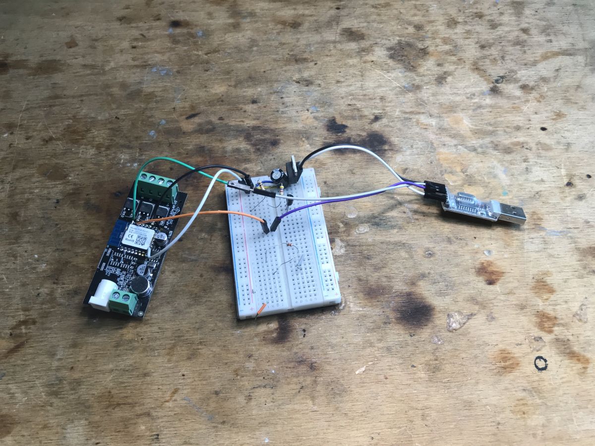

    Now it's time to change the firmware .

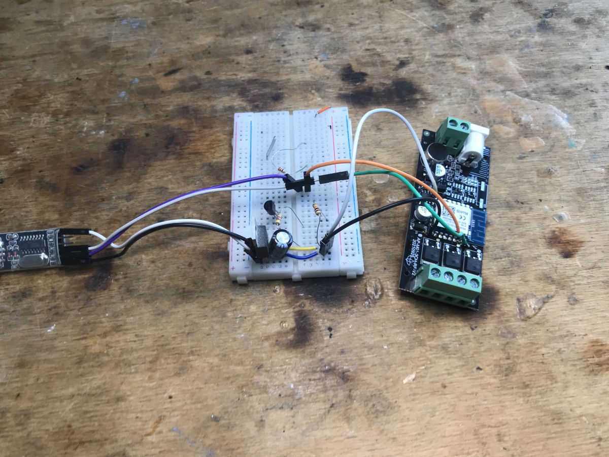

    According to our flasher's instructions, all you need is a USB to UART converter:
    I took the 3.3V from the LDO on my board, although you could just as well feed from the input from the LED strip.
    CB3S LED controller connected to breadboard with USB-UART adapter EC79901 LED controller connected to breadboard and USB-UART adapter .

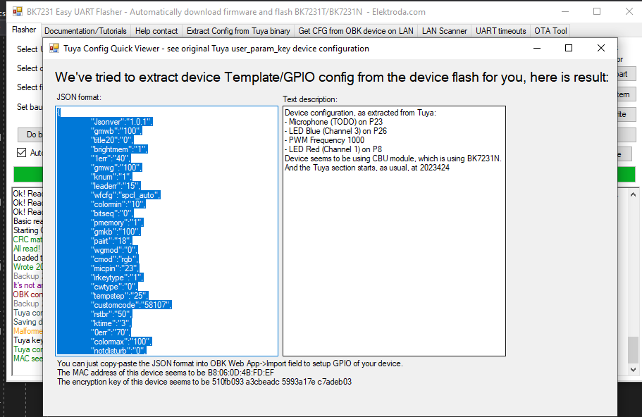

    Flasher has correctly detected the configurations:
    BK7231 Easy UART Flasher window showing GPIO config of LED controller .
    Verbal description:
    - Microphone (TODO) on P23
    - LED Blue (Channel 3) on P26
    - LED Green (Channel 2) on P24
    - PWM Frequency 1000
    - LED Red (Channel 1) on P8
    Device seems to be using CBU module, which is using BK7231N.
    It is also interesting to note that according to the JSON from Tuya, this module identifies itself as a CBU:
