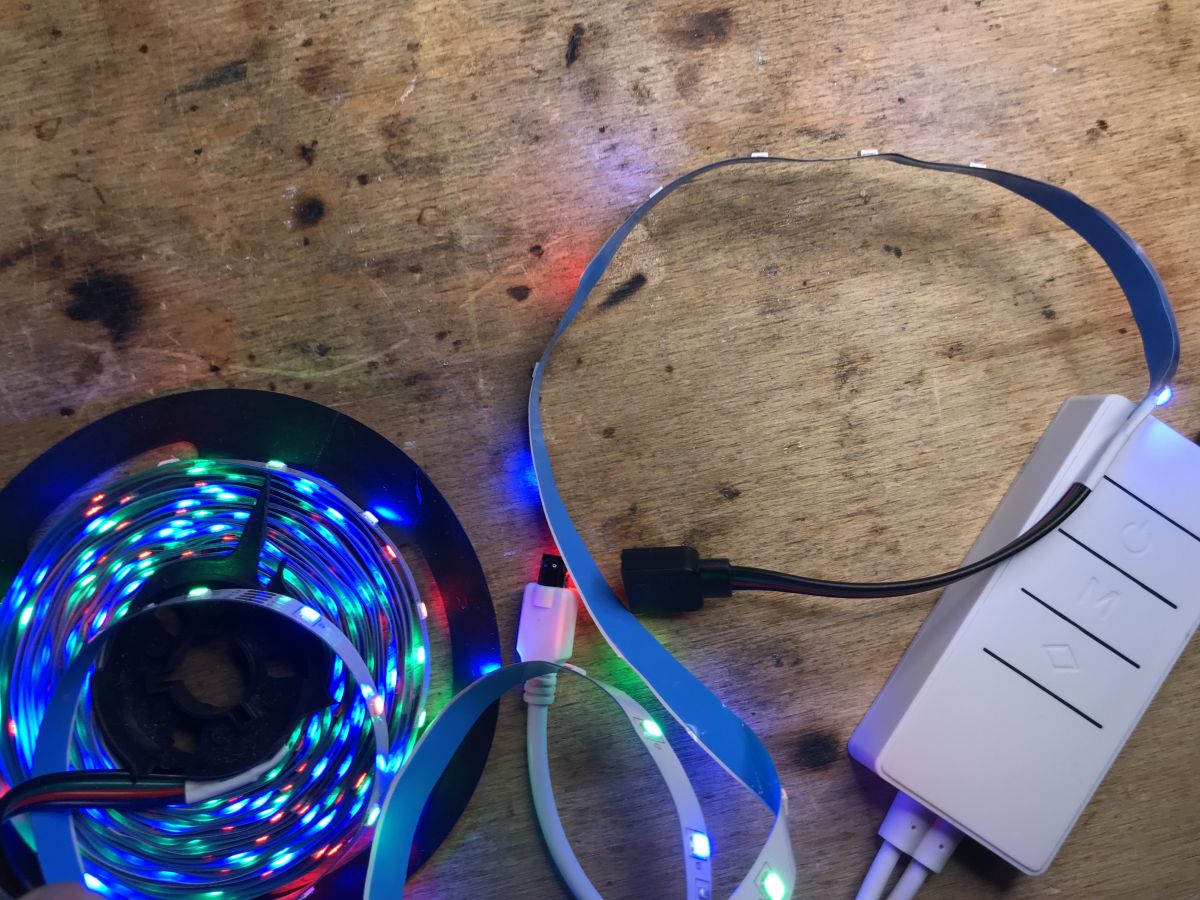

    Buying an LED strip
    I got the LED strip from one of the readers to upload the firmware and send it back to the reader (not everyone can and likes to solder well), but as far as I know, the strip is one of the most popular products in our country:
    [BK7231T] WiFi RGB LED controller with IR remote control masterLED AIP-Future TY

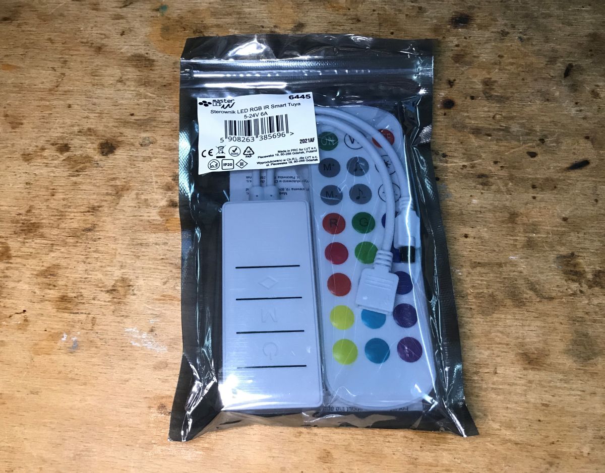

    The controller costs PLN 45. This is the RGB version. In turn, the version for one color costs PLN 40.
    NOTE: The set does not include the LED strip! The kit is quite cheap, but it's just the controller with the remote control, even without the adhesive tape to attach it.

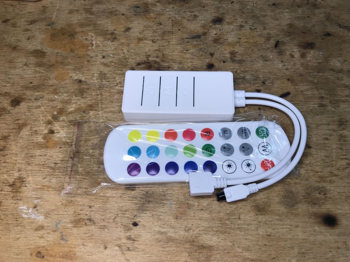

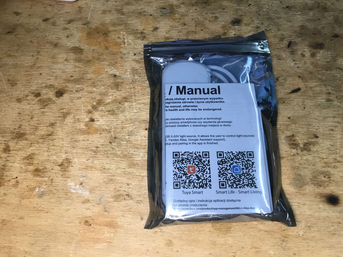

    Photo of the actually received set:
    [BK7231T] WiFi RGB LED controller with IR remote control masterLED AIP-Future TY [BK7231T] WiFi RGB LED controller with IR remote control masterLED AIP-Future TY

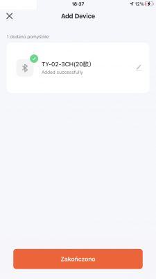

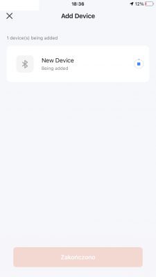

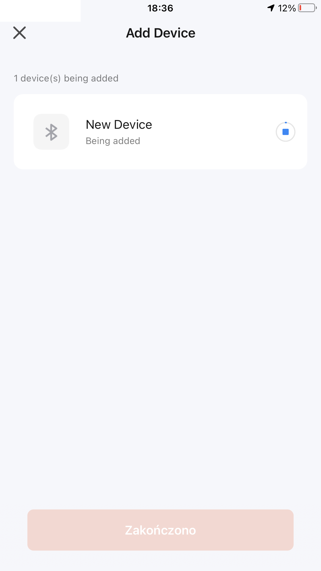

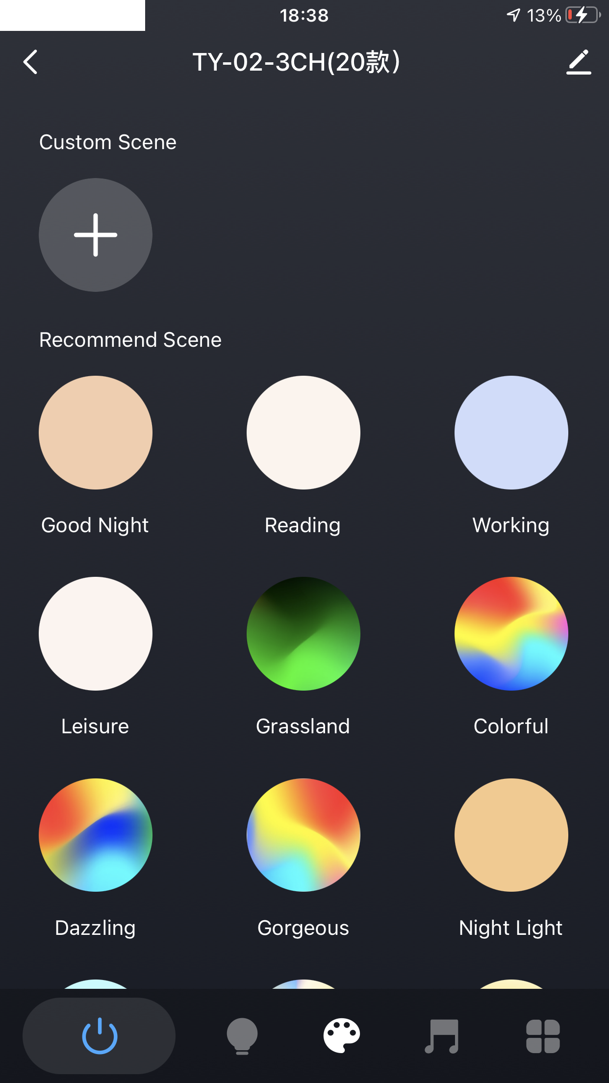

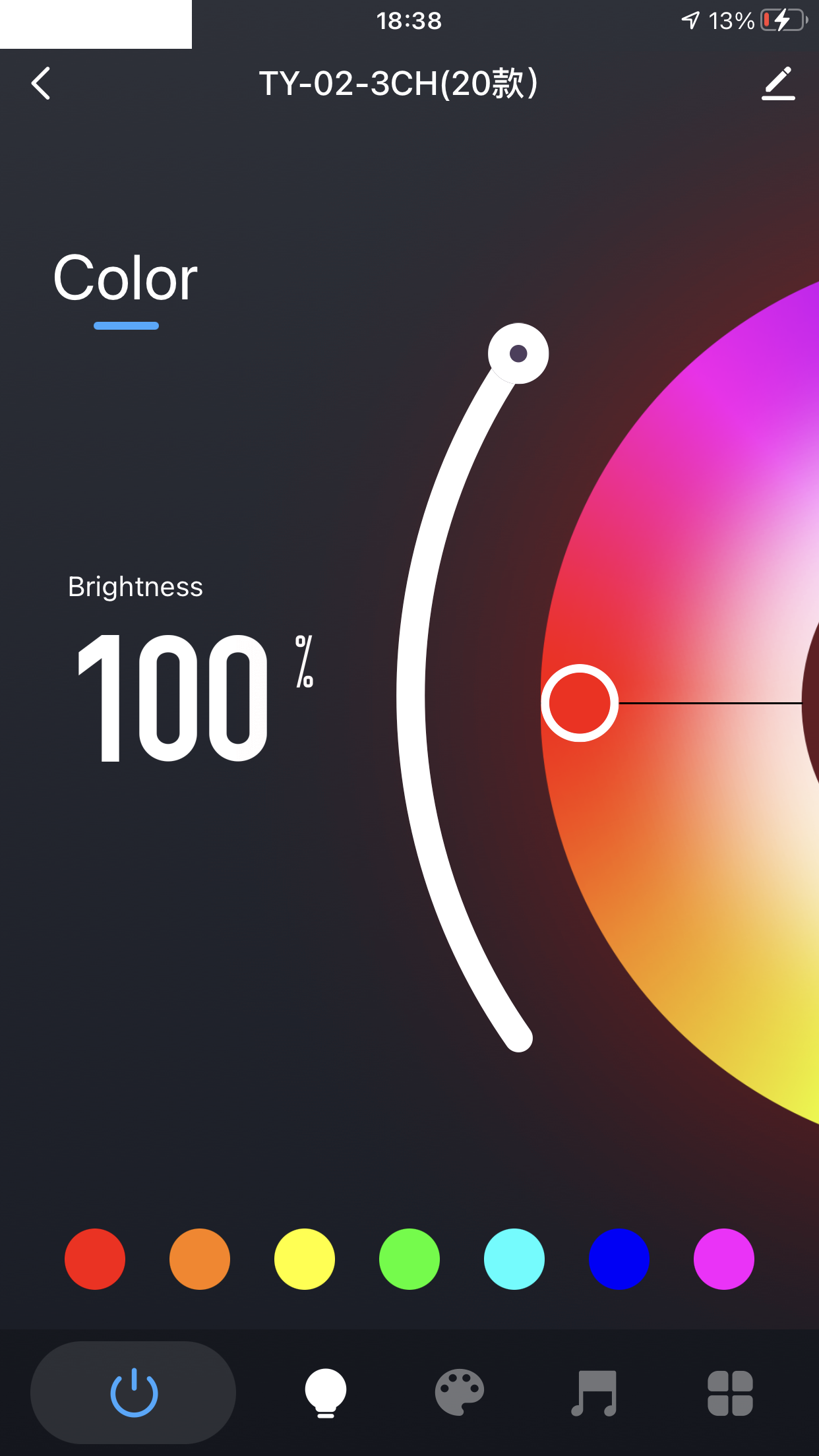

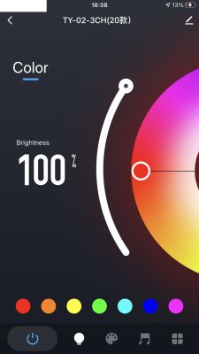

    A few screenshots from the application
    The Tuya application has been discussed many times before, so this time very briefly. The quality of the "musical" effects itself has also been criticized on the forum.
    [BK7231T] WiFi RGB LED controller with IR remote control masterLED AIP-Future TY [BK7231T] WiFi RGB LED controller with IR remote control masterLED AIP-Future TY [BK7231T] WiFi RGB LED controller with IR remote control masterLED AIP-Future TY [BK7231T] WiFi RGB LED controller with IR remote control masterLED AIP-Future TY [BK7231T] WiFi RGB LED controller with IR remote control masterLED AIP-Future TY
    Basic automations based on other devices, switches, time of day, or setting the initial state after powering up can be done on the original software, without cutting off from the cloud.

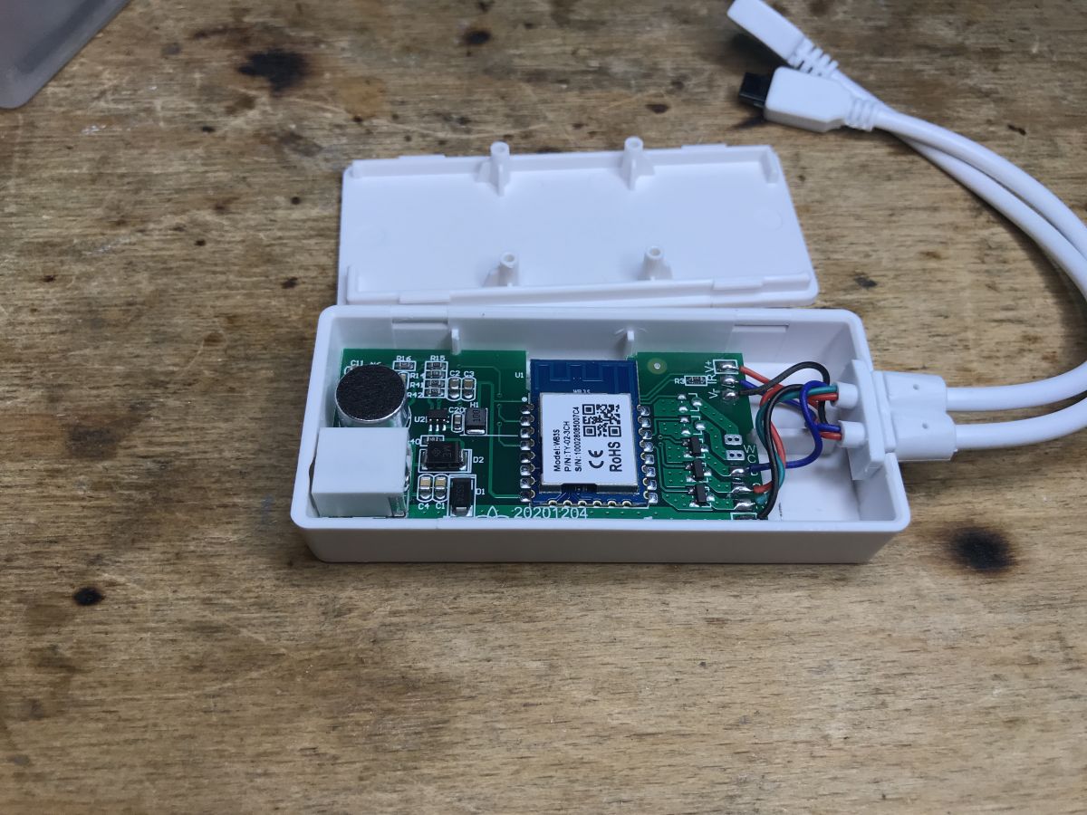

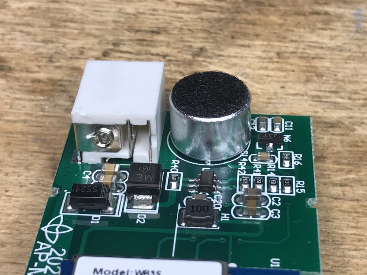

    Uploading the firmware and the basics of configuration

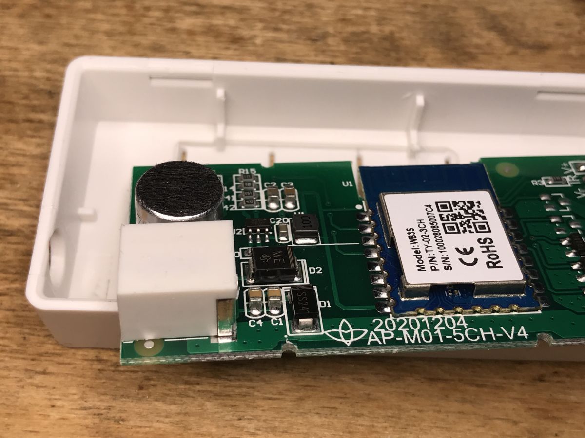

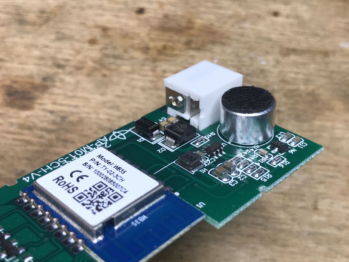

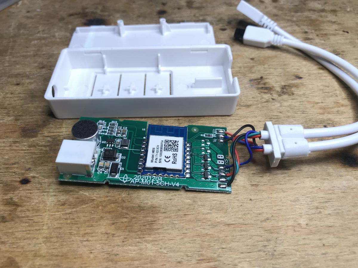

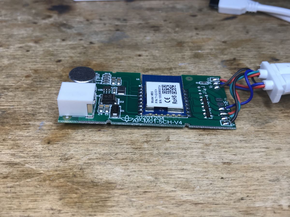

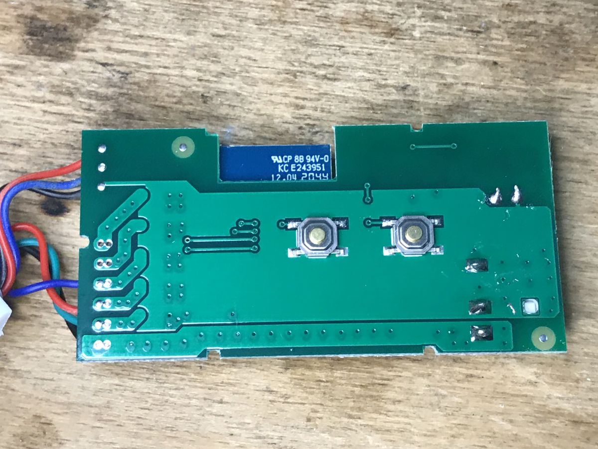

    The case is held on with a latch. It's easy to look inside.
    [BK7231T] WiFi RGB LED controller with IR remote control masterLED AIP-Future TY [BK7231T] WiFi RGB LED controller with IR remote control masterLED AIP-Future TY [BK7231T] WiFi RGB LED controller with IR remote control masterLED AIP-Future TY [BK7231T] WiFi RGB LED controller with IR remote control masterLED AIP-Future TY [BK7231T] WiFi RGB LED controller with IR remote control masterLED AIP-Future TY [BK7231T] WiFi RGB LED controller with IR remote control masterLED AIP-Future TY[BK7231T] WiFi RGB LED controller with IR remote control masterLED AIP-Future TY [BK7231T] WiFi RGB LED controller with IR remote control masterLED AIP-Future TY [BK7231T] WiFi RGB LED controller with IR remote control masterLED AIP-Future TY [BK7231T] WiFi RGB LED controller with IR remote control masterLED AIP-Future TY

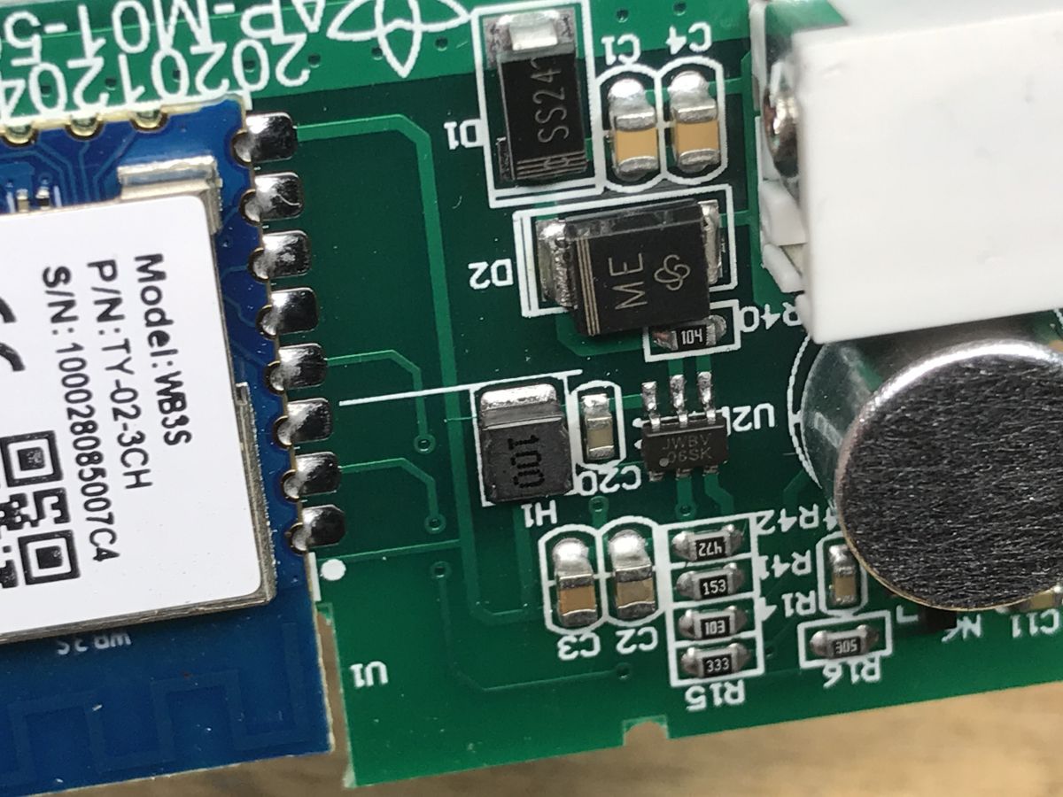

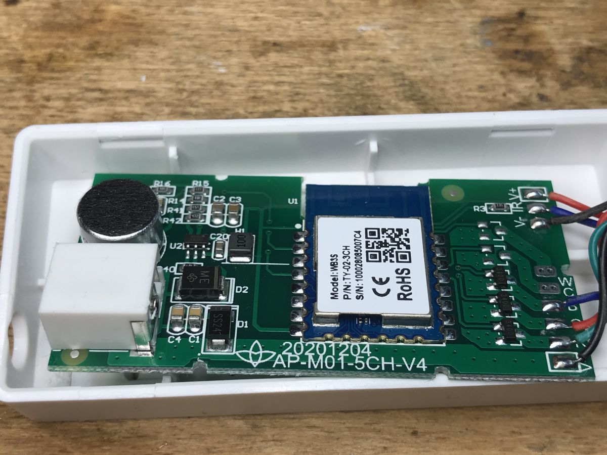

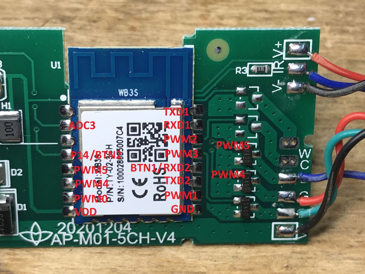

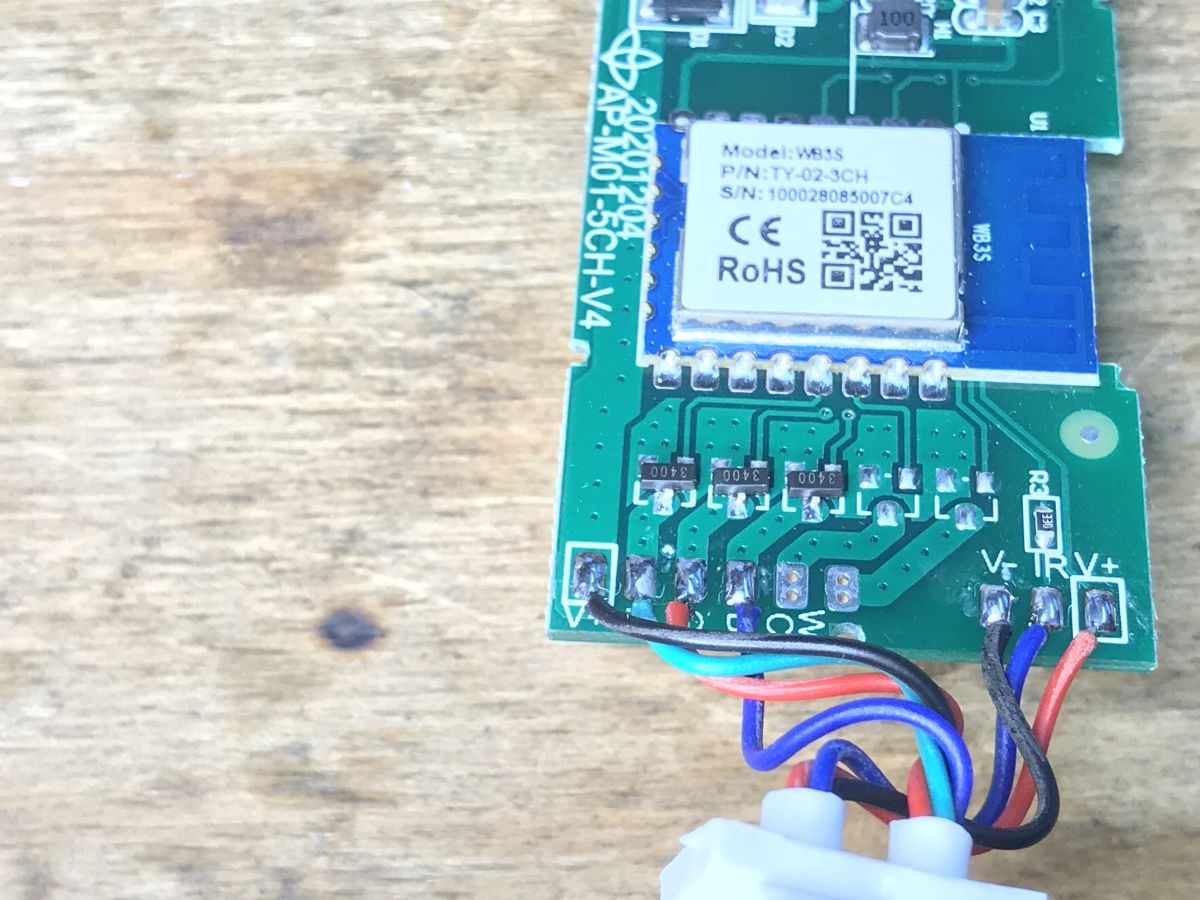

    And most importantly - the list of connections:
    We have here:
    - PWM5 - Blue
    - PWM4 - Green
    - PWM3 - Red
    - PWM2 - Cool (not used here)
    - PWM0 - Warm (not used here)
    - RXD2 - first button
    - P14 - second button
    - ADC3 - microphone
    We have two buttons here. One can be from power on/off, i.e. the usual role of Button in OpenBeken, and the other can be assigned the role of Button_NextColor (to switch colors) or Button_NextDimmer (to control brightness). We can also assign Button_NextDimmer to one and Button_NextColor to the other, and then additionally script one of them so that a double click switches the bar's power supply. The possibilities are great. How to add a button handler event? An example will be in the next paragraph.

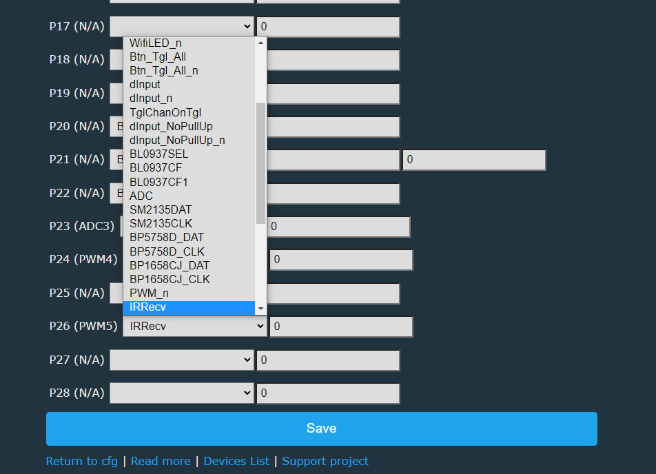

    IR configuration in OpenBeken
    First, we set the IRRecv role for the selected pin. Then we reboot the device.

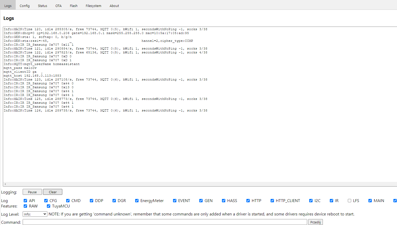

    From now on, in the logs, we will have information about the received IR signals.

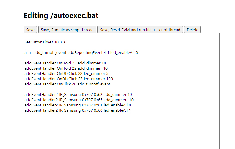

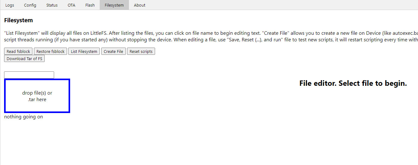

    IR codes appear to us in the console. We can save and script them - for example via autoexec.bat from the LittleFS file system:
    Sample script:
    This section is about physical buttons; we are not interested now:
    addEventHandler OnHold 23 add_dimmer 10
    addEventHandler OnHold 22 add_dimmer -10
    addEventHandler OnDblClick 22 led_dimmer 5
    addEventHandler OnDblClick 23 led_dimmer 100
    addEventHandler OnClick 20 add_turnoff_event
    This section is more important:
    addEventHandler2 IR_Samsung 0x707 0x62 add_dimmer 10
    addEventHandler2 IR_Samsung 0x707 0x65 add_dimmer -10
    addEventHandler2 IR_Samsung 0x707 0x61 led_enableAll 0
    addEventHandler2 IR_Samsung 0x707 0x60 led_enableAll 1
    addEventHandler2 adds an event handler with two arguments. The name of the event is IR + the name of the IR protocol received by the receiver, the first argument is the device address, and the second is the button code. Then we give the command.
