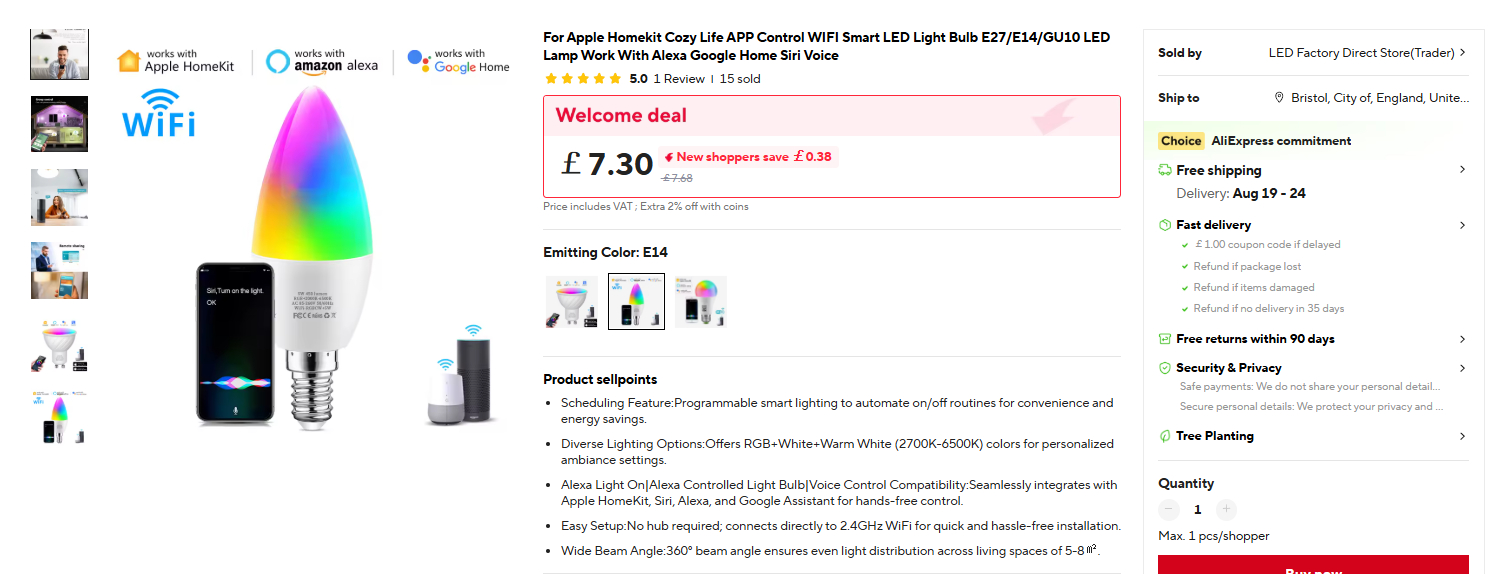

Quick look at an Aiyato CozyLife Homekit bulb I bought in November 2024 and forgot about. https://www.aliexpress.com/item/1005006367930047.html
Aiyato CozyLife RGB+CW E14 LED bulb with WiFi control and HomeKit support

jarekgol 13 Aug 2025 23:35
Link to ali does not work, 404 [Read more]
divadiow 14 Aug 2025 08:00
works for me. try searching for product code 1005006367930047 in your Ali [Read more]
