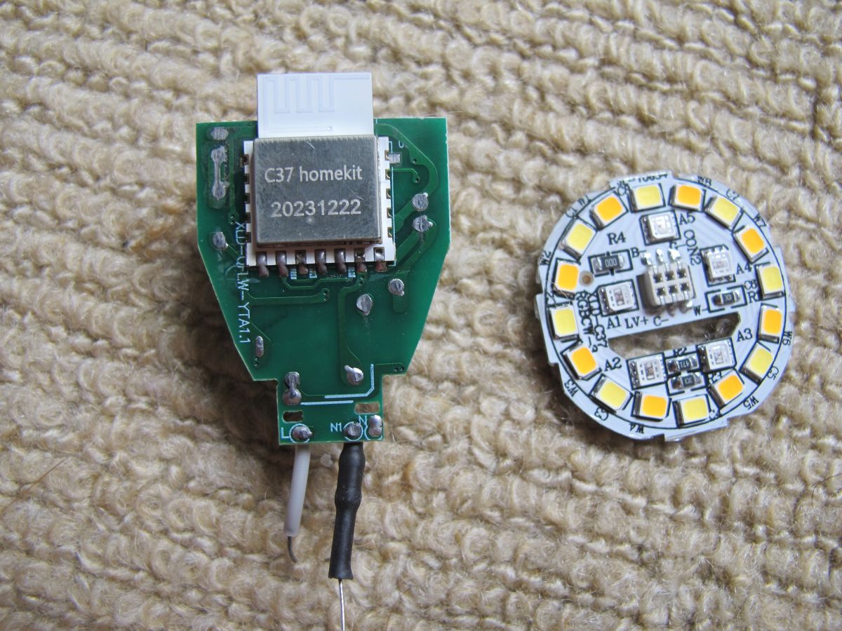

  • Aiyato E14 CozyLife HomeKit RGBCW LED bulb uses a C37 HomeKit module built around an ESP8684H2 on a DOIT ESPC2-05 board.
  • The module was de-canned to confirm the chip, then probed through TX0 at 74880 baud and with IO9 low for esptool chip info.
  • The bulb carries 2 MB flash, and a flash backup was loaded into OpenESP32C2 for testing.
  • Like other Aiyato/CozyLife ESP devices, it has no flash encryption or secure boot, and GPIO PWM channels were quickly identified.

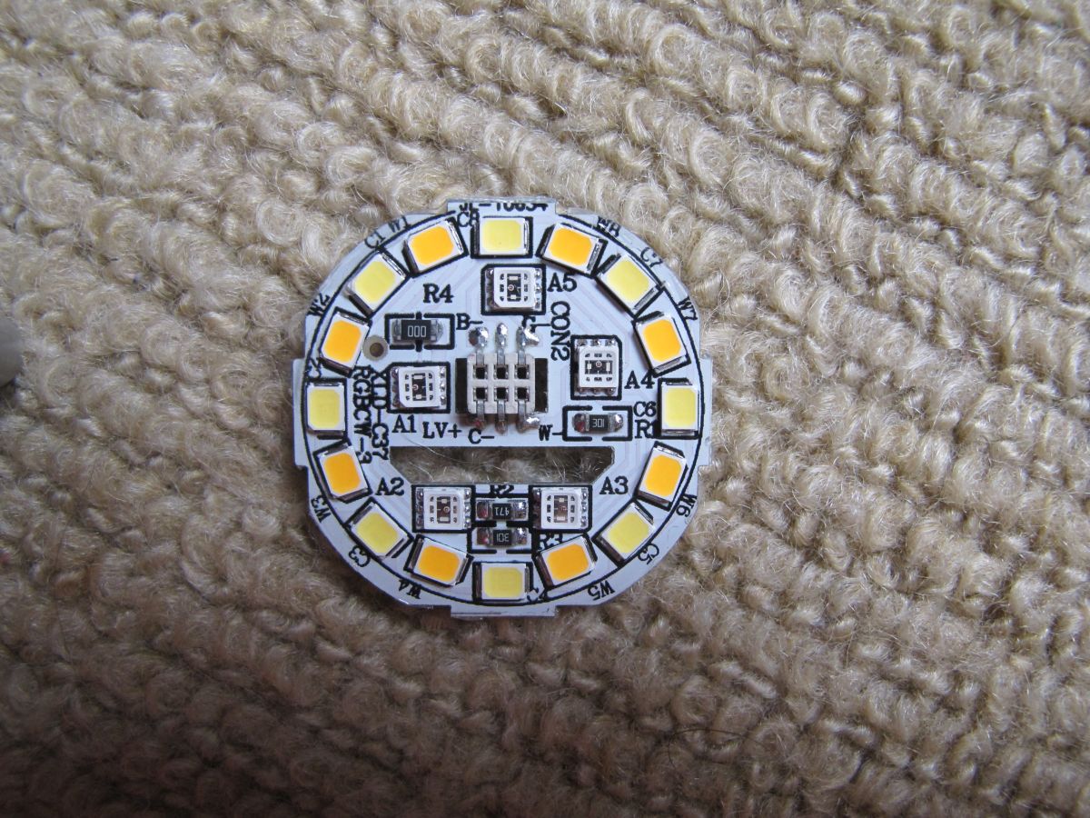

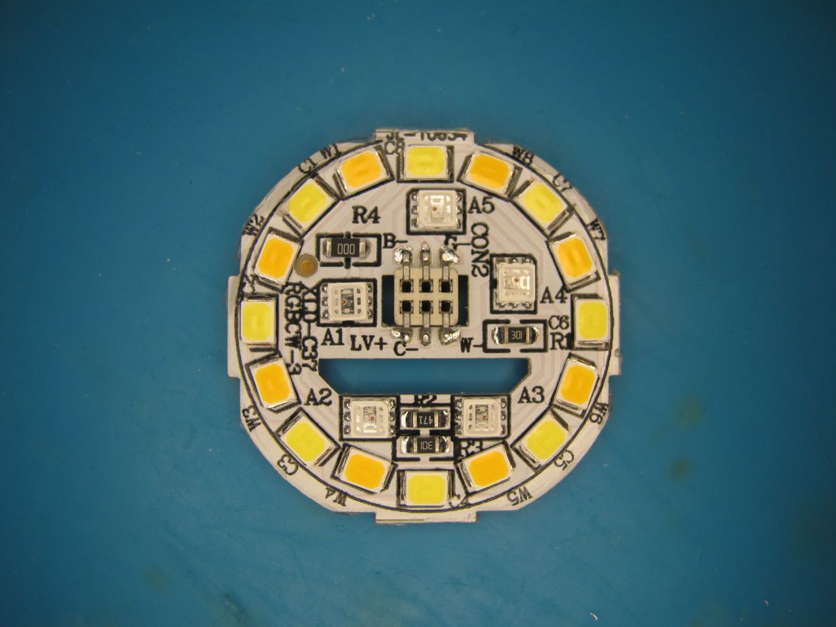

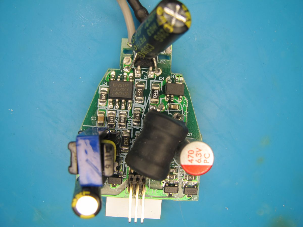

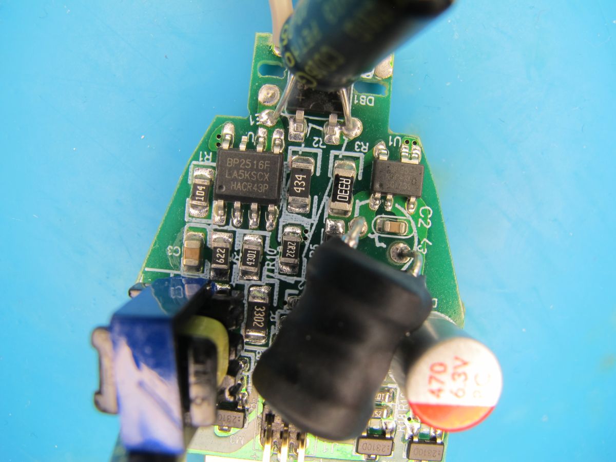

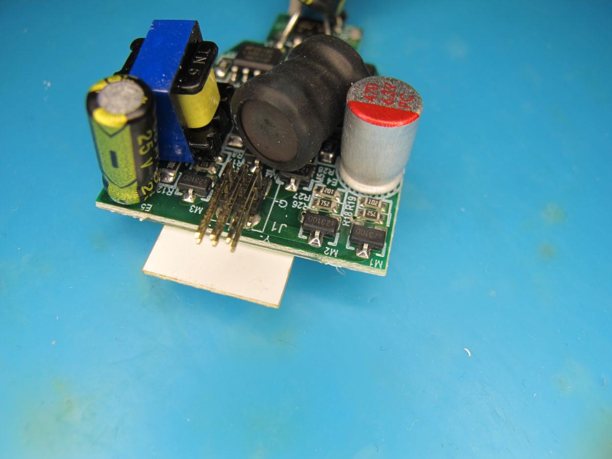

    AIYATO E14 5W RGB+2700~6500K bulb with technical specs printed on casing Candle-style E14 LED bulb with QR code on white body, placed on textured carpet Disassembled C37 Homekit module and round LED board with SMD components LED light bulb PCB with labeled parts A1–A5 and surface-mounted components RGBCW LED PCB with labeled connection pins and surface LEDs on blue surface LED bulb circuit board with BP2516F chip, capacitors, coil, and surface-mounted components Close-up of LED bulb power module with capacitors, inductor, and SMD components Close-up of PCB from a smart bulb showing BP2516F chip, coil and capacitors

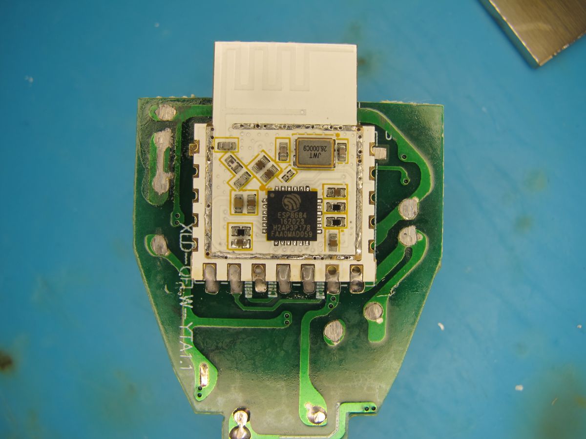

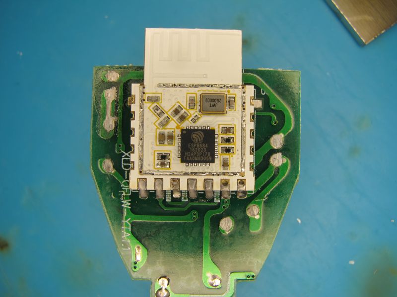

    C37 homekit module - I had to de-can it to check the chip. Couldn't see much about it Googling - ESP8684H2
    Top view of ESP8684 module on LED bulb PCB

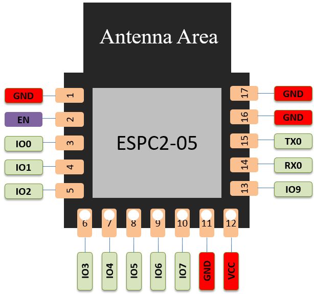

    It's a DOIT (Doctors of Intelligence & Technology) ESPC2-05 module (datasheet attached)
    Pinout diagram of ESPC2-05 module with labeled functions and antenna area
    TX0 log at 74880 baud:
    With IO9 low:
    esptool chip info
    like other Aiyato/CozyLife ESP devices, this is not flash encrypted or secure boot enabled

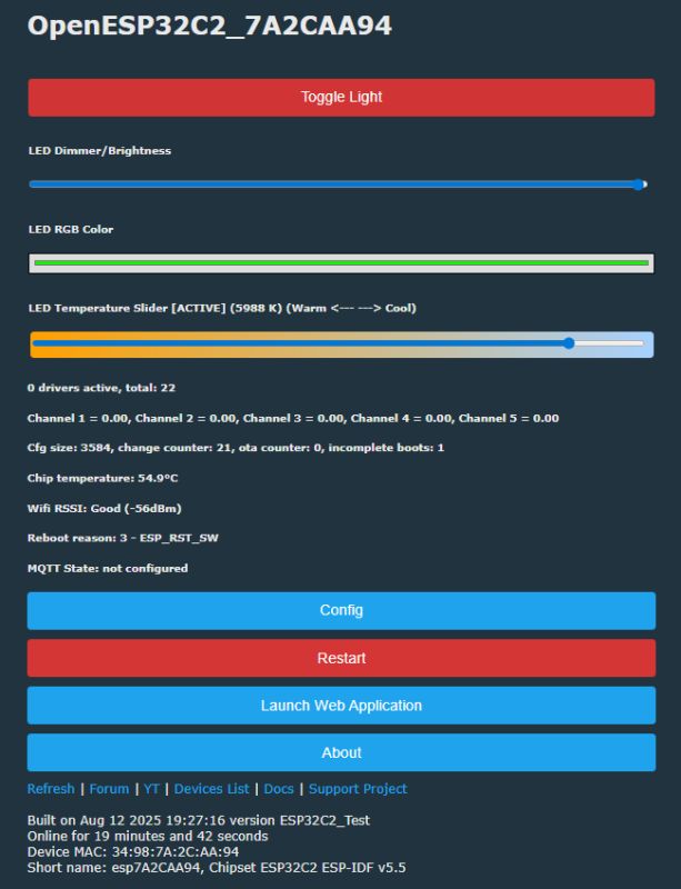

    And with GPIO Dr PWM channels are quickly identified
    Web GUI for OpenESP32C2 with LED control sliders and device diagnostic info

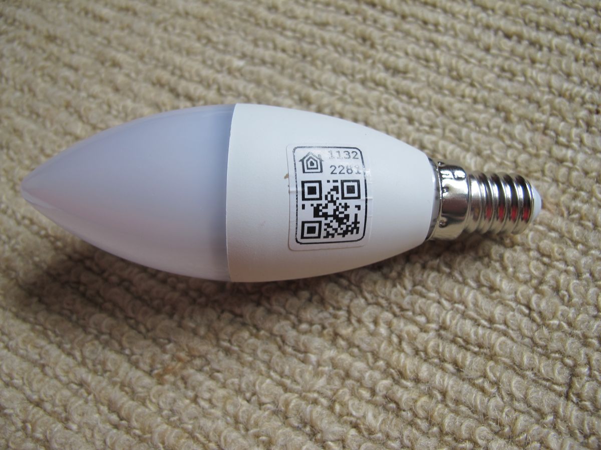

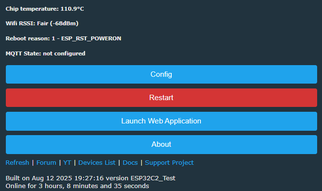

    @divadiow thank you for interesting presentation, so, ESP32 was not encrypted, since it's not a Matter device? Nice. Does it get hot quickly when on full brightness?
    toasty. this is with powersave 1
    ESP32 web interface showing 110.9°C chip temp and MQTT not configured

Which LED driver IC does this bulb use?
The PCB lists a BP2516F LED driver. The teardown photos and shared JSON mention BP2516F. This driver pairs with ESPC2‑05 to regulate RGBCW output. It supports the five PWM channels used. [Elektroda, divadiow, post #21634234]
