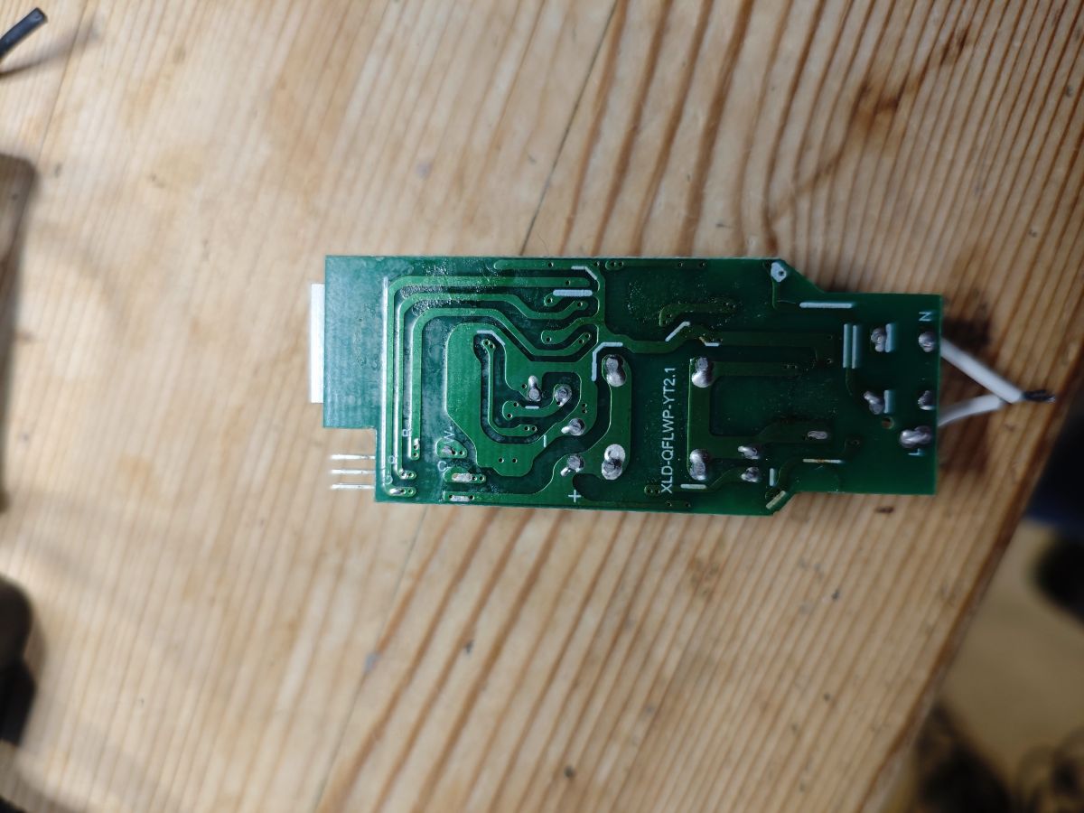

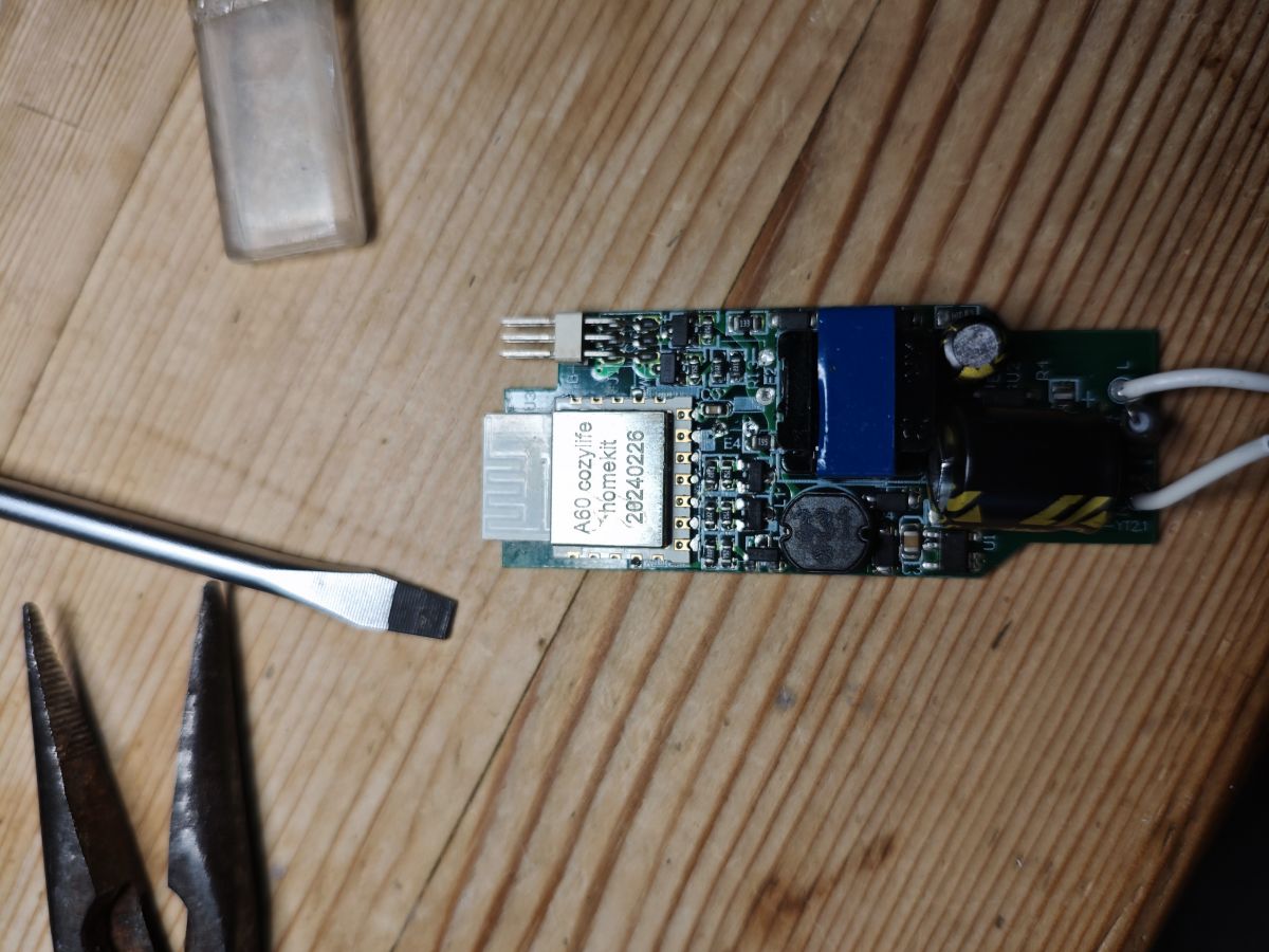

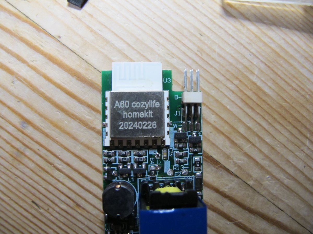

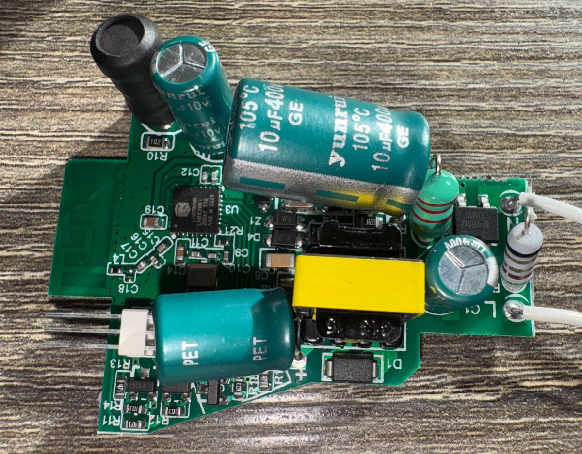

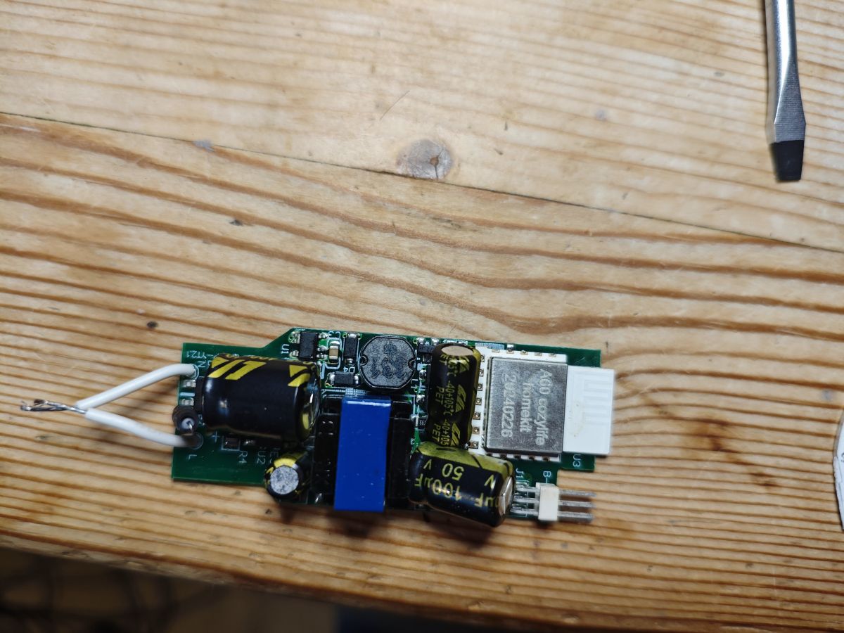

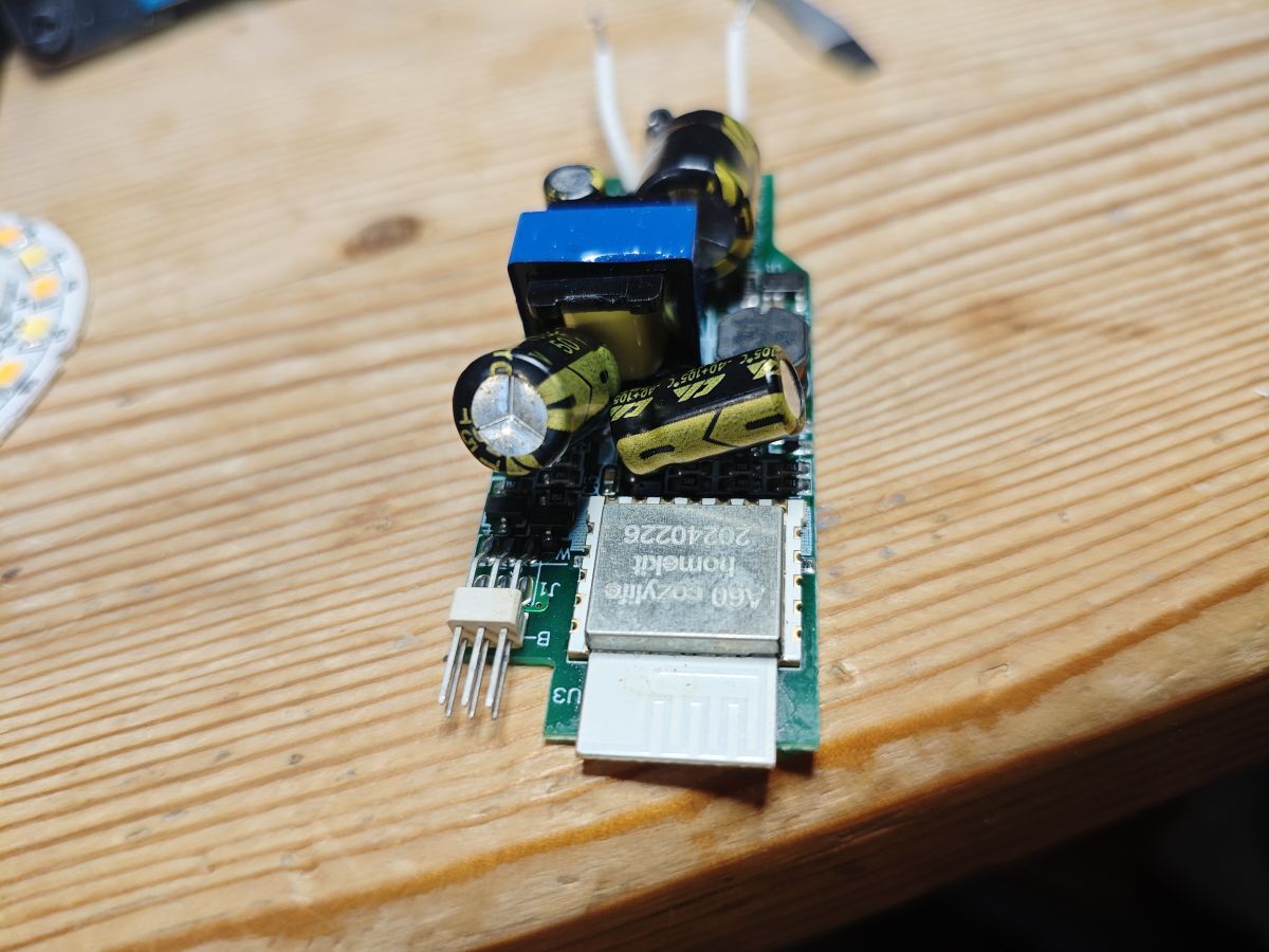

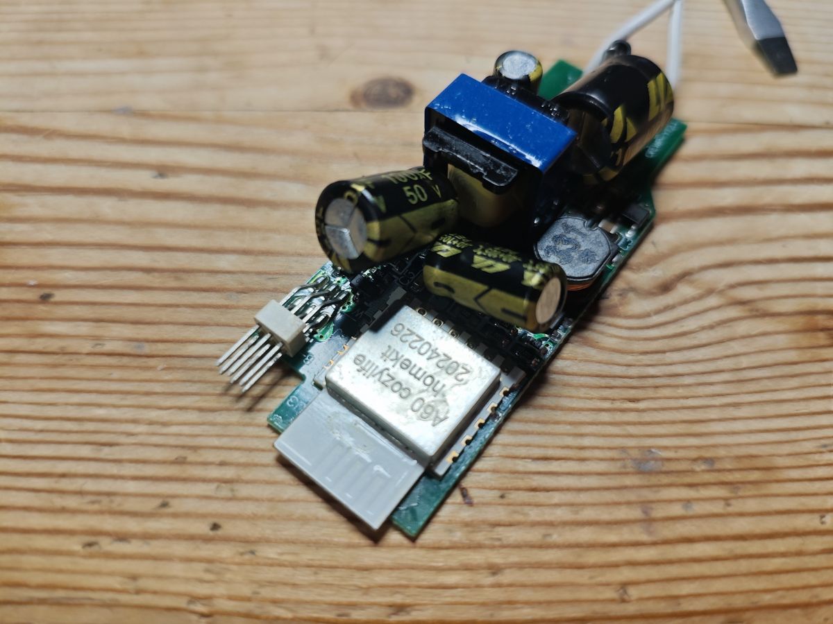

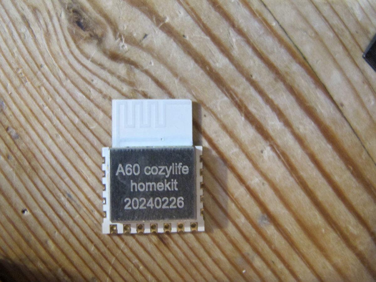

    Here's a little look at a Cozylife Homekit 9W RGBWW E27/A60 bulb. A device very similar to many others like this Corui with a BL602 based DT-BL200 module: https://www.elektroda.com/rtvforum/topic3930622.html
    This bulb, like other Cozylife Homekit (non-Tuya) IoT devices is equipped with an Espressif module - the DOIT ESPC2-05 which is pin-compatible with the DT-BL200. It got a mention by @ferbulous here https://www.elektroda.com/rtvforum/topic3930622.html#20379018 as a suggested replacement for the BL200 module.
    Now though, Tasmota is not the only option for ESP chips, so I'll try the OpenESP32C2 firmware.
    Electronic module with visible capacitors and Espressif chip on a circuit board. Cozylife Homekit 9W RGBWW E27/A60 module on a wooden table ESPC2-05 circuit board on a wooden surface Electronic module with capacitors and a chip on a wooden surface. Electronic module with components on a wooden surface. Cozylife Homekit A60 module with visible capacitors and components on a wooden background
    With the two capacitors removed the module can be de-soldered using hot air.
    Cozylife Homekit bulb module on a wooden table

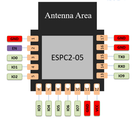

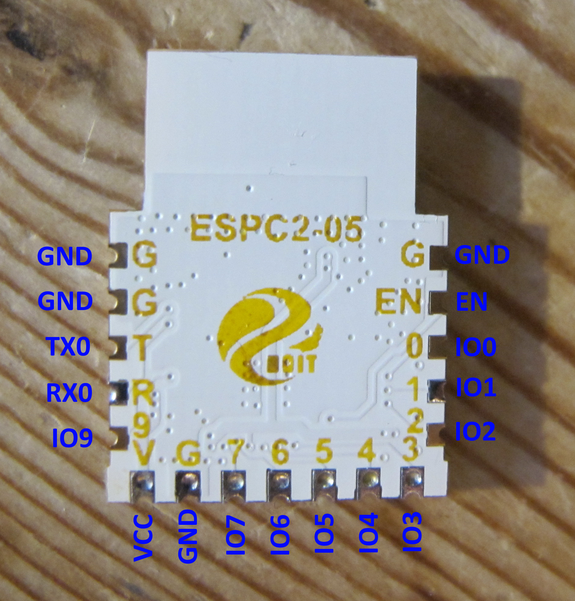

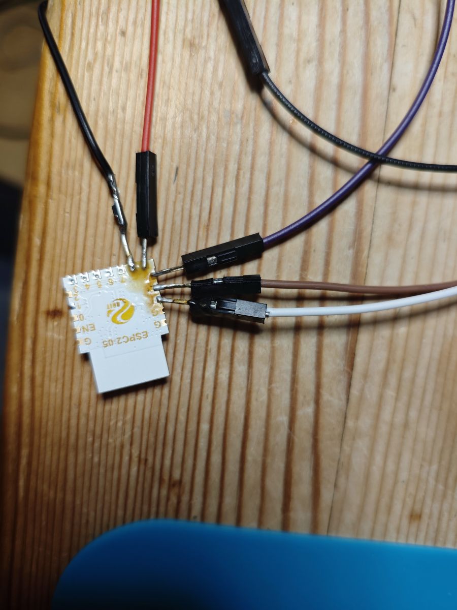

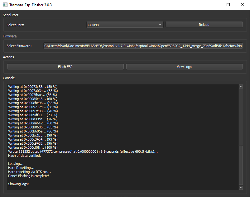

    and the VCC, GND, IO9, RX and TX soldered ready for flashing.
    Pin diagram of the ESPC2-05 module.
    ESPC2-05 module with wires soldered to the pins.
    from TX (74880 baud) on standard boot:
    with IO9 grounded
    and a confirmation of the chip using esptool.exe
    esptool.exe --port COm48 flash_id
    then a firmware backup, attached
    esptool.exe --chip esp32c2 --port COM48 --baud 115200 read_flash 0x000000 0x200000 Cozylife_A60.bin

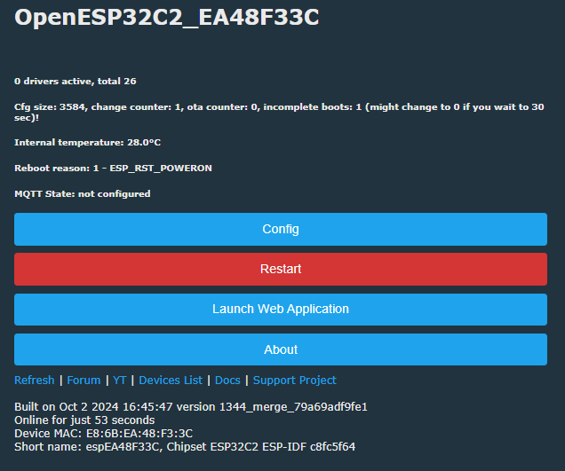

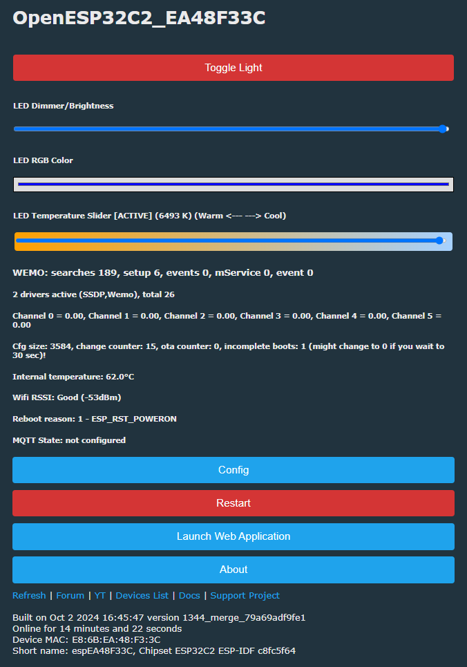

    and finally the flash to latest ESP build OpenESP32C2_1344_merge_79a69adf9fe1.factory.bin
    Tasmota-Esp-Flasher interface with ESP32-C2 flashing logs.
    Screenshot of the OpenESP32C2 interface with Cozylife device.

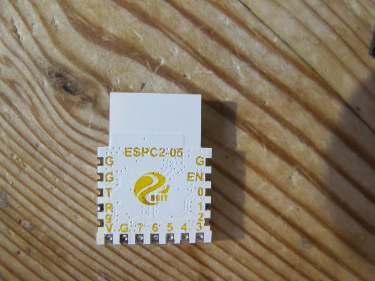

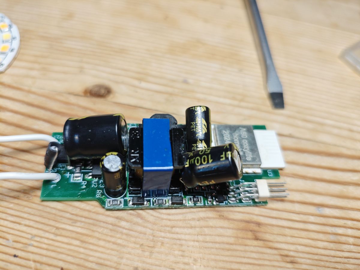

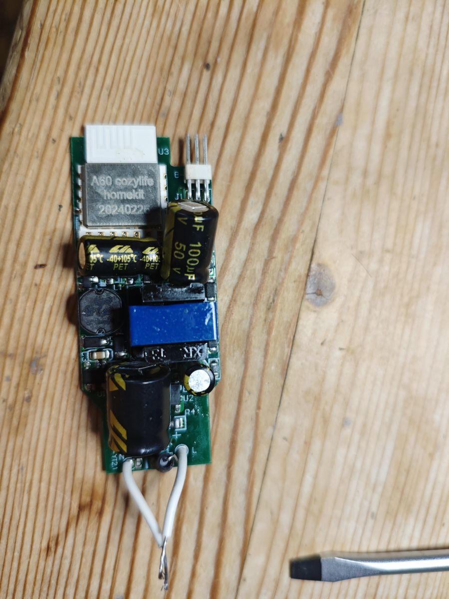

    tomorrow I'll solder it back up and find the PWM pin config for a final template. Here are some more pics of the module in the meantime
    Espressif DOIT ESPC2-05 module on a wooden background. A60 Cozylife Homekit module on a wooden surface Cozylife Homekit A60 module mounted on a circuit board.

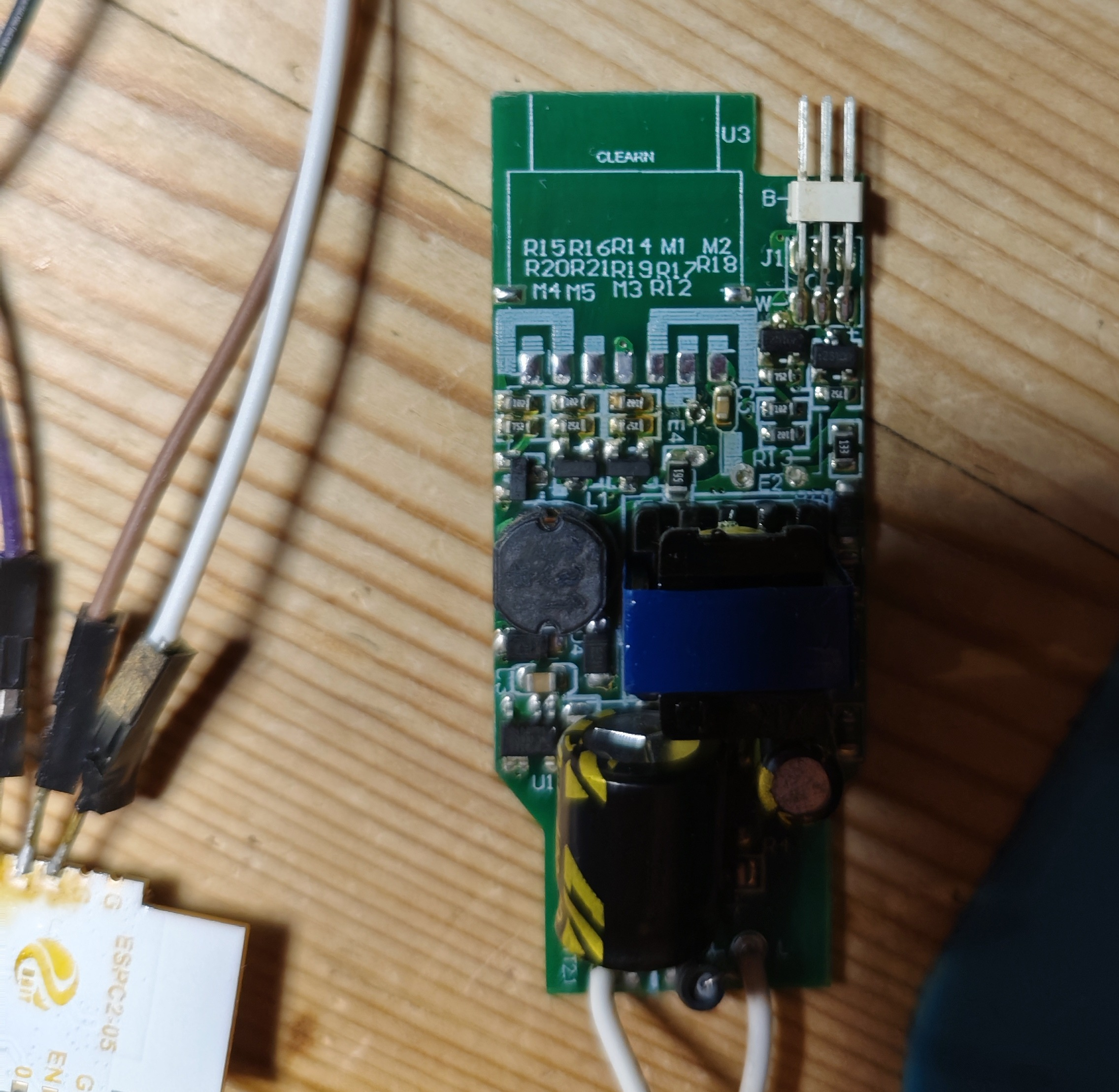

    I continued.
    Close-up of a circuit board with various electronic components and several connected wires.
    The assignments are simply the bottom row of GPIOs
    I believe the single side solder pads IO1 and RX0 are just used to hold the module in place.
    Making the template
    OpenESP32C2 web interface with LED lighting settings

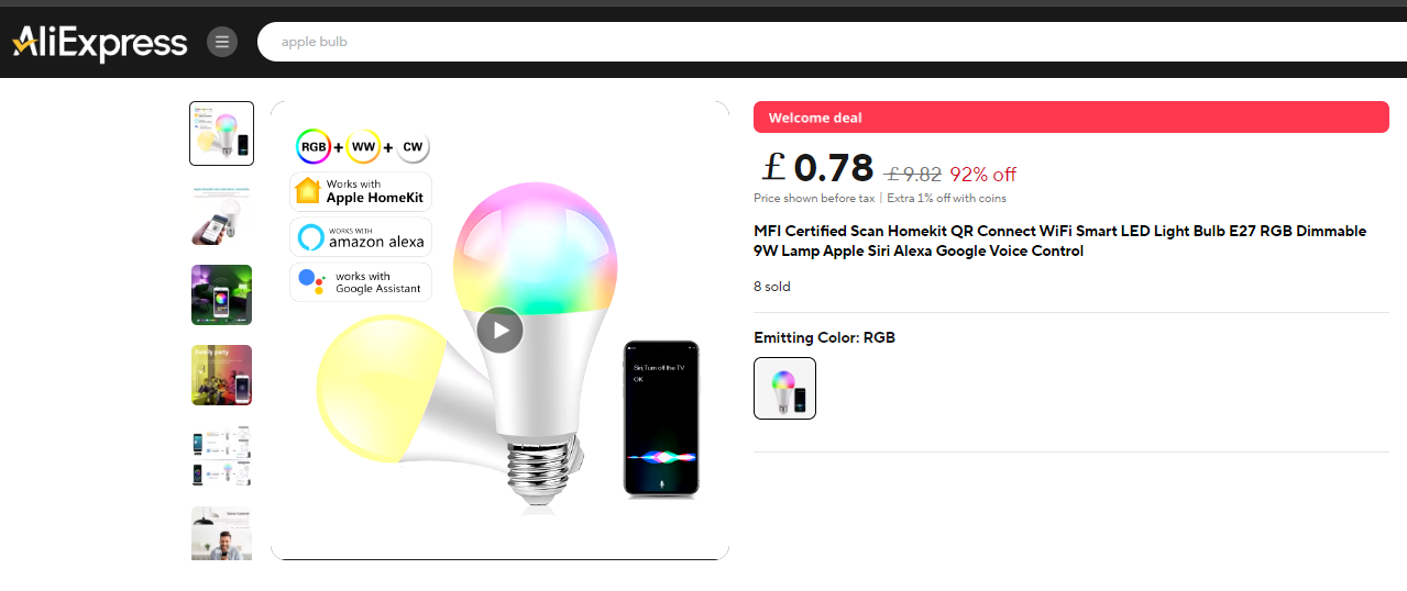

    https://www.aliexpress.com/item/1005007005261284.html
    Promotion of an RGBW LED bulb compatible with HomeKit, Alexa, and Google Assistant on AliExpress.

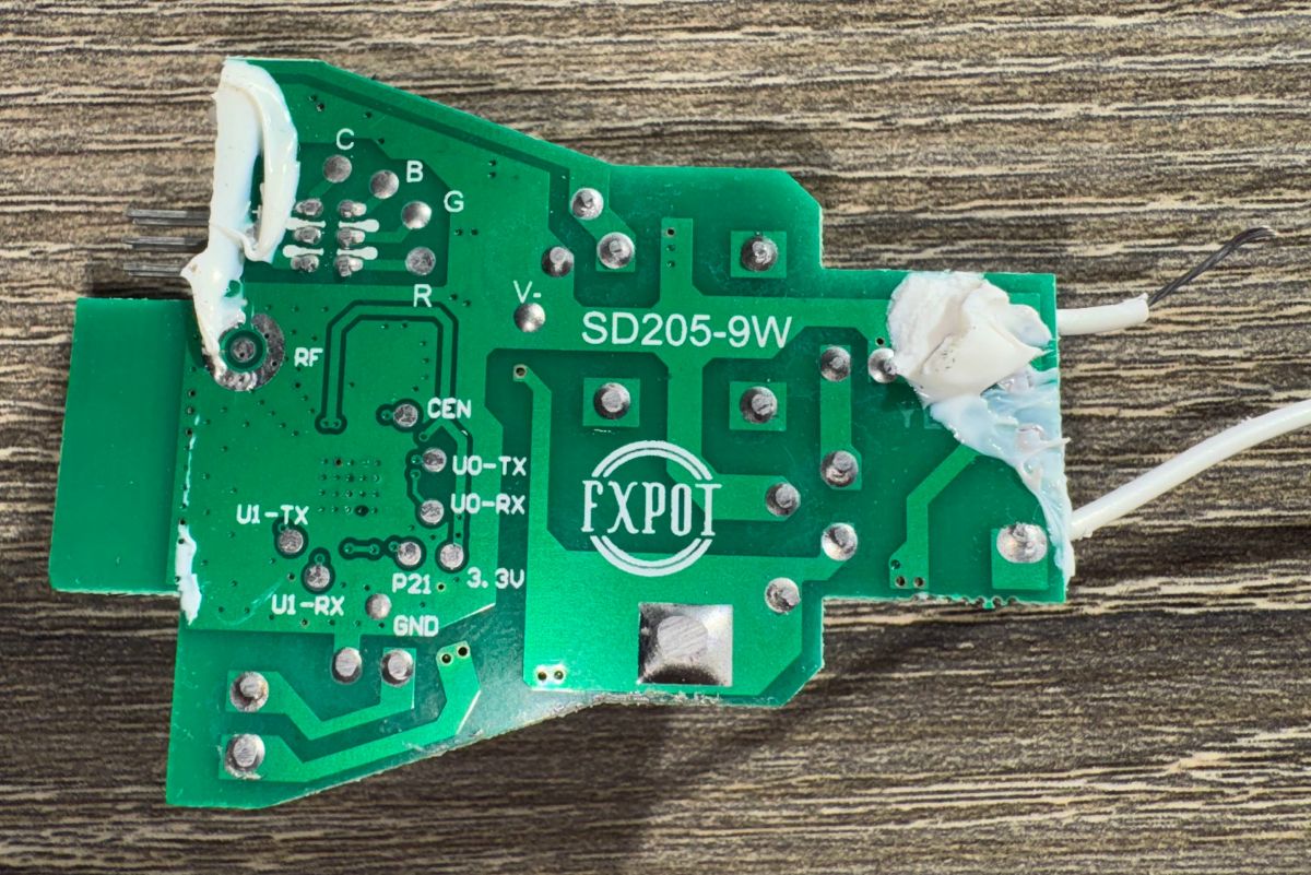

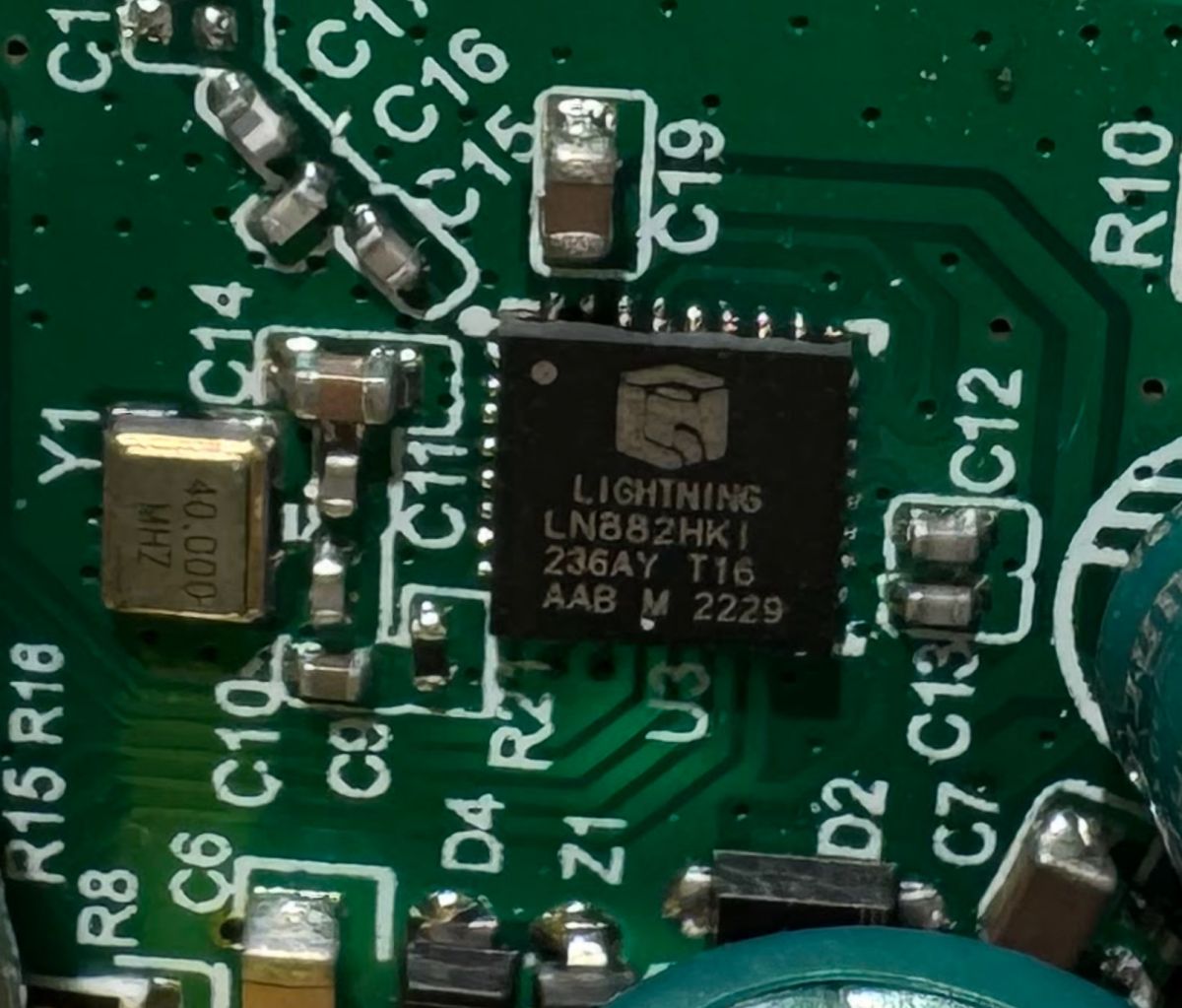

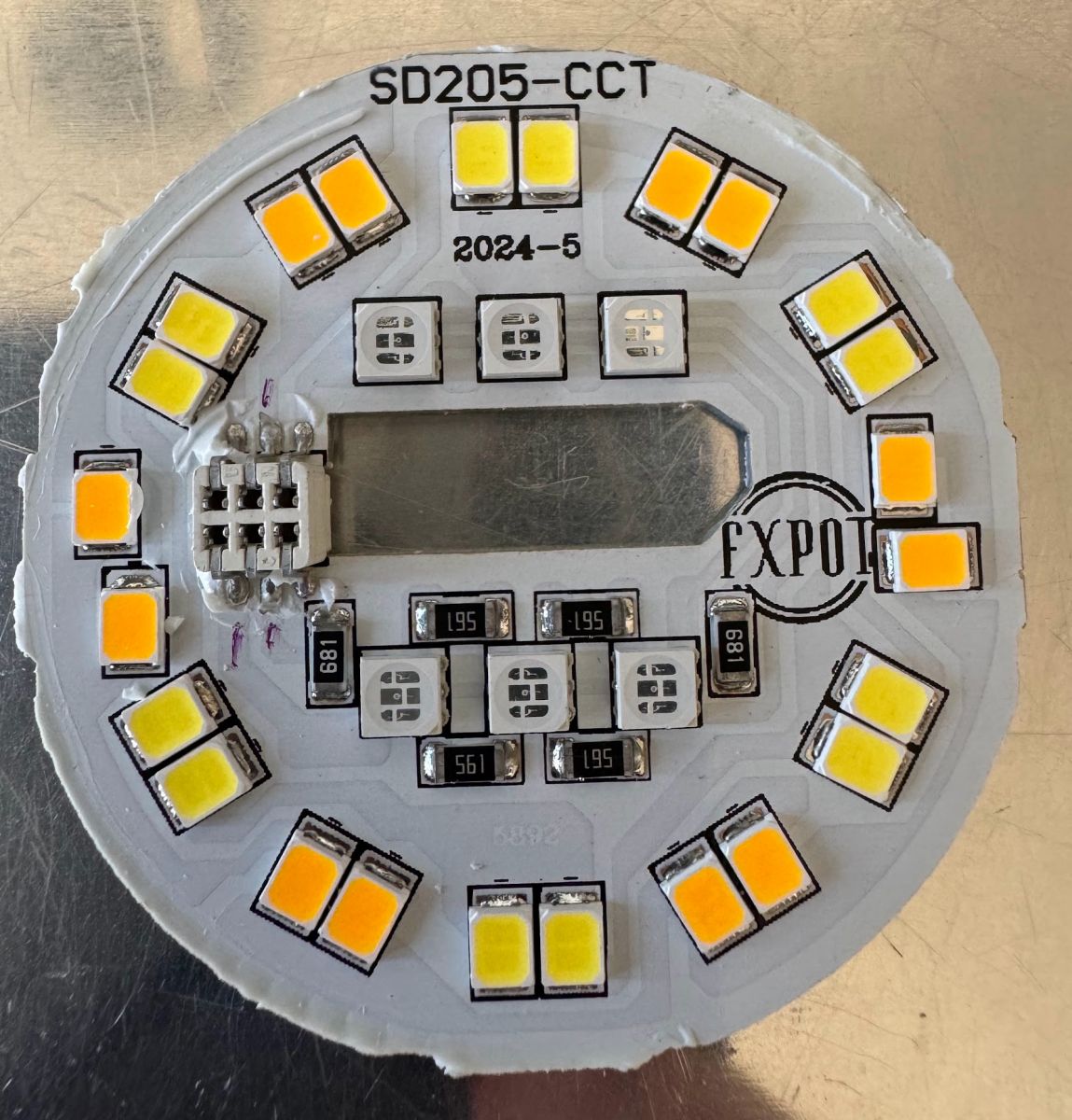

  • LN882HKI bare chip with labeled test pads
    #4 21288699
    poldim1
    I recently bought a similar Tuya bulb but the LN882HKI is a bare chip rather than a module. It was nice for the OEM to label all of the test pads. I'm going to try to upload the OpenBK7231N firmware when I get some spare time.
    AE details:
    Led RGB Light Bulb E27 Dimmable Ir Remote Control Lamp 5W 10W 15W RGBW RGBWW Led Spotlight Colorful Changing Lampada Decor Home
    https://www.aliexpress.us/item/3256807214151940.html
    Close-up of an electronic circuit with various components, including capacitors and resistors, on a printed circuit board. Printed circuit board with test pad markings and inscriptions. LED board labeled SD205-CCT with visible components and test pads. Close-up of a circuit board with an LN882HKI chip and test pad labels.
