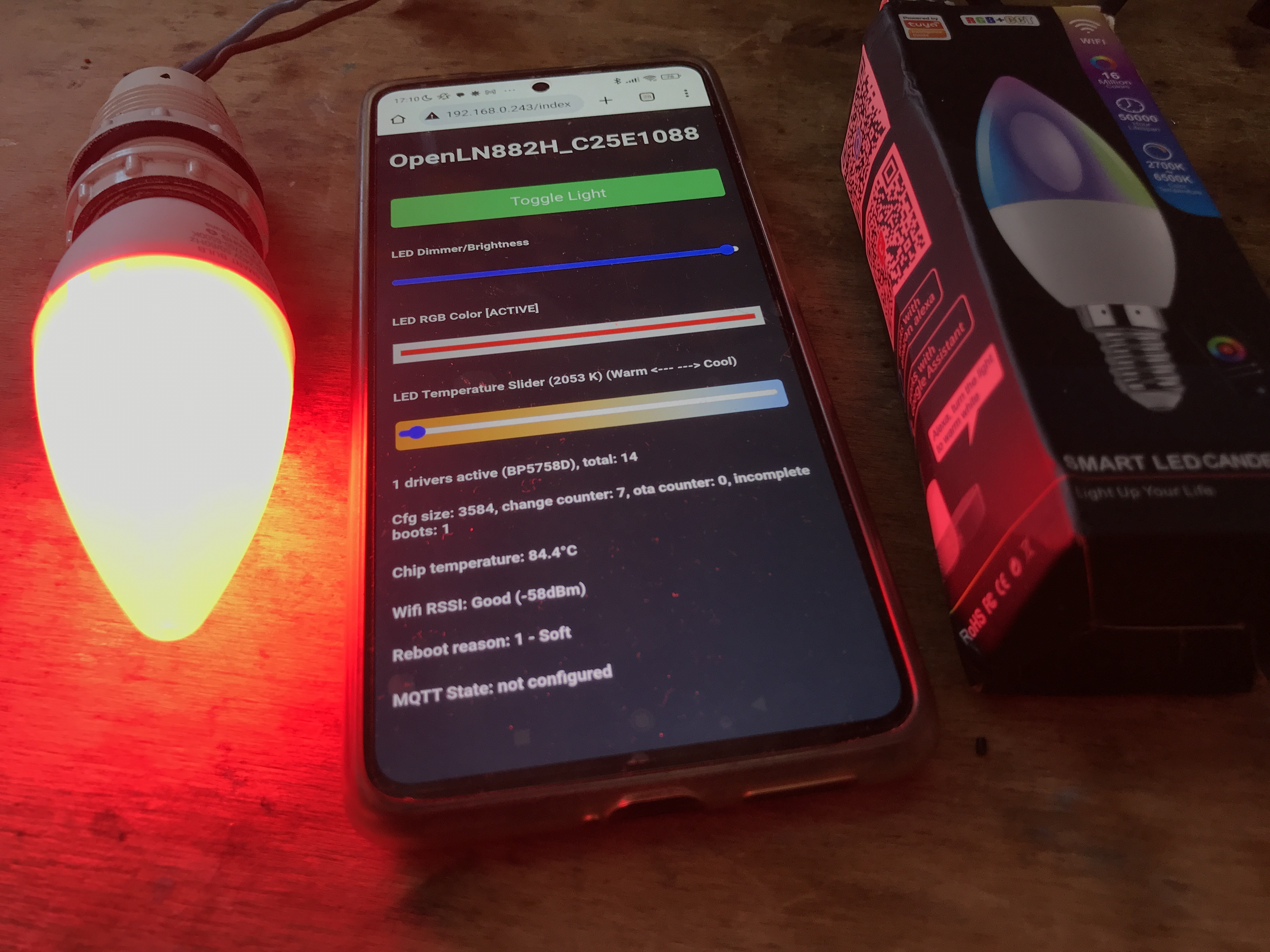

Here I will show how to change the software of a WiFi controlled LED light. The topic will cover its full disassembly, connecting the UART programmer, configuration and restoring the whole thing without glue. By the way, I will also reduce the LED current programmatically to extend its life a bit.
Let's start with the purchase itself. You can import such a lamp from China for as little as around PLN10. In our country, it is slightly more expensive. The whole thing can often be found under the name 'LED bulb', although this is just a colloquial name and is not correct. The unit shown here normally works with Tuya. Its designation is TY-E14-220VB*AT, WiFi LED Bulb RGB CW WW 5W AC. The RGB CW designation indicates the availability of colours and white temperatures. The second model name of the product is C3009.

E14 LED bulb next to a smartphone showing the OpenBK firmware interface and the product box. .
Selecting the current via BP5758D_Current allows us to decide between the lifetime and the level of brightness we want.
The final result (after putting it together):
A red-glowing LED bulb next to a smartphone showing a lighting control web interface. Smartphone displaying control interface for OpenLN882H WiFi LED lamp next to a lit LED bulb and its box. Smartphone showing a web interface for controlling a modified LED bulb with LN882H module, next to a glowing bulb and its packaging. .
WiFi-controlled LED bulb with custom firmware and smartphone displaying configuration interface. A green-glowing Tuya LED bulb next to a smartphone showing the OpenLN882H web interface for LED brightness and color control. Smartphone screen showing LED bulb control interface with custom firmware, next to a glowing blue LED lamp. .
