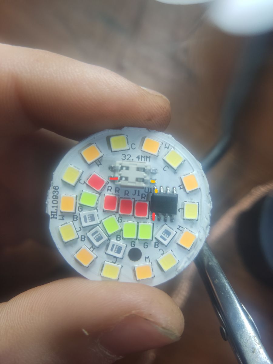

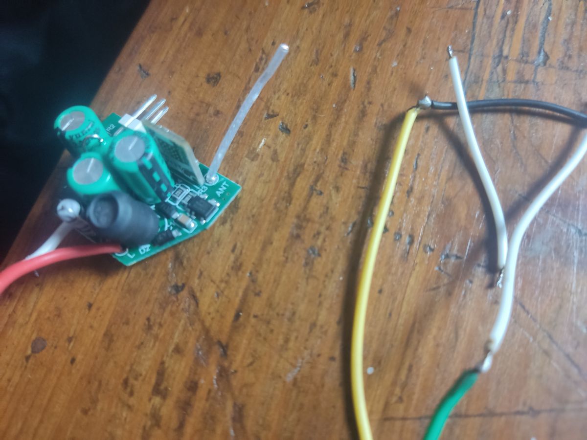

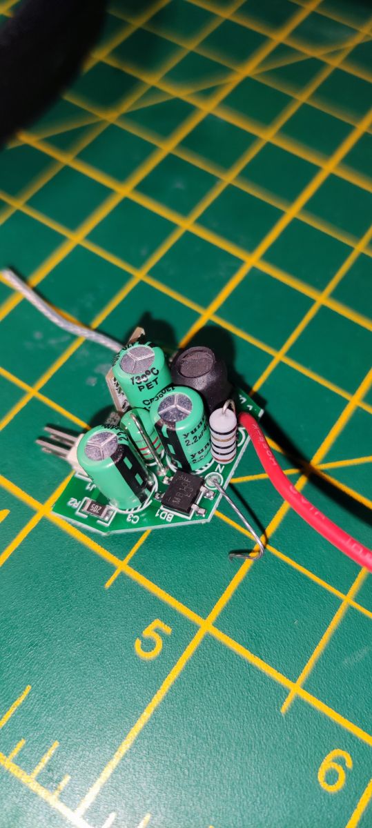

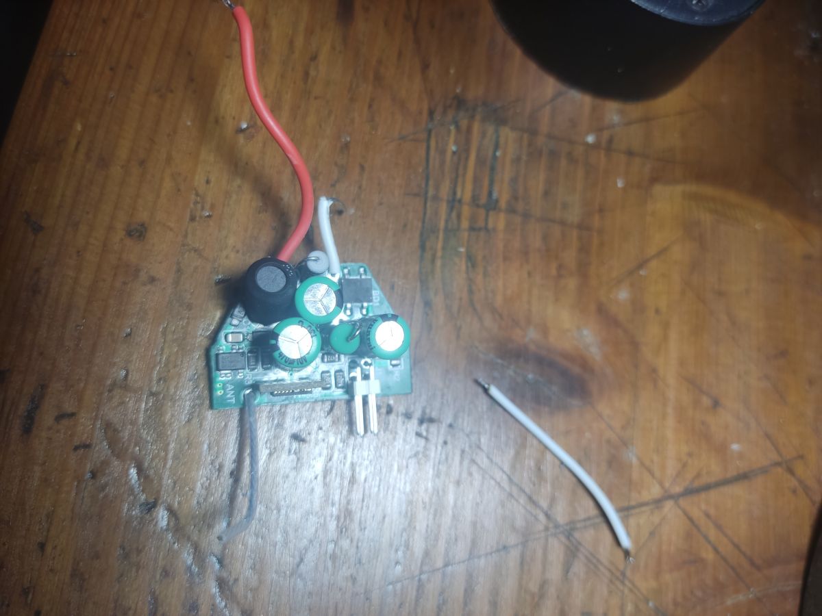

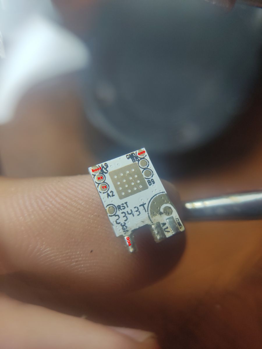

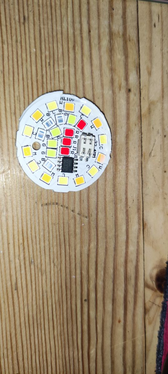

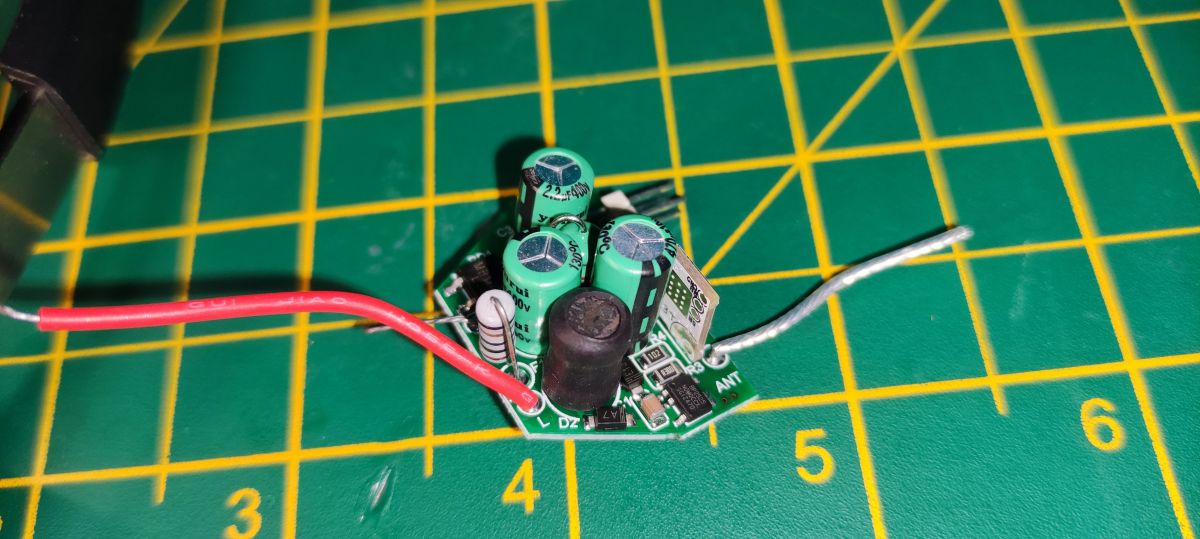

    Hello first time here,
    I recently bought a rgb light from aliexpress
    RGB LED lamp box placed on a keyboard.

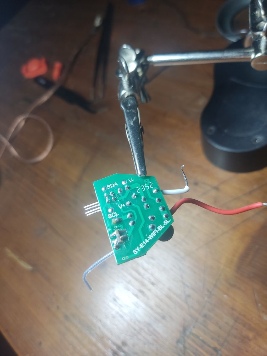

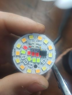

    The disassembly was pretty easy and I didn't damage the light thanks to the video from elektroda channel

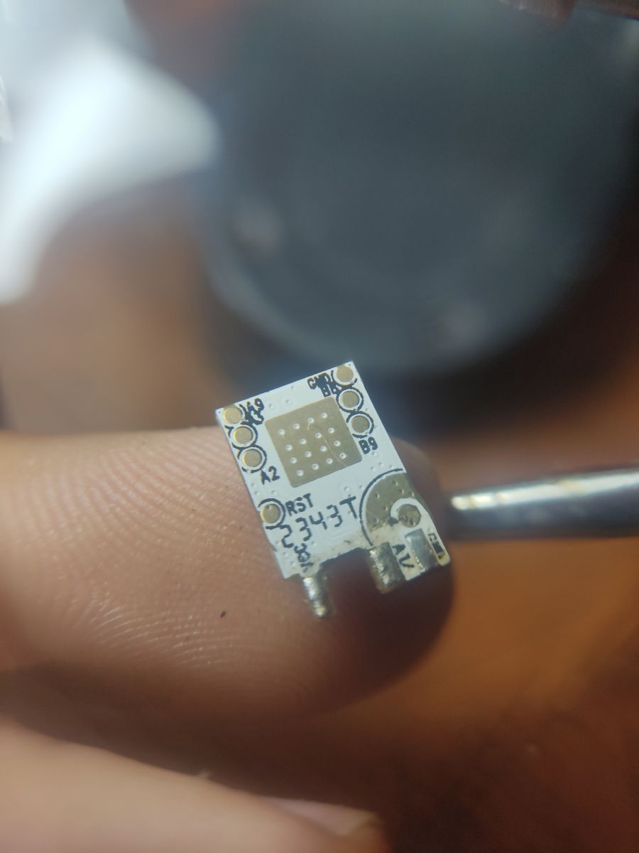

    And I was able to access to this: Electronic module from an RGB lamp on a wooden surface.
    Circuit board with pin labels SDA, V+, and SCL, held in a tool holder. Electronic module with several wires on a wooden table.

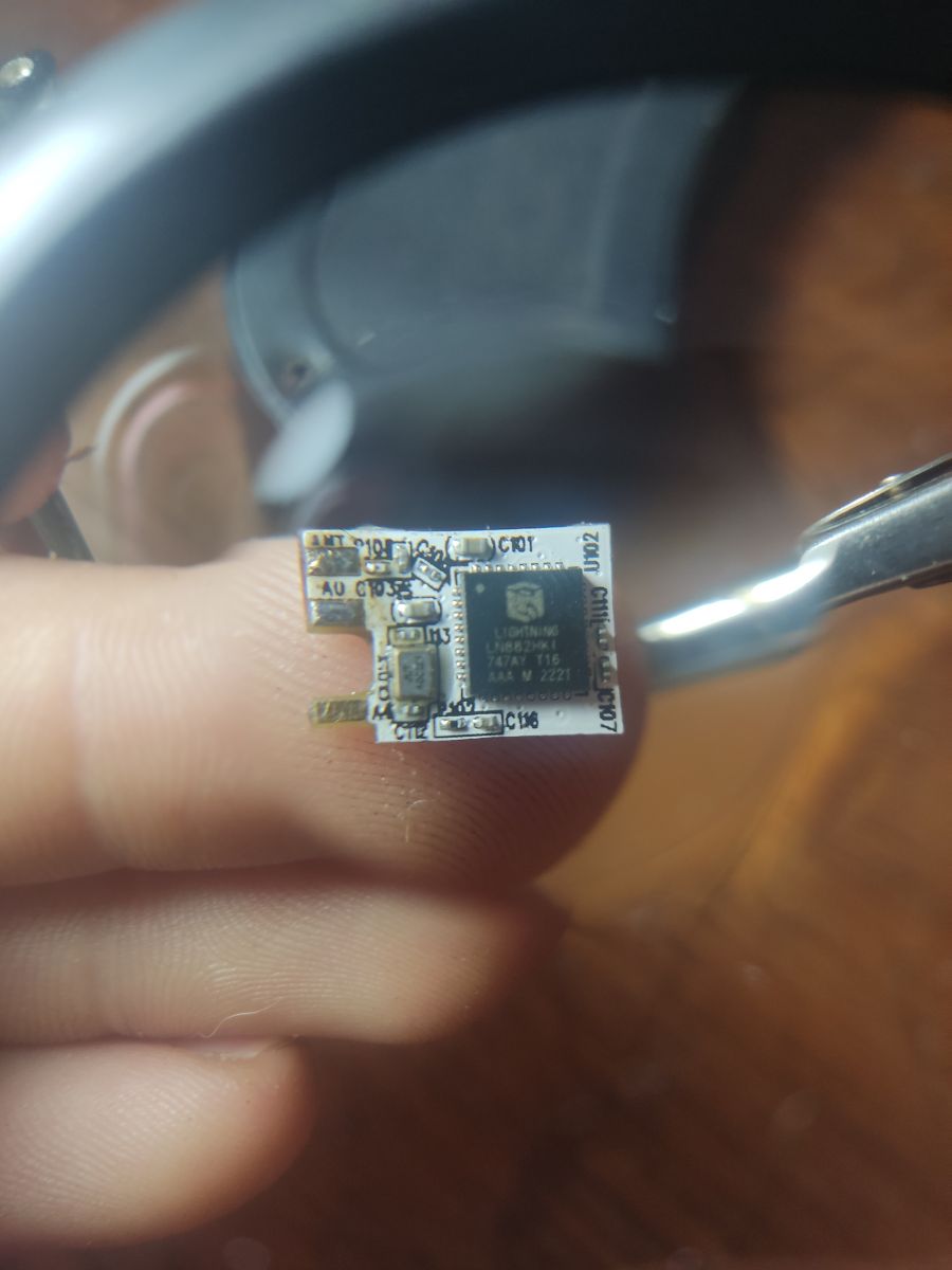

    After desoldering the module and seeing that it was a LN882HKI I was able to find the pinout with this topic Close-up of a small electronic module held in hands. Close-up of an electronic module with pin labels.
    I did a backup of the chip and tried to flash obk at 2000000 but after 3 fails I tried at 115200 and it worked right away.
    But now I'm facing an issue: I don't know how to setup the module in obk, I tried with the gpio finder but it did nothing except freezing starting P13 so I stopped messing with it.
    Thanks in advance for your help and sorry for the typos here and there

    gregmarfaing wrote:
    i don't know how to setup the module in obk , i tried with the gpio finder but it did nothing except freezing starting P13 so i stopped messing with it .
    sounds like you're doing the right thing? I've experienced freezing on some pins before but I just reboot and carry on. Perhaps start from the bottom instead.
    https://www.elektroda.com/rtvforum/topic3976371.html
    Added after 10 [minutes]:
    if they're PWM controlled LEDs, seems like only these pins can be used on LN882H anyway though
    8 GPIOA7 I/O PWM pin, corresponding to pin 15 of the IC.
    9 GPIOA10 I/O PWM pin, corresponding to pin 21 of the IC.
    10 GPIOA11 I/O PWM pin, corresponding to pin 22 of the IC.
    11 GPIOA12 I/O PWM pin, corresponding to pin 23 of the IC.
    12 GPIOB3 I/O PWM pin, corresponding to pin 24 of the IC.
  • #3 20970561
    gregmarfaing
    Posts: 16

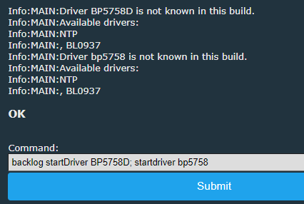

    Well i tried every gpio except p13 and p14 as it freezes and the leds didn't turn on (to be sure that i was doing good I tried with another rgb light).
    So to see if the problem is on my side, I checked the soldered points I did but still didn't see a thing and saw that on the leds pcb there was a bp5758 if it can be of any use

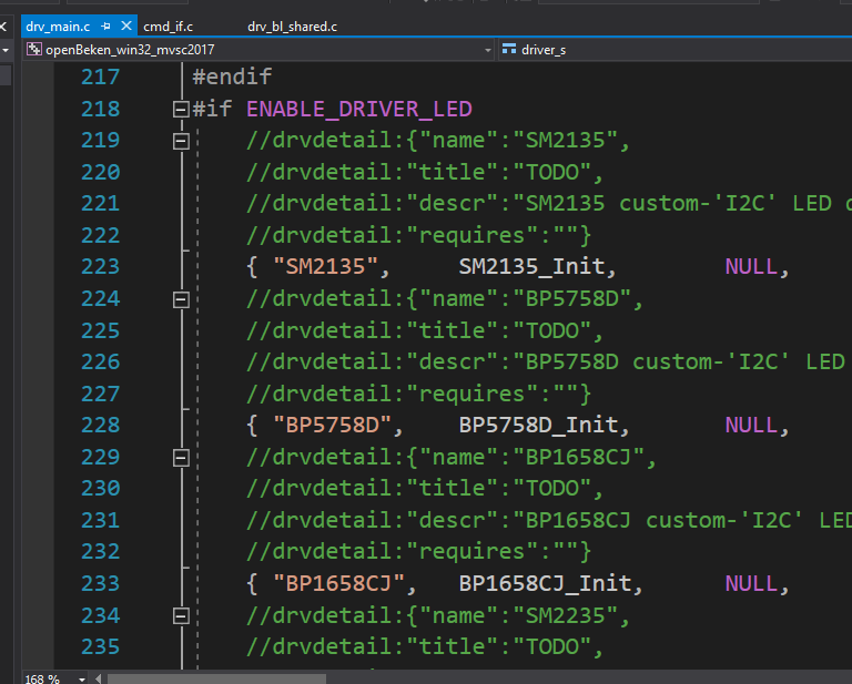

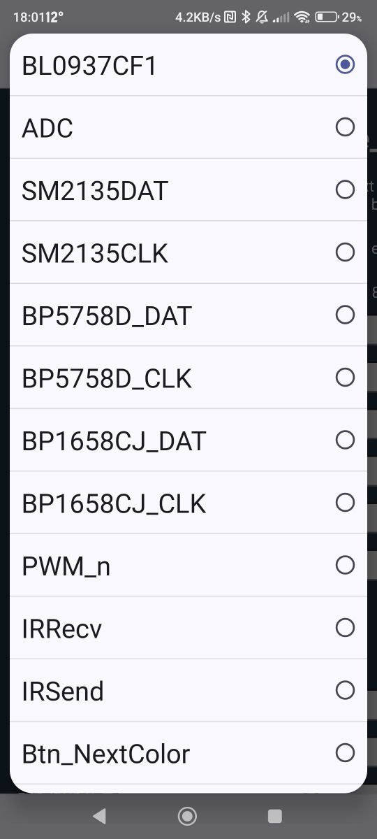

    Ah I see. I'm still quite new to OpenBK. I don't think I've had to set BP5758 channels on any bulbs. I do see there is DAT and CLK for that chip tho, so I guess it's finding the gpios for those two.
    Screenshot of an app displaying a list of available channel selectors, such as BL0937CF1, ADC, SM2135DAT, SM2135CLK, BP5758D_DAT, BP5758D_CLK, BP1658CJ_DAT, BP1658CJ_CLK, PWM_n, IRRecv, IRSend, Btn_NextColor.
    Perhaps there'd be continuity between two of the contacts on the PCB and two legs of the BP?
  • #5 20970790
    Posts: 14755
    Rate: 12879

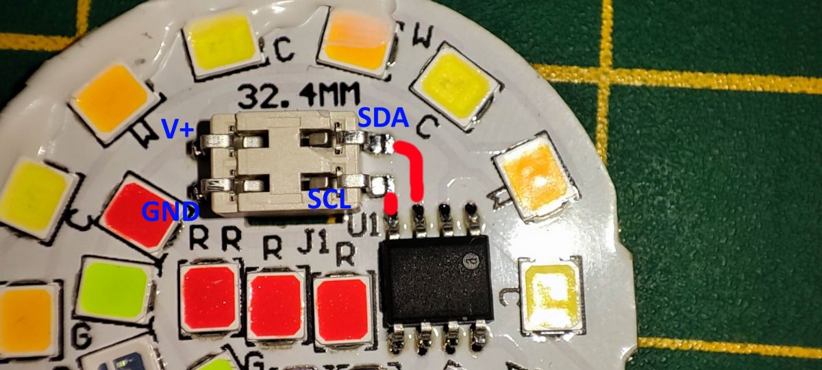

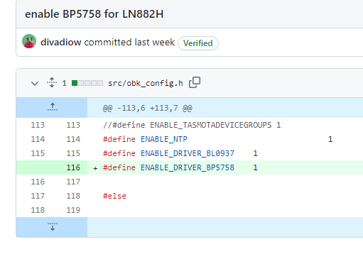

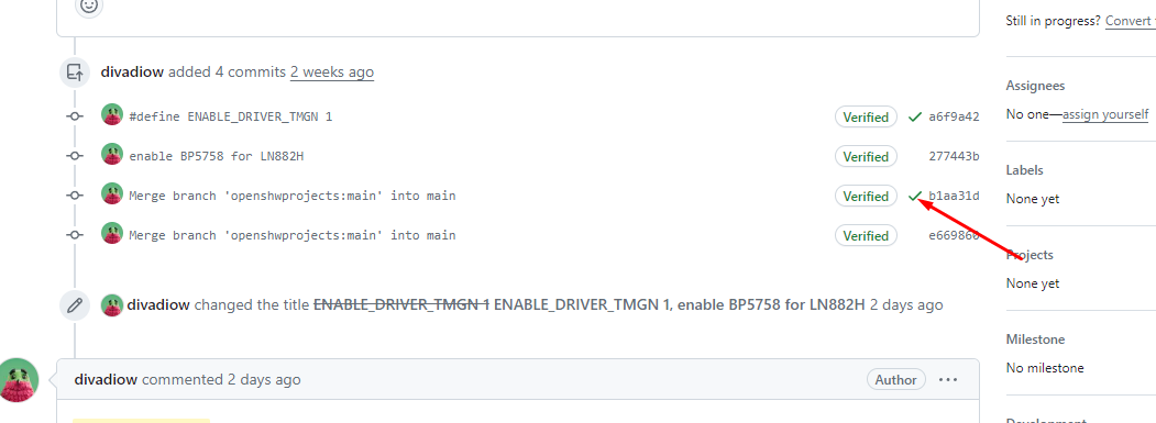

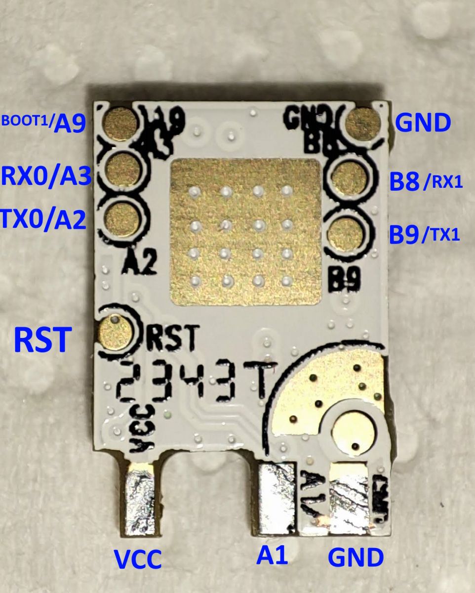

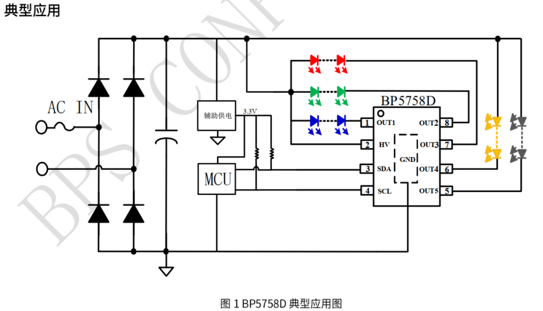

    You are the first one to find a LN882H + BP5758 combo. I will need to enable BP5758 driver for you.
    Still, first you need to get a multimeter and check which LN882H pins are used for BP5758 SCL and SDA (or CLK and DAT, it's the same...). This is currently necessary, because there are too many options to just guess.
    Do you know BP5758 pinout? Are SDA and SCL marked on board?
  • A0 and A1 are the module’s used pins
    #6 20970849
    gregmarfaing
    Posts: 16

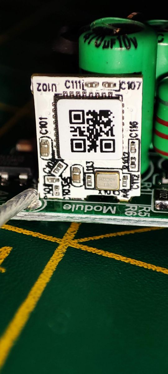

    Close-up of a PCB with marked SDA and SCL pins.

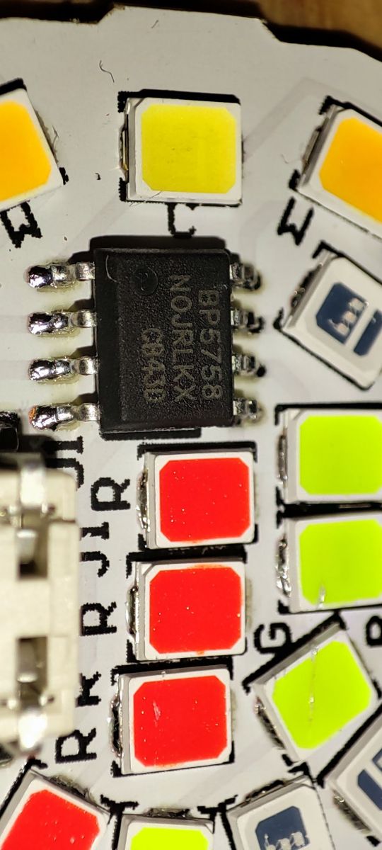

    as you can see SDA and SCL are both marked on the PCB and I think this is the pinout of the BL5758 (as the other pins are all connected to LEDs) Close-up of a PCB with highlighted SDA and SCL pins and LEDs.
    And I just wanted to add that for me the pin used by the module are A0 and A1 as the others connected are VCC, GND, and ANT, respectively.
    BL5758 microcontroller with highlighted pins on a PCB held by a hand.
    Close-up of an electronic module with pin markings on a PCB.
  • #7 20971149
    Posts: 14755
    Rate: 12879
    We need to know exactly which pin is SCL and which is SDA.

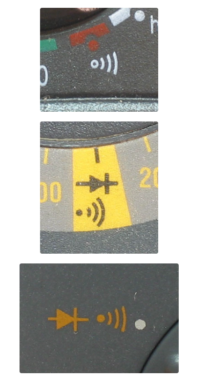

    I should've asked how to proceed with the multimeter because now I think that my device is dead. I first had the cold white light up then with the next pin I had a little electric flash and now nothing except some burn marks on some components.

    was it not in continuity mode? usually denoted by a "beep" audio symbol. my meter only has the beep symbol
    Close-ups of symbols and markings on an electrical meter.
    the bulb does not need to be powered when checking for continuity

  • A0 and A1 map to SCL and SDA
    #11 20971840
    gregmarfaing
    Posts: 16
    Well it's exactly that, I tried with the multimeter while it was powered on (I found this pretty dangerous so I was extra cautious) because it's my time doing this, I'm learning from scratch and I didn't know I had to use the continuous mode while the device was off. Still I really appreciate your help and divadiow's as well. Anyway, I think that I'll buy another one too as it's just so cheap (bought it at 2,69€)
    i can just add that A0 is connected to SCL and A1 is connected to SDA ( tested with the multimeter in good condition this time with the dead device)

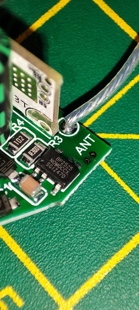

    UART output corrupted after accidental damage
    #12 20983813
    Posts: 5209
    Help: 446
    Rate: 914
    my turn to break one of these, but not sure how. I was so careful! UART just outputs junk now and there's no sign it's transmitting.
    I didn't get to flash it, but before I killed it, these are the pins and boot log. I've ordered another one lol. 😫
    Image of a PCB with LED components and pin labels. Close-up of a PCB with labeled pins. Close-up of a PCB with labeled pins.

    and some more random pics of the PCB Close-up of a section of a PCB with visible electronic components. Close-up of a PCB section with visible capacitors and an MB10F bridge rectifier. Electronic module on a PCB with a visible QR code. The image shows a small circuit board with wires attached to components. Image of a PCB with several green capacitors and wires on a work mat background. A photo of a circular PCB with colorful SMD LEDs on a wooden table. Close-up of a BP5758 integrated circuit on a PCB with colored LED lights.

    Diagram of current flow in the BP5758D circuit with MCU.

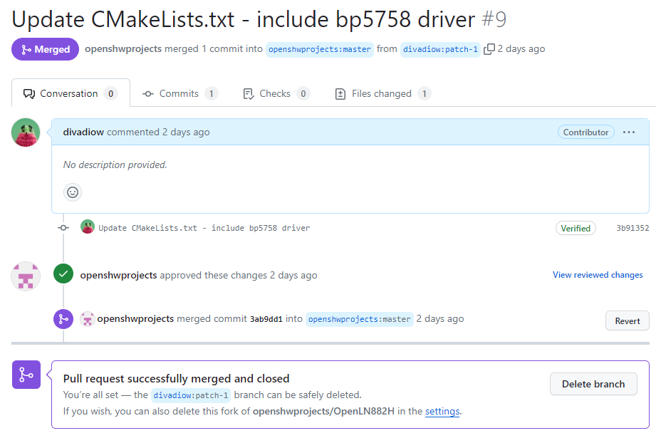

    This may require one little change more. You need to add the related file to Make. Here is an example how I did that for power metering:
    https://github.com/openshwprojects/OpenLN882H/commit/5e1e686bc5884ef0abee362bc791be660a541a2b
  • #19 21002234
    Posts: 14755
    Rate: 12879
    If you have enabled this driver and updated the SDK, and it compiles fine with:
    #define ENABLE_DRIVER_BP5758    1
    then you should next try using it on LN882H to see if driver is available.
  • #20 21002248
    Posts: 5209
    Help: 446
    Rate: 914

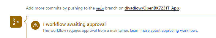

    oh. I enabled the driver with #define ENABLE_DRIVER_BP5758 1
    but does this need you to OK again it now before I can try a test workflow build?
    Screenshot showing a notification about a workflow awaiting approval on the GitHub platform.
  • #21 21002253
    Posts: 14755
    Rate: 12879
    I think that you can still click here:
    Screenshot of a version control system interface showing a build log with several commits.
    and get the build files from the commit build.
  • Latest bin already includes driver enable support
    #22 21002260
    Posts: 5209
    Help: 446
    Rate: 914
    ah crap yes. you're right. AND I remember your guide says this 😳
    Added after 30 [minutes]:
    hmm
    Screenshot of a user interface showing driver information and a text command.
    the latest bin does include driver enable in main https://github.com/openshwprojects/OpenBK7231...mits/277443b2a56f0343a84afe548b226ddbc5712a3f
    A configuration file excerpt with driver definitions showing the enabling of driver BP5758.
    and you've already merged the LN882H PR to add driver file for LNH882H https://github.com/openshwprojects/OpenLN882H/pull/9
    Screenshot showing details of a merged pull request on GitHub.
    so, not sure now

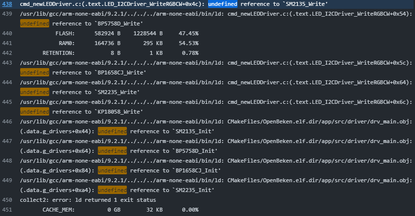

  • Missing LED driver define caused the issue
    #23 21002388
    Posts: 14755
    Rate: 12879
    Updating the SDK requires also a manual update of dependencies in the main App repository. I did it myself on the App, but did you merge my changes into your fork?
    Still, if that were missing, then you'd get linker errors...
    Oh, I've found a problem! We didn't have such define! We have just one large define for all 4 LED drivers:
    Source code snippet in an editor with LED driver definitions.
    Sorry, I should have caught it earlier.
  • #24 21002439
    Posts: 5209
    Help: 446
    Rate: 914
    aha! that explains why I didn't see any other BP5758 defines for other chipsets
    Does this mean all LED drivers under that umbrella define need adding to LN882H?
    Screenshot of compilation errors indicating undefined references in LED driver code.

    failed on i2c drv. added. https://github.com/openshwprojects/OpenLN882H/pull/11
    Added after 1 [hours] 11 [minutes]:
    lol, sorry https://github.com/openshwprojects/OpenLN882H/pull/12

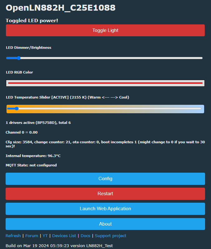

    Added after 10 [hours] 17 [minutes]:
    woohoo
    LED control panel with settings for brightness, RGB color, and temperature.
    I just need to nail the BP5758D mappings
