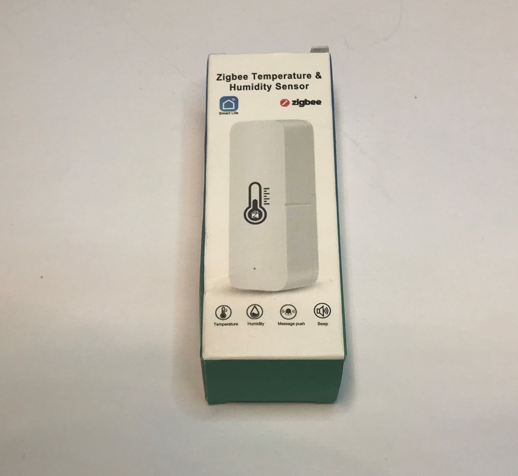

Zigbee temperature and humidity sensor packaging with function icons
The subject of the TH08 sensor, based on the CHT8310 chip and offering Wi-Fi connectivity, has already been raised many times in our forum. Its integration with the Home Assistant proved possible, albeit quite challenging. This time I will show its Zigbee variant, whose pairing with HA is much simpler. We will also take the opportunity to look inside both devices to see how they differ.
Let's start with the question of pricing. The Zigbee version can be bought in our country for around PLN40, while the Wi-Fi version is slightly cheaper, costing PLN20 to PLN30. Here one might be tempted to say that why would you need one Zigbee sensor when you can have two Wi-Fi ones for the same price? but I recommend caution. Indeed Wi-Fi is cheaper, but it is also more difficult to convert so that it works without the cloud:
[BK7231N/CBU] Tuya TH08 Generic Wi-Fi Temperature & Humidity Sensor [CHT8310]
So let's see what we get in the kit. In addition to the sensor, it includes instructions and a strip of double-sided tape.
