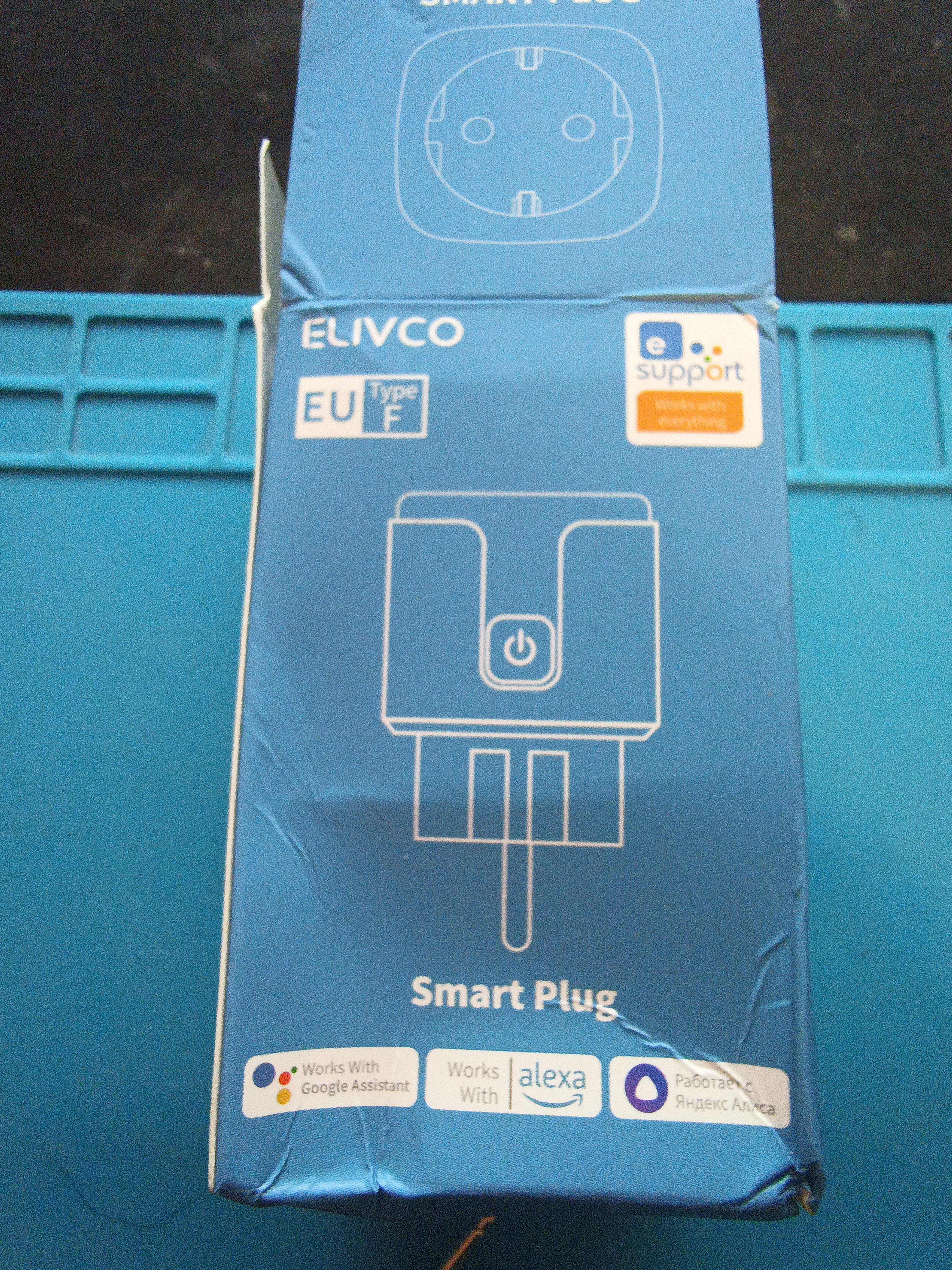

Here is a teardown of an 'ELVICO Smart Plug'. It is intended for Zigbee using the eWelink platform. I have been hunting for bouffalolab-based devices, as my project has been porting those chips to Zephyr RTOS for a few years, and we just got BLE working, enabling usages similar to OpenBeken or Tasmota.
Blue ELIVCO Smart Plug box, EU Type F, with Google Assistant and Alexa compatibility logos
