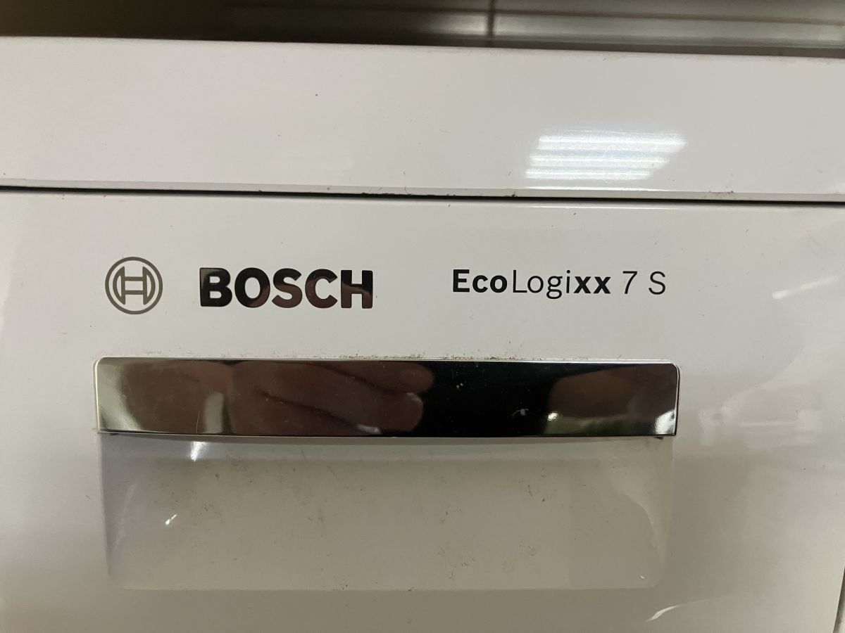

    I still have such a vintage :D

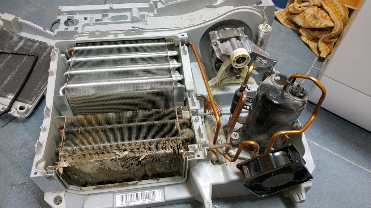

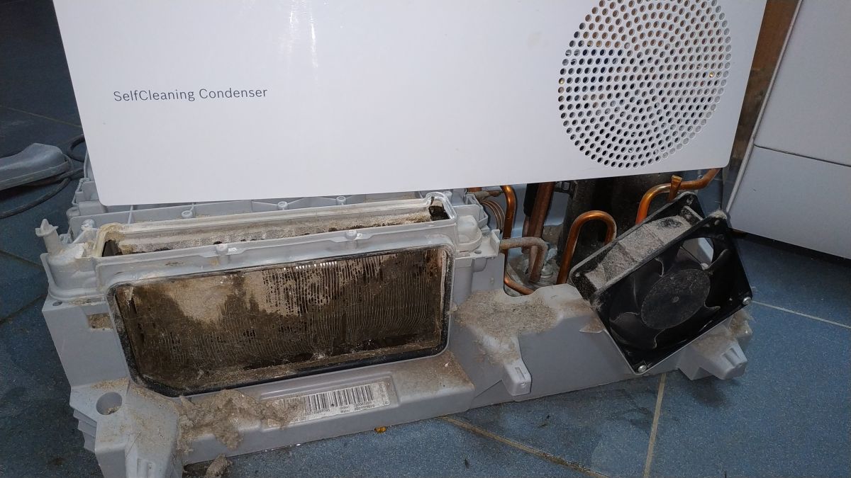

    Here is an example of the effectiveness of the exchanger flush. one of the many dryers with auto cloas or self clean systems after a certain period of operation.

    One of many... let's not do beauty contests. I presented a specific solution which I happen to have and which I think works, and which a colleague obviously does not have to like.

    @mrice I cleaned a colleague's once by taking it apart like this, the second time went with a pressure washer and it was done

    What you are showing is not AutoClean.

    This is not the way to go, once with a pressure washer you will not clean the other part of the exchanger or the drain channel properly.
    This technique is, unfortunately, patting the syph with powder.
    Borutka wrote:
    One of many.... let's not do beauty contests.
    It's not about competitions, it's about facts, how dryers with exchanger flush systems look like.
    I will not convince a colleague by force if he does not believe the photos.
    pacpaw wrote:
    What you show is not AutoClean.
    So outline the differences in construction and principle of self and auto.

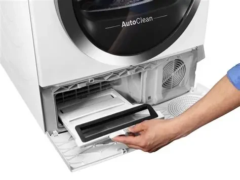

    I was referring to a system where there was no filter under the door, but it was in front of the exchanger. It was flushed with water and the lint went into a drawer under the exchanger. For some reason, this system was abandoned and we returned to the infamous previous solution, where the exchanger is flushed and not the filter in front of it. There is also a filter under the door.

    You have shown a dryer with SelfClean, this is an older system, in fact Bosch still uses it.
    I think the AutoClean system was in one generation, which they quickly phased out. Supposedly due to a change in EU requirements for energy labels (although I don't know what the fart has to do with the windmill). Below is a photo.

    They withdrew because it worked and probably reduced sales of dryers
