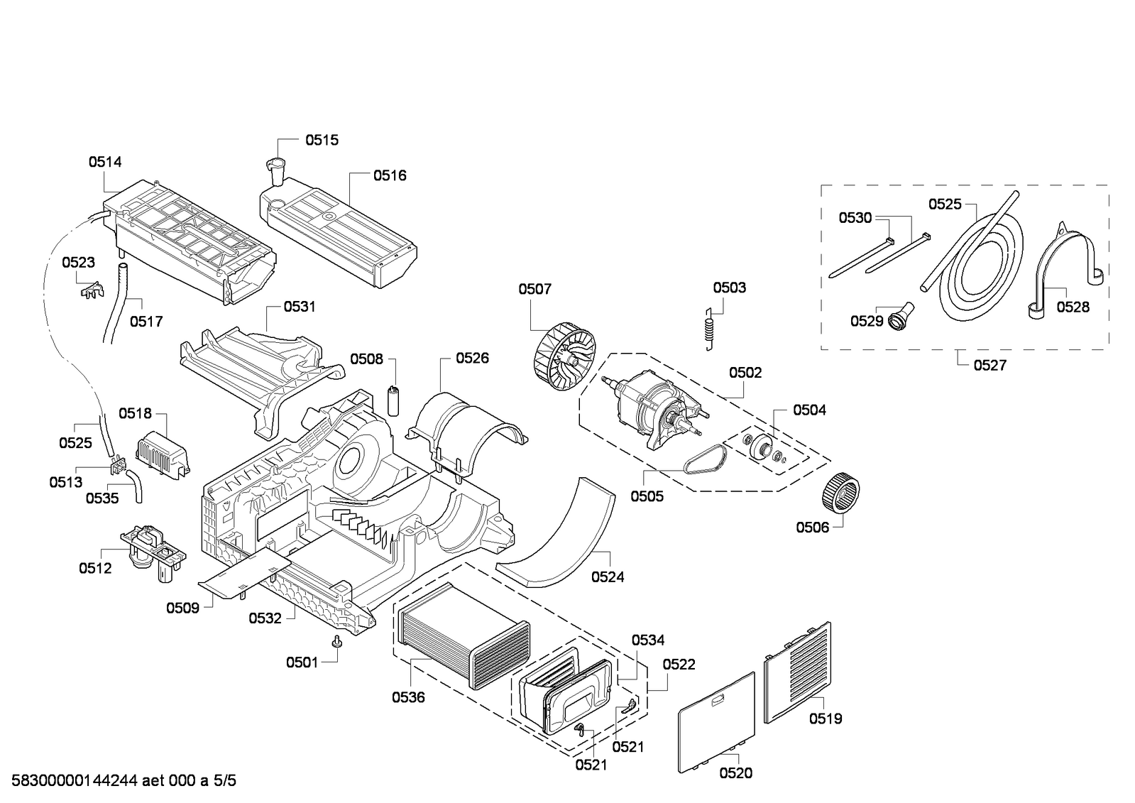

    Diagram of parts for the WTE86386/30 heater dryer
    Nothing is falling apart. The video shows an old WTE86386/30 heater dryer and a view after removing the side casing, removing the inspection flap (0509) under the exchanger and removing the water pump (0512) - you can open this inspection flap after removing the exchanger (from the front), but cleaning is difficult.
    Yes, a heater dryer appeals to me more structurally than one with a heat pump - that's why I'm not getting rid of the old dryer and I approach the new one with caution.
    I only found out that I had dirt in other places when I completely disassembled the dryer. The chamber in which the exchanger is located was clean - as far as I could reach with my hand, but there was a lot of dirt at the back, where the fan 0507 and under the housing of the fan cooling the exchanger. 0526.

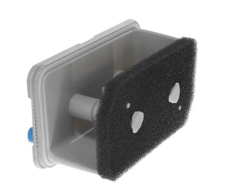

    Another question - before the exchanger you have such a sponge filter
    Sponge filter for a dryer on a plastic frame. .
    How often have you cleaned / washed it? Similarly with the lint filter which is by the drum.... I ask these types of questions because heat pump dryers are, if nothing else, a novelty on the market and I always wonder whether by taking care of these filters the user can extend the life of the appliance in any way. I bought myself a new sponge filter with my dryer (also Bosch) - every 2-3 dryings I replace it with a clean one and that's it, and I clean the lint filter after every drying - and in my opinion cleaning these filters has a greater impact on drying time than on the life of the appliance, but life will tell.

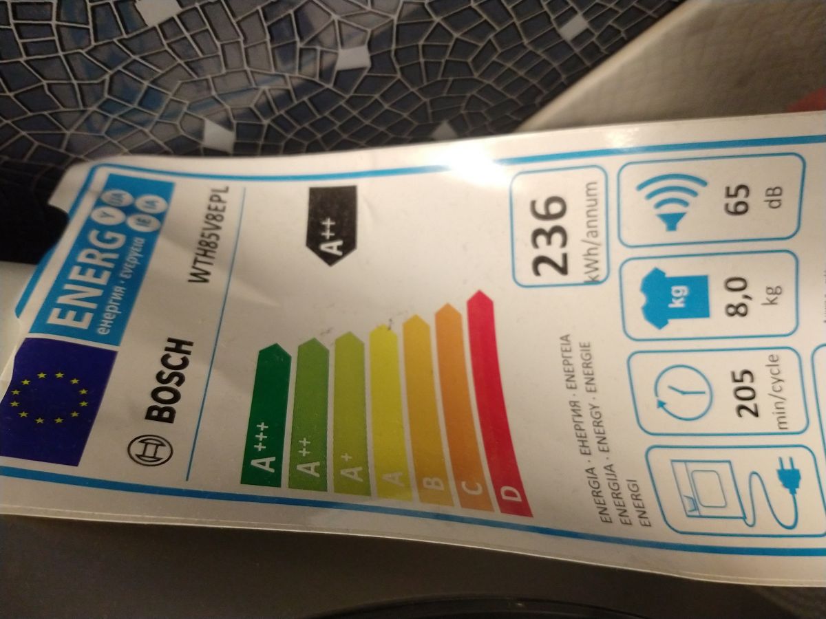

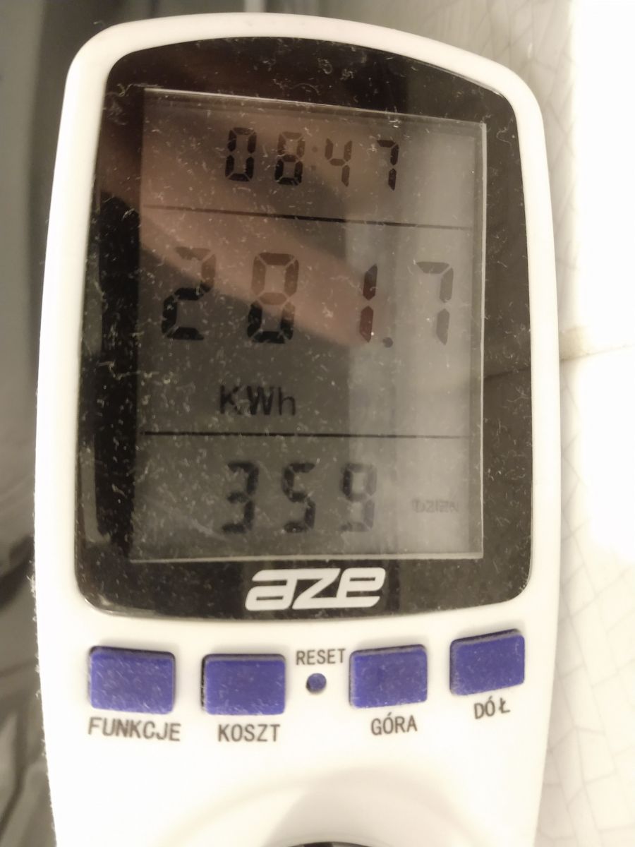

    So maybe as a way of defusing the atmosphere I'll throw in an interesting fact ;) I have a Bosch appliance, a WAN2826EPL washing machine (usually spins to 1400) and a WTH85V8EPL dryer. Dry 99% mix, statistically ~1kw/dry. While it's obvious that manufacturers are sizing up the actual consumption (because as you know everyone uses differently), you never know what to expect. In my case it came out just under 20%, to my eye not too bad. Family of 2, one of which is a bobo.
    Electric energy meter with display showing 20.17 kWh consumption. .
    Energy label for Bosch dryer model WTH85V8EPL. .
