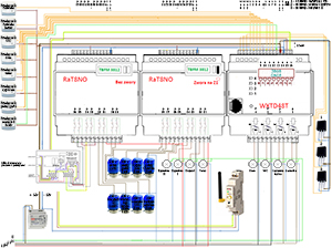

    microtomi
    Posts: 6
    Welcome all to the forum intelligent house system on plc controller (sterbox) installation, programming made by me. Controlling lighting, underfloor heating (8 temperature sensors switch electro-valves on pump manifolds and furnace) roller shutters, gates (entrance and garage). In addition, an rs485 translator from zamel is installed to control RGB led light scenes, control via tablet or smartphone. All information about the operation of the sterbox is displayed on a website created by me.

    MicroT
    Bajdy 213, Wojaszówka, 38-471 | Company Website: www.microt.com.pl

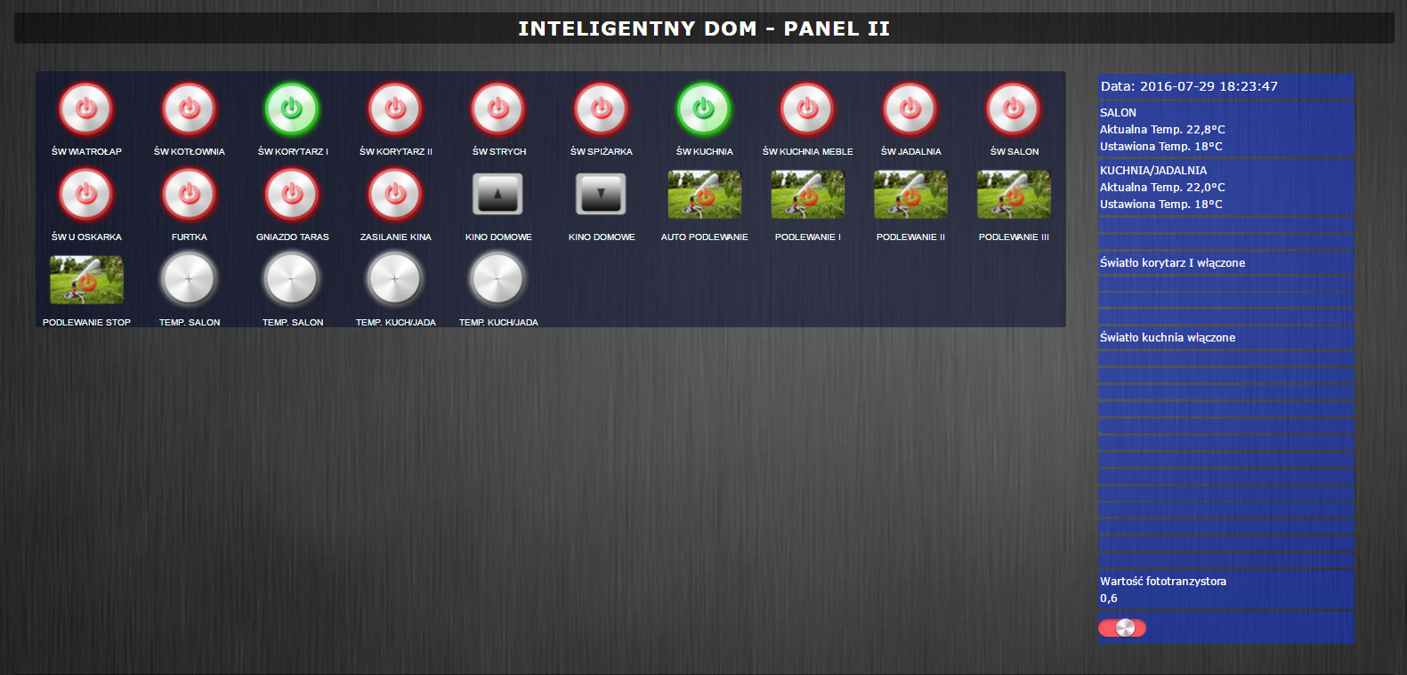

  • #50 15900714
    ditomek
    Level 22  
    Posts: 590
    Help: 24
    Rate: 230
    Which smart lighting and roller shutter solution: Siemens Logo!8 or Satel?
    as you can see the base of the controller is the most ordinary arduino mega. Galvanic isolation on all digital ports, all com ports are out, one on 485 with automatic flow control, plus a 5 button keypad and status of outputs on red leds (sliding registers). iO organisation: 24 outputs and 26 digital inputs

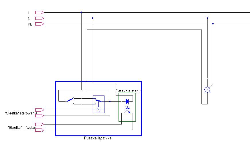

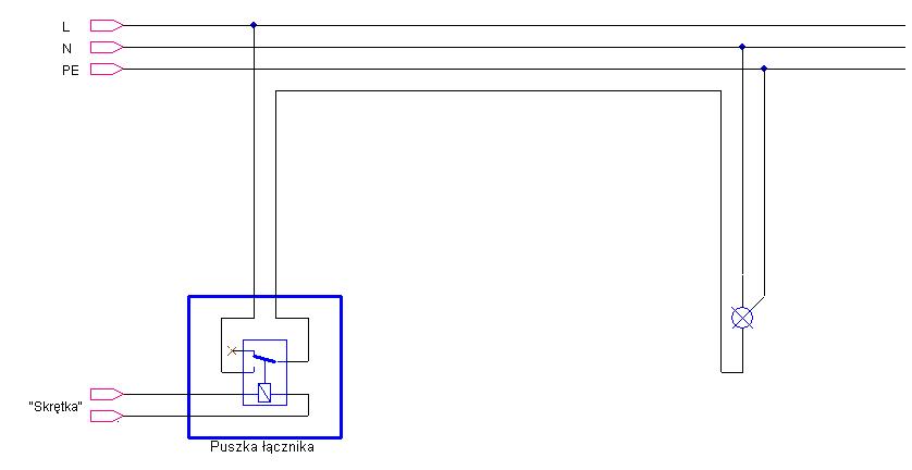

  • #51 15901442
    pafciowaw
    Automation specialist
    Posts: 2439
    Help: 480
    Rate: 365
    Col. ditomek: upon reflection, I concede your point about the cabling....
    And back to that ...what after 20 years?
    Maybe immediately provide for a manual switch which, together with a relay, will create a "staircase system" - there will be the possibility of manual control (regardless of the action/inaction of the "intelligence"), detection of the physical power supply of the lamp (to be used in a remote/local application)
    Note: detector drawn symbolically.
    A two-coil bistable relay can be used instead of a relay (you will not need to hold the coil between switches)
