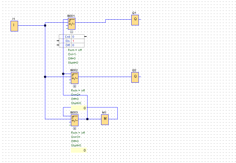

  • #20 15790840
  • #21 15790898

    1b, what about switching off ?
    #22 15790950
    Wojciech.
    Level 37  
    Posts: 3595
    Help: 319
    Rate: 468
    hmm maybe a 3rd click that will reset the counters?
    That would be the easiest way to do it. Unless the author says something more.

    How about both lights ?
    Added after 39 [seconds]:
    Totally confusing.
  • #24 15791081
    Wojciech.
    Level 37  
    Posts: 3595
    Help: 319
    Rate: 468
    After one press, Q1 lights up, after the second Q2(Q1 is switched on) and after 3 all counters are reset.
  • #25 15791143
    Zbigniew 400
    Posts: 4356
    Help: 283
    Rate: 794
    And if you only want to light up Q2 ?
  • #26 15791169
    Wojciech.
    Level 37  
    Posts: 3595
    Help: 319
    Rate: 468
    And you are right. Because it wasn't a matter of 2 presses but 2 clicks. The matter gets a bit more complicated.
    Well, because in total the controller has to verify the 2 clicks and there should also be some error tolerance.

    @Wojciech.. thank you very much because you are terribly helpful.
    I will write how I think it would work.
    1 click turns the main light on, again 1 click turns the main light off
    2 clicks turns on side light, again 2 clicks turns off side light
    3 clicks (or holding for e.g. 2sec) turns everything off.
    Seems simple. Just a click changes the action. When ON it does OFF, when OFF it does ON. However, holding it down (or 3 clicks) always does OFF.
    But, gentlemen, this is bullshit. I will be programming such things myself at the finishing stage.
