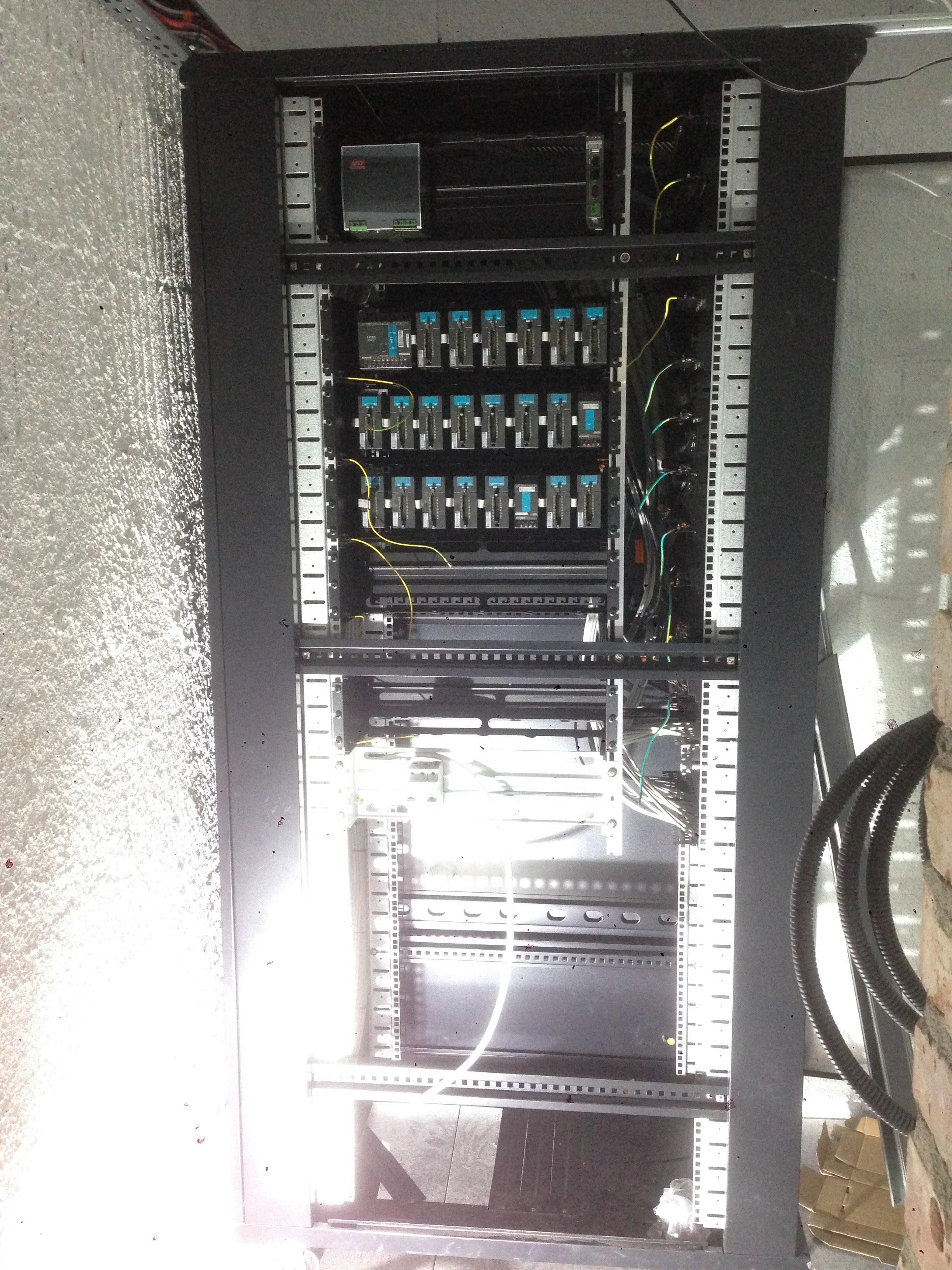

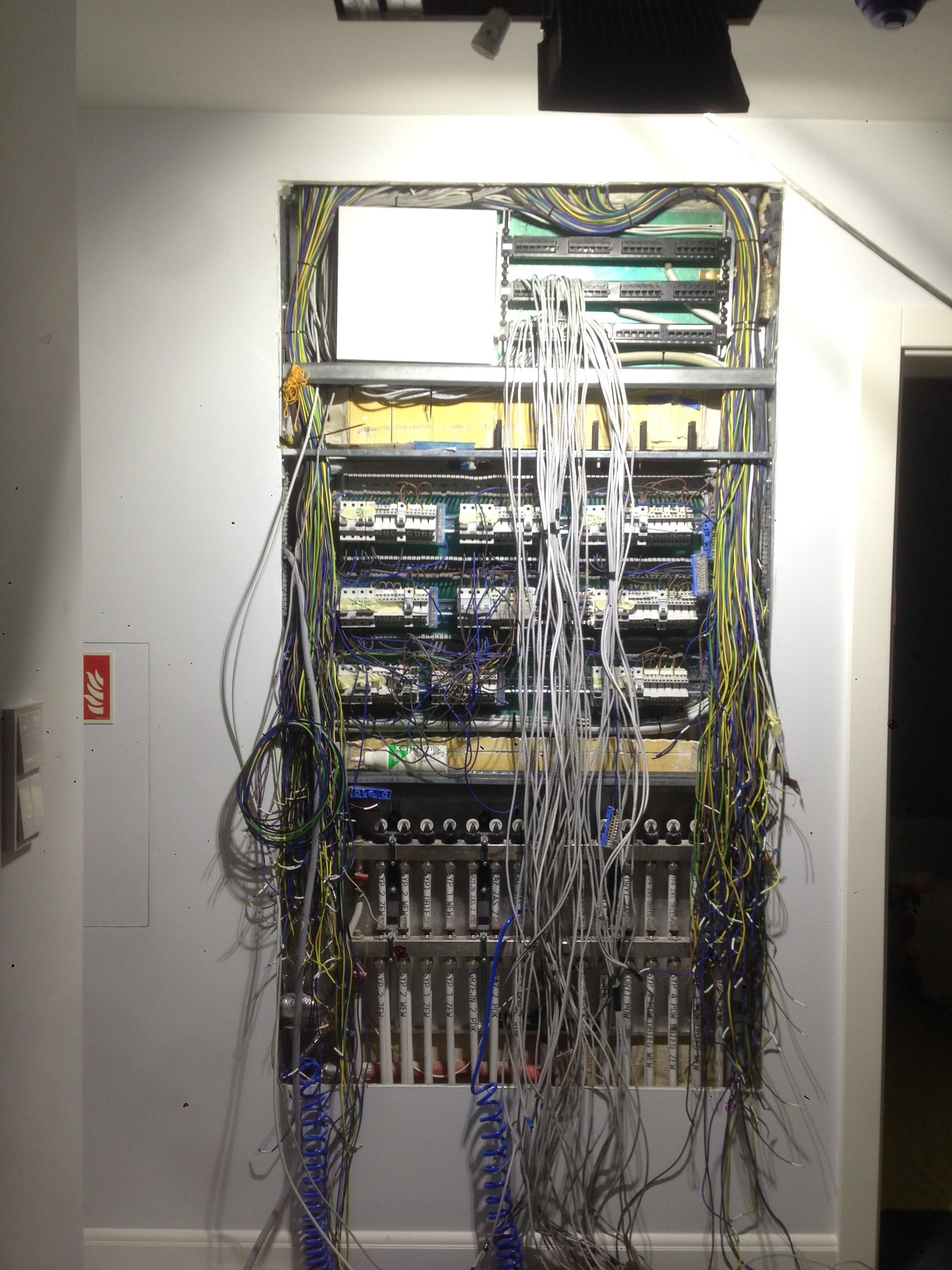

  • #9 16120096
    bresland
    Posts: 73
    Rate: 10
    I ended up plugging twisted pair cables from the bell buttons into the patchpanel in the intermediate distribution boxes.
    Contact board as terminal for PLC FATEK and UTP 5e cables - 24V, 0.1A/0.8A
    Route everything via multicore cables e.g. 4x50x0.6 to the central rack - there the cables are routed out to the patchpanel and connected via patchcord to the PLC
    Patchcord cut in half and connectors made on the cut end.
    Connectors plugged into PLC.
    I have dispensed with the contact board as the above solution seems clearer and easier to test or measure wiring parameters.
