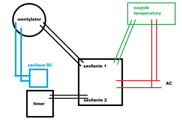

    Good afternoon, I am looking for a solution to the following issue.
    I have a fan (DC) running in continuous mode. I would like to connect it to some kind of controller which, when negative temperature is detected, would switch it to power with a timer running 15 mins on, 15 mins off, and which would return to continuous operation when the temperature rises.
    The idea is to achieve this effect: when the outside temperature is positive, the fan runs continuously, when it is negative it runs in 15 min on/off mode.
    I wanted to do this with a temperature controller , timer and automatic power regulator , which would switch to an alternate power supply with a timer after a loss of voltage from the temperature controller, but maybe there is a simpler way, because here I have as many as three devices?

    just take a look here and choose the right finished product available on the market.
    For example, the AR603 temperature controller should meet your needs:
    " time function (clock):-start signal: button or binary input START/STOP, power on
    -start of timing: after start signal or when heating setpoint is reached
    -supervised outputs: P1/SSR1, P2/SSR2
    -indication of timer operation: LED TIME, output P2/SSR2
    -setting range: 0 ÷ 8640 minutes (up to 144 hours)

    In the entry I just added a drawing, kind of illustrative. OK, so here's the thing: in recuperators there's a marvel called the "anti-freeze system" - this "technical marvel" is implemented in several ways, and each time is then sold for a lot of money. One way is to temporarily switch off the supply fan while the exhaust fan is always running. This way, when the temperature is negative, the warm air from the building heats the exchanger defrosting it or not allowing it to freeze at all. The blower fan simply pauses every 15 min for 15 min when the temperature is below 'some' (implicitly negative). The more 'fabulous' recuperators still have pressure switches to detect negative pressure - that's the magic of 'anti-freeze systems' for which you pay extra, e.g. PLN1,000.

    What you think is simple in concept, yes it is, but in the final implementation it requires a bit more resources and time, a bit more than 1k pln (on average somewhere 1000 times more :D ).
    A well made and working recuperator is quite a challenge to realise - even if you assemble it from ready made "blocks" .
    I still don't know what we are talking about, from the schematic - sketch it looks like your colleague wants to use some kind of DC motor?
    Not really suitable for exchange systems due to the speed, unless you use its properties for easy adjustment .
    Is this to be a mini recuperator or has your colleague also come up with an ingenious solution?
    Or maybe a mega-sized recuperator for the production hall , which would then explain the use of centrifugal fans with a gear drive DC motor (occasionally used nowadays due to drives with inverters not destructible) .
    Where did the colleague get the 15-minute defrost period from? At winter temperatures for our latitude, it may turn out that "defrosting the recuperator" and the recuperator itself will cool down the room while consuming energy :D .

    This is not to defrost the recuperator just to prevent frosting, in effect clogging the heat exchanger. If frost has built up in 15 minutes of "sucking in" cold air, then 15 minutes of blowing warm air through the recuperator in an attic where the temperature is positive should "defrost" it. Although a good point, perhaps the air supply should only stop once every hour for 15 minutes.
    The recuperator is supposed to be "mini", based on such fans: http://allegro.pl/noctua-nf-a14-industrialppc-3000-pwm-269-3-m3-h-i6005634349.html (yes, yes I'm not joking), according to this manual: http://www.builditsolar.com/Experimental/DIYHRV/DIYHRV.htm
    And after reading this topic (50 pages of interesting reading, with 3 realised and working recuperators): http://ecorenovator.org/forum/conservation/891-diy-ventilation-heat-exchanger.html
    By mini I mean a volume of 180 m3, two extractors, two supply air - each point no further than 3.5 metres from the air handling unit. Outside air and exhaust not more than 4 metres from the air handling unit. AHU in the attic, insulated ducts routed in the sheathing in additional insulation.

    How do you imagine the implementation on the hygrometer? Because I don't really understand how to make something like that with variable parameters of the input medium (air) quite large hysteresis of the system tripping , while maintaining a high efficiency of energy recovery?
    1. These heating mats are as a pre-heater? It makes sense, but eats up energy. The recuperator should defrost the exchanger "by itself", using the used and heated air from the house - probably more economical that way?
    2. How I imagine the whole system works. So:
    A) the whole thing is connected to a remote contact (radio control - PLN23 + remote control PLN28), when you want to ventilate the house with heat recovery it does a "snap" and the ventilation starts running at the speed set on the controller (it's possible that this ABB is a better solution although I still have concerns about its "pressure").
    B) regardless of being able to turn the system on demand, the fans are connected to the power supplies, these to the speed controller and this to the AVT1855 board. I set a value of 40 or 50 per cent humidity on the board, and when this value is exceeded the system turns on until the humidity is 'pulled' from the house to the optimum value.
    Independently of A and B, there is a 'safety' circuit which checks the air temperature just before it enters the recuperator and when it detects a value of, say, -1 deg it switches the air intake fan to run intermittently (as a colleague suggested 15/15 is probably not a good idea).
    Unfortunately such a system has a certain imperfection. A situation where, for example, it is constantly below freezing outside (e.g. 12 or 24 hrs) and the system only switches on to 'blow the moisture out' can lead to a situation where air is being pulled out of the house and not blown in. Assuming that the house is airtight, a negative pressure will be created which will "pull" cold air into the house through the leaks, but it will also pull it in through the supply duct, even without the help of the fan (the problem is smaller here because it will be heated on the exchanger).
    This is where the possibility of using a mat or heating cable comes in (we do not control the shutdown of the fan), but only check the temperature (of just what?) and switch on the mat.
    It would be a good idea to place a temperature sensor inside the exchanger (I think), in the cold air passage, and with it check what is the "condition" of this part of the exchanger. When its (the material? the flowing air?) is close to zero, we switch on the heating mat and now the question is what - the exchanger? the pipe supplying the air from outside? or maybe the chamber before the exchanger?
