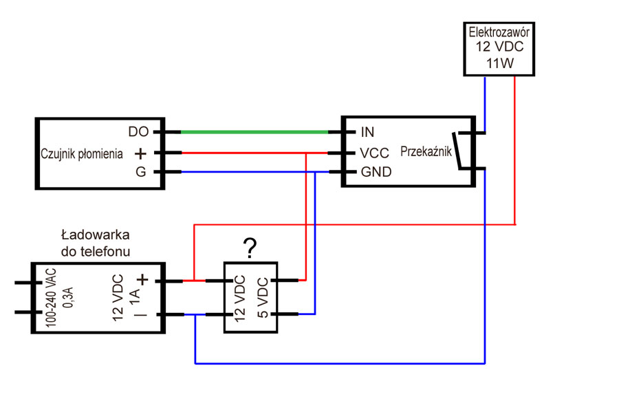

    Please check that I have drawn the connections correctly.
    I also don't know if the power supply used will cope, is it too weak?
    And I also don't know what relatively small device to use to get from 12 VDC, 5 VDC?

    On "paper" the connections are correct.
    The power supply is so on the "limit". But whether it is enough is hard for me to say because I don't know how much current the relay module draws. In addition, the solenoid of the solenoid valve on start-up may need more current and the voltage of the power supply may squat.
    Something like this should suffice as a stabiliser.
    http://automatyka.elstat.com.pl/p37748,modul-stabilizatora-5v-0-8a-lm1117-led.html
    And as I wrote before, if my theoretical considerations are correct (because I didn't have the flame sensor in my hands), in order to light the burner you will need an additional unstable pushbutton, i.e. one that short-circuits the contacts only when pressed and opens its contacts when released. The pushbutton is connected in parallel to the relay contacts.

    What device should be used to obtain 5 VDC from 12 VDC?
  • #9 16010680
    wiertacz
    Level 35  
    Posts: 1940
    Help: 312
    Rate: 384
    Just what I provided in the link above.
