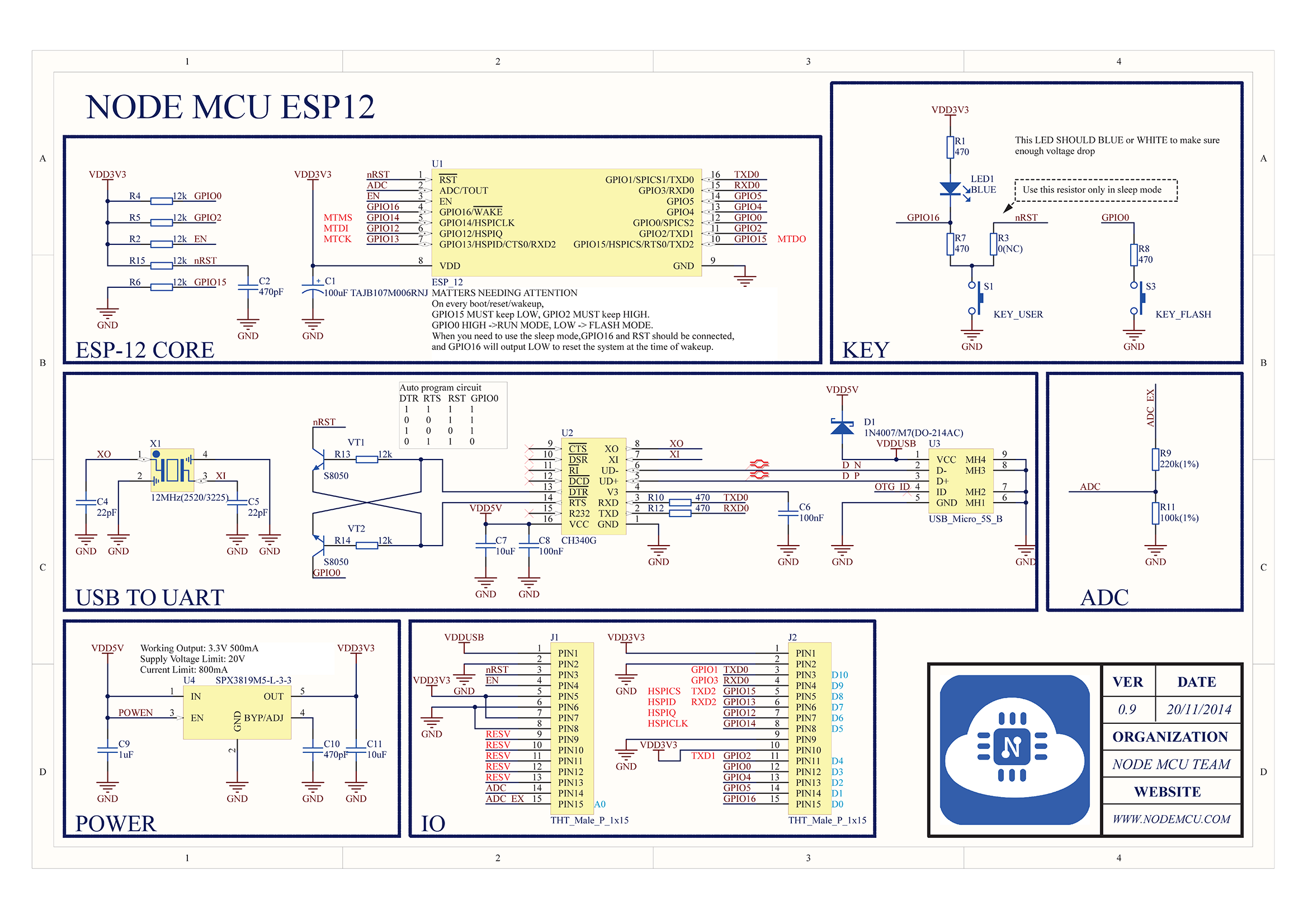

    Hello, I have a problem on how to power my circuit correctly. I want the whole thing to be powered by four batteries giving a total of 6V.
    Using a stabiliser I want to get 5V, with a current of 1A, and feed this to the VIN pin.
    I want to feed the dht22 sensor directly from pin 3V3 of my esp.
    However, I have a problem when it comes to the hx711 module, which also needs to be supplied with 5V. I cannot supply it directly from the esp, so I need an external source. The normal current consumption of the hx711 module is only 1.4mA. Does anyone have any idea how I should connect this?

    According to the note, this chip can be supplied with 2.6-5.5V, so you can easily connect it under 3.3V from the Nodemcu.

    only the strain gauge bar it will operate is 5-12V :(

    Then a logic state converter and problem solved. VCC to 5V and the two analogue lines via a 5v->3.3V logic converter or 1:1.5 resistor dividers to the Nodemcu.

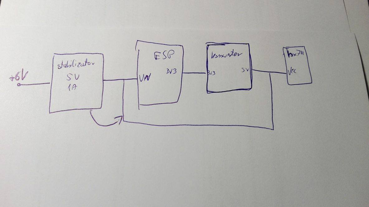

  • #5 16110794
    Poczatkujacy11
    Posts: 10
    So I can supply power via pin 3v3, but first I have to pass it through the converter to get 5V?
  • #6 16110885
  • #7 16110931
    Poczatkujacy11
    Posts: 10
    Such a thing? Should the stabiliser be where the arrow shows, since up to 20V can be to the vin?
