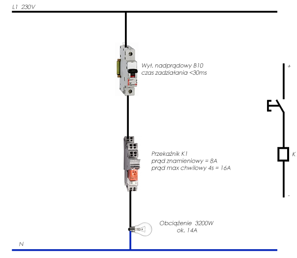

    I'm trying to make a smart home prototype.
    I have a dilemma which is best (briefly) shown in this image.
    Wago - 8A relay in a smart home system with Siemens S7 PLC - is it enough?
    Namely - I would like to use a Siemens S7 PLC to control relays to switch individual circuits. Lighting and some less loaded sockets.
    It is hard to find a relay with a higher load rating than 8A and having two connections at a good price.
    Is there a case for something like the picture? I.e. a relay with a smaller rating than the fuse in front of it?
    If the rated capacity is approx. 14A or even 9A, will the overcurrent circuit breaker trip first or will the relay burn out sooner?
    Maybe a silly question, but please answer.
    I hope the only solution is not to use 16A DC relays?

    If you have a 10A neutral, the 14 will not flow for too long anyway, and the 9A will overheat the relay sooner or later, so it's probably better to have a spare right away.
    For a neutral, the tripping current is 1.45XIn and it should switch off the circuit within an hour.

    Ok, so the only sensible solution would be to use more expensive relays up to 16A.
    With that 1.45Xln I was already completely confused about what this was about, but I've done some reading and am getting something there.
    It was supposed to be 16A AC not DC:-)

    For large 1-phase loads it is better to use a modular contactor e.g.
    https://www.tim.pl/stycznik-modulowy-16a-1z-0r-24v-ac-ict-a9c22111#
    The relay by definition has only one insulation gap between the contacts (the contactor has two) so it will burn out quickly.
    Then I have another question.
    The contactor you gave in the link is a contactor with a max load of 16A.
    Here I found a Wago 788-354 relay whose max load is also 16A ( Link )
    If I want to switch sockets in the house protected by a B16 overcurrent fuse then, given that a relay comes out cheaper, would it be better to use a relay or the contactor you have shown?
    And then there is a similar question - if I use a contactor/relay up to 16A max followed by a B16 overcurrent fuse, will this work or will the relay/contactor burn out?

    PiotreKK007 wrote:
    This brings me to another similar question - if I use a contactor/relay up to a maximum of 16A followed by a B16 overcurrent fuse, will this arrangement work or will the relay/contactor burn out?
    It doesn't matter.
    A relay is only allowed to interrupt one pole (L). The contactor has gasification chambers so it can interrupt both L and N at the same time. In your case, interrupting N would be pointless, so you can use the second track to double the interrupts for better arc quenching. The contactor will therefore be more durable, but also louder.
    The decision is up to you.
