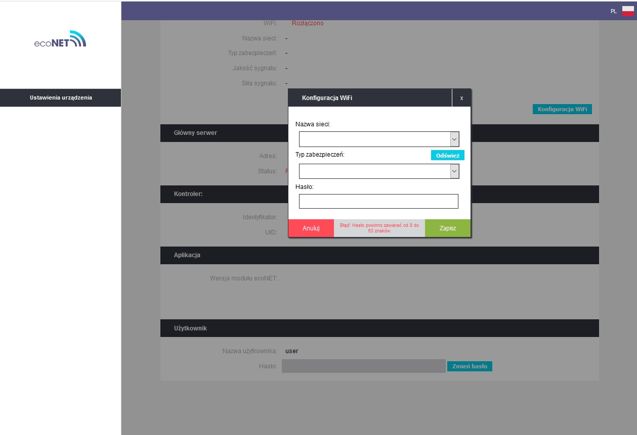

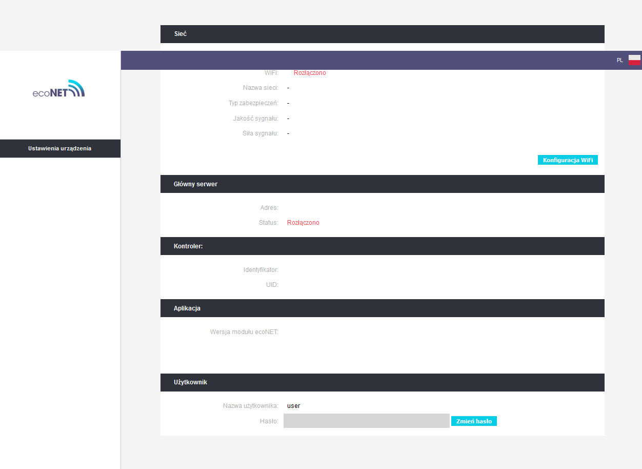

    I released mr
    I wanted to upload this file from przemo_ns and made a mistake.
    Due to the fact that it was not possible to upload econeta via the website, I tried to upload pure openwrt and bryndz via tftpd. it kind of uploads, but it starts up strangely. It connects to the network via spanking, no openwrt, while accessing the website shows some remnants of the econet Internet module ecoNet 300 and ecoLINK2
    and when you try to enter and search for wifi, it does not show any AP (it did not show before it worked) Internet module ecoNet 300 and ecoLINK2

    Hello after the break :)
    Econet works.
    Yesterday it was so late that I did not notice that after uploading a clean openwrt router got a different IP address and I was looking for the old one.
    What I was pasting was a browser cashe.
    Binarka from przemo_ns works and you can easily enter the router after SHA a user and pass to root.
    This program is very stripped down, loads of modules fail to run, even opkg, ls etc.
    dmeg works.
    As for usb and interface connection, only drivers for ftdi232 are loaded. no other will work.
    I tried to upload to the ch431 chipset, but it does not go.
    In any case, the econet is alive.

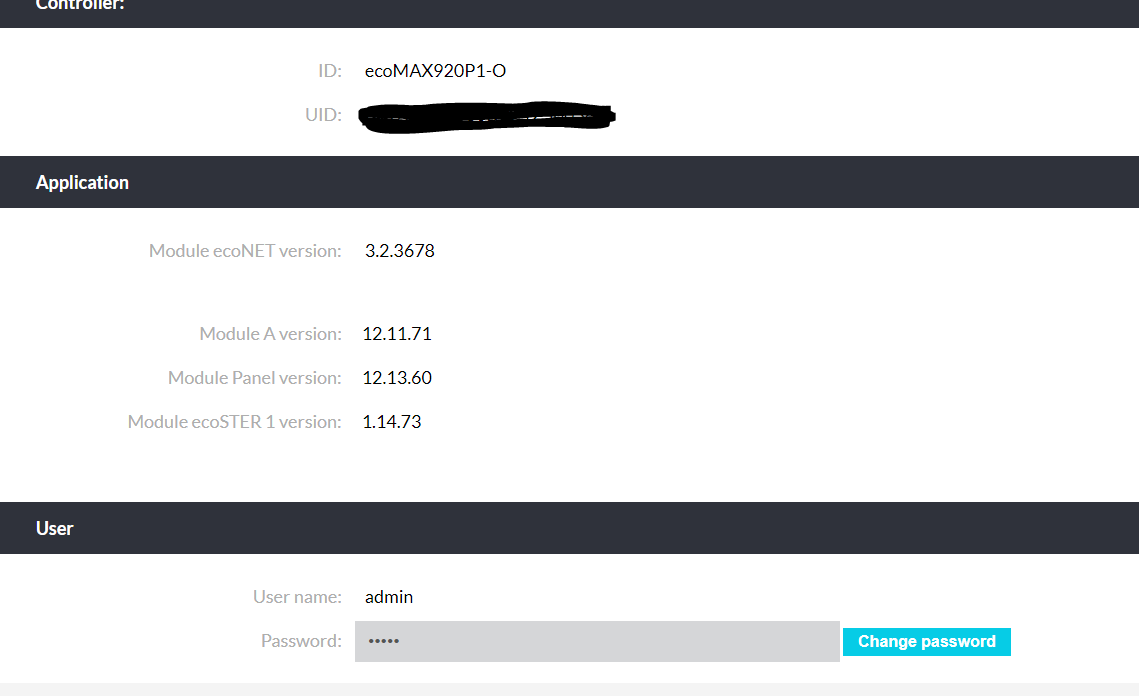

    Today my mr3020 came. First, openwrt via tftp, then Przemek's binary. I connected my USB-> RS485 converter (https://www.digitus.info/de/produkte/computerkomponenten/computer-peripheriegeraete/seriell-parallel-adapter/da-70157/) and the econet saw the stove. Suddenly there was silence in the logs (there was still information that he was looking for a USB device). Besides, I didn't notice any errors in the logs. On the app's website (the one served with mr3020), after logging in, I got my UID, I can see all the data correctly and also all my elements that I have attached to the stove. I also fired it on TP-Link TL-WDR3600 v1, which I am currently using to collect data from the furnace (also OpenWRT 18.06). So as for the hardware itself, it can be a different tplink, as long as it has a USB port and you need to redo the references to the LEDs, because the scripts have hardly any references and spam in the logs.
    • Internet module ecoNet 300 and ecoLINK2 ecomax uuid.PNG (19.27 KB) You must be logged in to download this attachment.

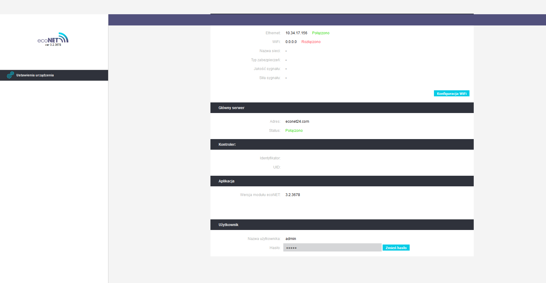

    SławekSS wrote:
    Hi
    Successfully uploaded this image .bin econeta posted by @kashue.
    the upgrade had to be forced, and as I had nothing to lose, I took a risk.
    Now I have an econet that connects to the econet24 server

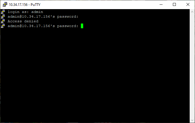

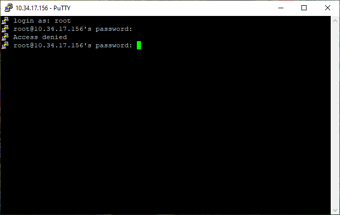

    I tried to enter via SSH but it asks for a password, unfortunately it is different than to the website
    Internet module ecoNet 300 and ecoLINK2 Internet module ecoNet 300 and ecoLINK2
    @ SławekSS
    Check what MAC address the router has now, econet authorization is done using mac, after ripping the flash from the router you can see it in hex after changing there is a message on the website that the device is blocked, changing the mac to another working causes the same symptom, i.e. somewhere in the software being stitched to the mac a second time that changing the visible mac is blocking communication
    Have you been doing clone registration? I have an econet and on the second router I did with the image posted here and after connecting I have the message device blocked
