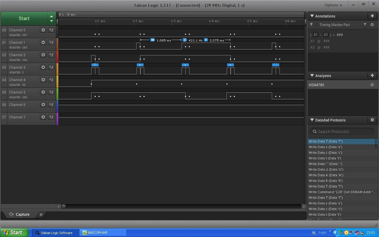

    Below I present the effects of viewing several protocols:
    - HD44780
    Continuous display of the text "Test UART" shown here:
    Brief description of the 8-channel logic analyzer on the Cypress system
    Analyzer settings for the tested protocol:

    Below is an example where the state of the processor port is changed every 1ms, fed to the first channel of the tested analyzer.
    As you can see - the program shows us the duration of the high state (described here as width - W), frequency - f and period - T. As you can see - you can choose what the program should show.
