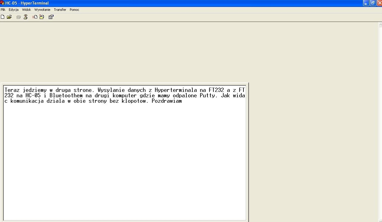

    The second part of the test is sending data wirelessly from one computer to another using the tested module. The distance between the computer and the module is approx. 6 m.
    In this test, I used a previously replaced computer, the tested HC-05 module and a second computer with Windows XP, to which a USB-UART converter built on the FT232 chip was connected. However, it should be remembered that our tested HC-05 module operates at the voltage level of 3.3V, therefore the jumper should be set to 3.3V on the USB-UART converter. On the second computer, "HyperTerminal" was used as the terminal. Here the converter is detected on the COM25 port, and below we have its settings for the "HyperTermianal" program.
    HC-05 Bluetooth module test - review and opinion
    From now on, we can communicate wirelessly between these computers thanks to our HC-05 module.
    In the "HyperTerminal" program, I turned on local echo in the settings so that what we typed on the keyboard can be seen in the terminal window. The effect of this should be that in the windows of both terminals we should see the same (as long as we transmit from the "HyperTerminal" - in "PuTTY" I did not find an option to enable echo, so we do not see what we enter in the "PuTTY" window ;) .
    I typed in the "PuTTY" window and on the other computer I received this message in "HyperTerminal" as shown in the image below.
    Since communication works one way, communication should work and the other way.
    To check in the "HyperTerminal" window, I enter the text:
    The "PuTTY" window shows exactly what was written in "HyperTerminal" on the other computer.
    As evidenced by the above wireless Bluetooth communication using the tested HC-05 module works correctly.

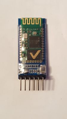

    I bought a bluetooth HC-05 with 6 pins. It connects nicely with the computer, telephone, but I can not enter AT commands. I've tried all the forums and documentation methods and none work. After pressing the button from the low state, the state goes high to the appropriate pin. Is the purchased module really HC-05? HC-05 Bluetooth module test - review and opinion HC-05 Bluetooth module test - review and opinion

    On PC, I use PuTTY on a Terminal phone. Pairing and communication is fine. I can see the entered values on the computer and receive it accordingly on the phone.
    The problem is with entering AT commands. After pressing the button before the power supply or during operation, it gives nothing. The state on Pin 34 changes from low to 3.3V. According to the documentation "
    Mode switch input. If it is input low level, the module is at paired or communication mode. If it's input high level, the module will enter to AT mode. Even though the module is at
    communication, the module can enter to the AT mode if PIN34 is input high level. Then it will go back to the communication mode if PIN34 is input low level again. "It does not work. The LED on the module always blinks fast no matter how long or when I press the button.

    Finally, I found a solution to the problem with accessing AT commands in the module with the help of "grala1" :)
    I started trying to connect to the module with "Putty", but the commands did not work in any way. I tried to press the button on the module before turning on the power or during work. Nothing worked. The next program is "hyperterminal". After a few hours, the commands were sent and received. I was able to change the name and the rest of the parameters. On the second day I wanted to reconnect to the module with the same settings, but it failed. Additionally, I have a problem with hyperterminal because after typing the 3rd character the program hangs for a few seconds and after typing the next character the same thing happens, and finally the module does not respond.
    After downloading "termite 3.3", the module is finally alive :) I can connect to it without any problem.
    OK ... but to the details ...
    My HC-05 is set to 38400 speed by default, 8 data bit, 1 stop bit, no parity. I can get to the AT command at any time before pressing the button on the module before sending the command to the module. Pressing the button before turning on the power or during in my case does not change the communication speed. Of course, the module cannot be connected to any other device. The LED flashing frequency does not change. Below the program settings (After changing the default speed from 38400 to 9600).
    IMPORTANT:
    1) I don't know what the "append CR-LF" means in the program, but without checking this, the commands don't work. I've tried turning on these options in previous programs but it didn't change anything.
    2) I wrote above about the communication speed along with the number of stop bits and parity, because you also have to enter these two parameters when changing the speed. By inadvertent, I had a little trouble figuring out why I lost the module after changing the speed ;)
