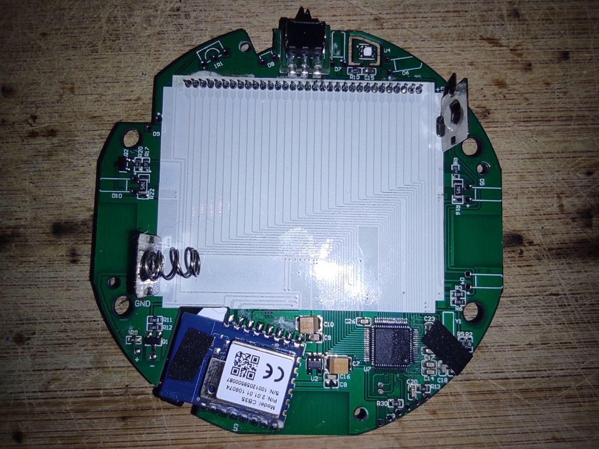

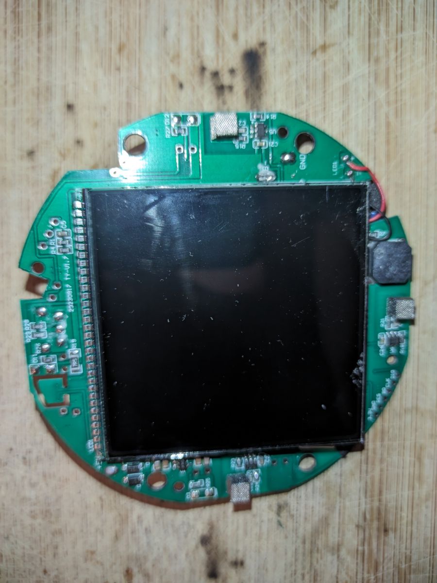

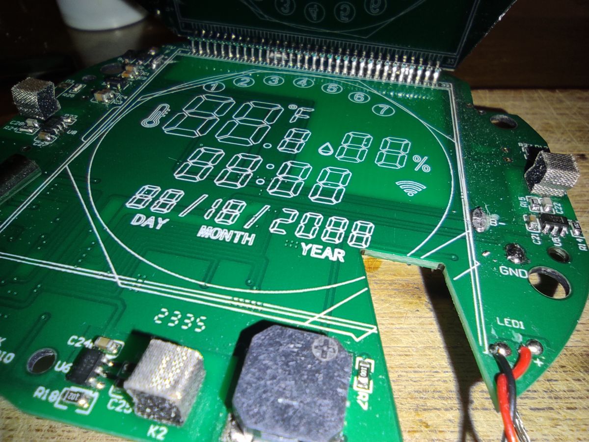

    The inside:

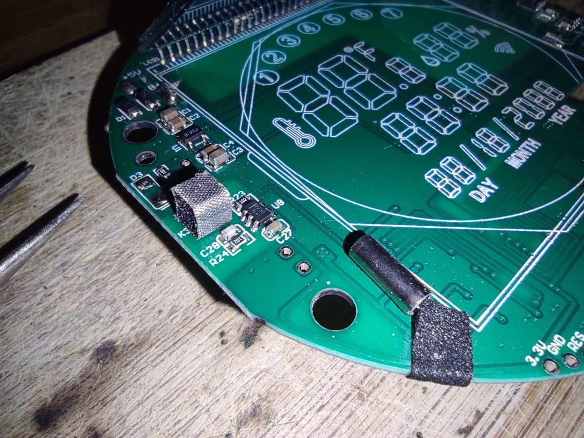

    Image of a round printed circuit board with various electronic components on a wooden background.Green circuit board with a mounted LCD screen.
    Circuit board with electronic components and a display.Close-up of a green printed circuit board with a digital display and electronic components.

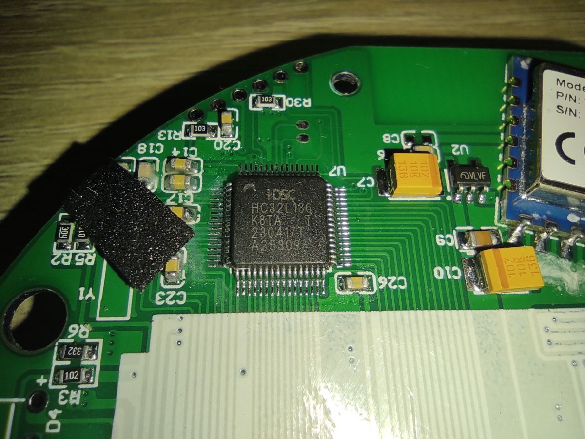

    It's a CB3S module aka BK7231N communicating with a HDSC HC32L136K8TA MCU.
    Close-up of a printed circuit board (PCB) with visible electronic components.

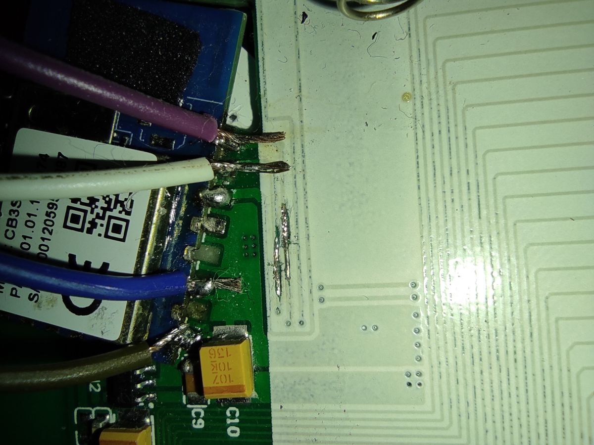

    CB3S is connected like the following :
    - TX1 & RX1 to MCU
    - P26 to unpopulated IR diode emitter
    - P7 to unpopulated IR diode receiver
    I desoldered two times the CB3S but damaged some traces.
    Then I soldered some wires and cut temporary main TX/RX traces.
    Close-up of a circuit board with soldered wires.
    As I did not want to get Tuya app, I decided to install directly OpenBK.
    With some tries and a new flag in the firmware, I manage to get my values and send them.
    This device is considered low powered cause it could be used on battery.
