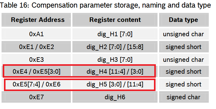

    I already have the moisture reading done, but I want to ask about the dig_H4 and dig_H5 .
    For what purpose under Register content at dig_H4 the information [11:4]/[3:0] , and at dig_H5 --> [3:0]/[11:4] ?
    It seems to me, that to correctly read the value of dig_H4 and dig_H5 only the information in the box "Register Address" is needed.

    czasnagli wrote:
    Why is [11]/[3] given under Register content at dig_H4 and --> [3]/[11] at dig_H5?
    The point is that in order to presumably save memory space they stuffed dig_H4/5 into two registers instead of, say, four. This, from the table, means that the 0xE4 register holds the bits 11 to 4 of dig_H4, while the bits 3 to 0 of 0xE5 hold the bits 3 to 0 of dig_H4. The analogy is the same for dig_H5. Note that both numbers are actually 12 bit values.
    It's a bit twisted and strange that they wanted to cram it into two registers by force. I remember that it takes a bit of work to read these values correctly. Not as simple as for temperature and pressure.

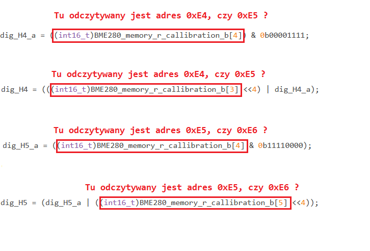

    Going back further to the "Register Address" I see, that at dig_H4 the bits are set in the correct order - from oldest to youngest [11:4]/[3:0] . However, with dig_H5 the bits are set in the wrong order [3:0]/[11:4] . If we want to read the 12 bit value dig_H5 then the bits should be set in this order [11:4]/[3:0] ?
    Thanks for the example you gave, but which registers are read when calculating dig_H4_a, dig_H4, dig_H5_a, dig_H5? I ask because I don't want to make a mistake at my place.

    Sorry for not specifying specific registers so:
    BME280_memory_r_callibration_b[3] is address 0xE4
    BME280_memory_r_callibration_b[4] is address 0xE5
    BME280_memory_r_callibration_b[5] is address 0xE6
    czasnagli wrote:
    If we want to read the 12 bit value of dig_H5 then the bits should be set in this order [11]/[3] ?
    Well literally as you write... with this humidity is probably the most messed up thing about this whole BME280....
    If you do as in my example from the previous post by substituting their addresses 0xE4-6 for the corresponding "BME280_memory_r_callibration_b" then these values will be read exactly as intended by the BME280 creators ;) .

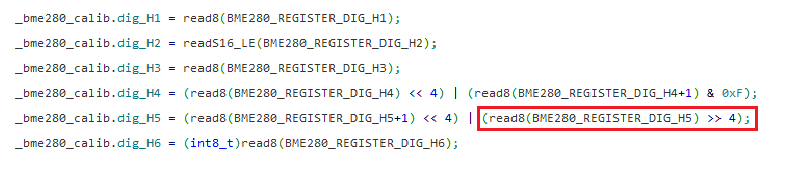

    I also found a simplified version of the reading dig_H5 without & 0b11110000 , but I don't know if it is correct.

    I also found a simplified version of the dig_H5 readout without & 0b11110000, but I don't know if this is correct.
    Yes it is correct, you can do that too and it will be ok.

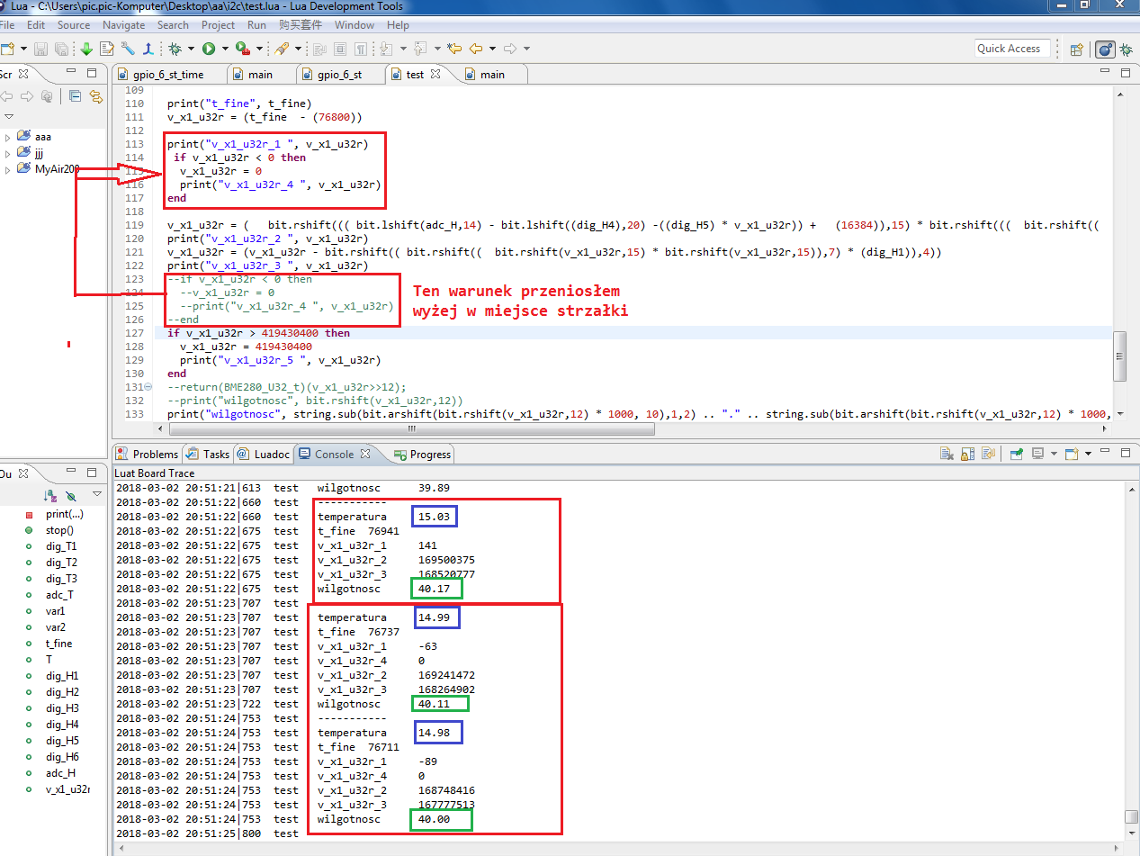

    The humidity reading works correctly, but only when the temperature is above 15°C . For example, at 15.03°C humidity is correct and is 47.42% but at 14.96°C the humidity is not correct because it is only 14.03% .
    Code: Lua
    I may have made a mistake by replacing this entry
    Code: C / C++
    such?
    Code: Lua
  • #38 17068191
    chemik22
    Posts: 115
    Help: 10
    Rate: 27
    Board Language: polish
    These conditions look cool. Strange these results because it clearly looks like these conditions don't work if it says you have the value v_x1_u32r = 588814594. I don't know how it is in Lua. But test yourself on some simple example if such a notation if "something there" then "something there" end works at all as you expect. In the terminal you will then find out....
  • #39 17070911

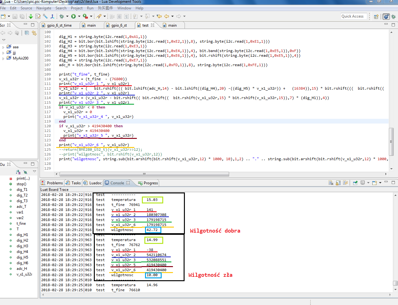

    In various lines of the script I inserted the printing of the variable v_x1_u32r to check the operation of the program. With the same colour, I marked the printed value of the variable v_x1_u32r_1 for temperatures above and below 15°C . In summary, it can be concluded that when the temperature dropped to 14.99°C it v_x1_u32r_1 took a negative value -38 . At that time, the calculated moisture content was only 10% , which is obviously an incorrect value.
    The variable marked in brown v_x1_u32r_5 was printed, confirming the operation of the second condition if v_x1_u32r > 419430400 . However, meeting this condition did not result in the calculation of the correct moisture content in the second case.
    Could the miscalculated moisture value be related to the fact that at some point the bit shifts are conducted on a negative number -38 ? The question remains about the first condition if , which did not work because the value v_x1_u32r was not less than zero.

    I checked in lua the correctness of the bit shifts on the number -100 . In lua after shifting to the left -100 <<4 I got the result -1600 . I got an identical result in this calculator --> http://calc.penjee.com/?s=vvAAAAlAJJehhhhlAJJ...JJeiiiiqslrAJJehhhhlAJJeiiiivvvlAJJbeAJJehhhh
    In lua after shifting to the right -100 >>4 I got the result 268435449 . I got an identical result in this calculator --> http://calc.penjee.com/?s=vvAAAAlAJJehhhhlAJJ...hhlAJJeiiiivvvlAJJbeAJJehhhhlAJJehhhlAJJeiiii
    If the above calculations are correct then the reason for the incorrect result of humidity below 15°C should be sought elsewhere.

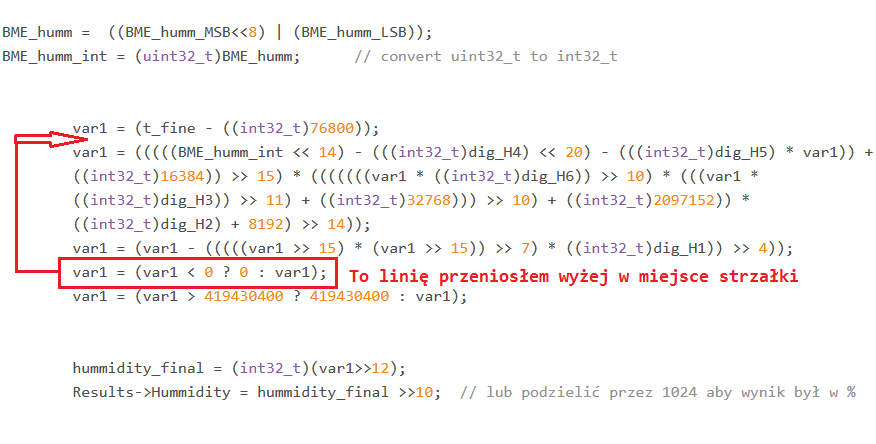

    Here's the code for humidity:
    Code: C / C++
    This can probably be simplified as well but with this notation it works without a problem.... I hope this solves the problem....

    Thank you for the code :) . Based on it, I checked my calculations but found no error in them. After doing this, I did one more test. I moved the line marked by the red box higher in place of the arrow and then cooled the thermometer to below 15°C . In the posted snapshot, it can be seen that moving the line var1 = (var1 < 0 ? 0 : var1) triggered this condition. The variable v_x1_u32r_1 --> -.63 was set to b5ca7bca6f 0 ( v_x1_u32r_4 --> 0 ), and the calculated moisture content appears to be the correct value. At 15.03°C humidity was 40.17% , and at 14.99°C --> 40.11% .
    Wouldn't moving the condition higher up falsify the moisture results? Can the line remain at this point?

    czasnagli wrote:
    Would moving the condition higher not falsify the moisture results? Can the line remain in this location?
    A bit strange that this condition depending on where in the code once works and once not.... Intriguing and incomprehensible...
    Generally such a change makes little difference because in the "old" place the condition should be caught faster (or slower) notice that the number var1 recalculated with the formula var1 = (var1 - (((((var1 >> 15) * (var1 >> 15)) >> 7) * ((int32_t)dig_H1)) >> 4)) is always less (or more) than the initial value depending on what character dig_H1 has....
    But something feels that it won't change much in real life because the humidity measurement is anyway with low accuracy so I think you can slowly start to enjoy a working sensor ;) .

    This is what I did and found the cause of the error. It turned out that shifting bits in a negative number with the function bit.rshift() is not a good idea. To shift bits in a negative number, use the function bit.arshift() . Below the result of the bit shift to the right for 4 (4 >>1) and -4 (-4 >>1).
    Code: Lua
    Now the humidity reading works correctly without transferring the condition. Thank you for your help. :D .
