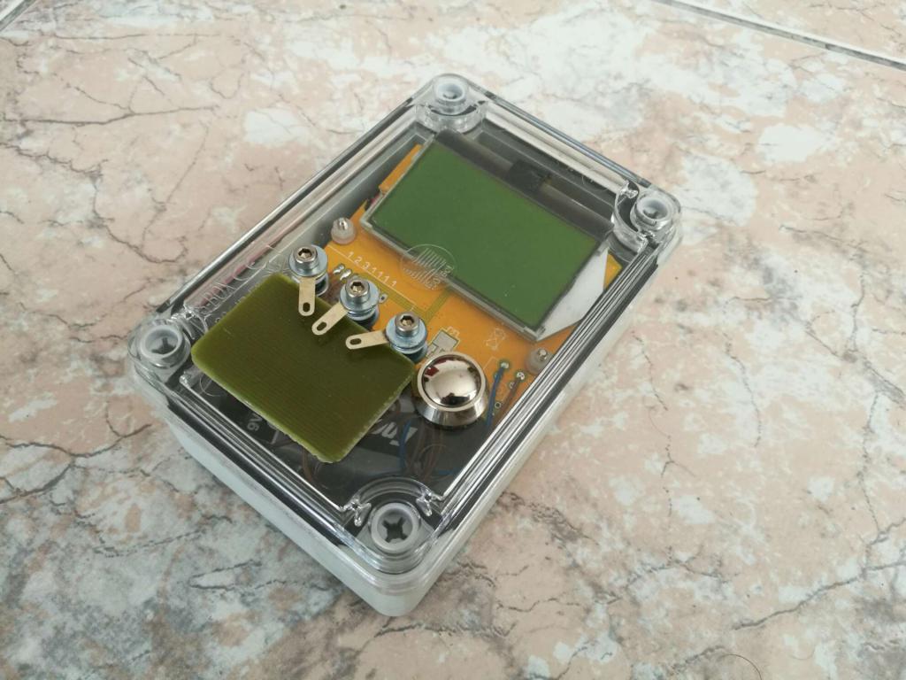

    I use an identical tester as in the first thread and for convenience and safety I put it in a practical, convenient and cheap housing with a transparent lid: LCR-T4 electronics components tester ATMega328 - Test and Review LCR-T4 electronics components tester ATMega328 - Test and Review The original ZIF socket is, let's say, moderate quality, and after a few times the plates are made and the elements are removed from the socket when placed in the socket will not have a good contact. The second problem related to this basis was the inability to place elements thicker than eg 1/4 resistors. In the legs - simply leads with a larger diameter than the legs of the power transistors do not fit and even destroy it. I quickly applied temporary - as it seemed to me at the time the solution, which turned out to be flawless for me and I would rather not change anything. LCR-T4 electronics components tester ATMega328 - Test and Review LCR-T4 electronics components tester ATMega328 - Test and Review As usual screws, insulating sleeves for transistors, eg TO220, soldered tips, washers and nuts are used. From the outside I placed a piece of laminate in case there was a need to solder the element, however, as so far, and I use a tester in this case, it was not necessary to solder for over a year. All measurements can be successfully performed by holding down the element pressed to visible terminals for a few seconds. In general, I recommend such encapsulation of the tester, cost about 20 PLN that is small, work a small amount, some glue from the gun and we are sure that nothing will damage and the tester will serve us a long time. LCR-T4 electronics components tester ATMega328 - Test and Review LCR-T4 electronics components tester ATMega328 - Test and Review LCR-T4 electronics components tester ATMega328 - Test and Review LCR-T4 electronics components tester ATMega328 - Test and Review LCR-T4 electronics components tester ATMega328 - Test and Review The housing used can be found on the auctions by entering in the search engine: HERMETIC SURFACE BOX 120x80x50 S-BOX 216P, there are different sizes and shapes, which makes them applicable also to other devices in my service.
