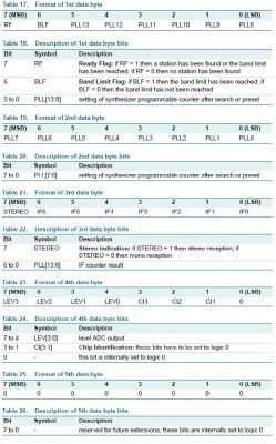

    Let's look at the documentation for the byte description in read mode. Below is a fragment of documentation where we have a description of bytes in read mode and an address for working in read mode.
    TEA5767 radio module from NXP - V2
    The first two bytes contain information such as:
    First byte
    - bit 7 - whether the station has been found or the frequency limit has been reached;
    - bit 6 - whether the frequency limit has been reached;
    - bit 5 to 0 - PLL 13 to 8
    Second byte
    - bit 7 to 8 - PLL7 to 0
    As you can see - the module found a radio station, and the frequency limit was not reached. If no station meeting the given conditions is found, the module will stop at the lowest or highest frequency (depending on whether it is looking up or down), i.e. 87.5 or 108MHz, and bit 6 of the first byte will be equal to 1. PLL in this case is 11000111101110 written in the binary system, which after conversion to the decimal system gives us 12782. Using the following formula:
    After the transformation, we get the following formula, where from the PLL we can calculate the frequency of the received station, the frequency with this RMF load:
    Therefore, it follows from the above that our module, when searching for stations, stopped at the frequency of 104.485144 or 104.5MHz.
    In the same way, we can calculate the frequency from which the module was looking for a radio station. PLL here is 11001001101001, or 12905, which gives the frequency 105.5MHz after the conversion according to the formula.
    Byte three, bit 7 tells us whether the station is received in stereo or in mono.
    From the reading we have 1, which means in this case that the station being received is in stereo.
    According to the documentation for the described fourth byte in read mode, bits 7 to 4 are the ADC level. In our case, the value read is 1100 (bin) = 12 (dec).
    According to the settings, our module was supposed to search "down" from the set frequency 105.5MHz - byte 3 bit 7 (0 - searching down, 1 - searching up).
    The search was to be stopped on a high signal, ADC output level = 10, byte 3 bits 6 and 5 (Search Stop Level).
    Summarizing all this, the module was to search for stations, starting from the 105.5MHz frequency, it was to look down and stop at the station with the ADC level not lower than 10. The module searched for stations with ADC level 12 on the frequency 104.5 so it was assigned conditions met. We also have information that this station is received in stereo.
