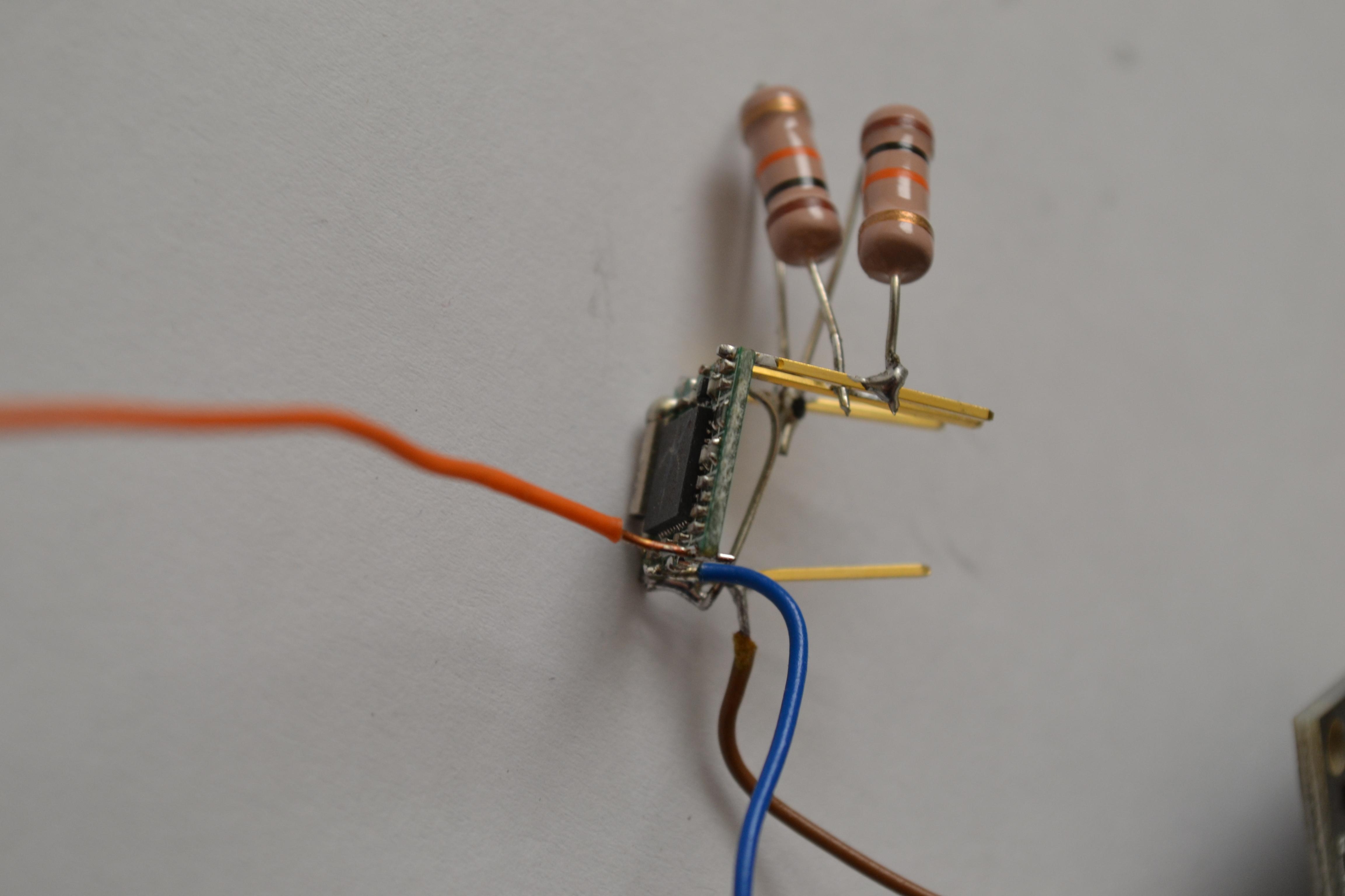

    BUS MODE is connected to ground so that communication via I2C works.
    As the module is really small and its raster is not standard, only 2mm, so it had to be dealt with somehow, and a "hybrid" as shown in the pictures below came out. :)
    TEA5767 radio module from NXP - V1

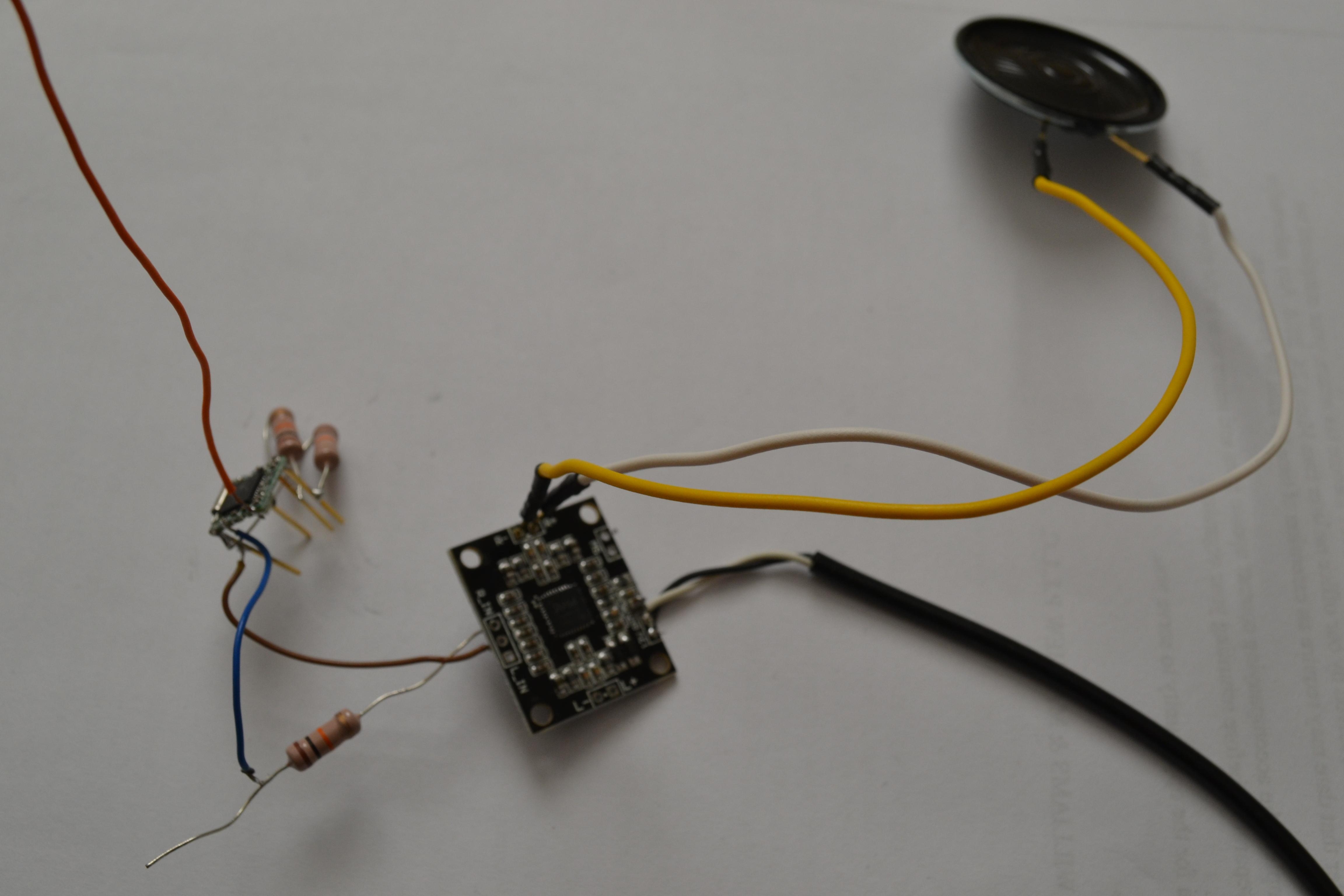

    It's about testing the module, not aesthetics, so forgive me - I did it on McaGyver and it's important that it works, next time I will try harder so that apart from the ears and eyes they can enjoy. ;)
    To control the radio, I used the ZL2AVR development kit, although a breadboard and a microprocessor that will send a few bytes using I2C - for example AVR or PIC or the popular Arduino is enough here.

    When starting this little radio it was without problems - the loudspeaker made a sound right after loading the program to the processor and pressing the button. The biggest problem in all this was only soldering this "hybrid", but I think it will not be a problem to use Google to find a library, eg in Eagle for this baby.
    As you can see from the photos - I used a piece of wire about 10cm long as the antenna and as you can hear on the attached recordings - the radio sounds quite good

    There is no revelation on this amplifier and loudspeaker, because it is a loudspeaker without any housing, taken out of a walkie-talkie, but by connecting headphones it sounds really good for my ear.
    Connecting to the audio input in the car, I do not see the difference between the sound from this module and the factory radio, but as I mentioned, I am not an audiophile.
    I think it's worth spending less than a dollar on this module.
