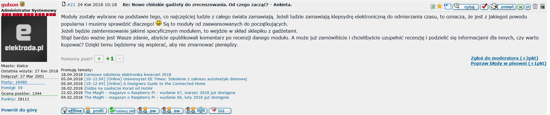

    gulson wrote:
    The modules were chosen on the basis of what most people from all over the world order. If people order an electronic hourglass for timing, it means it's popular for some reason, and we need to see why! :) There are modules from advanced to beginner.

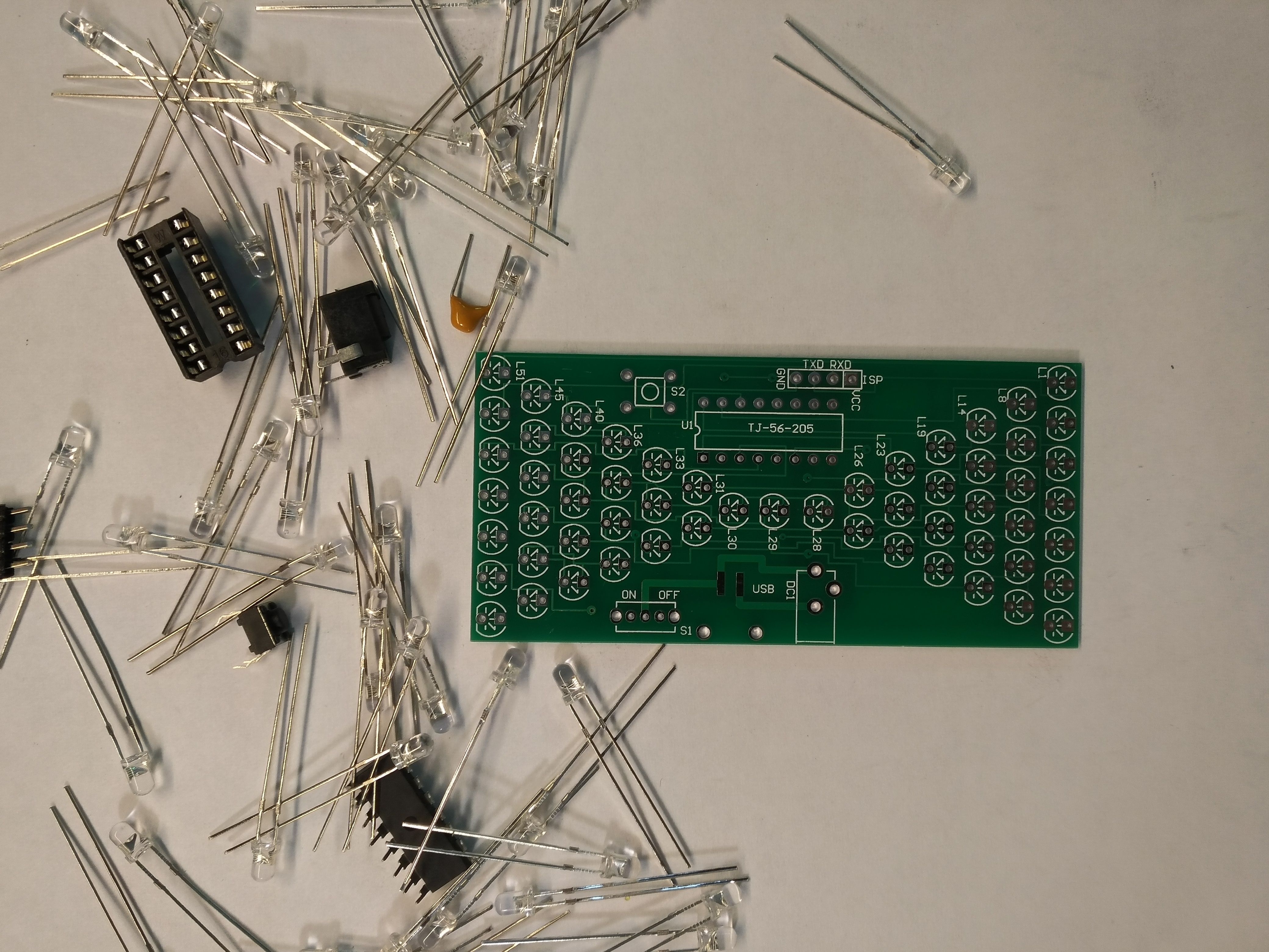

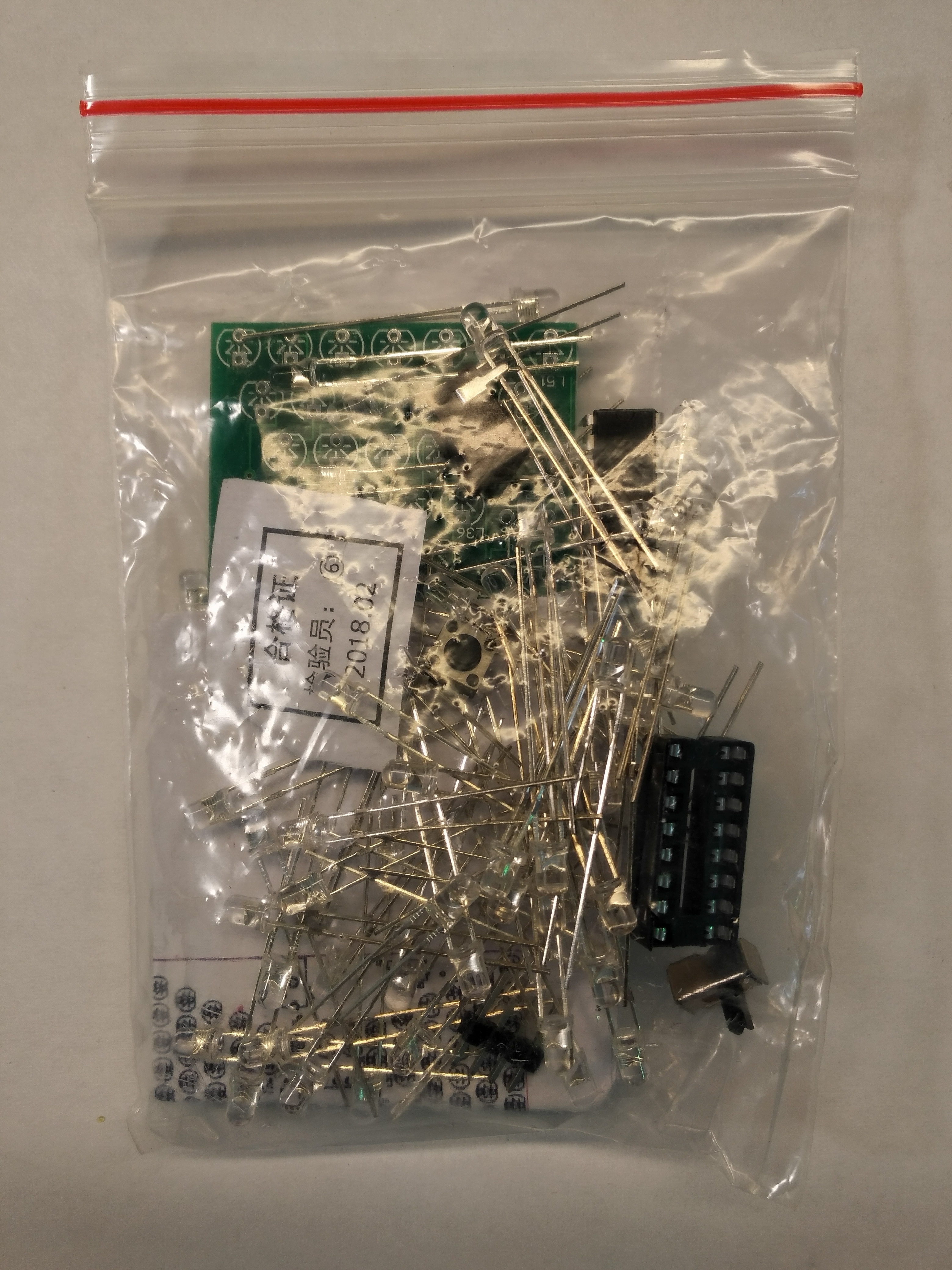

    Meanwhile, we get:
    LED hourglass for self-assembly - Made in China - Review. LED hourglass for self-assembly - Made in China - Review. LED hourglass for self-assembly - Made in China - Review.
    As you can see not much :( .

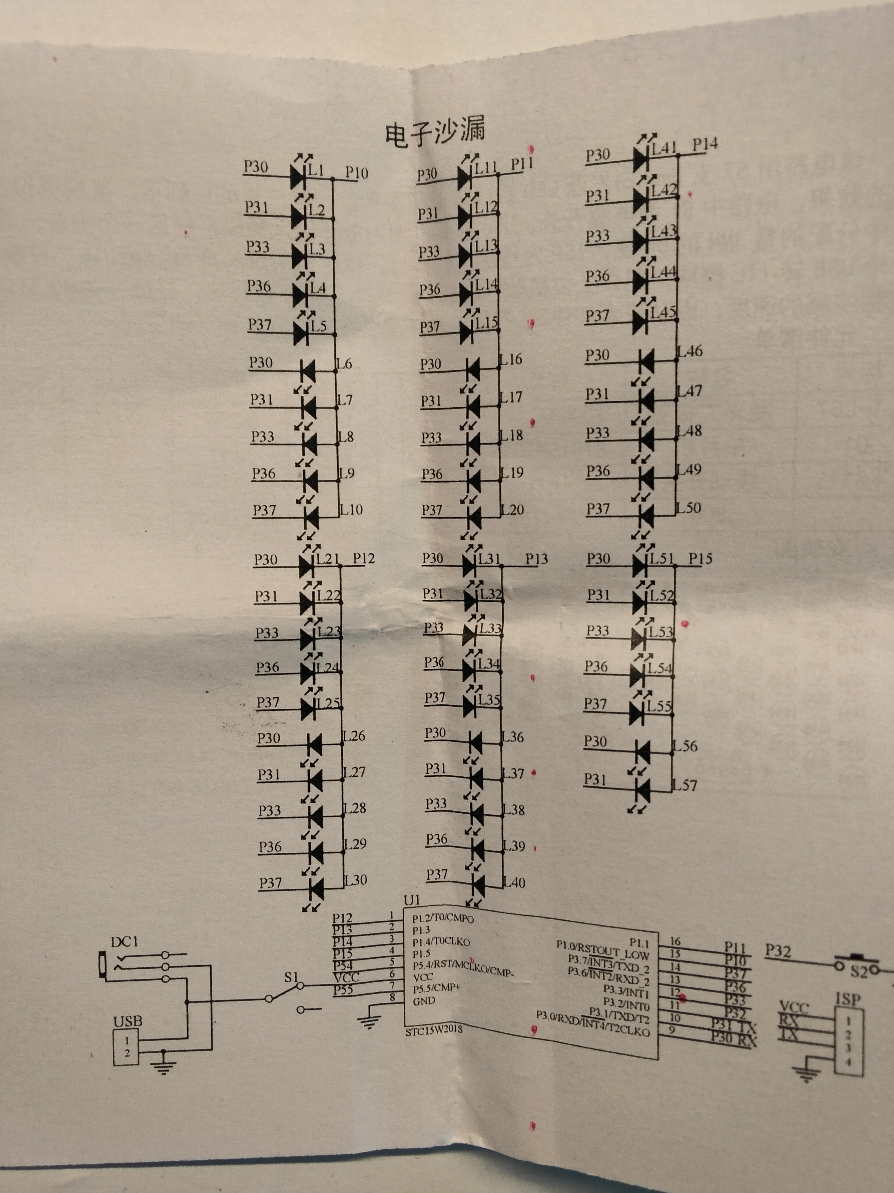

    We also have a diagram and a list of elements (I don't know why, but it is).

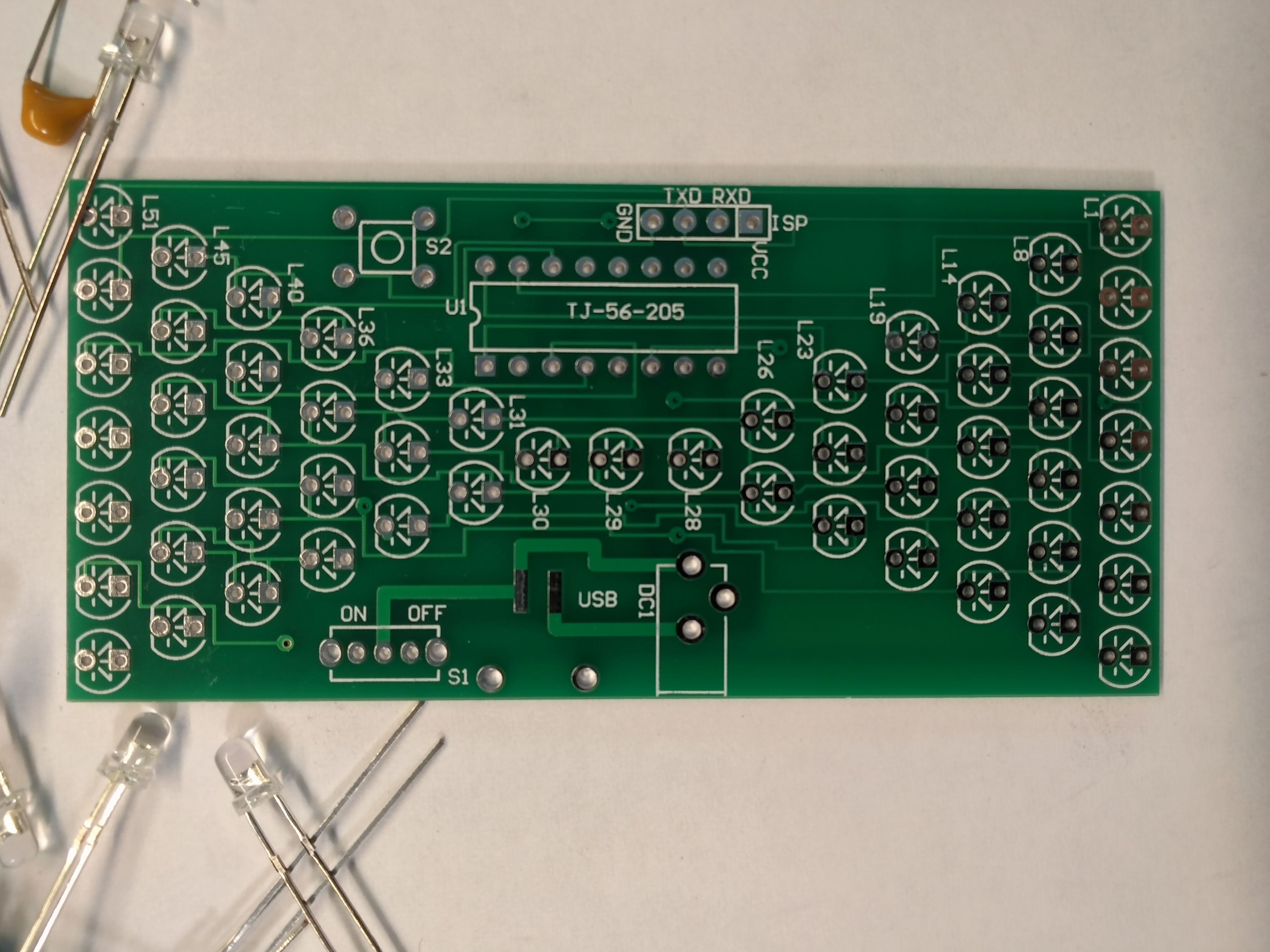

    The list shows that the set includes:
    1. 57 LEDs, blue in this case.
    2. STC15W201S chip pcs one.
    3. PCB with dimensions of 84mm x 41mm.
    4. DC Jack 3mm x 1.2mm. With a plus inside.
    5. ISP connector in the form of a four-pin goldpin strip.
    6. 5mm x 5mm microswitch momentary button.
    7. Power switch - miniature switch.
    8. The power supply of the system is 5VDC. We can put them on the DC Jack socket (then the switch works), or on the goldpins, as in the pictures. In this case, the circuit breaker will not work.
    9. The system starts at a voltage of 2.6V. At full voltage, it consumes 14mA.
    10. After assembly, a few more components remain, namely ceramic capacitor 334 and three diodes.

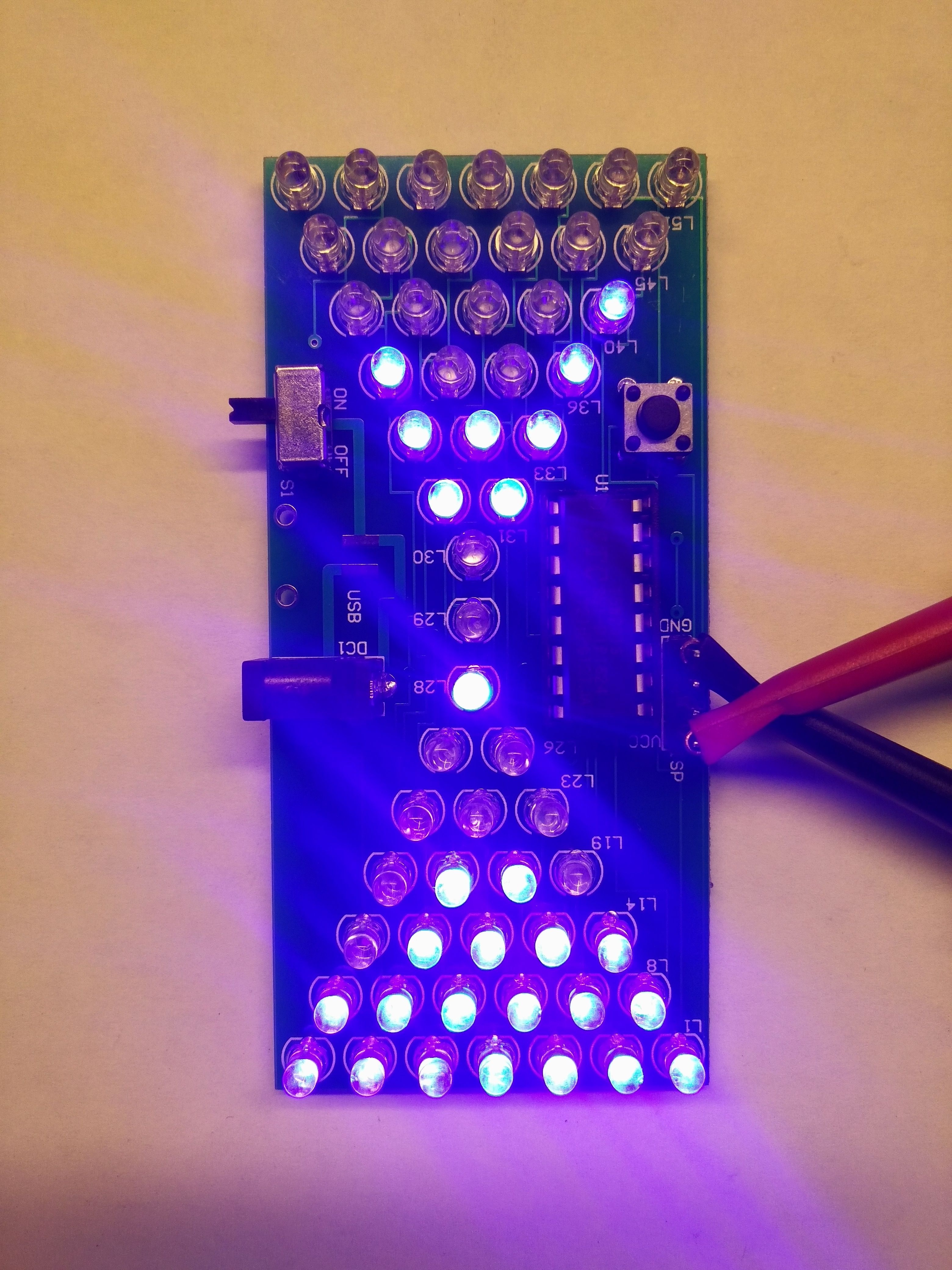

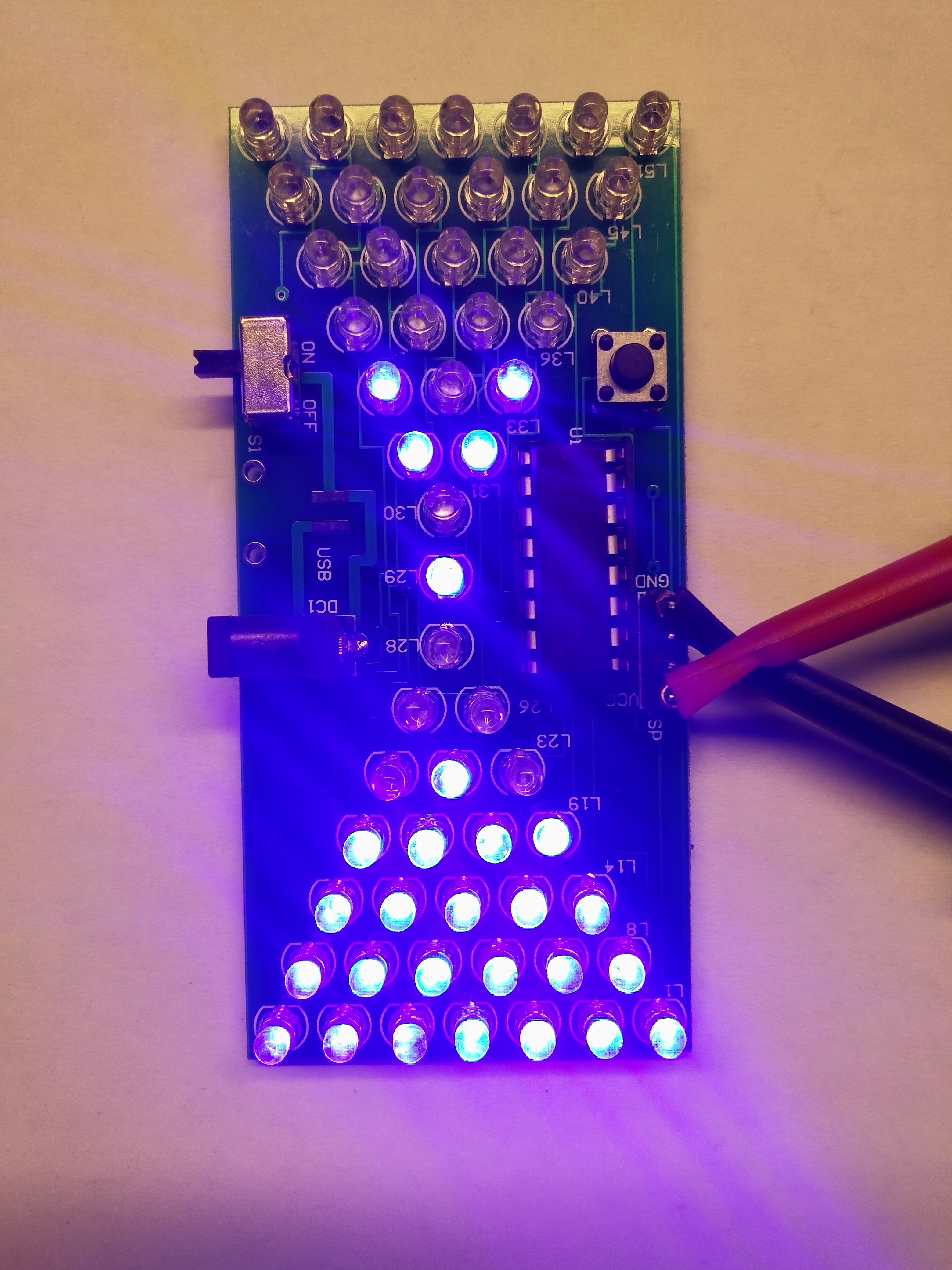

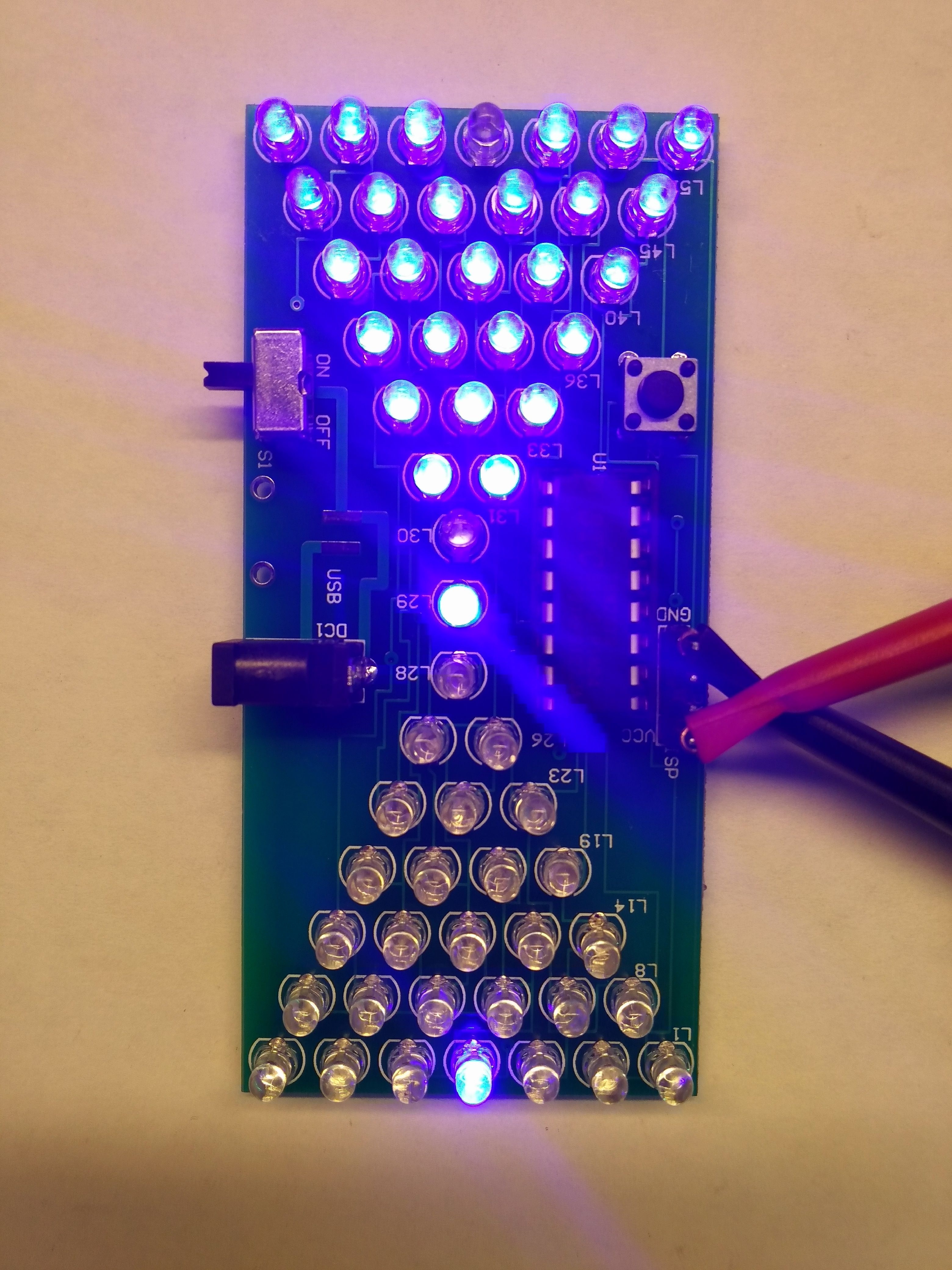

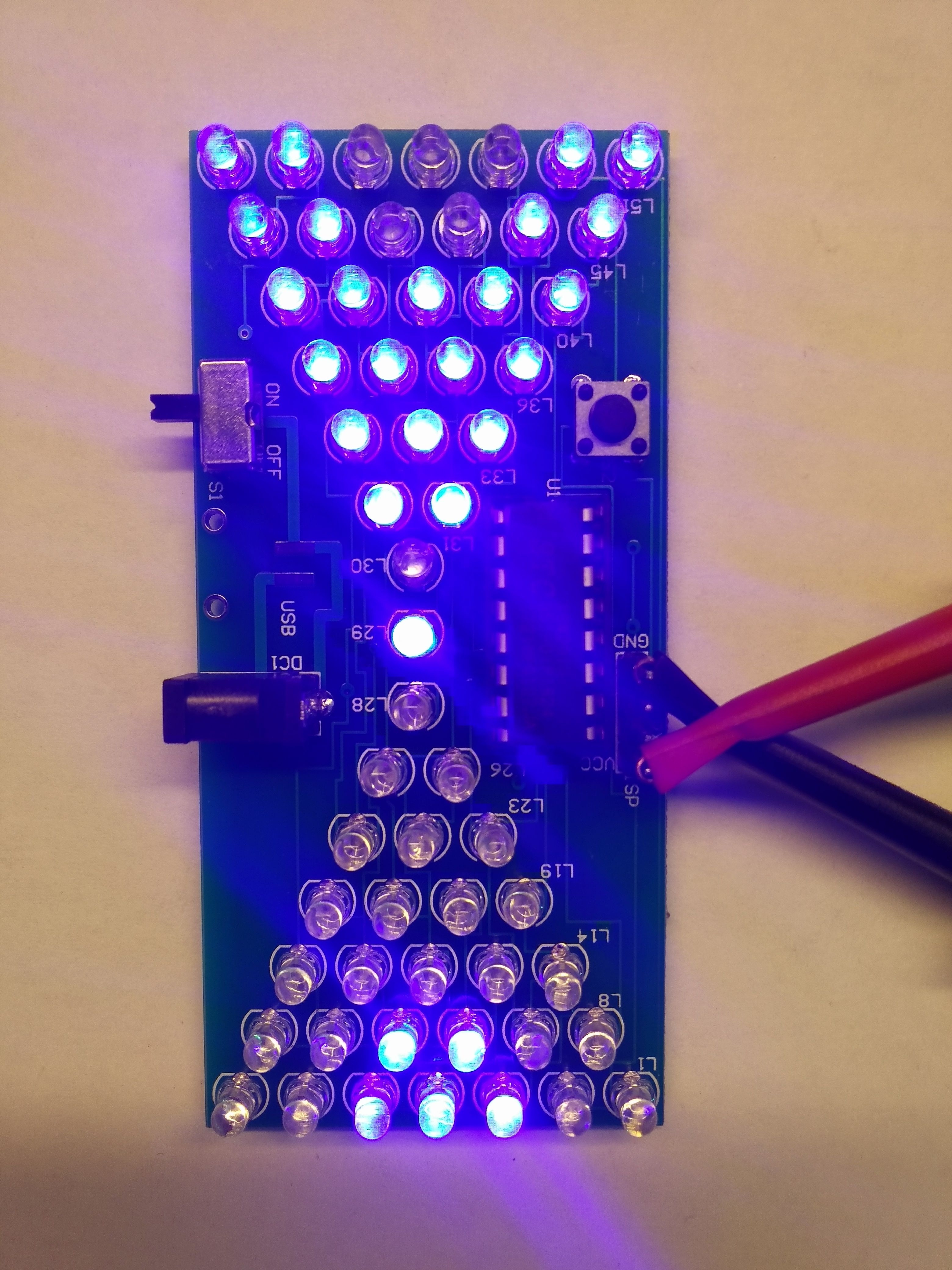

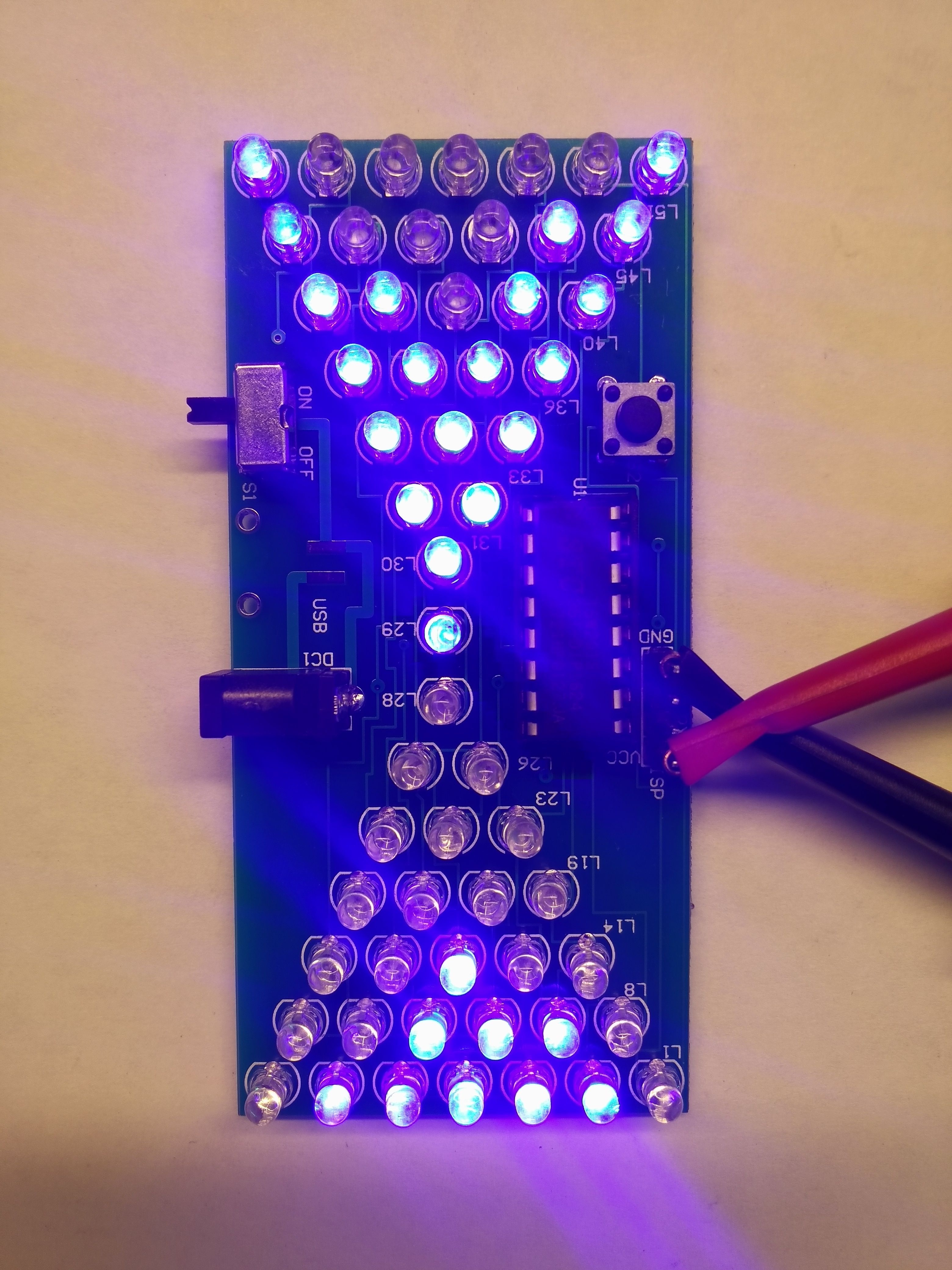

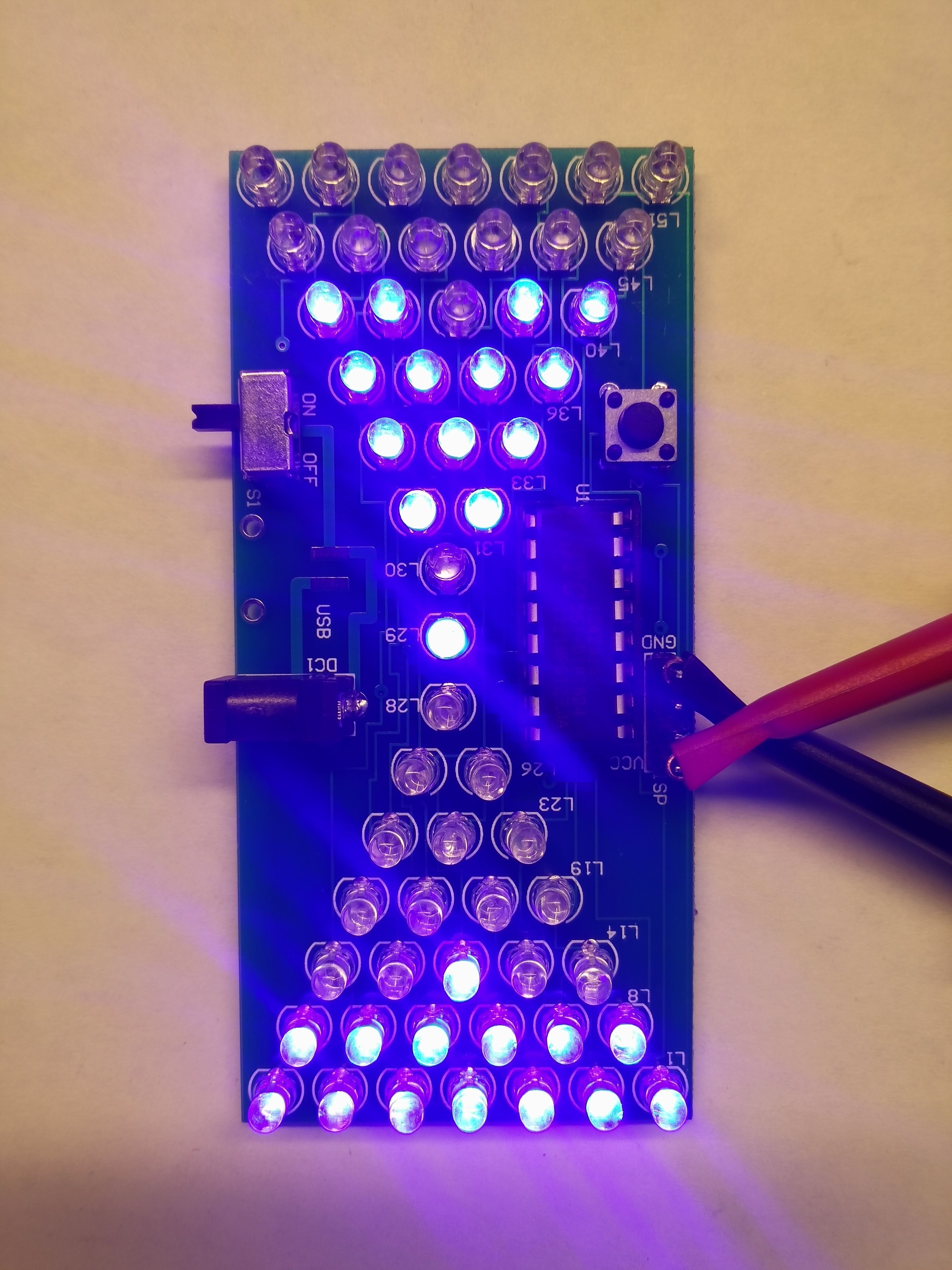

    After assembling. (And it took me a lot of time for such a small circuit. That's because of quite a lot of LEDs placed close to each other.) The circuit looks like this:
    LED hourglass for self-assembly - Made in China - Review. LED hourglass for self-assembly - Made in China - Review. LED hourglass for self-assembly - Made in China - Review. LED hourglass for self-assembly - Made in China - Review.
    After connecting the power, the hourglass starts in the default mode, let's call it slow. When we hold the S2 button for a few seconds, the second mode will be activated, let's call it fast. I have absolutely no idea what this gadget would be used for. Well, he gets tested and described, they do their job.
    Finally, two more videos of the action.
    Slow:
    Fast:
    As you can see, this is not any useful length of time. I have no idea why this crap is so popular on Aliexpress, or what people use it for.

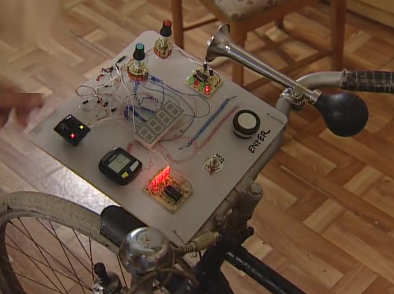

    Learning to solder?
    CMS wrote:
    nor what people use it for
    To a new time machine as he found :)

    It seems to me that such a kit will be the most popular among beginner electronics. I myself, when I started almost 20 years ago with Nord Elektronik and Jabela kits, I mainly bought various kinds of sparkles, glowing arrows, floating lights, dice, roulette, in general everything with leds was interesting. And there were no blue LEDs then. I also had hourglasses from Nord Elektronik, the NE113 set, I remember that it was based on the 4060 system, it was possible to adjust the "timing" with a potentiometer. Back then, this kind of kit cost a dozen or so zlotys at the end of the 1990s, so spending less than PLN 10 for such a twist today does not surprise me, only that here we have everything simplified to the maximum, only a microcontroller and LEDs.
    On the left I see a floating arrow, on the right a floating light, both from Nord Elektronik, I still have. As they say, it used to be :D

    CMS wrote:
    I really hoped it would be useful in some way.
    Unless:
    So I looked around and noticed that this controller (STC15W201S) in this toy, maybe an old school one, but it is quite interesting. From the STC website you can download an application that programs this bone through the most ordinary rs232 TTL. But this application, apart from flashing itself, is a whole combine with calculators (timers or baudrates), initialization code generator, demo applications (both C and ASM) and a source of relevant information.
    And the processor itself is an old, good 8052 but tuned so that, according to the manufacturer, it has the speed of the classic 8052 with a clock of 420MHz! Despite the mess in the documentation (as is often the case in Chinese companies), it seems to me that it is possible to complete the full knowledge on how to use this die.
    Here on the forum there are sometimes enthusiasts of assembler of old processors, it seems to me that the development of this controller (e.g. when a child gets bored as a toy) is probably the most simple way to get into the 8052 problem practically. .
