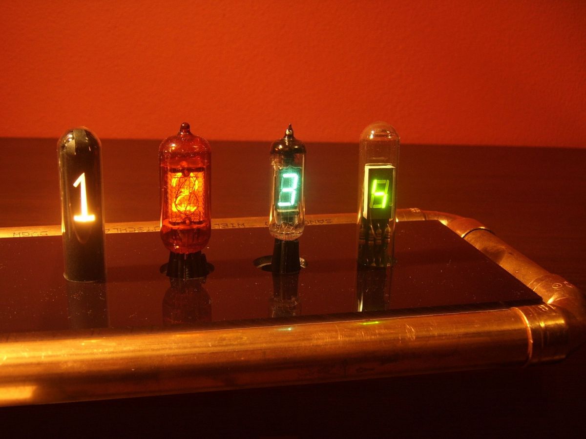

    We all have a fascination with tube displays from a bygone era, unfortunately their prices are a bit prohibitive and basically nothing can replace them. The aim of the project was to get at least a minimal approximation to the atmosphere of tube displays. All in all, what came out was quite an unusual creation :D . Everyone asks: What are these tubes?

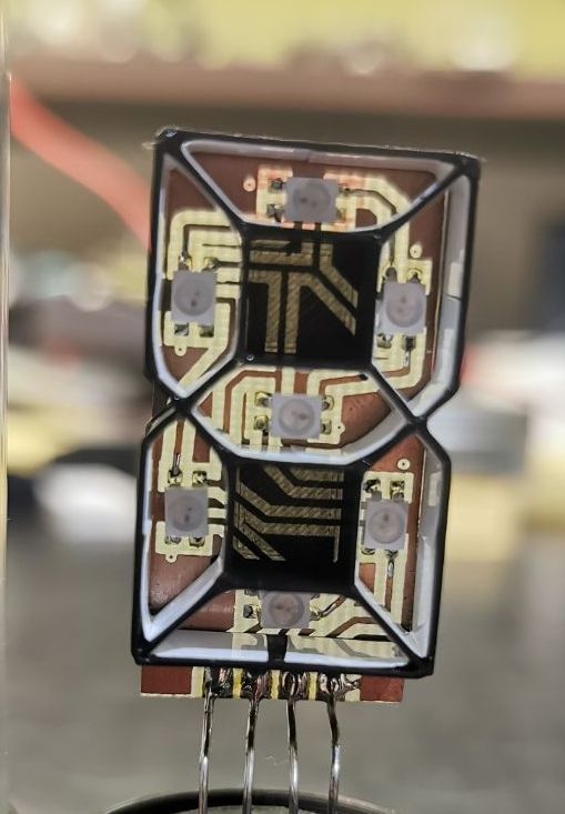

    The SK6812 mini-E LEDs (2.8x 3 mm) were used in the design, due to the small size of the display. These LEDs can be addressed similarly to the WS2812. This of course limited the number of wires connecting a single display to 4.

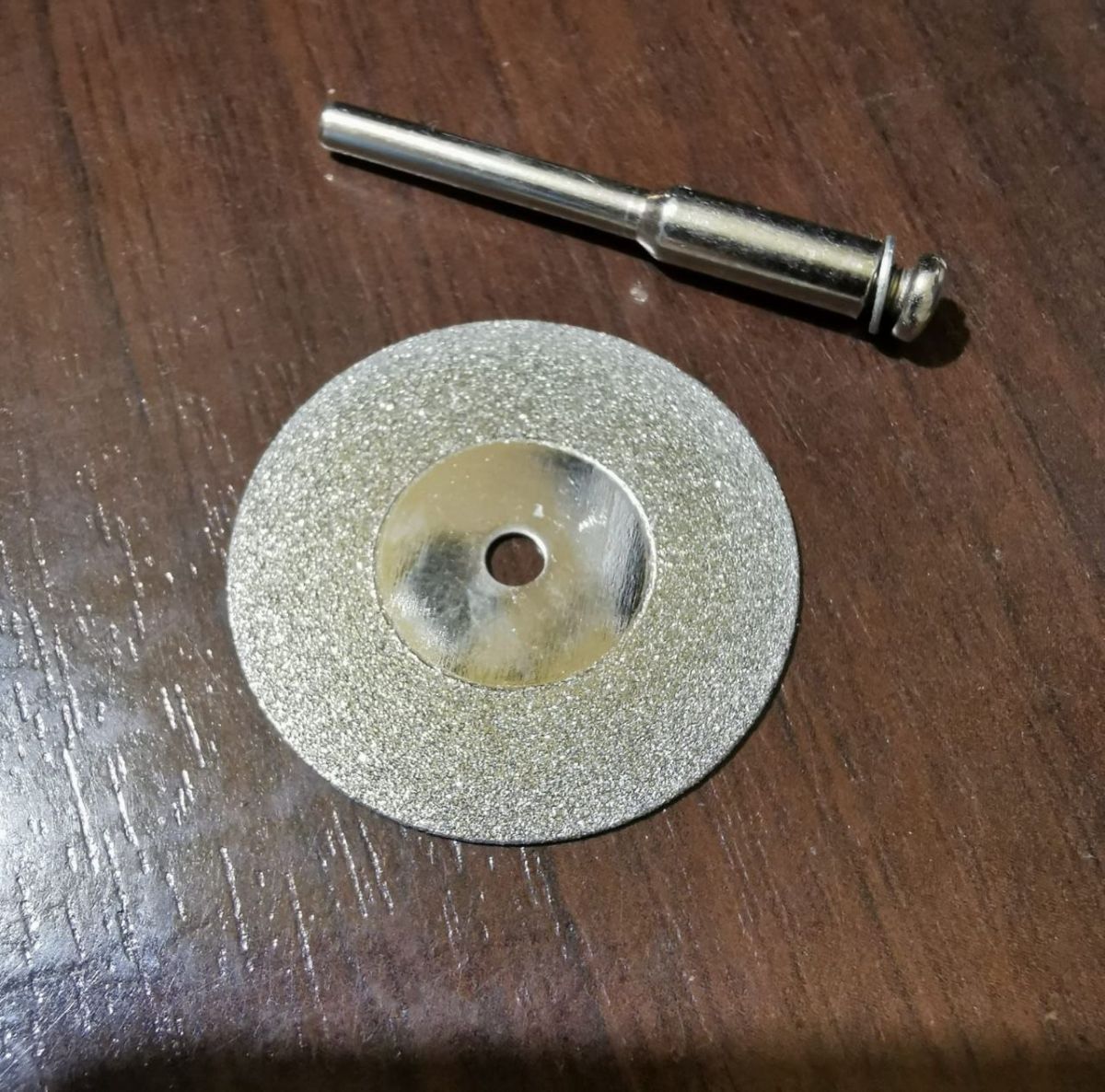

    Most of the components were printed. I obtained the glass bulbs from tubes with a diameter of 25 mm. I also looked for a larger diameter, but further down the line it's all bottles and jars.
    I cut the test tubes to a length of 80 mm. Cutting with a mini grinder with a diamond disc. First a scratch all round and then 2-3 rounds are enough.

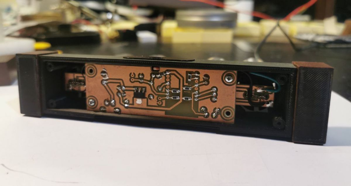

    The electronics are a handful of components. At its heart is the ESP8266. The displayed time is taken from NTP servers.
    PCB board with electronic components, including ESP8266 WiFi module. .
    Prototype displays. Digit height 30 mm. I tried to simulate a getter, but without success.
    Prototype LED display in a glass enclosure .

    Karaczan wrote:
    Very interesting idea with these pseudo Nixie.
    I've got a bit of such mesh, I'll poke around with the LCD screens to see if they come at least a little closer to VFDs.
    The mesh, at least the one I used (fan filter) has asymmetrical holes (you can see it in the picture) and "left" and "right" side (probably the effect of extruding the holes). When combining, it is worth paying attention to this and trying to rotate it 90 degrees horizontally.

    I thought it was a clock with Nixie type lights, which I like, but this one surprised me with this one.
    Beautiful thought and workmanship.

    Bravo for the original idea!
    At first I thought you had put an ordinary led seven-segment display in the tube. I once committed such a clock myself, in which each segment was displayed using a different technology (incandescent, nixie (neon), vfd (luminophore - fluorescent) and finally LED). Such a short history of electric light:
    Various types of numeric displays on a base. .
    After reading this, I noticed the details of the construction of the single display and immediately had a thought and a question at the same time. You wrote about wanting to simulate a NIXIE display. So why did you use a clichéd template from a typical 7-seg display? After all, you can go wild with non-trivial digit patterns e.g:
    Varied segment designs of numbers on a colorful background. .
    I recommend changing the typeface in your next watch :-) .

    Congratulations on your experiments. :) .
    And where is it that I wrote that the watch is supposed to simulate NIXIE?
    On the contrary, I wrote that quote: "All in all, it came out as quite an unusual creation".
    I was already about to write where the comparison of some commentators to NIXIE displays came from.
    Overall an experimental design and there is a lot to change here. Once you remove the grids and set the right colour, it will look like a VFD sooner. :) .
    Combinations with the getter have nothing to do with NIXIE either.

    efi222 wrote:
    why the comparison of some commentators to NIXIE displays.
    Ok - the design of the 'lamps', the mesh on the front and the mention of the getter evoke an association with NIXIE. Although the shape of the digits brings to mind more of a VFD.... But that was just such a preface.
    In the main part of my post, I suggested changing the typeface to something less typical - which is asking for it with such a display design!
  • Suggesting a less typical font for the display

  • Glass cutting and edge rounding method
    #25 21359930
    ArturAVS
    Moderator
    Posts: 26413
    Help: 2303
    Rate: 7830
    efi222 wrote:
    It is possible to cut these slides with a diamond minitool?
    I haven't tried, but I doubt it. Take a look:
    Once upon a time, I used to cut tubes from fluorescent tubes by wrapping them at the point of cutting with resistance wire and heating it up. I then poured water over them. One in several cracked.
    In order to round off the edges, I put the glass in the oven for a while and treated the heated edges with a blowtorch. The glass gained some "fluidity" and the edges rounded slightly. Then tempering in the oven for a few dozen hours until the chamber cools down. Much depends on the thickness of the walls. Boro-silicon glass is best (unless there are newer alloys). In general, I guess the typical laboratory glass is resistant to heat treatment and shrinkage.
  • Borosilicate tubes cut by scoring and grinding
    #26 21359968
    efi222
    Level 22  
    Posts: 779
    Help: 12
    Rate: 1219
    The tubes used in the project are boro-silicon. I just cut them off with a small grinder. So much so, you can't drive "sharply" into the glass just contour to deepen the scratch. After three - four such rounds, the glass is cut (2 - 3 minutes). Then the cut edge is sanded on the outside with an angle grinder. Inside with a small abrasive stone. But you can also over-melt the edges as you write. The guest in the video is clearly a skilled magician. :) .

    @efi222 in the wet?
  • #28 21359985
    efi222
    Level 22  
    Posts: 779
    Help: 12
    Rate: 1219
    @ArturAVS . Well that's just it dry... At first I tried to soak the disc a bit, but this water was splashing out to the sides anyway. Another test tube cutting and dry sanding. When cutting, the slide should lie on something soft so that it "doesn't ring". For the next cuts I will make a small film.
    35x0.6 mm disc.
    Diamond cutting disc with a diameter of 35 mm and thickness of 0.6 mm on a wooden surface. .
  • #29 21359994
    ArturAVS
    Moderator
    Posts: 26413
    Help: 2303
    Rate: 7830
    Glass is only wet sandable, it is too brittle a material for dry sanding. Instead of using a sander, you can use 1000-2000 "water-based" paper, especially as the glass will break if you put a little pressure on it. To roughen the edges, such paper is just the right thing. If you have already cut the edges, use a tray of water+paper and go.
