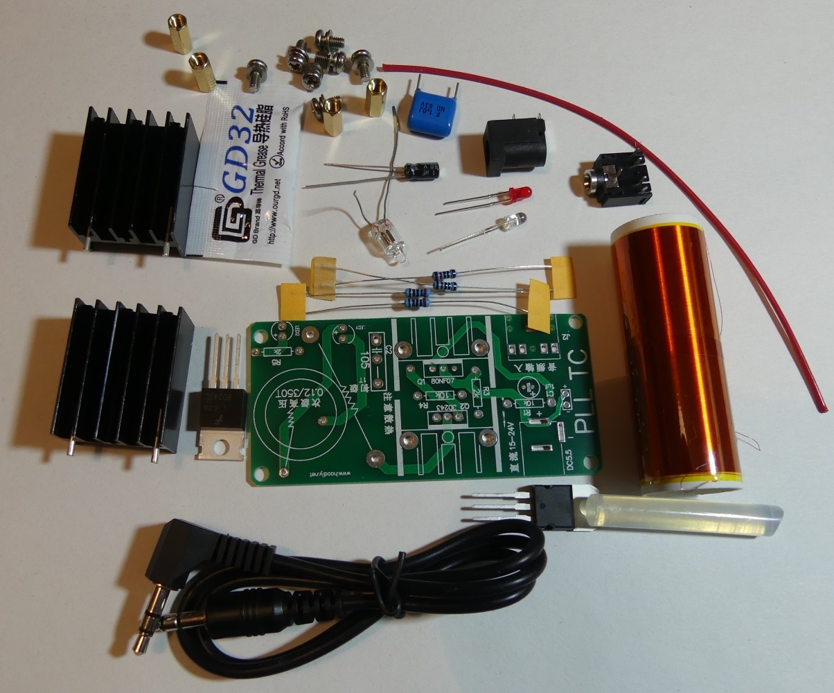

    The set includes a plate, a set of elements, thermal glue for mounting the coil, thermal paste for mounting transistors on heat sinks and a neon lamp to check the operation of the device.
    Tesla Electronic Miniature Coil - Assembly Kit
    The assembly should begin with the smallest elements (resistors), through connectors, capacitors, etc. The transistors should be mounted on the heat sinks using screws (apply silicone paste to the contact surface before assembly). The coil of the air transformer is ready and secured with Kapton tape. One end of the coil is soldered to the board as described, the other end is left in the air (there will be a corona discharge on it). The assembly is carried out as described on the PCB. Surround the air coil with one turn of the attached wire and solder it as described on the board.

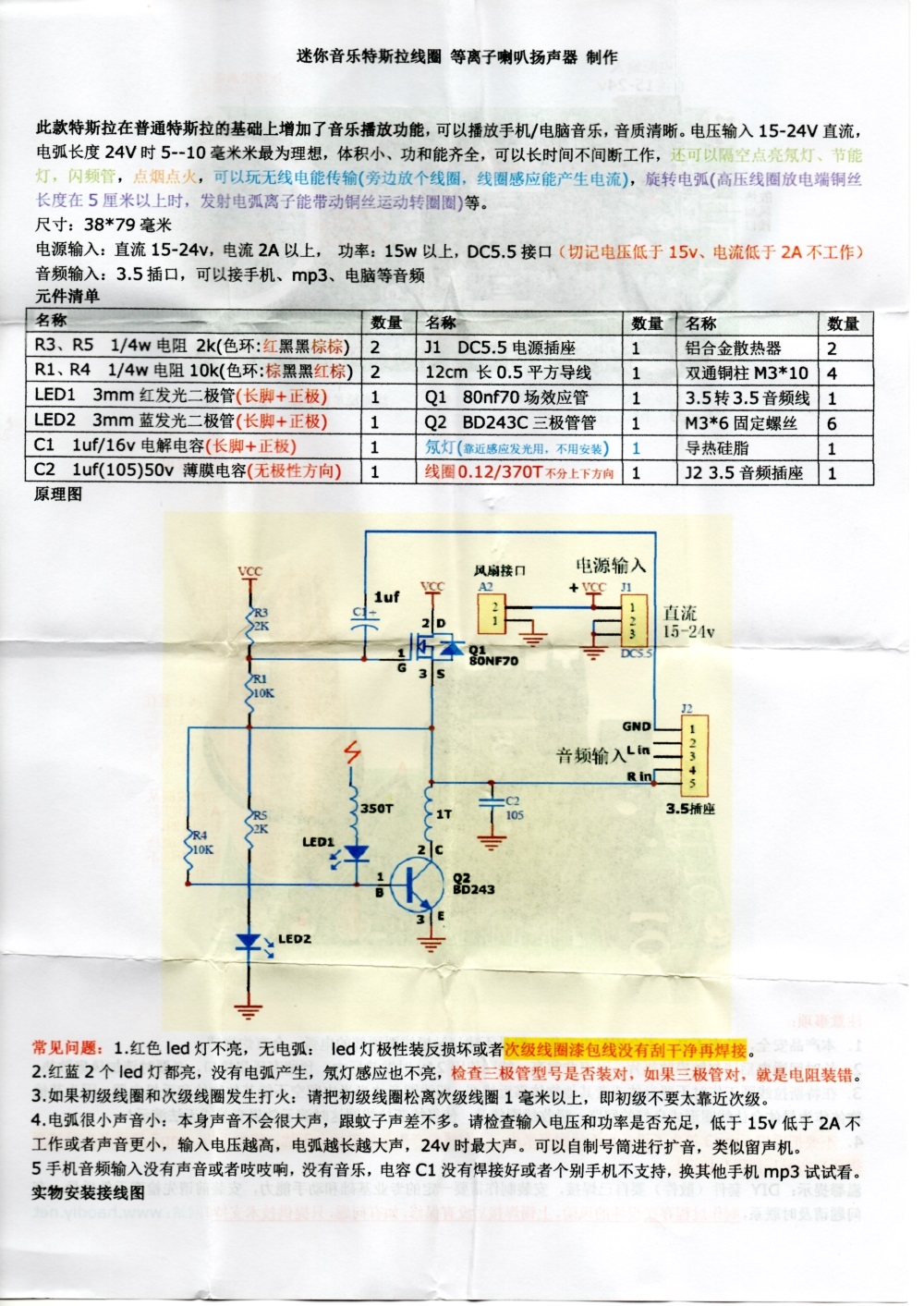

    The set includes a manual in Chinese, you can see the assembly of the system (in particular, the method of making the primary winding of the air transformer). The manual also includes a schematic diagram of the device.

    Very simple layout, reproducible at home. The coolest thing is a ready-made coil on a tube with which I always have a problem; /

    But I am wondering otherwise. On this search page you can see that there are definitely different views on the primary winding for practically the same PCB and elements. They are single-turn, three-turn, but also hmmm ... half-turn (?).
    Especially that the principle of the self-induction generator would imply that for the primary winding its inductance and coupling with the secondary is crucial for the power and voltage obtained on the secondary side. But you can see that this system is somehow not very sensitive.
    Why? winding the coil in all this construction is the most fun.
    If anyone knows how to do it, he can do it without any problem.
