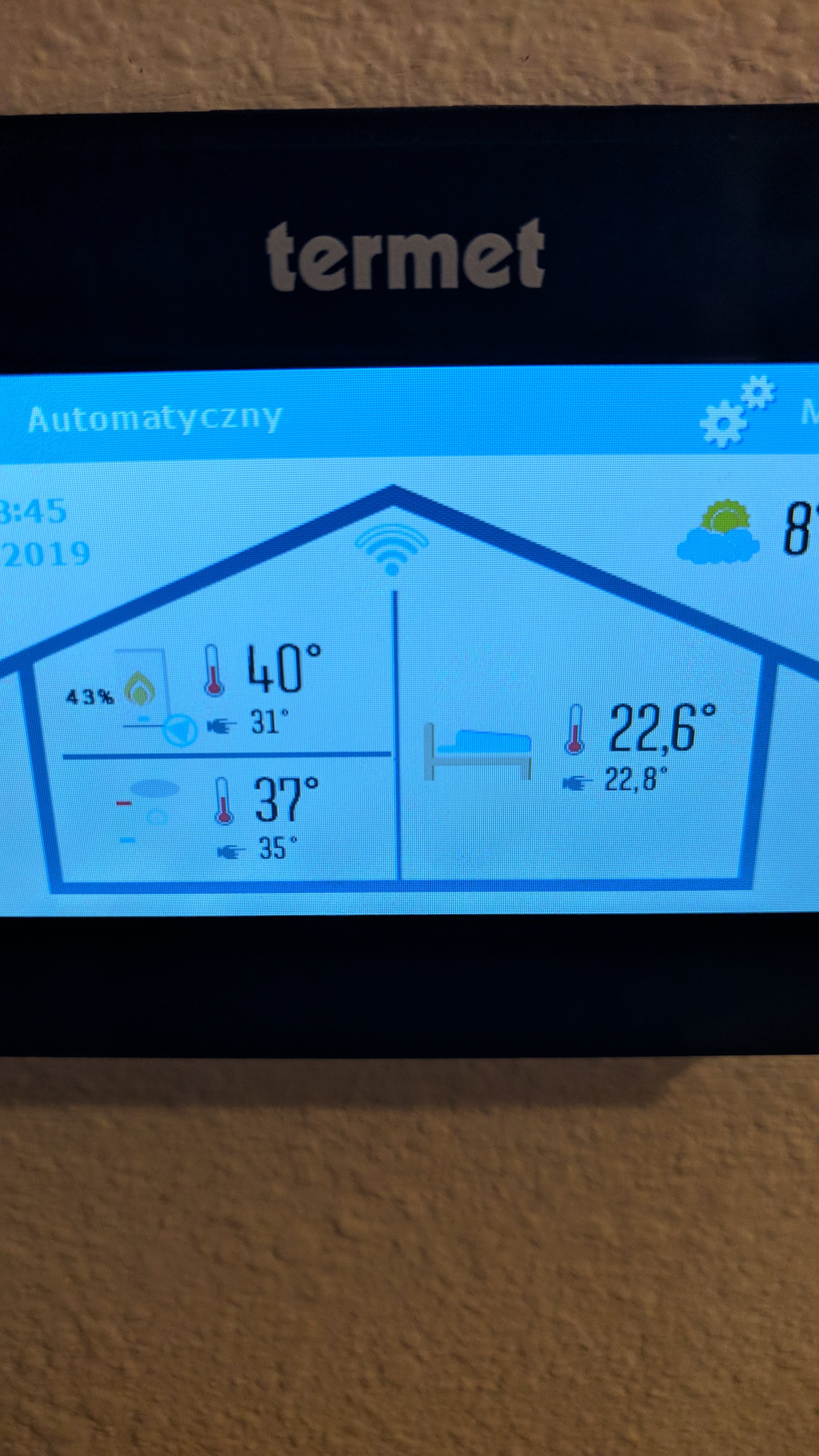

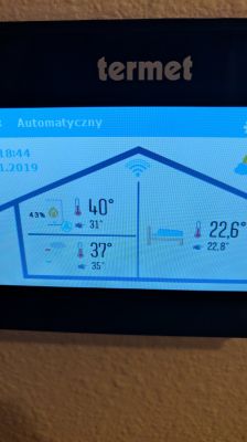

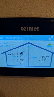

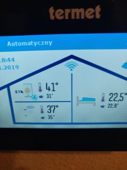

    From what I could observe, these indications of the% modulation of the burner appear in the form of a value when you put it in the burner
    Literally
    When __% is displayed, it means that the boiler is working at its minimum power, instead of dashes it should be 00
    When you give him a burner by increasing the preset boiler temperature in the curve from 40 to e.g. 50 ° C, after some time, about 30-60 seconds, instead of __ a numerical value appears. from reality, but these are my observations
    To sum up, when the boiler works with minimum power at low temperatures, instead of the% burner power value, we will see two lines, i.e. __% the boiler is blowing at minimum power
    edition
    And the button, my thoughts went to the head
    Termet ECOCONDENS GOLD PLUS + ROUND with Wi-Fi - Open-Therm - connected incorrec Termet ECOCONDENS GOLD PLUS + ROUND with Wi-Fi - Open-Therm - connected incorrec Termet ECOCONDENS GOLD PLUS + ROUND with Wi-Fi - Open-Therm - connected incorrec Termet ECOCONDENS GOLD PLUS + ROUND with Wi-Fi - Open-Therm - connected incorrec
    As you can see, even at a low set point, the modulation value shows up, so I don't know what the kaman is about
    We're still with a hand in the potty :(
    On the other hand, you can see that the lower the boiler temperature, the lower the% modulation, but this is probably normal

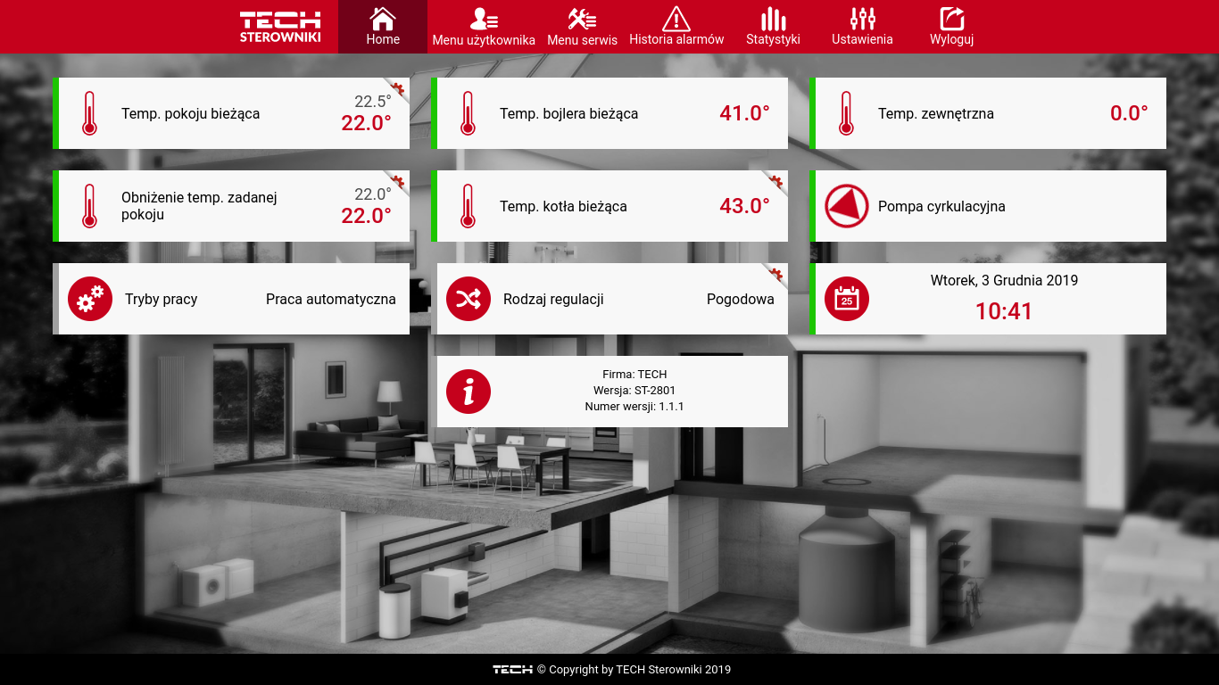

    and the first hours on the weather control hmm the curve is set that at 0 - 42st outside now 1st and the stove heats 46 or more hmm
    where does this difference come from? the chart shows that the supply temperature jumps significantly

    Well, setting the curve in this driver is not very accurate. The graph every 10 degrees and between it is set by eye
    I don't remember now, but by setting it directly on the controller, you can probably set it more precisely
    The curves in the boiler have a setting range of every 1st
    You need to write to the driver manufacturer to make a more detailed table :)
    For me, the boiler set is more stable than for you
