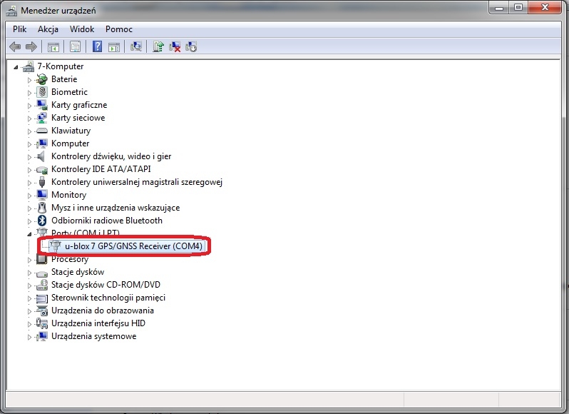

    What does an additional USB socket give us? Well, here it makes our work with this receiver much easier. Thanks to the USB socket, we can power our module and communicate with it without additional devices as in the previous version, where a UART converter was needed, eg FT232. You only need a USB cable to start working with the receiver. There is no UART converter on the PCB, just look at the documentation of the NEO-6M system to see that this system has a UART interface that is led out to pins 5 and 6, which are here connected directly to the USB socket. Nothing prevents you from adding or soldering a USB cable to a module that does not have a USB socket, eliminating the need to use a UART converter.
    After connecting the cable to the socket and installing the drivers, we only need to find in the device manager under which virtual COM port our module is.
    Comparison of two NEO-6M GPS receivers
    In the case of Windows 7 we do not need drivers, the system already has the appropriate drivers. In the case of Windows XP you will need the appropriate drivers, I do not know how it will be with newer operating systems. To do this, just install the U-center program from the U-blox website and the system will find the drivers itself after connecting the receiver to the computer. In the attachment at the bottom you will find the package with the program, the program can also be downloaded from the manufacturer's website at this link:
