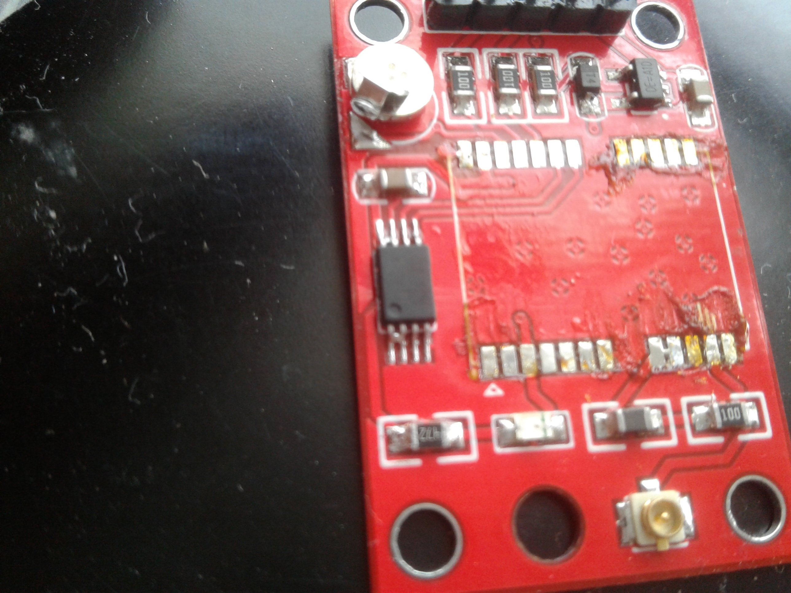

    The module I got didn't work at the beginning. After connecting it to a laboratory power supply, the current limit was set to 100mA, the supply voltage dropped due to the activation of the current limit. Increasing the current did not help - it turned out that it is not the receiver that gets that much, but rather a short circuit. I desoldered the NEO module and after connecting the power supply, the current limitation of the power supply was still working. It gave some hope that the module could be functional, and after carefully examining the board, I found two places where there were short circuits. They were on the eeprom memory.
    You can see it in the pictures below.
    NEO-6M GPS receiver - description and review. NEO-6M GPS receiver - description and review.
    One of them did not matter because 1-2-3-4 legs were tightened, but here 1-2-3-4 legs are tight on the board. The legs 7-8, i.e. on the memory power supply, were also tight. After removing these short circuits, surprisingly, the stabilizer worked - a tough beast. After soldering the NEO module and powering the receiver, the LED finally turned on and it was possible to establish a connection with the receiver.

    @MODI , I don't know if this is a question for me but I haven't tried it - so far I didn't have such a need.
    @TechEkspert , I do not know how to recognize if it is a real U-BLOX or only compatible. If you know, write how to check.
    I found information that these systems are recycled, but you can always come up with a fairy tale that would sell better.
    I have two modules and each has a sticker with a logo, although one looks better and the other worse. There is also a production date, where one is for week 10 of 2017 and the other is for week 22 of 2015. There is also a serial number and each has a different number.
    As for the quality of the PPS signal, unfortunately it does not have such precise equipment to check it.
    Below are two screenshots - one from Hantek6022BE and the other from Saleae clone.

    @ grala1 I know mine is not u-blox because in the description it had "compatible with u-blox" and there is no manufacturer's logo on the module.
    What is 1PPS? Perhaps it would be possible to examine the signal from two different GPS modules, although there will be no information as to which is OK, but if both signals have a similar shift, it means that both are relatively stable?
    In general, long-term tests, even with a thermostated quartz generator, could show something, although it will not be known what floats, but you may be able to observe some drift or no drift.

    TechEkspert wrote:
    Interesting description, is it "real" u-blox or "compatible" with u-blox?
    I haven't met the original ones on Ali yet, and I have bought some from various sellers for testing.
    Therefore, at auctions in their titles there is no word uBlox but NEO something there (ot Aliexpress prohibits fakes) in case of a dispute, the seller is also covered because he has not written anywhere that it is uBlox ...
