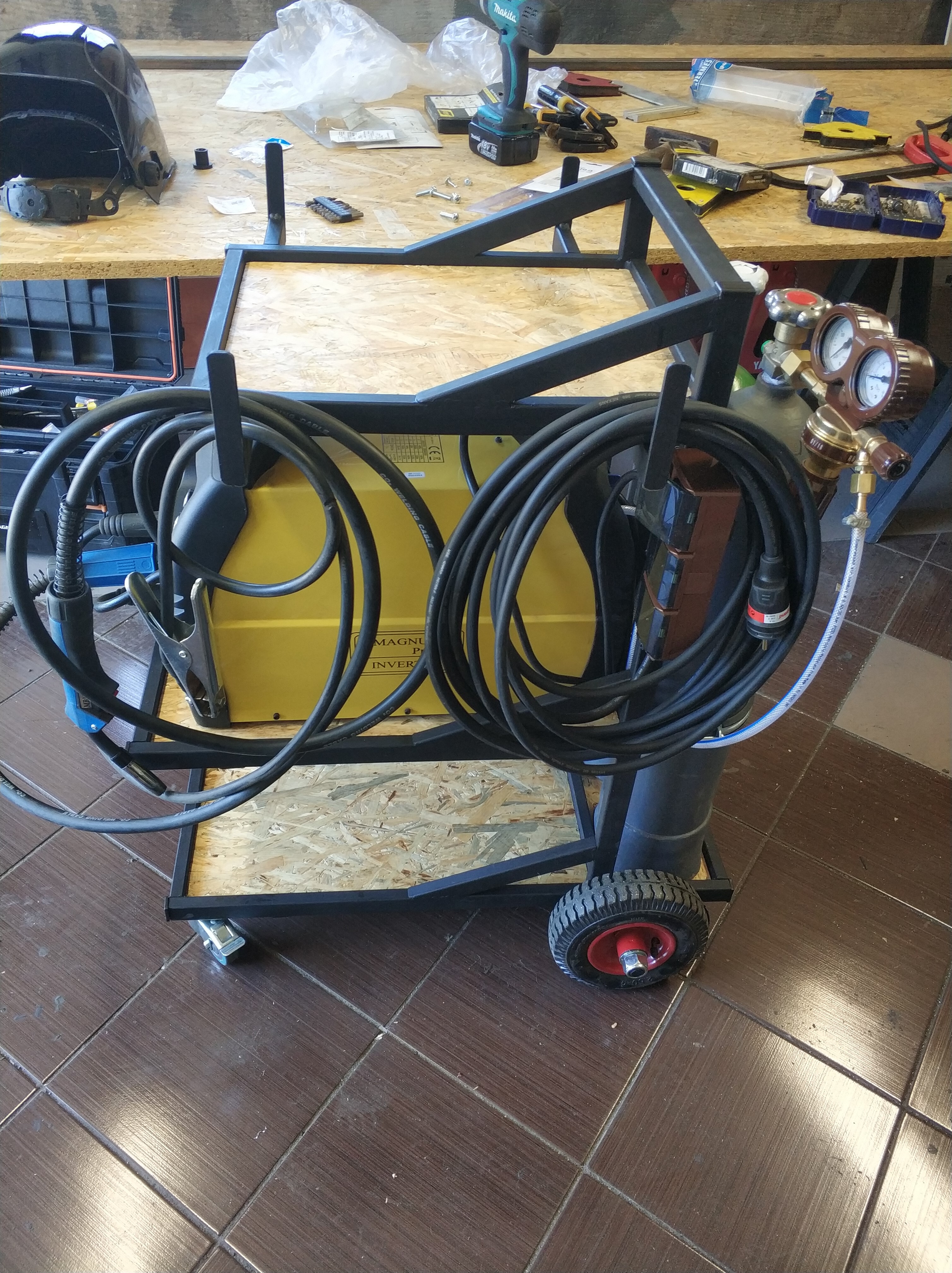

    I haven't posted anything on the forum yet, so it's time to show something.
    I present for a quickly built welding cart.
    Construction made of 18x30x2 sections.
    Reinforcements for shelves - 20x4 flat bar.
    Shelves made of 18mm OSB.
    Front wheels - swivel 75mm with brake.
    Rear wheels - 220mm pumped on 20mm axle.
    Additionally, a triple hermetic socket 16A and 10mb of H05RR-F OW 3x2.5mm2 cable with Legrand 16A plug are mounted.

    Why did you choose pneumatic wheels?
  • Add a rear handle and pipe tool holders

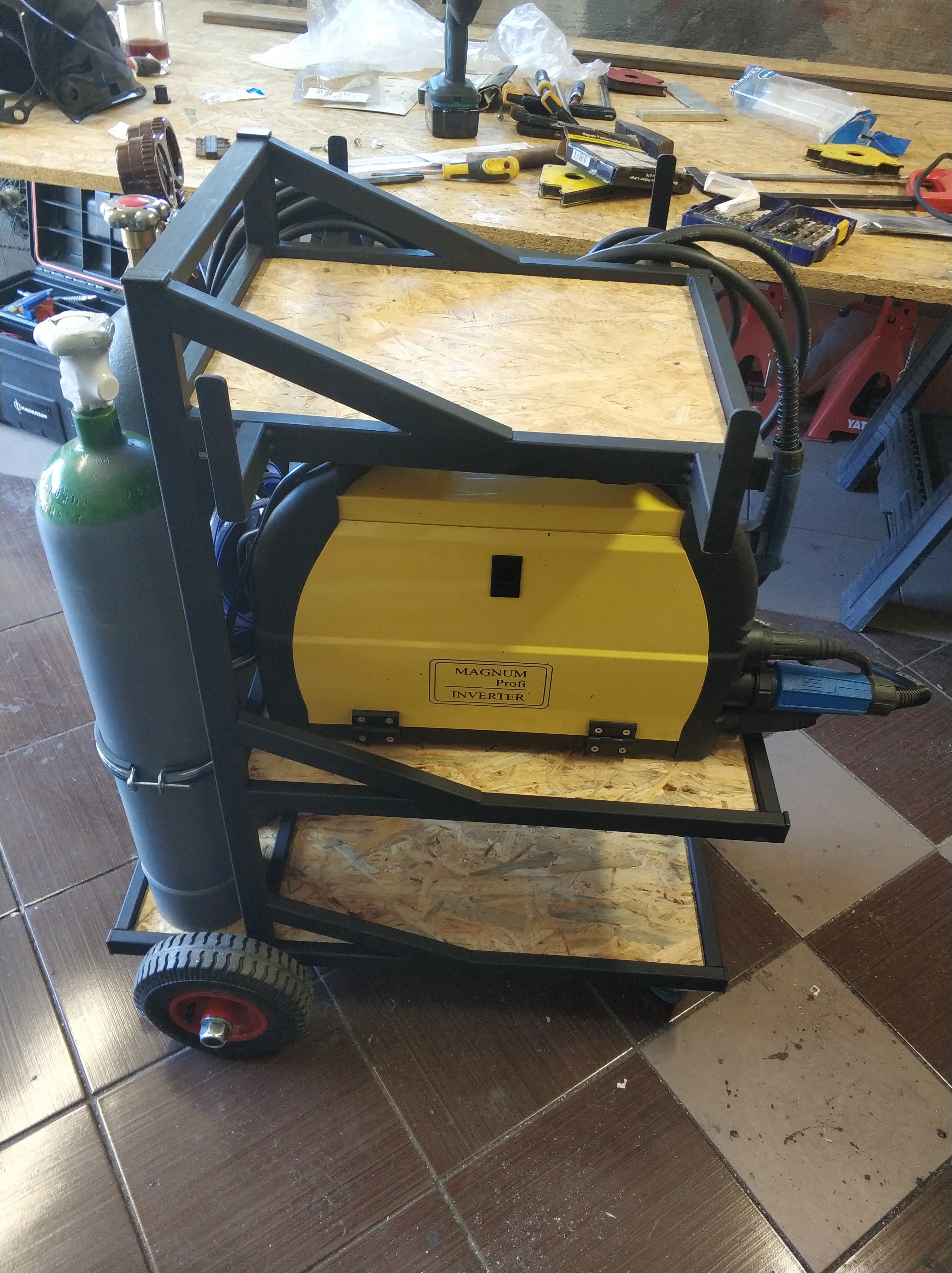

    The cart probably modeled on the idea Pirana ;)
    I do not see any handle behind which the trolley can be guided, it makes maneuvering much easier. I also recommend welding the side tool holders from cut pipes.
    My version of the pram:
    Trolley for MIG / MAG welder Trolley for MIG / MAG welder Trolley for MIG / MAG welder
    PS This is my debut welding, before I did not even hold the handle in my hand ;)
  • Need for a rear handle and side tool holders
    For no reason. I just bought it :)
    Fixxxer1 wrote:
    The cart probably modeled on Piran's idea ;)
    I looked at a dozen carts and took over something from several.
    From Piran also ;) .
    I lead behind the "corners", but if it is too bothersome I weld the handle to the upper shelf.

    The reducer protruding beyond the outline looks a bit disturbing. Mounting the cylinders would also make it easier to replace them, and as above, not to lean when tightening the screw. I think I would stick to the cylinder chain.
  • Cylinder chain preferred over screw mounting
    I assure you that it does not protrude beyond the outline of the stroller :)
    Well, I am asking you ... Every few months I will make this effort to lean a bit, remove (with a screwdriver) two screws and replace the cylinder ...
    Every day I bend even more to tie shoelaces and live somehow ... ;)
    I don't quite understand what you mean specifically ...
    In my photos you can see handles on the side of the trolley, e.g. wire brushes or wire cutters :)

    It turned out that driving the stroller by the "corners" is not the peak of convenience. Therefore, I made a handle, which significantly improved maneuvering.

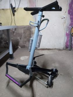

  • Adjustable rotating trolley for MIG/MAG welder
    #15 19333191
    PiotrSpaw
    Hello. I want to present my own idea for a non-ordinary trolley which has several advantages for the welder's work, so you can adjust the height of the lifted welder, which is very useful and additionally rotates around its axis as well as mobile when moving. Trolley for MIG / MAG welder Trolley for MIG / MAG welder Trolley for MIG / MAG welder Trolley for MIG / MAG welder Trolley for MIG / MAG welder Trolley for MIG / MAG welder Trolley for MIG / MAG welder Trolley for MIG / MAG welder Trolley for MIG / MAG welder Trolley for MIG / MAG welder Trolley for MIG / MAG welder
