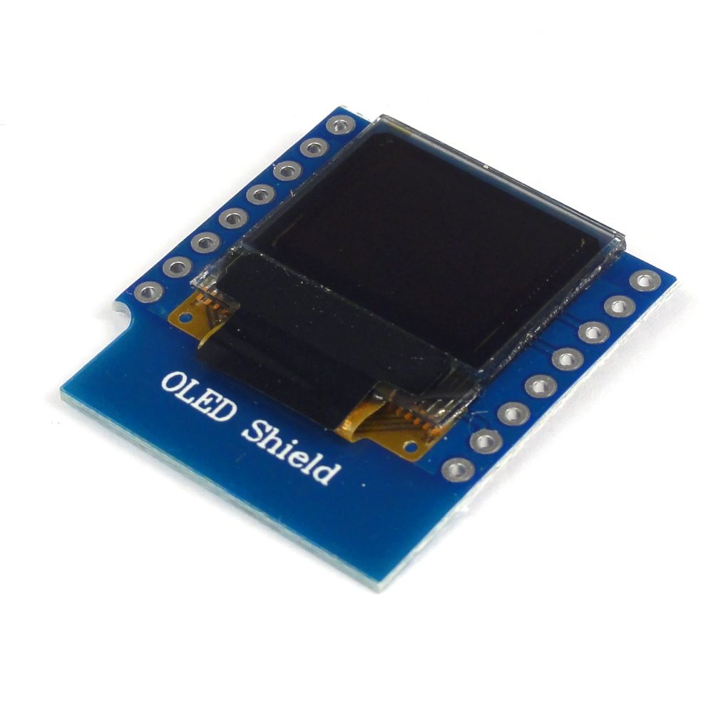

    Wemos is a D1 MINI:
    Wemos + OLED 0.66 + RFM69: How to change the DIO0-IRQ pin? .
    And the display:
    I'm probably typing the new pin wrong or in the wrong place.

    Khoam D7 is, after all, the MOSI pin of the radio.
    The pins I can use are D0, D3 or D4.
    I don't know what you mean by the OLED schematic.

    Well, now I know why all this was not working out for me.
    So it's not possible to connect the Wemos with this display and radio to make them work?
    Is there any way to make the display and radio share a common pin?

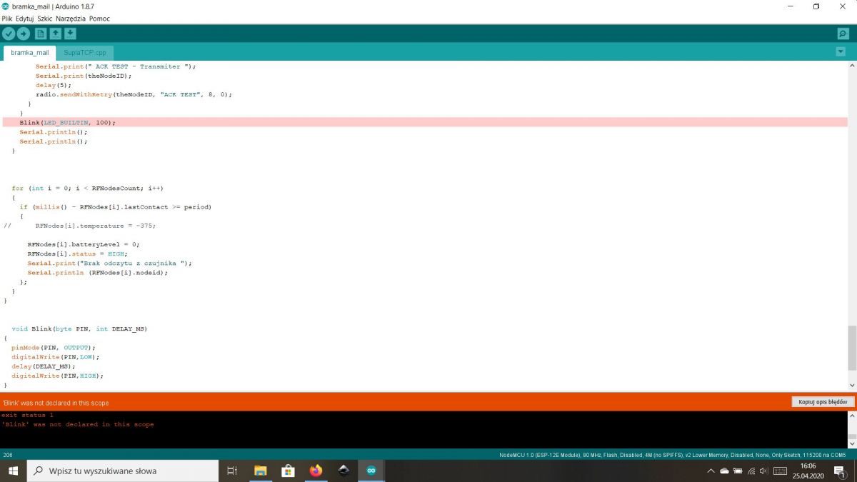

    Why is the compiler throwing an error in this case:
    As if it doesn't see the "Blink" function. If I give "Blink" somewhere in front then the compiler doesn't see the problem but the diode doesn't glow.
    I have an almost identical program running and in it the compiler does not see the problem.

    I placed void Blink(byte PIN, int DELAY_MS); at the beginning.
    The error has disappeared but the led does not blink when receiving data.

    Thanks to Khoam, everything is now working.
