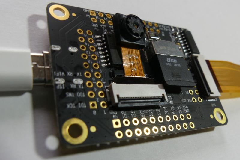

    Architecture RISC-V has already discussed on elektroda.pl, a set SiPEED MAiX DOCK in the price of $ 19.90, it is based on the SiPEED M1W module containing the K210 dual-core CPU in RISC-V architecture, KPU (support for artificial neural networks) and WiFi 2.4GHz connectivity (previous version M1 needed an external WiFi module, e.g. ESP8266). The set includes a M1W board, microphone, LED, connector for micro SD card, camera, TFT display, WiFi antenna and micro USB to USB C adapter. Numerous interfaces are available on goldpin connectors that can be soldered in PCB. The board has an audio signal output and PAM8403 amplifier. USB allows you to power the module and UART communication (CH340).
    MAiX DOCK set: RISC-V, python and image analysis, tests, launch
    The flexible tapes connecting the display and the camera are quite delicate, it is worth to take care of attaching a heavy display so as not to damage the flexible bus during the tests.

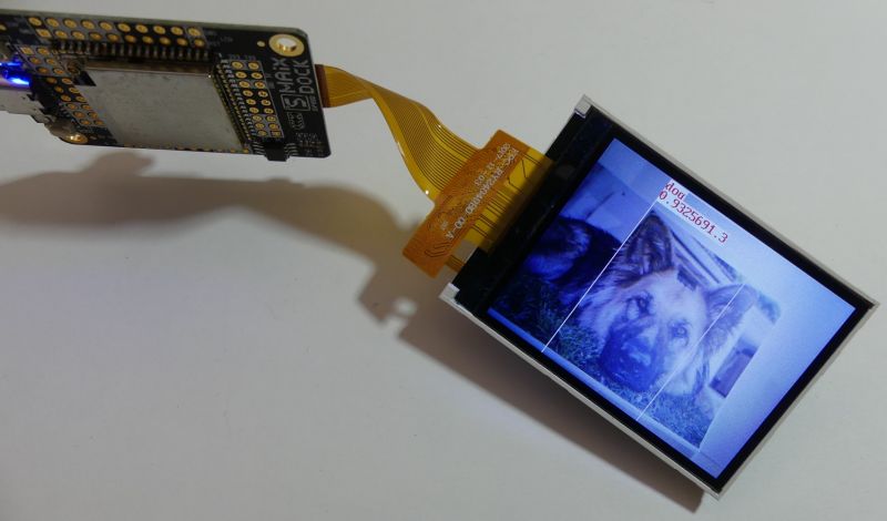

    I didn't check WiFi communication and microSD card support, recognizing objects in the image was much more interesting :)
    There is an initial (which may contain many errors) example with recognition in the image of predefined 20 objects (airplane, bicycle, bird, boat, bottle, bus, car, cat, cow, table, dog, horse, motor, person, potted plant, sheep , sofa, train, monitor / TV).
    The file is available here:
    http://blog.sipeed.com/p/677.html
    we can upload to the module:
    file maixpy_20class.bin
    and
    20class.kmodel at the address 0x500000
    then open the serial console via eg putty and using ctrl-e ctrl-d we place and run the 20class.py code
    The effects of running code:
    MAiX DOCK set: RISC-V, python and image analysis, tests, launch MAiX DOCK set: RISC-V, python and image analysis, tests, launch MAiX DOCK set: RISC-V, python and image analysis, tests, launch MAiX DOCK set: RISC-V, python and image analysis, tests, launch
    One of the possible applications is the construction of a device for the youngest, which will recognize the images shown to the camera.
    Both photos and drawings can be recognized. There is a chance that after a few attempts you will be able to draw an object that will be correctly recognized by the device.
    At the end a short film showing the recognition of various objects and even "ten-second" drawings with a marker on a piece of paper ;)
