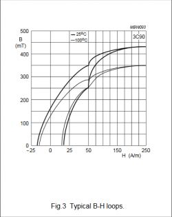

    Delta B is equal to H * u(permability). From core material documentation we can choose value of B field and permability.
    Half bridge LC resonant with parallel load to C topology - calculations
    However, we can also find magnetic loss plot. On this plot we can read value of Bmax*f vs frequency. We can use Bmax*f value for assumed 100kHz and multiple it by 2 (or not?) (because we will work with symmetric +Bmax and -Bmax).
    I1rms is assumed maximum rms current flow by primary winding. let's assume 800mA.
    I will use in calculation value of H field:
    $$A_P = \frac{877.79*0.5*2*0.8}{100000*40*0,00238761*4.5*1000000*0.3} = 54466mm^4$$
