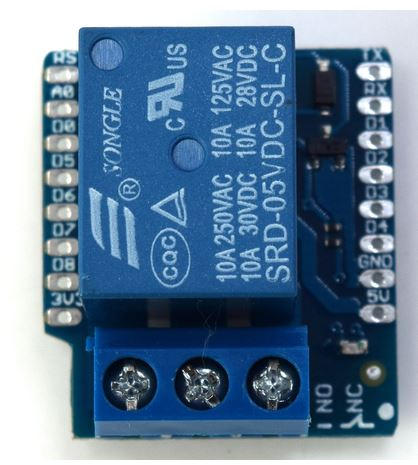

    I have made a project in Blynk as attached.
    I have uploaded a basic program to Wemos under Blynk.
    I have a photoresistor + resistor connected to A0 and 3.3V connected to GND.
    I have a relay connected to D1.
    The Blynk reads the light intensity, there is a graph, I can control the relay via Buton from the blynk, but the Eventor which is supposed to switch the relay on above a value of 30 (lux) does not switch the relay on.
    I've extended the code more, but it still doesn't work.
    Would someone please drop me a code?
    Greetings.

    And the relay is such an overlay on the wemos .
    How to fix Eventor in Blynk for WeMos D1 mini with photoresist? .
    The relay itself works as I switch this on the buton in the blynk.

    This function is at the end of the code
    void transmitBLYNK() { //procedure to send the state of the buttons to the BLYNK server
    Blynk.virtualWrite(V0, lux); //sending to Blynk
    I'll have a look at the links you provided, maybe I'll deduce something

    Is this how it should be?
    Code: C / C++
    Unfortunately it does not work :( .

    I converted the code from the link and it works
    Code: C / C++
    only i had to disable sleep after 20s
    // action.attach(1, 20000, sleep); // put to sleep after 20 sec of operation
    I will try to refactor this code for my needs.
    Thank you for your help.
