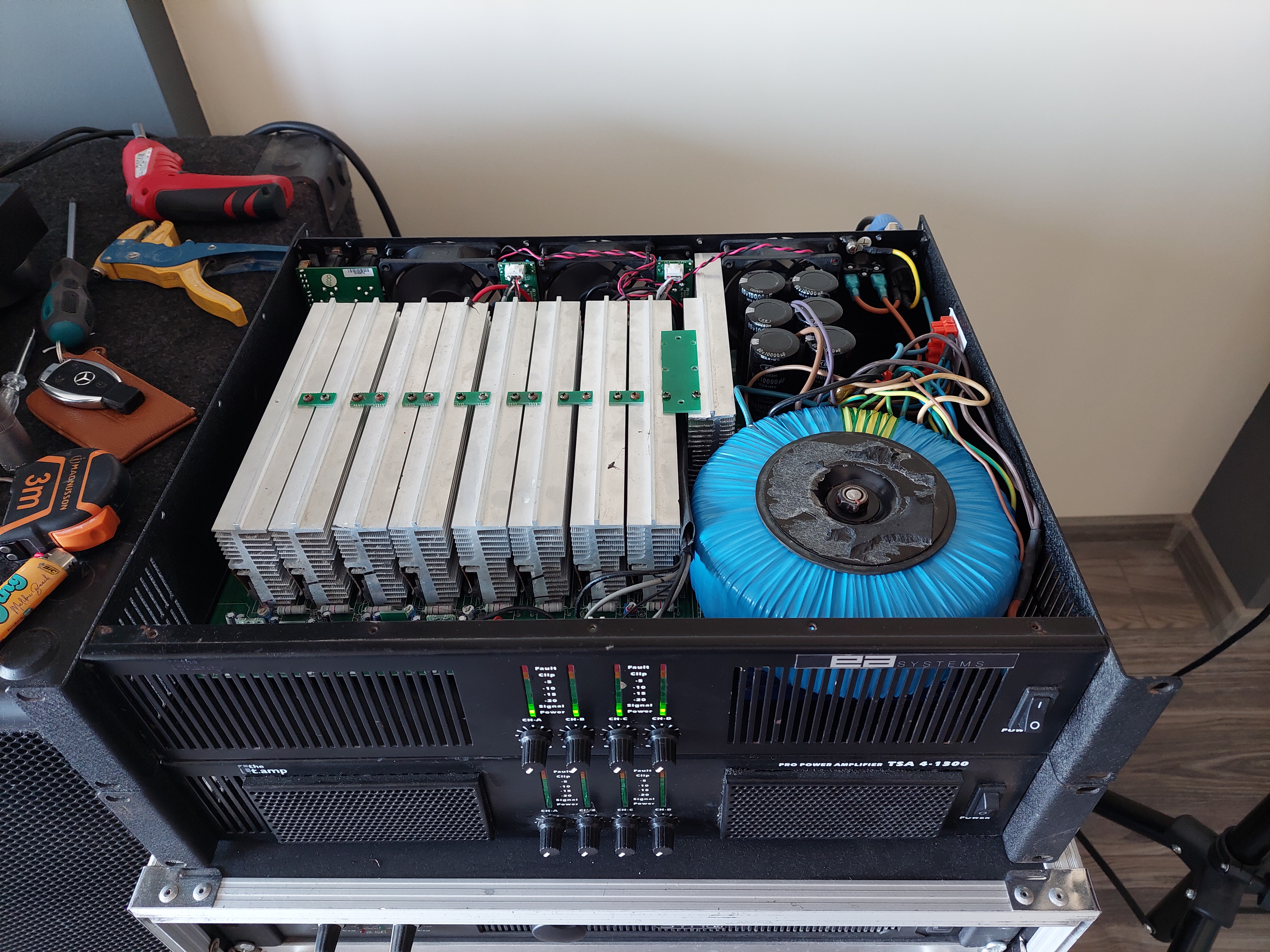

    anteka thanks, I read it twice.
    From what I can see, it is not fully explained what is defective - power supply or terminals :(
    If the ends themselves were ok, it would be worth making a separate, failure-free power supply.
    I bought two tips and started repairing :)
    I will describe what and how when I manage to repair.

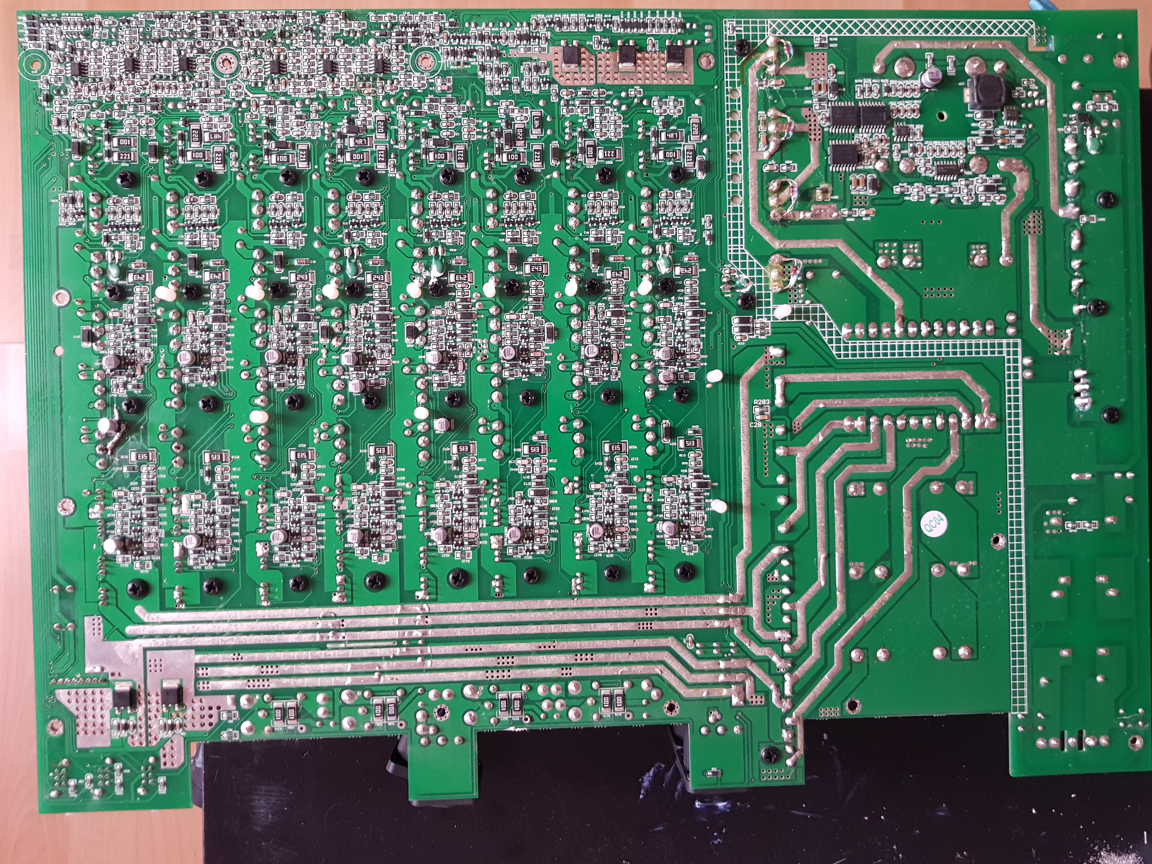

    It is not really known what is defective, whether the tip itself or the power supply. I personally have five of these amplifiers and, as someone wrote earlier, there are three versions of it. The first version differs from the others that the manufacturer did not make the finished product, but wanted to sell it. Therefore, it did not give a 15V zener diode and a resistor on the gates of the power bridges to ground. And probably later they were added to websites. Another difference is that the + 15V, -15V auxiliary power supply is taken from the + 60V, -60V terminal voltage. And only in later versions, the auxiliary power was taken from the + 30V, -30V tap. The + 30V disconnect in the first version was also used, but it was only used to power the + 24V stabilizer. But maybe a little bit about my copies. In the first copy of the latest version, only the power supply was damaged. So transistors, gate resistor, zener diodes next to transistors, driver. In the second copy of the latest version, one end and the power supply were damaged. So, final transistors and a power supply. So what was damaged in the first piece in the power supply. In the next amplifier, i.e. already in the third version, but it was the first version, the power supply was damaged and I have something else with the fan system because when I turn it on without a signal and wait a few minutes, the fans themselves increase the speed to the maximum. Although the heat sink of the power supply terminals and transistors are cold, of course the bridge and triac heat sink is also cold. In addition, sometimes it is so that the terminal goes into some error at half of the input signal and turns off the output relays. But only on one channel this happens. On the other three, I can increase the sound to the maximum and nothing turns off. So I did not finish this tip. I haven't fixed the next pieces yet. So sometimes the power supply is damaged and when the end is damaged, it drags the power supply with it because there is no protection for exceeding too high output current in this end. I am giving you some pictures of the first version of the power amplifier board.

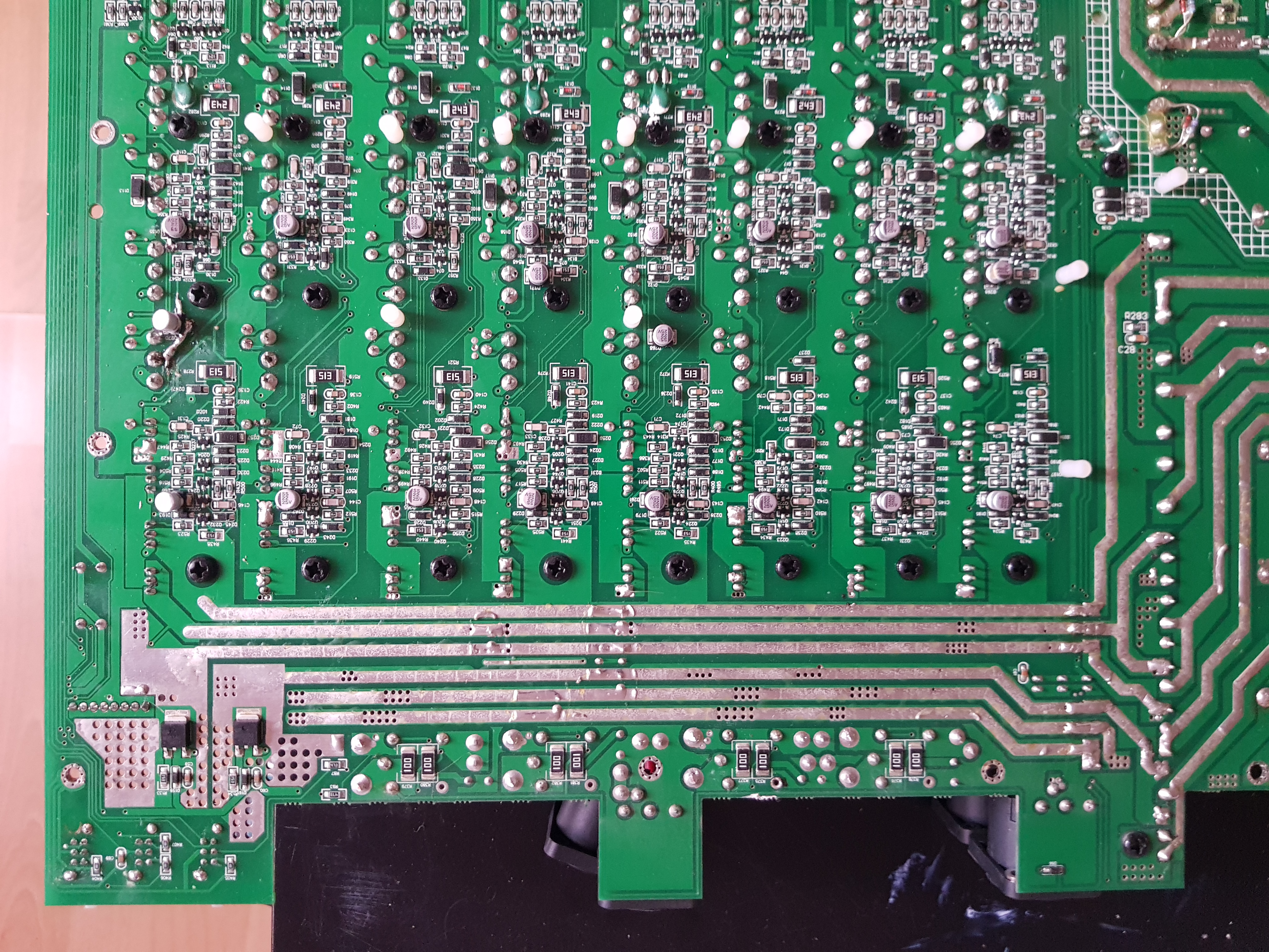

    In one version I have 100 uF 25V electrolytes connected to ir2110 one electrolyte for one system, bootstrap in this version 3x1uF
    Do you have a cheap source of 4 transistors for a power supply ??? maybe some replacement for 200 amps ???
    Digging through Farnell, I find something there - but will it work?
    SGL160N60UFDTU

    I used the IRFP460 to start the power supply, and only when everything was ok, I took out the IRFP460 and soldered the target transistors. It is worth giving fuses for powering transistors, i.e. power supply from the network after bridges and after capacitors. At + 310V. That is, cut the path and solder the fuse on one pair and also on the other. The fuses saved me twice from burning the transistors in the power supply. I assumed 3.15A 250V, two pieces.

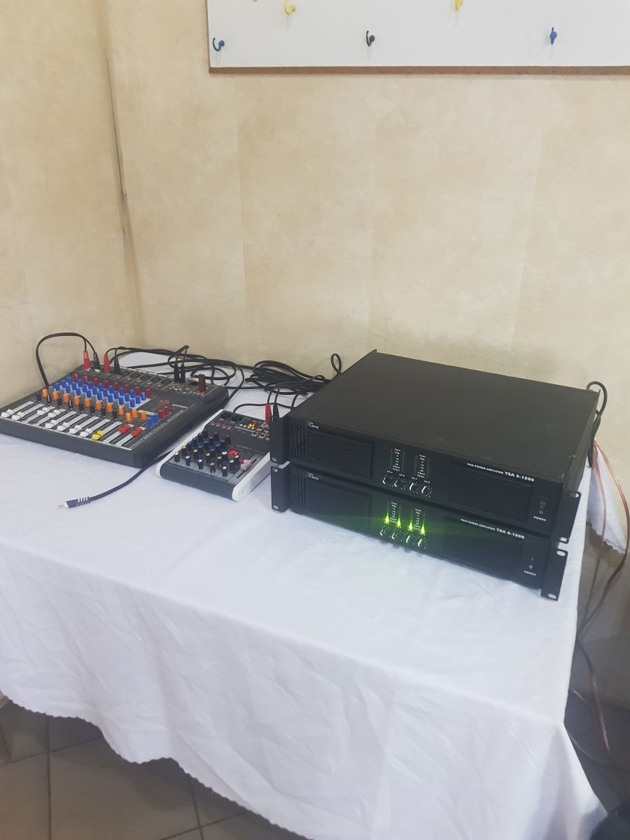

    The first event at this end was completed. A hall of 15 meters by 20 meters and I am happy with this end. I also talked to a friend who turned out to have this ending from the news and also says that he is happy. Of course, he said the same as I would say "everything will work using the equipment with common sense" T.amp TSA 4-1300 Power Amplifier Issue: Not Turning On, Red Diode Flashing, No Visible Damage T.amp TSA 4-1300 Power Amplifier Issue: Not Turning On, Red Diode Flashing, No Visible Damage

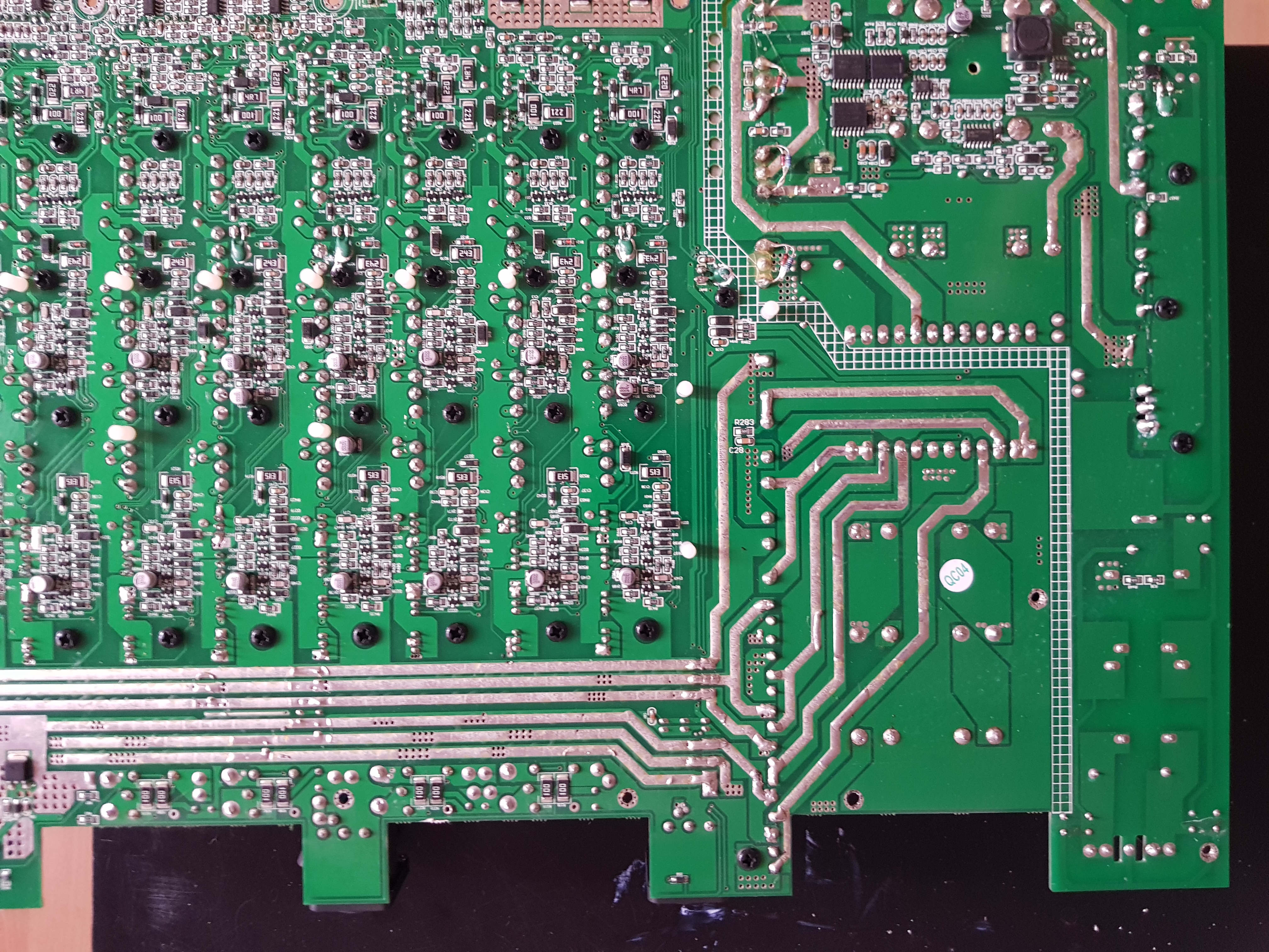

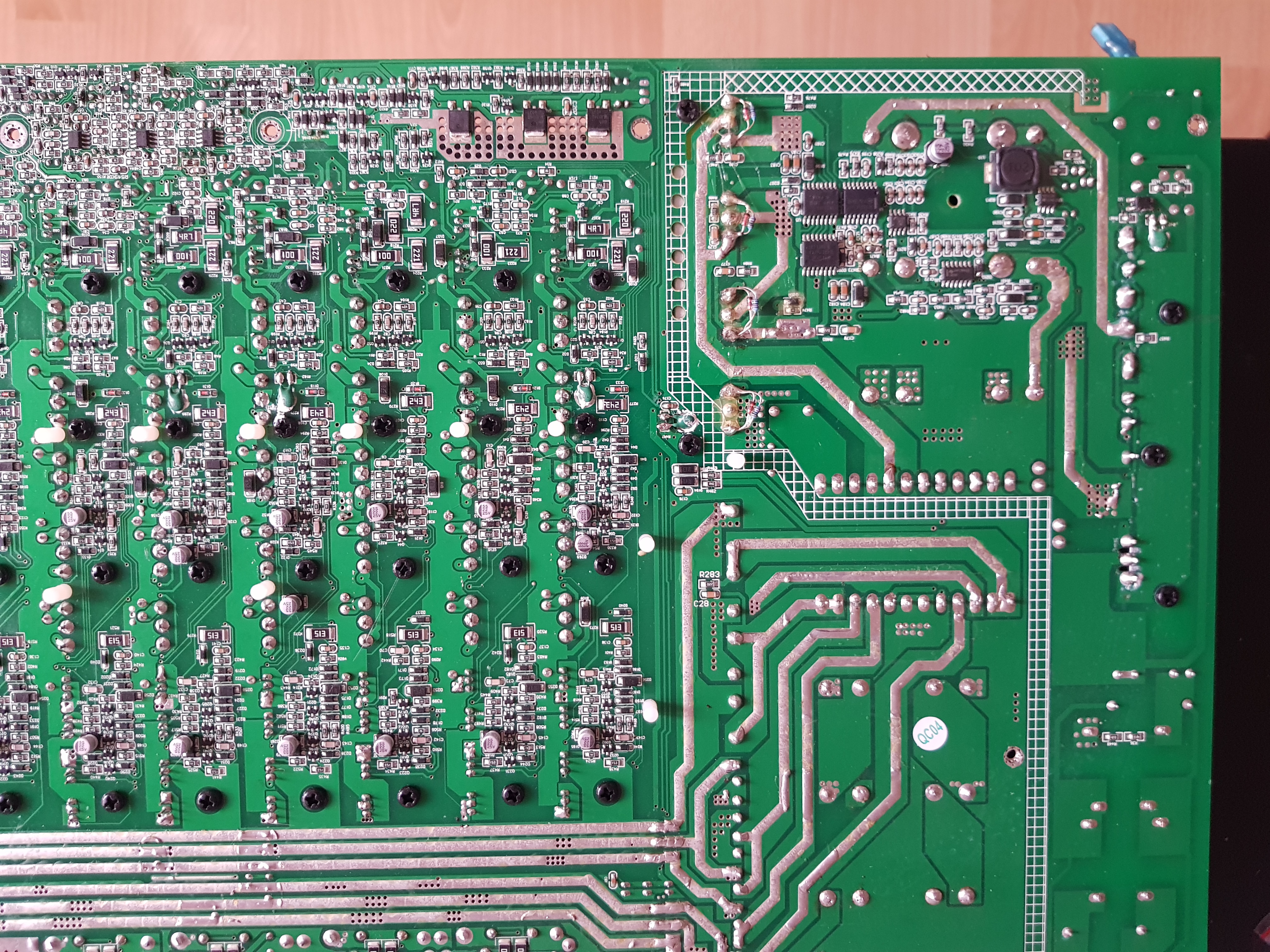

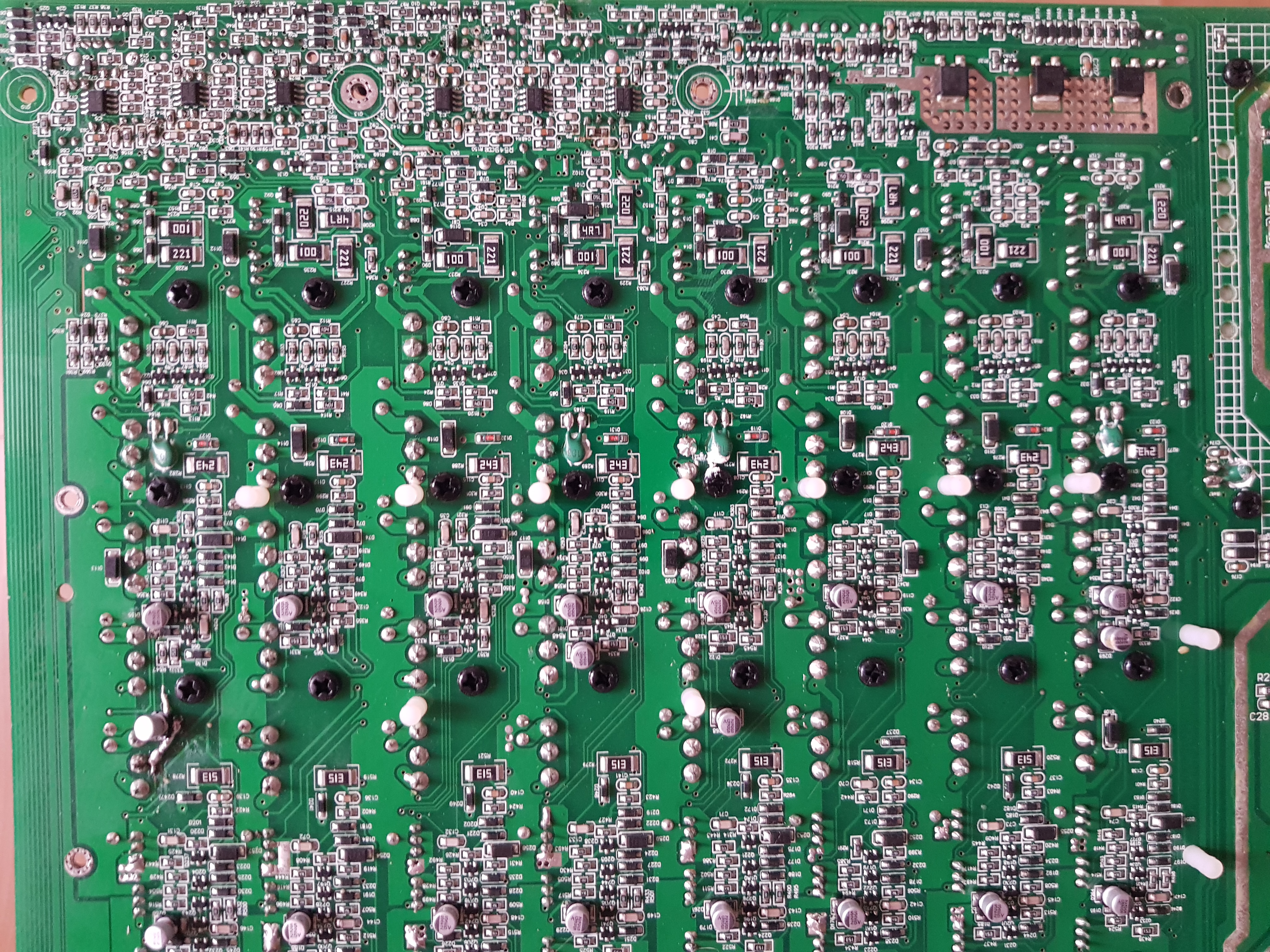

    check the voltage stabilizer 78m24 and whether there is voltage to it.
    The triac powers the bridges and the small converter powers the PWM driver and IGBT gate drivers
    Added after 3 [minutes]:
    replace also lm339 and lm555 correspond with delayed switching on of the inverter

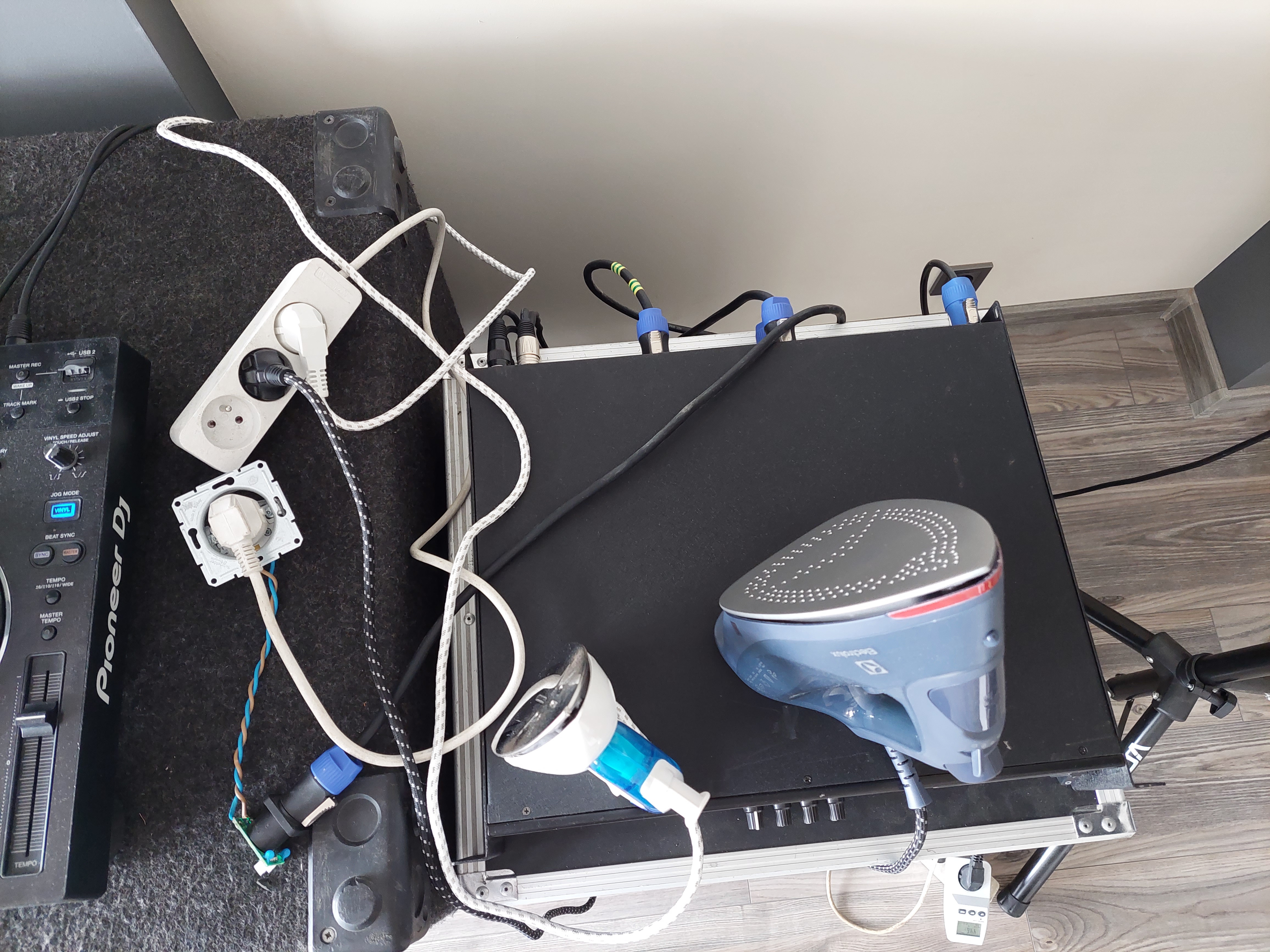

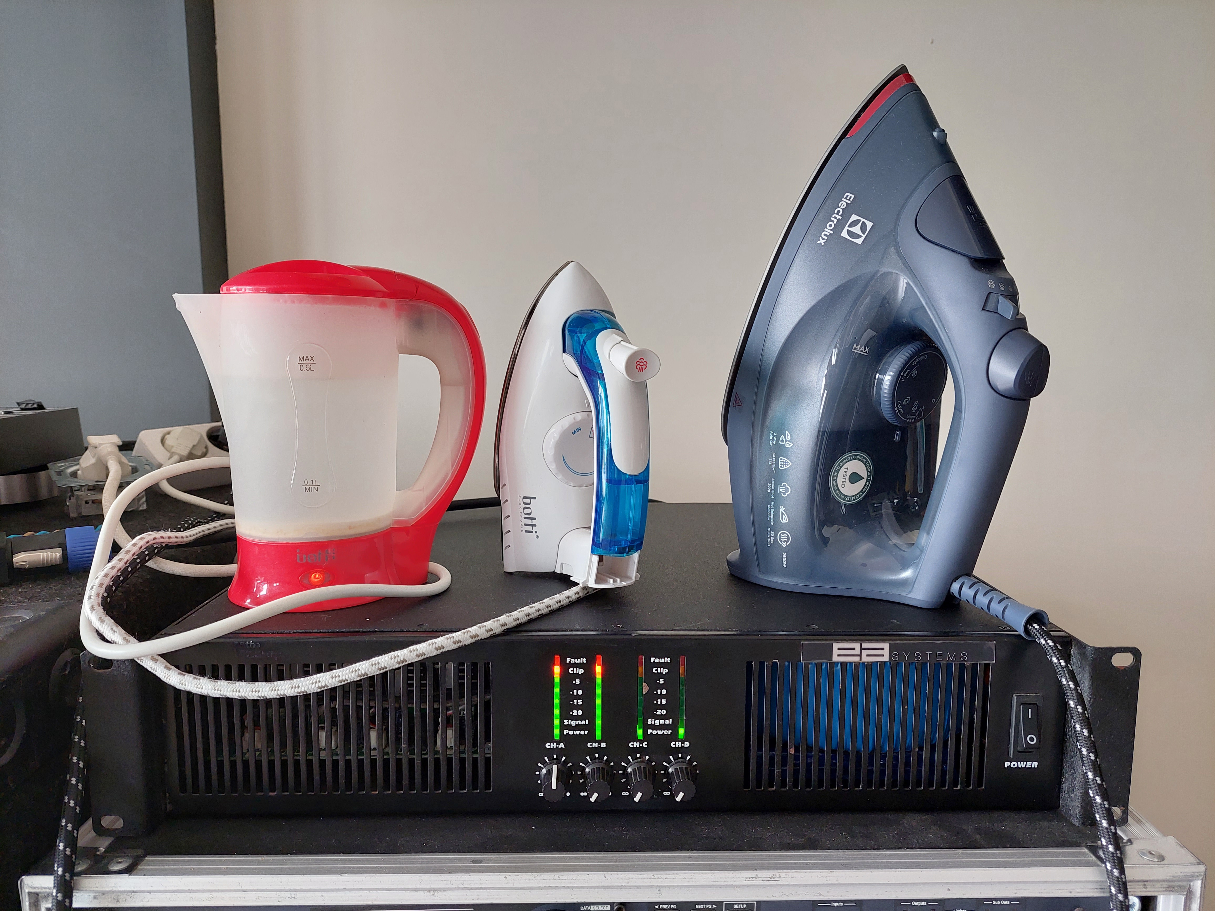

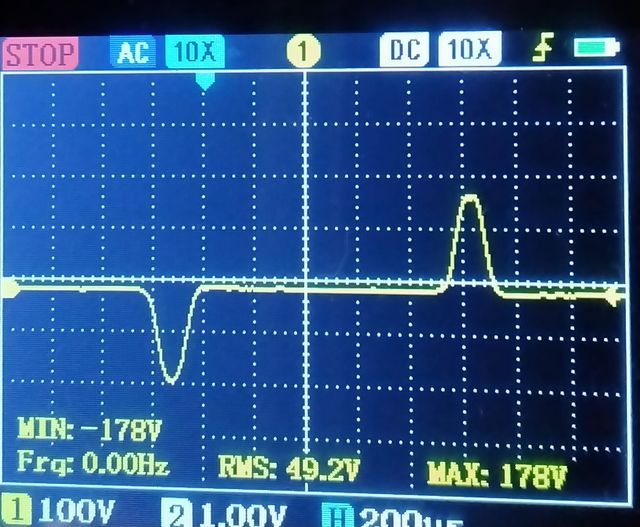

    The hair is on the head!!!
    T.amp tsa 4x1300
    I made measurements with a "sine wave" with a CF of about 11dB - that is, a waveform with such filling as the average musical material :)
    Load 8.7 ohms.
    The output voltage came out - 178V MAX, 49.2V RMS
    Power respectively - 3640W MAX peaks, (current 20 amps peaks)
    280W RMS power (current 5.6 amps average)
    I will not play a normal sine wave on this amplifier - I'm afraid.
    I will not do the test on a 4 ohm load either, because it is also a risk and looking at the above results, I do not even try to think how much will come out at the top.
    As for how the clip works
    Interesting things happen here.
    When I reach 178V (then I have the knob on about 70%) and I keep turning the knob to increase the power:
    1 - the amplifier no longer boosts the power and it is impossible to get the flattening of the sine peaks characteristic of the clip - it looks as if the amplifier had " limits " or " peak reduction " which mutes the signal in such a way that clipping does not occur.
    2 - the sine wave is clean all the time without flattening at the top despite increasing the volume.
    3 - the CLIP LED on the front panel does not light up despite increasing the volume !!!
    4 - while the diode inside the board starts flashing informing me that " limits " or " peak reduction " It lowers my signal so that I don't clip it sometimes. - I will lead these diodes outside so that I can see them :) Too bad the manufacturer didn't.
    I thought that the amplifier would calmly handle my parties only:
    I will convert the subs from 4 ohms to 16 ohms and then I am sure that I will not burn anything and the power in the peaks will be around 1800 watts, which is enough since the subs have a 1200 watt power program.
    Gentlemen, thank you all for your help :)
    Without you, I would never have repaired this amplifier :)
    I bow my head!
    Incorrect reasoning that differs from the actual parameters of this amplifier based on the applicable laws of physics for a real device of this type ( class AB amplifier ). And you probably misspoke, due to this and not another amplifier, we may be talking about one party here. ;) Although with the planned output power of 100W per channel, there is little chance of this invention working longer until the first failure.
    Well, some are irreformable and do not listen to others with more professional experience.

    aaanteka wrote:
    What was the actual burden?

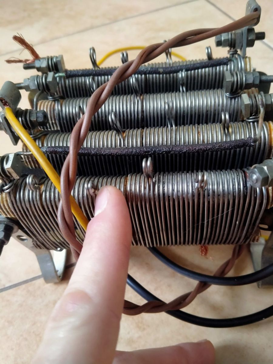

    The load was such a resistor as in the photo.
    It may sound amateur - how to measure the power of the amplifier? I can't input a normal sine wave!
    What am I doing wrong there? after all, you can see on the graph that in peaks for a fraction of a second I have 178V, from ohm's law I have 178V x 178V / 8.7 Ohms = 3642 Watts
    I emphasize 3642 Watt occurs only for a fraction of a second, which is the power of PMPO !!!
    Thanks for the post Aaantek :)
    Why? Sorry, I'm off topic. After all, it is a full-range amplifier, as far as I remember, there is some irs that has an integrator at the input, because without it you will not give the irs audio signal to the input. The integrator converts the audio signal into pulses with variable duty cycle and the SZ is connected to it. Unless it's done differently here. Explain what you mean.
    The power measurement is made with a sine of 1KHz and that would be enough of the parameters you need to provide to the amplifier.

  • #267 20602089
    roberrt
    Posts: 43
    I just have a TSA 4-1300 in repair.
    After repairing the power supply (IGBT, IR2110, diodes, etc.) and the second channel, the amplifier starts. Unfortunately, the voltage is too low to control the relays (about 13V) and only one turns on.
    78m24 that powers them is operational, but has only 15V at the input. The voltage from the transformer after resistors R462 and R463 and diodes D194 and D196 is 15.5V. Voltage before rectification on the transformer ~100V, single leg of the transformer to ground ~50V.
    Maybe some of you have had a similar experience and can help. Unfortunately, without a schematic, it's hard to understand the entire branch.
    Regards
  • #268 20604057
    Ziemowit1973
    Posts: 99
    Rate: 36
    In the middle there are smd diodes that rectify the voltage of about 30V - there measure whether you have about 30V. The diodes are connected to the first double windings of the transformer :) Good luck.
    Check if you have other supply voltages - are you sure both halves of the converter are working - if one half of the converter will not work then you can hear the converter beeping and then all the voltages are cut by half but the amplifier surprisingly plays :)
  • #269 20607530
    roberrt
    Posts: 43
    In fact, only half of the inverter worked (it didn't make any sounds for me). After replacing the faulty IR2110S, the voltages doubled. The auxiliary voltage supplying, among others, the 24v regulator is now 31.5v and everything works.
    Thanks for the help.

    Hello and welcome!
    Post described very generally, only for entertainment and educational purposes!
    I have had this electronic waste for a long time, so I decided to do something about it, and this freak was born:
    TSA 4-1300 converted into a transformer with 4 channels covered, working "H" keying and the largest possible toroid mounted.
    I removed the PCB section from the converter, in its place a base for a toroidal transformer was inserted.
    The transformer I had had 2x 15V and 2x 84V secondary windings, I additionally added 2x42V, so the main voltages are:
    P0: 2x21V DC
    H1: 2x59V DC
    H2: 2x118V DC
    H3: connected to H2
    The whole, after previous modifications, fit in the original housing and works properly.
    Before the final modification, I tested the power amplifier on many transformers, from 2x15V+2x24V, a few others to the current one. As for the operating points of the transistors - I did not touch anything here.
    The temperature thresholds work properly, surprisingly, the VU indicator on the front scales nicely with the power obtained from the input voltage, so no modifications were made here either, I checked the waveforms with the sine wave on the oscilloscope, regardless of the power supply voltage used - CLIP also reacted correctly.
    [!] IMPORTANT:
    This power amplifier, in addition to a poorly selected power supply and a few nuances, has a design flaw in the form of using the housing to connect ground points on the motherboard.
    This is not an exception, because such solutions are found in many devices, but when using a poor quality housing and poor threaded bushings, it is asking for trouble.
    The screws break the connection, the whole works mechanically to a small extent when moving, placing sideways or a bad grip for lifting, and this is enough to strain the connection.
    I would recommend connecting these points with wires after each repaired piece, otherwise disconnecting them, e.g. during transport, may cause damage again.
    MEASUREMENT AND OPERATION:
    Single channel, 50Hz sine per input, 4ohm resistor in water = 69.43V RMS on oscilloscope (69 * 69 /4R = ~1190W)
    I checked all channels on the above load "under CLIP", after 20 minutes of testing for each channel. Cooling responds properly on all channels.
    The bridge mode works properly, it has a decent kick but I did not measure the power due to the lack of an 8ohm resistor.
    I checked both bridges in the form of entertainment by connecting the SPEAKON-Extension adapter, plugging in various home devices. The power supply from the power amplifier output was correct, the ironing was successful and the coffee was brewed.
    In general, the whole thing works fine, I haven't installed the soft-start for the toroid yet, so sometimes it throws B16.
    The power stages are repeatedly overloaded, intentionally tortured and somehow the device lives.
    I think that in this configuration at lower power "it" should work without failure.
    Educational project for people who have in their collections some reasonably suitable goes to this amplifier, absolutely not economical when ordering a new transformer.
    With two loaded bridges, connecting 2x Polaudio TP118 18LW2400 8ohm basses and playing very hard after an hour, the transformers are warm.
    My project requires cosmetic corrections and additionally I would add some capacitors in the power branch.
    Regards!
