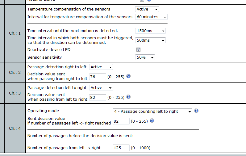

    Hello again colleagues.
    Please help me with the configuration of a motion sensor with HMIP-SPDR direction detection. After many attempts I have come to the following:
    1. if one person enters e.g. the kitchen, the bulb lights up and on leaving it goes out. And this is ok.
    2. if e.g. my wife enters it lights up, then I enter it continues to light, but when I leave it already turns off the lighting and my wife is already sitting in the dark :D .
    There is a "Difference of passages left" or right in the sensor options but that doesn't work for me somehow.
    Does anyone know how to configure this sensor?
    Greetings.
  • #2 18386462
    bumble
    Level 40  
    Posts: 7189
    Help: 609
    Rate: 1193
    Maybe a bad detector? Maybe it knows when someone enters and doesn't count the other person, but when someone leaves it switches off. I have an ordinary detector and it works fine. When it detects movement, the light switches on if nothing happens for a minute, even a small movement of the hand switches on the light and in the kitchen the light is constantly moving.
    Added after 38 [seconds]: .
    I only had the problem of choosing a spot so she wouldn't see someone walk in front of the door but it worked out.

    From what I have checked it counts fine, one way and the other. Surely the reason is at the moment a bad configuration. I will look further on the German forums for what they write.
