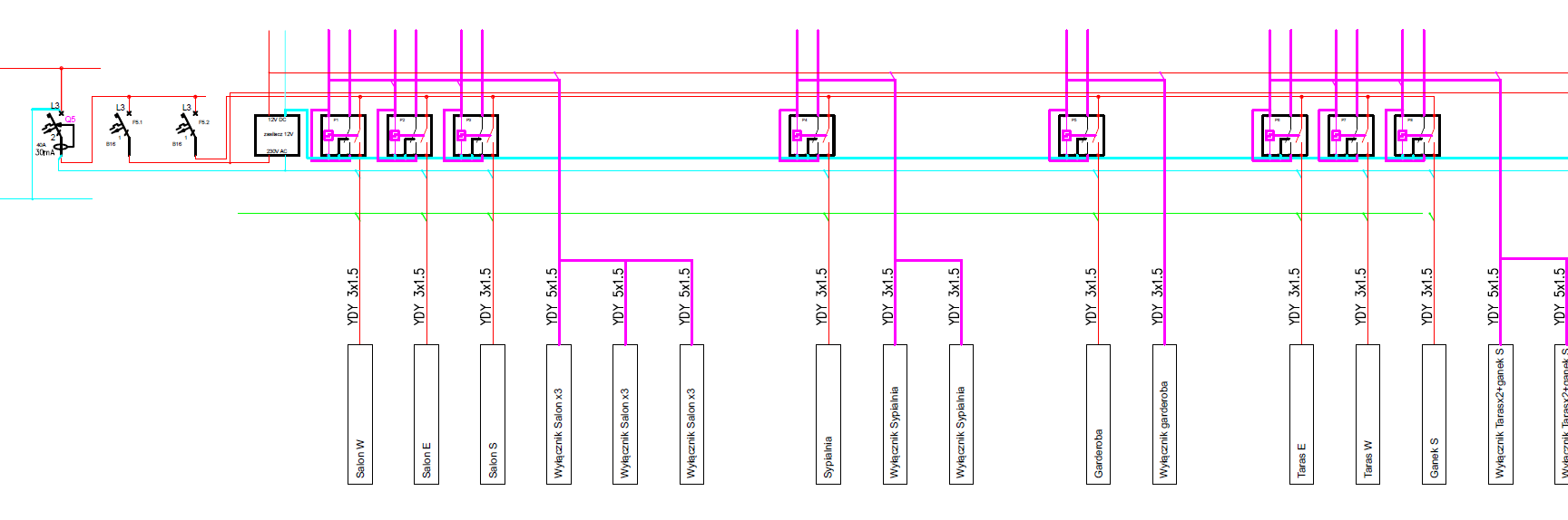

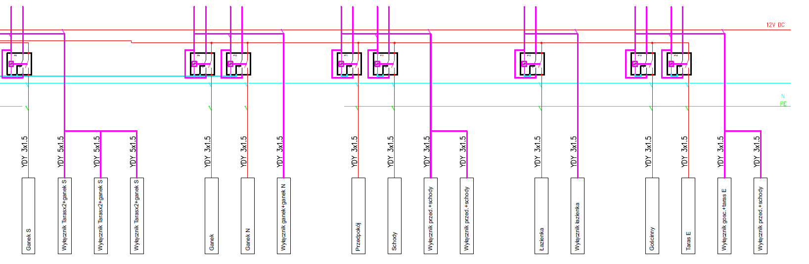

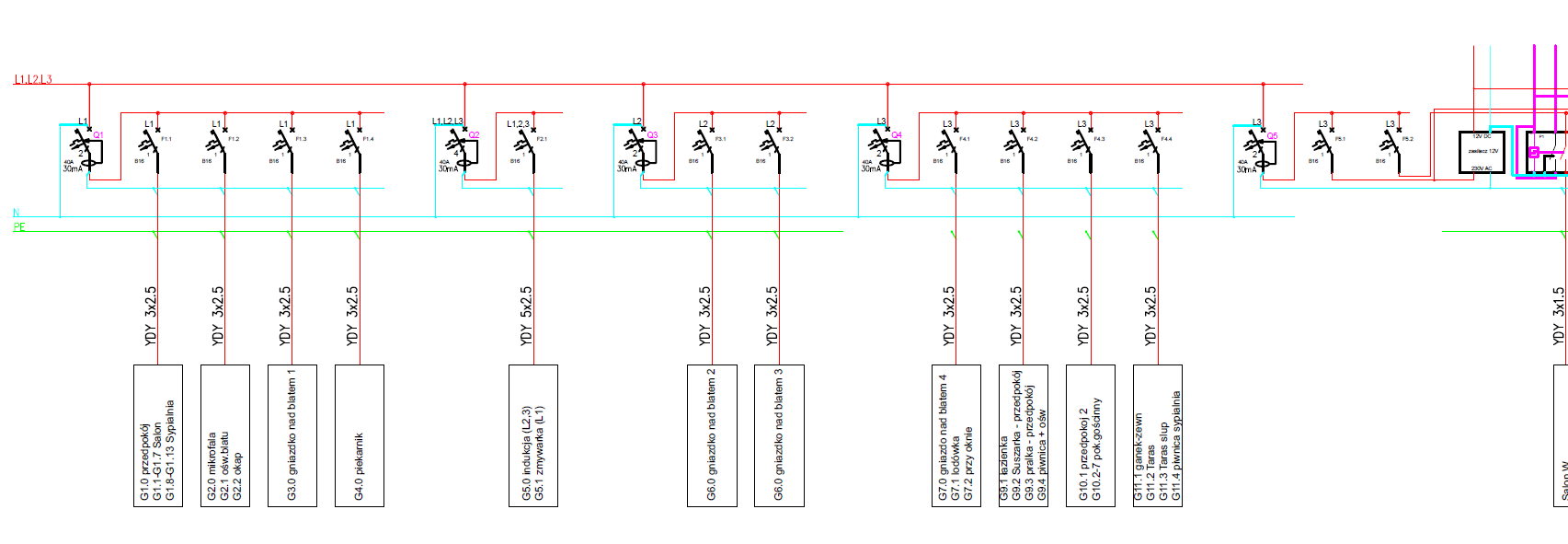

    I attach the project. It shows the switchgear that will serve the Ground Floor. I still have a main switchboard on the property which via C25 feeds this switchboard, a switchboard in the utility room/garage and there will be a switchboard on the first floor which will serve the heat pump, PV and sockets and lighting on the first floor as well as one external circuit.
    In this scheme I still need to give the outside sockets under the relay and a selected socket/s in the house under which the iron will be likely to be plugged.
    The whole thing can work autonomously independently of the automation, and I will connect the automation, which will be able to act like a bell switch by supplying 12V and test the state of the relay contacts.
    All the outputs to the top (purple) are to the automation, which I will probably do in a different place, because that's where the reed switches from the doors will come down, maybe from the motion sensors.... etc..
    The diagram doesn't show the power supply, which of course has to be there. I'm unlikely to use a circuit breaker on the input, as it's better to de-energise the power cables as well, and I can do that in the main switchboard where I have 3x c25 and maybe add some Type1+Typ2 300mA/voltage surge.

    Schematic as described in the first post, may be useful for selection of some components - e.g. switchgear.
    What is missing is the most important thing - automation. It is it that will determine the satisfaction or not of the whole. Do you have a concept (algorithm) of operation?
    The vision in the first post is also more about execution than concept of action. It is important what and how you want to control (this you have shown on the diagrams), what kind of information you want to collect (reed switches, switches, motion detectors - and, for example, control by app, by voice). What additional elements are you planning? Air-conditioning, heating, humidifiers, purifiers, automatic hoovers, some audio, roller shutters, alarm, carbon monoxide/gas sensors, flooding, some electro-valves, etc., etc.?

    I see that the diagram has an error:
    - relays P1..P15 (also lier small) will be bistable, like for lighting, to control bell switches. One end of the coil permanently to minus the other controlled by a pulse from a switch, or automation.
    - Contact 11 of the relay gives state to the automation, when off it is ground and when on it was supposed to give PLUSA. But I connected a control pulse. Instead, a plus should be applied to terminal 14.
