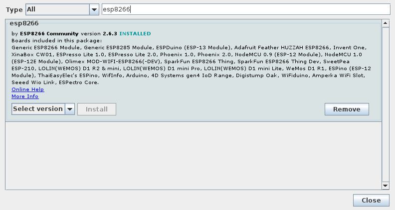

  • #36 18536670
    pier
    Posts: 2446
    Help: 40
    Rate: 1893
    After just updating the board, the circuit works flawlessly overnight.

  • #39 18542924
    pier
    Posts: 2446
    Help: 40
    Rate: 1893
    I tested the whole thing with Blynk, Thingspeak and ESP.deep.sleep. Everything works as it should. An update to the board helped.
