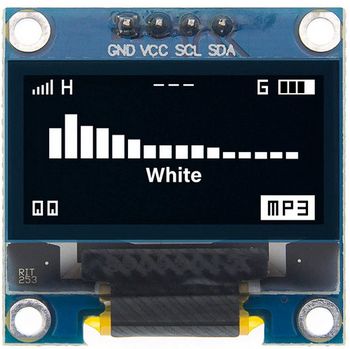

    Colleagues please help as I have no strength left.
    Tell me what is wrong in this code that as soon as I add Deep.sleep or initiate Blynk, the display only flashes and displays nothing. Without these functions it works normally and shows measurements from the sensor.
    Code: C / C++
    Added after 4 [hours] 23 [minutes]:
    I've come to the realization that some strange display has hit me. The same program uploaded to another board works with deep.sleep and with Blynk without any problems.
    Do you know what the issue is with this display?

    And isn't this display from the new series? They need a much higher initialisation delay. Without this, they either display nothing or just flash the image and everything disappears.

    Marek_Skalski wrote:
    And isn't this display from the new series? They need a much higher initialisation delay. Without that they either display nothing, or just flash an image and everything disappears.
    Not sure about the new series bought this week.
    So does it initialise and give delaja or how to do it? Some new library maybe?

  • #8 18530830
    Marek_Skalski
    Posts: 1338
    Help: 114
    Rate: 1044
    New type display:
    [Arduino] SSD1306 flashes after adding Deep.sleep/Blynk .
    Display of old type:
    The main differences are:
    - the size of the display itself (the new one is smaller)
    - width of the ribbon connecting the display to the board - the new one is narrower
    - number of components on the board - the new one has less
    The old ones start immediately (< 50 ms from power on). The new ones need (in my case) > 400 ms. I bought some of the new ones and thought they were defective. But I was surprised to find that after a reset of the circuit they work without any problem. A while later I figured out that the chip needs more time to start. In tests it came out > 400 ms.

    I have an old-style display.
    Khoam nothing is achieved by these treatments. After a reset the image shows for a while and disappears....

    I checked for peace of mind but just as I thought it didn't change anything. I repeat the display works if there is no lag, blynk or sleep in the code. For some unknown reason the problem for this display is any delay in the code, just give a delay(); greater than 10 anywhere in the code and already the display is silent.
    Khoam probably needs to consider that this display is some kind of junk, damaged or has some clone of the SSD1306 driver, give up on it and buy a new one.

    And didn't I write you that after uploading this program to another board with another copy of the display everything works as expected. I might be tempted to swap the lcd itself then it will be 100% sure.

    I connected another copy of the display to this board and it works as expected and blynk and deep.dleep.
    The conclusion is that these two-colour displays are kind of weird.
    As it turns out, I'm not the only one who has a problem with this display Link .
    I also did a trial with adding pullups on the data lines, with no effect.

  • #27 18535730
  • #28 18535756
    pier
    Posts: 2446
    Help: 40
    Rate: 1893
    khoam wrote:
    It should rather be:
    Code: C / C++
    It starts to work and with sleep, although the display does not always get up after deep.sleep.
