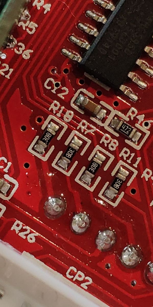

    Hi,
    I have this problem.
    I would like to read the status of a 7 segment display from one device (controlled by a controller from the board of that device, you know) using an external ESP8266.
    The model of the display is 10016BH (10 pin).
    How can and should I hook up to this display to read the state of each segment using the GPIO on the ESP8266?
    Thank you in advance :) .

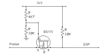

    khoam wrote:
    If it "works" as an output in the GPIO of the ESP8266, that would be a problem. I don't really understand how this could happen "by accident", but programmatically it is possible What voltage is supplied to the diodes in the display segments?
    On the meter 5V before the resistor, ~2V after the resistor, SMD resistor 308 - that is probably 3GΩ.
    On the display + is common, - flies through the resistor
    ESP is obviously running at 3.3V.
    As for the case, I would prefer to protect myself, I don't know what happens to the ESP pins when programming etc.... I don't want to mess up the other board. Would a diode, for example, fit so that only one way the signal flies, or am I thinking too simply? :)

    Connecting ESP8266 to 10016BH display - how to read the status? .
    That is, the diodes are flying on 5V with a 2kΩ resistor, and a 3.3V signal would have to go to the ESP. Any ideas? :(

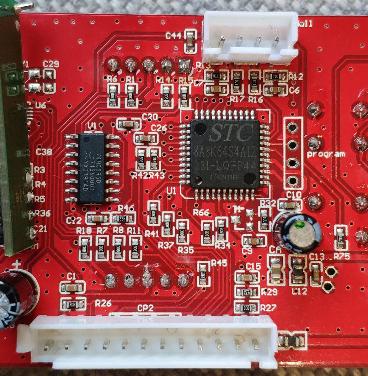

    khoam wrote:
    what voltage value would be the "high" state and what would be the "low" state.
    For the ESP or this STC? How do you measure this? :(
    I am attaching a picture of the board. Maybe from this it will be easier to determine something.
    The main controller is an STC8A8K64S4A12.
    The diodes are connected to something called a "74HC595 sliding register".

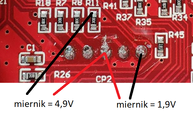

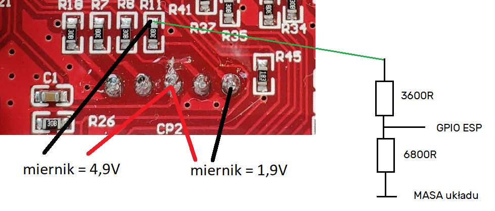

    When the segment is lit, there is 1.9V behind the 30B resistor and 4.9V in front of the resistor.
    Values from a plug-in meter as shown in the photo.
    When the segment is not lit, it is 0V.

    Give the resistors alone and it will be OK.

    If it's a display with a common anode, the active state is logic 0(the 595 register at the output of the active segment gives an L state). The easiest way is to enable the pull-ups in the ESP(high state forcing) and through the shottky diodes connect to 595(the active output will pull down to logic zero the ESP input).

    evolucja wrote:
    Diodes are plugged into something called a "74HC595 sliding register".
    If you've got a 595 register there, then instead of combining, hook up to the serial input of that register - you've got SCK, MOSI, SS - you hook that up to SPI in slave mode and you've got a readout of what the processor is sending to the latch. Even if you need to convert levels, you only have 3 signals, not 7 or 8.
  • #21 18648712
    ArturAVS
    Moderator
    Posts: 26413
    Help: 2303
    Rate: 7830
    Just add some more series resistors which will limit the "collision" current . Although it might be worthwhile, instead of reading the state of the segments, to simply listen for transmissions to the 595?
