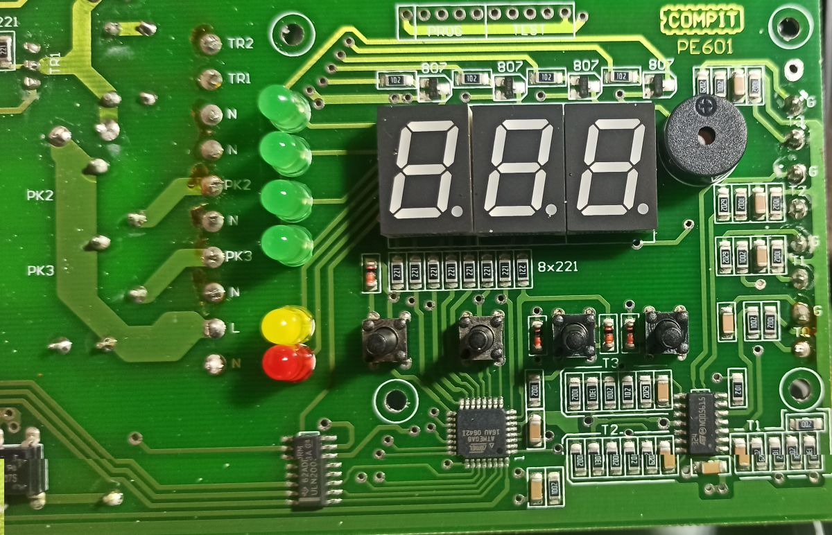

    I want to use the ESP8266 (actually nodemcu v3) and the PCF8574 to read the status of a 7-segment LED in another device (three to be precise).
    From the PCF8574 datasheet I read that the supply voltage should be between 2.5 to 6V which means that, at least theoretically, it should work from a 3.3V supply just like the nodemcu, however, I can also read (in the datasheet) that "VIH High-level input voltage" should be from the range of 0.7 × VCC VCC + 0.5 which means that in the case of a 3.3V supply, for the high state a minimum of 2.31V and a maximum of 3.8V is needed, while "VIL Low-level input voltage" from the range –0.5 0.3 × VCC i.e. -0.5V to 0.99V
    I don't really know how to determine what the maximum voltage can be on these 7-segment LEDs their designation is KT10521BJ1B-A unfortunately I couldn't find an datasheet for exactly this model.
    I am wondering how to safely connect the PCF8574 to these 7-segment LEDs, Will it be safe directly for both the device I want to read the information from and mine. Or should I use a voltage divider on each input and additionally (or only) connect a resistor in series that will limit the current flow to a maximum of a few mA i.e. 4k7 ESP8266, PCF8574 and 7-segment LED how to connect it correctly? .

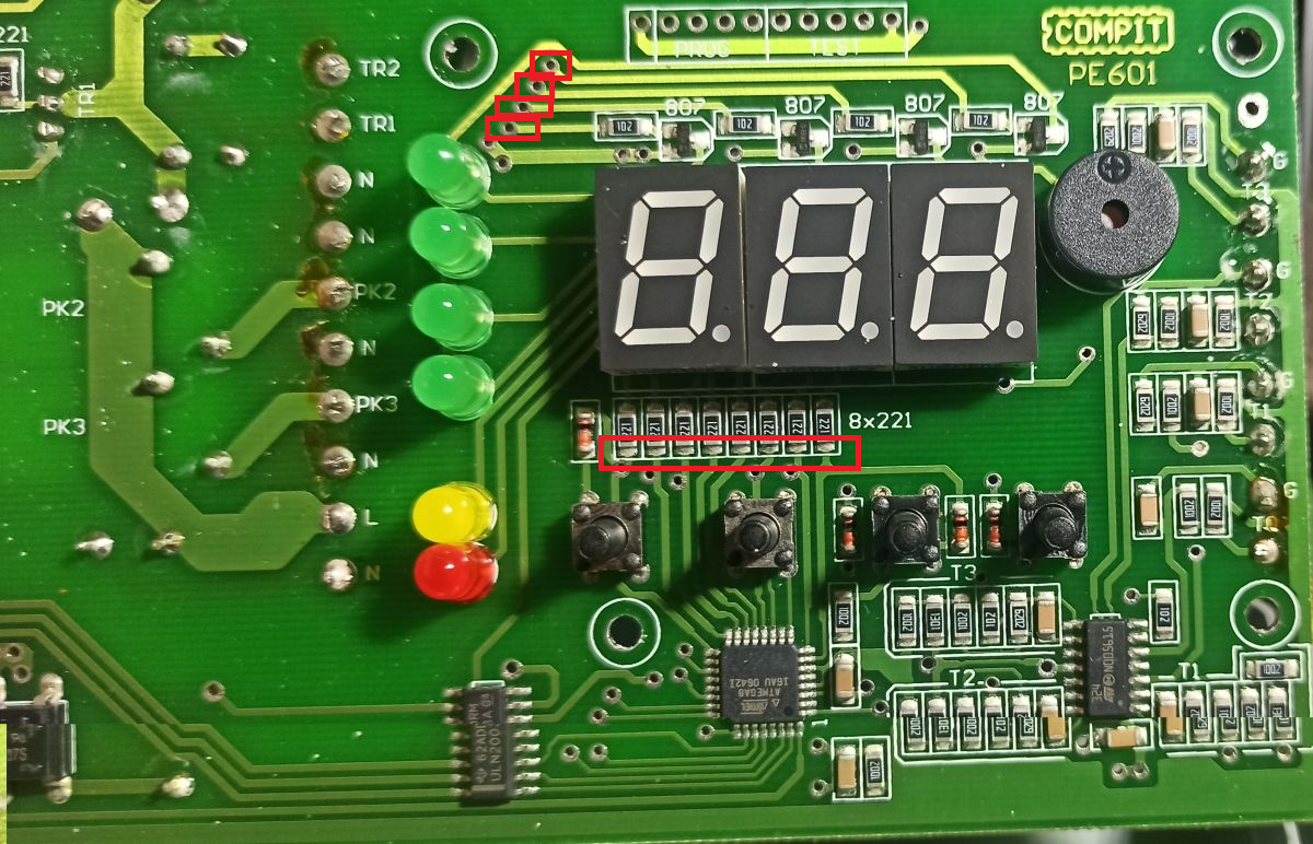

    The voltage you will be working on is the supply voltage of this atmega (just measure it).
    I would not take the signals from the display but from the atmega.
    The display is sequential(read) and additionally the keyboard works on the same lines.
    You will need 12 lines to read data from the display.
    I think the most convenient places to plug in are the lower fields of resistors 221 (data) and the vias next to the top green LED that is the transistor base control before resistors 102 ( selected digit)

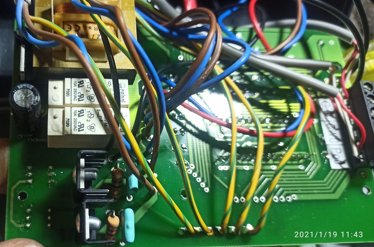

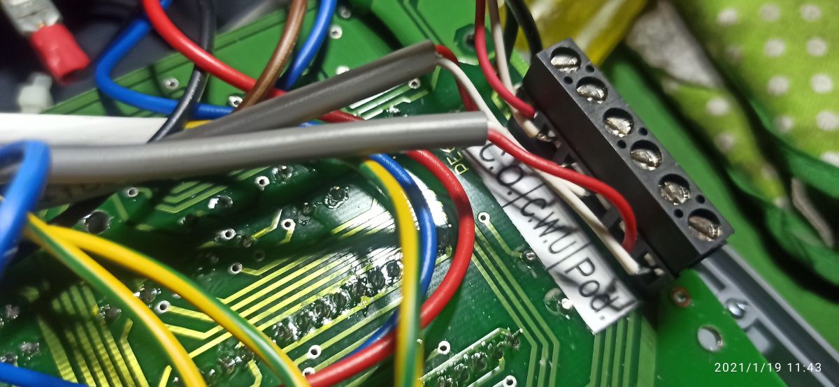

    Unfortunately I don't have very good pictures of the other side those described as test on the other side are probably connected to the temperature sensors which are in the picture in the first post on the right. I was planning to use 24 lines for the display readout, I have a couple of PCF8547's and three I wanted to use for the segmented ones and one for those other 6 leds through, am I wrong or are those 6 leds controlled identically to the segmented ones? I was wondering, when I tried to measure the voltage on these leds (one and the other) with a meter, it showed some strange things, it could show lower voltage on a led that is not lit than on one that is lit, is it because they are not lit all the time but "blink" (they are multiplexed)? In general, these small LEDs are so obviously at least some of them even when lit do not light up at full power
    Maybe not a clever question, but how do I know the status by connecting to the resistors and to the bases of the transistors? Do I understand correctly that each of these transistors is responsible for "lighting up" one segment and on resistors I can find information which elements of the segment should be lit up and which remain blank? So you have to read the states on the resistors all the time and find out which transistor is currently conducting?
    I would also like to ask you a question, because I know (I assume) that the ULN on the left side of the atmega is used to control relays, but what is the circuit on the right side? I've tried to find it by designation but have not been able to figure out what it is.
    Tomorrow I'll take more detailed pictures from underneath and measure the voltage on the atmega
    That second photo is those test prog vias (by those yellow/green wires) and the first one is on the other side near the atmega (atmega somewhere on the top left I think)

    CiekawyŚwiata wrote:
    For the display readout I was planning to use 24 lines, I have a couple of PCF8547s and three I wanted to use for those segmented ones and one for those other 6 leds through?
    There is no point. You will read everything through these 12 lines
    am I mistaken or are these 6 leds controlled identically to the segmented ones?
    You are right - they are treated as a fourth display - read about sequential control(multiplexing) of displays
    Do I understand correctly that each of these transistors is responsible for "lighting up" one segment and on the resistors I will find information which elements of the segment are to light up and which remain blank?
    Yes.
    So that you have to read the states on the resistors all the time and catch which transistor is currently conducting?
    You're doing the right thing - just wait for 1 logic in front of the base of the transistor in question and when it comes up read the states of the lower resistors and so on 4 times. And if you get it right you can read the state of the buttons too.
    To check if something has changed you can use the INT output of the pcfa which will read these 4 lines.

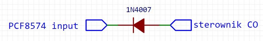

    There is also option 4 - diodes (12 pcs) facing anodes to the PCF.
    The PCF has a built-in input pull-up so you can power the PCF from 3.3V. Voltage higher than this, the diodes won't let through (they will be in the negative) and when the tested output of the atmega is zero, it will pull the voltage from the PCF leg through the diode

    There is also option 4. - diodes (12 pcs) facing anodes to the PCF.
    The PCF has a built-in input pull-up so you can supply the PCF with 3.3V. Voltage higher than this the diodes won't pass through (they will be in the negative) and when the tested atmega output is zero it will pull the voltage from the PCF leg through the diode
    Could you please elaborate because I don't think I quite understand how it works, the connection is supposed to be like this : ESP8266, PCF8574 and 7-segment LED how to connect it correctly?
    At least for now I'll do on the dividers (although the one with the diodes also interests me but I haven't understood it yet), I'll order some voltage converters and maybe in the future I'll check how it works with them. I'm uploading the schematic of how I'm going to put it together for now (maybe I want to do something wrong), as the pushbutton operation is already there and tentatively working it's also on the schematic, I'll connect the PCFs on Friday or Saturday because tomorrow unfortunately I probably won't have time to play :) .
    No - diode reverse.
    Rather some faster than rectifier e.g. 1N4148
    The PCF has a built-in input pull-up so you can power the PCF from 3.3V. A voltage higher than this the diodes won't let through (they will be in the negative) and when the tested atmega output is zero it will pull the voltage from the PCF leg through the diode
    Are you sure the PCF has a pull up built in? I've searched and read but can't find anything conclusive even in the datasheet

  • Probe digit scanning at the ESP pins, not transistor bases
    #27 19265293
    krzbor
    Posts: 1783
    Help: 42
    Rate: 1072
    Maybe to start with, connect the digit selection through the divider to the ESP leads. You'll be able to see if anything is changing (scanning the digits). With the timing functions on the ESP you will also determine how fast the subsequent digits are being swept. Note that you cannot connect to the base of the transistor - the voltage there changes between 0V and 0.6V. You must connect in front of the base current-limiting resistor (which is basically the microprocessor leads).
