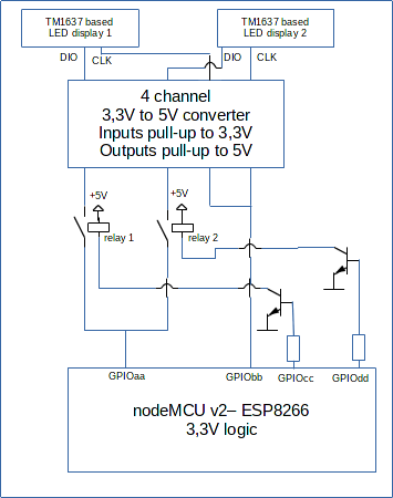

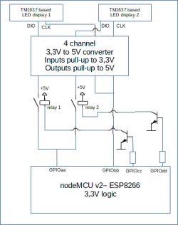

    I am currently using the circuit shown below to multiplex the input to two 7-segment LED displays from a single output of the ESP8266 chip. This is because I have ESPeasy software installed on it. Such software can only work with one such display, so I have to 'trick' ESPeasy into thinking it only works with one display, while it de facto works with two. All switching is done using the 'rules' defined in the ESPeasy configuration. The relays I use are small solid-state relays of the SSR type (this is so that there is no 'flopping' effect). But this solution is too expensive and too large compared to using MOSFETs, for example, such as the 2N7000.
    Using MOSFET transistors instead of SSR relays with nodeMCU v2
    Unfortunately I don't have enough knowledge hence I am asking Fellows on the forum. How can I replace the relays shown in the picture (along with the bipolar transistors controlling them) with MOSFETs ?

    mackowiakp wrote:
    How can I replace the relays shown in the picture (along with the bipolar transistors that control them) by MOSFETs ?
    This route, in any case, is not optimal, because you are dealing here with logic signals and the switching can be taken care of with a ready-made multiplexer. For example using 74HCT4052, 74HCT4053 or similar. You can control it with one bit if you don't have a "none selected" situation.

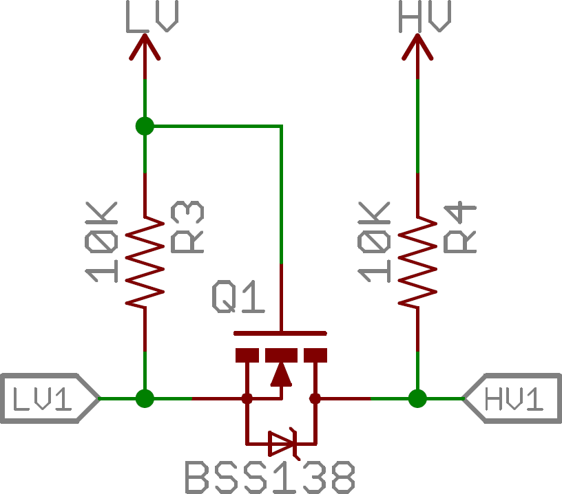

    I think I have found a solution. Let's look at a single channel of a 3.3V to 5V converter.
    Using MOSFET transistors instead of SSR relays with nodeMCU v2 .
    If we control the gate of the transistor directly from the GPIO of the ESP8266 then we have a multiplexer and a converter in one. And I have to use the converter anyway even though the TM1637 works fine when powered and controlled from 3.3V. And this is because I am using blue displays which light up poorly with a 3.3V supply. I will buy the transistors on Monday and give it a try.

    mackowiakp
    Posts: 52
    Everything you write is right. That's why I wanted to use displays based on the MAX7219, which is also supported by ESPeasy. These ICs have a "chip select" which would take care of the multiplexing problem. Only they didn't have any in the shop in the blue colour I wanted.
    Baywellian. I found an even simpler solution based on a bipolar transistor, and I have one in my drawer:
    The converter is admittedly unidirectional but that's all I need. I connect the base to the GPIO and it should work.
